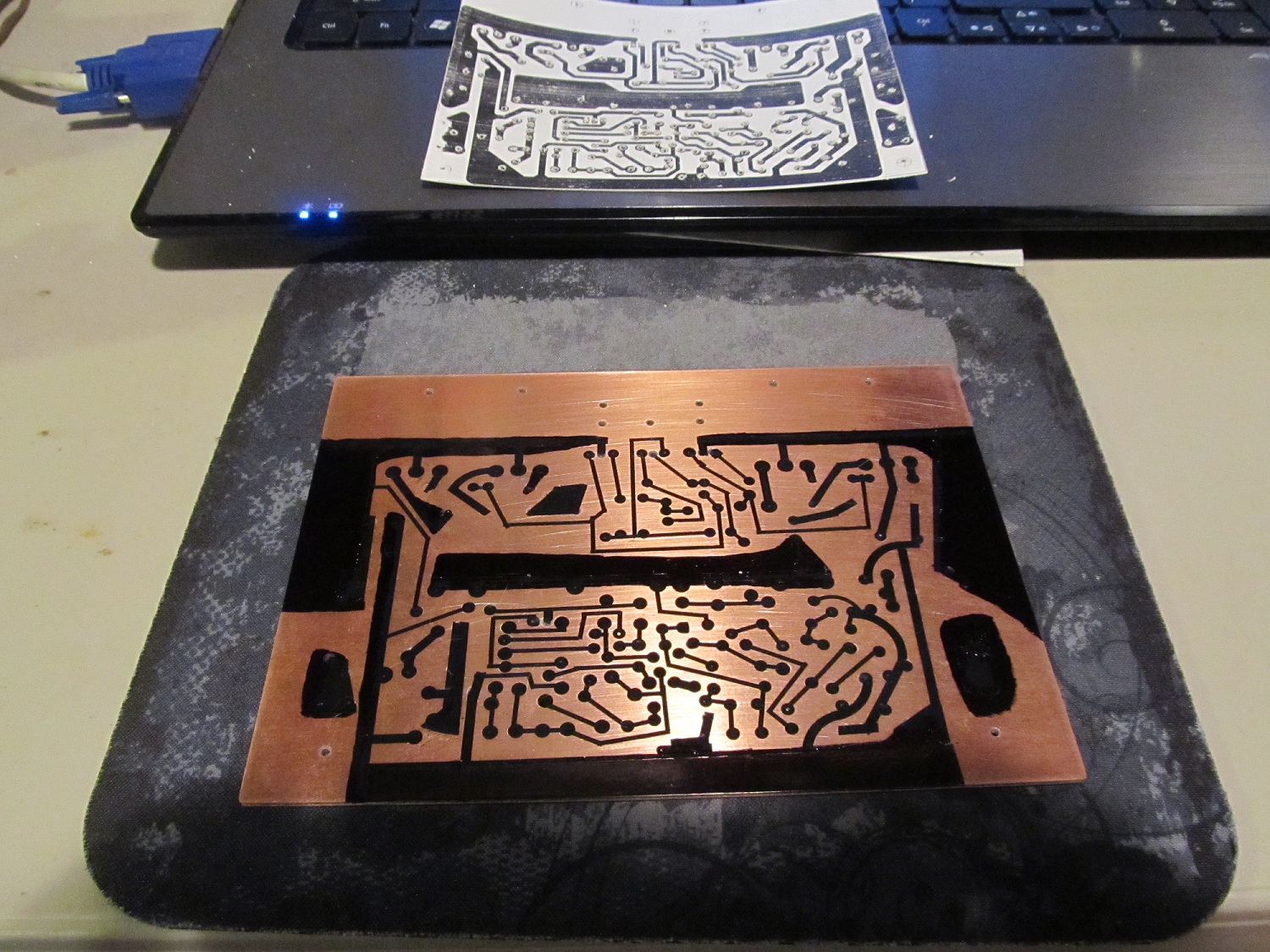

I etched the board and soldered in the components, it took me about 4 days to do this, I loved the build all the way. Looking forward to using the laser printer method, this board was laid out by hand. Also love the community that designed and release something wonderful like this for me to enjoy.

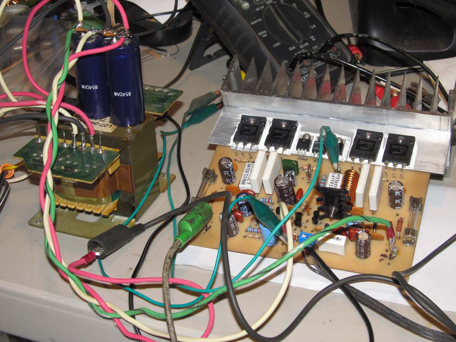

Here are pictures of my amp, I cant post here yet due to missing security ring? Think I am too new.

From your pictures, you have substituted that NTE375 in place of the bias device BD139. The TO-126 and TO-220 devices have different pinouts - one is the reverse of the other.
Also your 2SA1943/2SC5200 transistors look like they may be cheap copies or fakes. If so, that could be causing the oscillation.

Output transistors look fake
Brand is Japan? 🙂
Make sure you replace them, you might burn other components when your fakes burst into flames. If you have a spare one brake it and post a picture with the die inside it. Maybe you are lucky and they are not too worthless.

I’m thinking after a bit more of reading I will build another one… This time I will use the laser toner transfer method for making the PC board instead of laying it out by hand and I will make two at a time, left and right. Before printing the boards I wish to Photoshop the design and include one more NPN and PNP output transistor on each side. I BELIEVE that I can do this without modifying any other value or part on the board. Just make the board a little wider, move the pos and neg traces out to the sides and insert another transistor and resistors R23 & R26…. I will use MJL4281A & MJL4302A and everything else like the original schematic. All amps I build need to be PA rated so for overkill I would like to include another set of transistors.

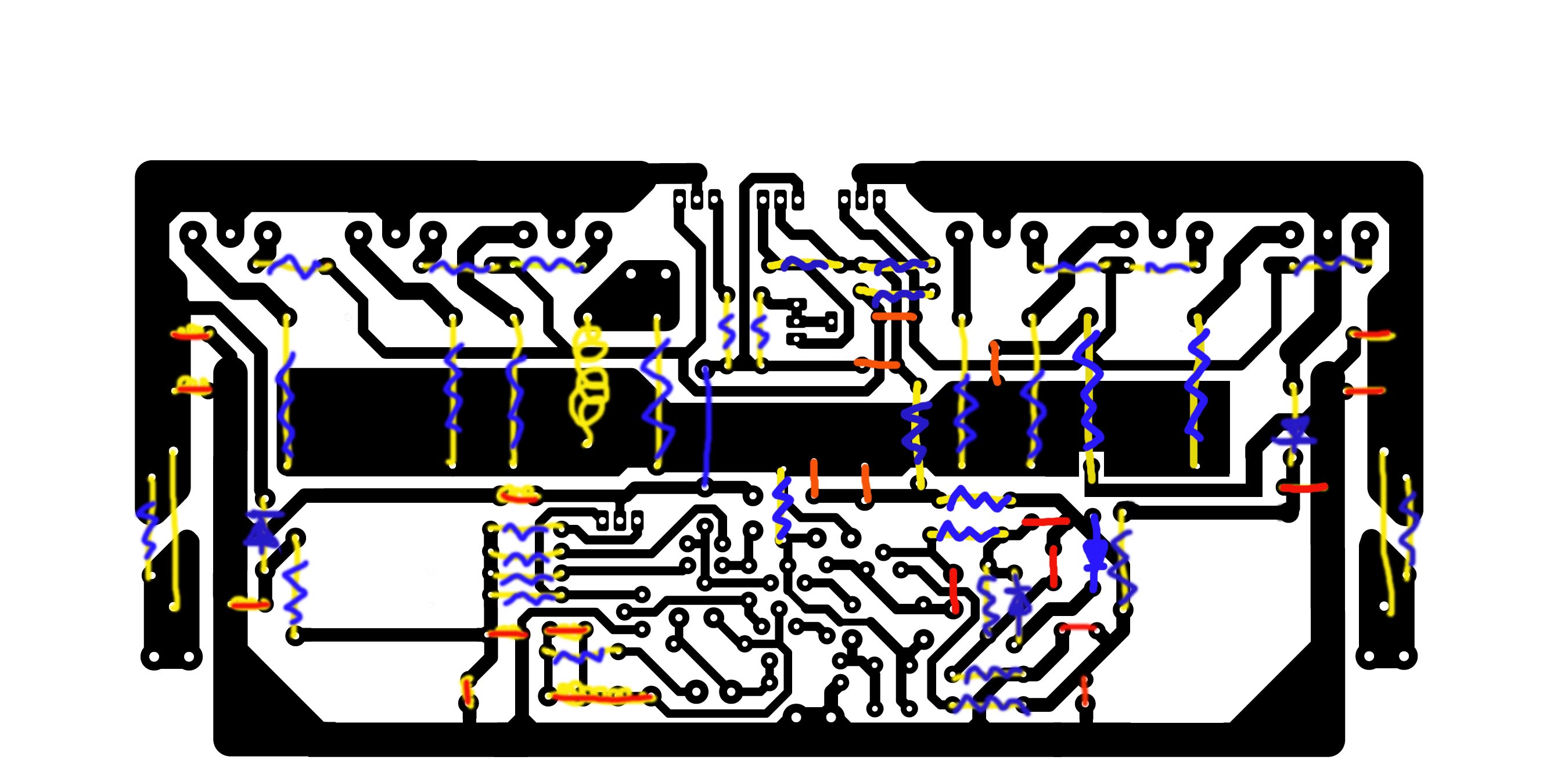

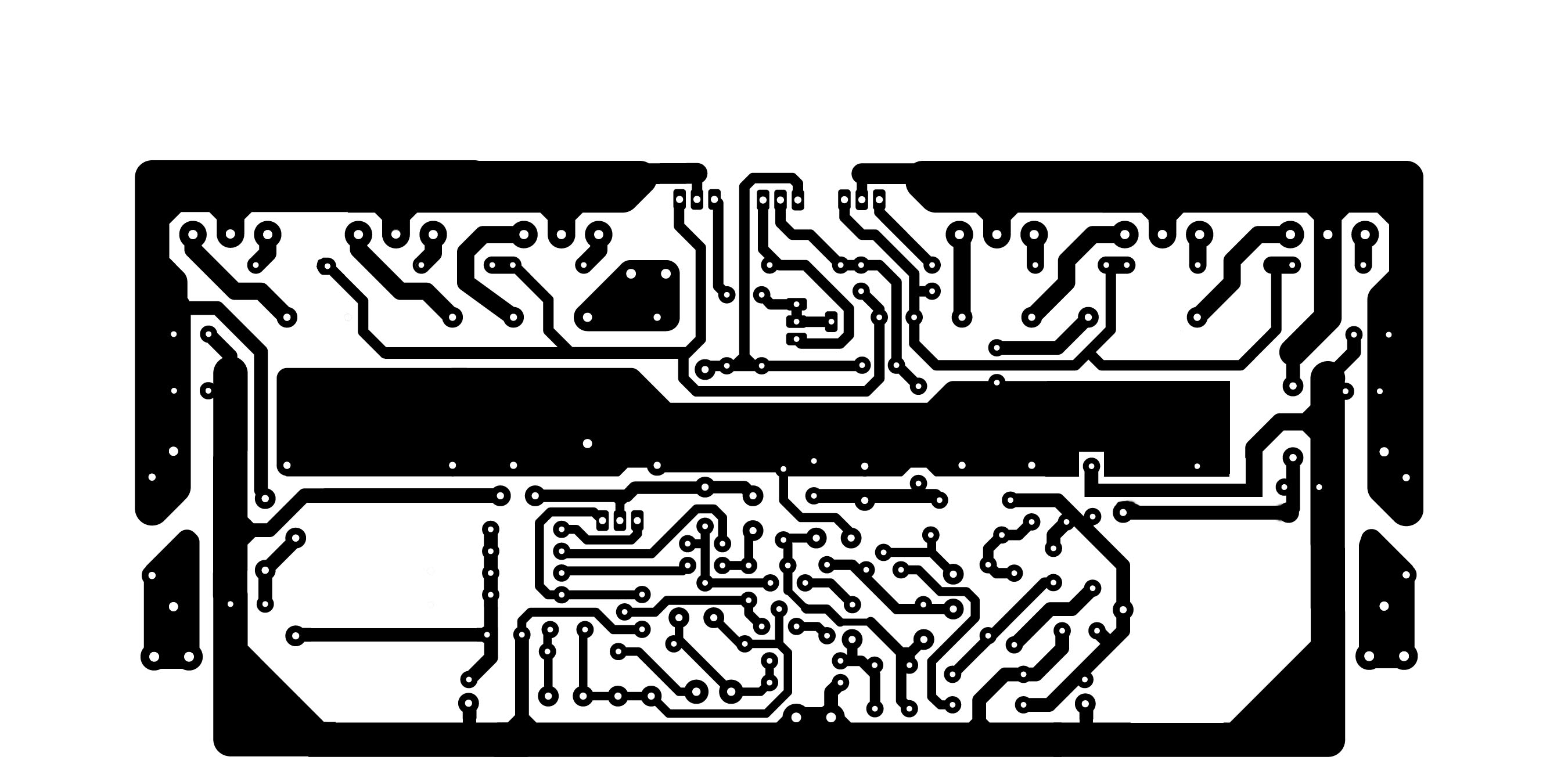

I was thinking of something like this… I would call it DX Blame MKII Super Duper Supercharged amp… 1 extra set of output transistors…. I CAN DO THIS RIGHT?
The final layout will come once I have all the parts on hand so I can tweak the layout should a capacitor or fuse socket need just a bit more space.
I would power it with 45 volts (61 after regulation) 300VA transformer per side and make all the capacitors rated at 100 volts (80 volts for the storage caps 60,000uF total each amp)
Design goal would be 150 Watts output at 8 ohms for use in PA application of top high and mid speakers.
What do you think?

Should be no problem to change it up with an extra pair of outputs. The thing with multiple outputs is that for good current sharing between these devices you want to ensure the devices are 'matched' so that they all turn on together and flow similar current. This usually means buying extra and testing them - something I've never done because I'm too lazy. Although I've never tried it, I think multiple output devices from the same batch will be fairly well matched already and then just use largish emitter resistors, say 0R47 to force the current sharing a bit more.
