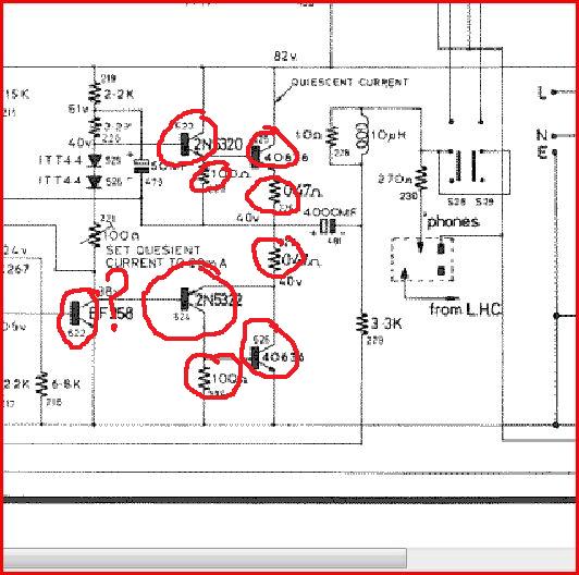

Here's the schematic in the mean time!

Thanks for the circuit...
just one mad thought... if a wire to the output transistors broke (with keep moving the PCB) then that could cause the problem you have.
I can virtually guarantee that replacing the driver transistors and outputs (if they are short) will fix it together with the 100 ohm, but it's nice to fix stuff properly.
With the amp OFF
You need to confirm that the two 0.47 ohm resistors are OK.
Next measure the output transistors on a "diode check" range on your meter. If they have failed it is almost certainly from Collector to Emitter.
Do the same for the driver transistors... I can't clearly make the ref numbers out, looks like 623 and 624. It the "2N" transistors anyway.

These are what to check. The transistors are all obsolete types but that's no problem at all. The BF258 (that's a video output transistor from the very early solid state bw/colour TV days) is probably OK.
When you replace any parts for this repair use a "bulb tester" which is a 100 watt filament bulb in series with the mains supply to the amp. It can save blowing output transistors if there is a fault.
Need to know exactly what has failed however. It's also possible but unlikely that the two ITT44 diodes have been damaged and also the 100 ohm preset.
For the cost of the parts tbh I would just replace the lot in both channels but it's educational to do it properly.

I checked all the components that you suggested, testing the transistors using the method shown for bi-polar's on this site... (anything not reading out at more or less what they said it should has been written off)
Testing semiconductors with analog and digital multimeters
I have put red rings around the damaged components, green rings round the tested and passed components. The blue rings signify that I was about to test the components and then my soldering iron stopped working... (ARGH!) but I strongly suspect, looking around the BF258 that it will also be knackered! I found that the 0.47ohm resistor that I passed came out at 8ohm, but I tested the two on the other side and found they also read out at 8ohm. I've put this down to the armstrong "rolling development" policy.

I'll put some suggestions for parts down.
The 0.47 ohms... hmmm. They won't be 8 ohm for an "emitter" resistor. 0.47 is about as high as can be used for various reasons. Make sure your meter reads 0.00 when the leads are shorted together.
I think the best option is to rebuild both channels and keep them the same. It's a dead easy repair (famous last words) as long as you are methodical. I must look up the output devices to see what package they are in. Probably T03 at a guess.

8 ohm doesnt sound right - were these tested out of circuit? I'd suspect your meter cannot read low values correctly otherwise. 0.47 ohms is a typical emitter resistor value in output stages.
BF258 you may have to find old stock. The 2N5320/2N5322 are still made by ST and Semelab, Digikey have them. The 40636 power transistors can be subbed with 2N3055's - in fact this is what the RCA datasheet I found lists for them.
Edit: on second thoughts the 2N3055 looks like it's out of spec for the rail voltage used. No matter - pretty much any TO-3 device would work well here. 2N3773 as PB2 states, or MJ15003.

The output stage is undersized for handling a short circuit load, is there a fuse or anything in the supply lines? I'll let you look.
Edit: OK I looked 2.5A are there in the schematic - were the right ones in there?
The VAS needs a current limter also if you want it to survive a shorted output.
I'd add a 2.5A fuse in each supply line to each channel, and a current limiter on the VAS set for about 50 mA.
