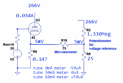

Hello guys, I am prototyping an amplifier with the output tube biased at 34mA (#45). I've decided to remove the cathode resistor (especially the cathode resistor capacitor!) having better bass plus more details and control the bias with the grid voltage (around 50V). For a peace of mind I would like to monitor the bias current. I've got a microammeters with the "0" in the middle, so if there is no current flowing the meter pointer remains in the middle.
On the 0R47 (relatively small resistance that should not affect the output impedance) current sensing resistor there is about 16mV voltage drop, opamp amplifies it to 1.6V. On the opposite there is 1.6V reference voltage after the opamp buffer. At 34mA I've got 0V between them and the current is not flowing. If the bias current will change I got the meter pointer moving to direction that depends on the voltage difference.
Is it an optimal solution? Is there a better idea?

You circuit looks cute. But without completely analyzing it, I think that the poor 50uA
meter movement will be hard pegged at one end, until the 45 tube warms up.
Where is the meter protection?
And your circuit does not have any integration of the cathode current, which will vary wildly during large signal conditions, the meter will be shaken to death.
Fix the meter issues, and at least you can see that the current is where you desire it, regardless of what you do for a fixed/variable/feedback - grid bias system.
As to automatic bias control using - grid bias, the requirements are a cathode current sense resistor, (in the 45's case 'center of filament' & with DC filament power), operational amp(s), negative bias supply voltage that runs the op amp(s), and a very long time constant integrator loop for the op amp(s).
I believe that the thermionicaudio has part or all of that.

It won't monitor the bias on a meter (but you could rig one up) but it will match bias on all output tubes so you don't have to bias it anymore.
I don't know, if is it better, but simpler. 🙂Is there a better idea?
1R "cathode resistor" paralleled with 50-100mV DC meter.
Panel Meter 100 mV DC, round - Tube-Town GmbH
IMHO amount of current is more important than the degree of change.
I would not say so. To be optimal, there are much components required to carry out a simple task, i.e. to monitor cathode current.
I would say optimal current monitor is simply 1...2.2 ohms cathode resistor and suitable current meter (some 100 uA) across it.
This size cathode resistor (< 10 ohms) has negligible effect to output impedance.

...Is it an optimal solution? Is there a better idea?...
You will find out quick enough if the needle bounces on loud bass passages.
Depends on the mass, resonance, and damping of the d'Arsonval movement.
Also depends on the 2nd harmonic distortion caused by the 45 and decreasing XL at low frequencies.
PRR, awesome, thank you for that, I will try it, if it start bouncing at low frequencies as 6A3sUMMER said I will try to implement this (it's over complicated now but I've added simple meter protection and an integrator):
