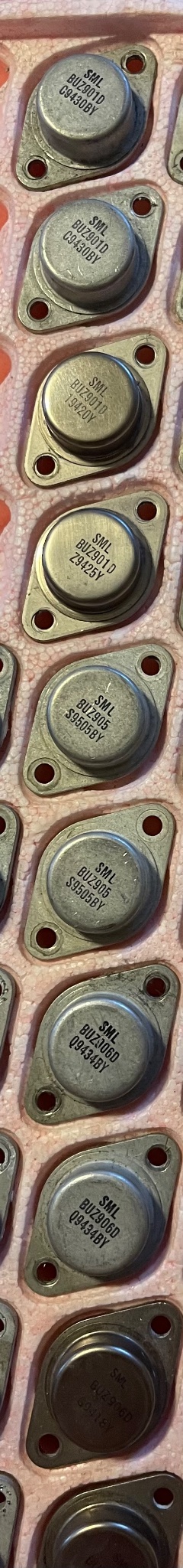

Bought this amp as none working in the hope of an easy fix, I replaced all the capacitors and 2 resistors ( burn marks around their pins ) .
All was well until i heard a loud crack through one speaker and the amp powered itself off , I unplugged it , I’m just guessing now that it potentially be the output transistors which only have the chord markings so I can’t identify them, can I identify them by unsoldering them and then connect my peak atlas to the pins and the one retaining screw ( pen shows where they are ) they’re very difficult to get to ! I can see the printing on them but it relates to nothing.
It depends on the version of the amp. The small one, the 600 have less, the bigger, the 1200 have more. I really can`t remember all details. I do, however, have a complete 3000 without PSU. With lots of MOSFETs.

Look at my picture, BUZ901 and BUZ906.
