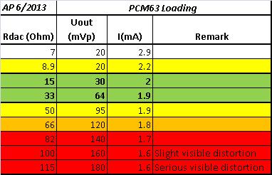

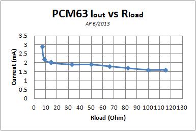

in a thread about pcm63 I got a couple of images (credits to original author) about the "ideal" value of load resistor for this dac.
Wouldn't too low a value (2.5R) make the pcm63 suffer in supplying the needed current?
Stefano
Thanks,
Thanks for sharing such measurements. I do not know why such a resistor value called as "ideal", but I know based on AD1862 that 7.5Ohm i/v resistor has impact (distortion) at -100dB.
There was no any issues in practice. The lower the seen imp, better LF response at least.
Probably the best answer could be the answer for question: what impedance was seen by PCM63, within datasheet measurements (using OPs)? 🙄
