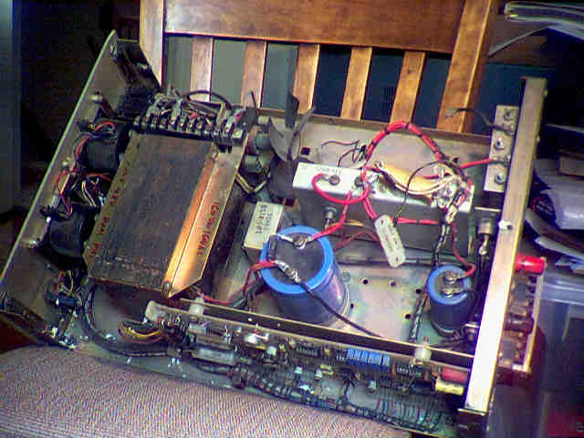

The flux that goes thru the core couples both windings. Any flux that circles just one coil (air path) causes leakage inductance. So tight spacing between windings is the general rule (except minimum insulation required for V difference). The great untapped (except for one famous OT manufacturer) technique for reducing leakage L is using a "long" E or going to a toroid. A long air path makes the high mu core much more attractive to the escaped flux. Cut toroids with one or two short bobbins lose that advantage. Long E lams may still be available for "constant V" xfmrs, but their days are long gone with switching supplies these days. Some long E lams have dimensions that will fit TWO standard bobbins on their length, like the one shown below made by Tempel. Some old Kepco power supplies used long E xfmrs to keep a low profile. All the commercial OTs out there use standard "scrap-less" short E laminations, so have to use a high number of interleaves (which by the way make each winding section relatively long and thin) to achieve low leakage L.
You mentioned using a "long" E laminination, but those are hard to come by, so, is it possible to use two regular E's like this?
For a SE transformer an air gap would be needed and they would also need to be clamped tightly together, which is doable.
One could use two bobbins or fabricate one twice the length.
Should work for SE, Make sure the lams are neatly packed with a flat surface for the gap spacer. Probably will need to pack them into the bobbin tightly to avoid buzzing lams. Maybe a big hose clamp around the outside to keep them together tightly.
