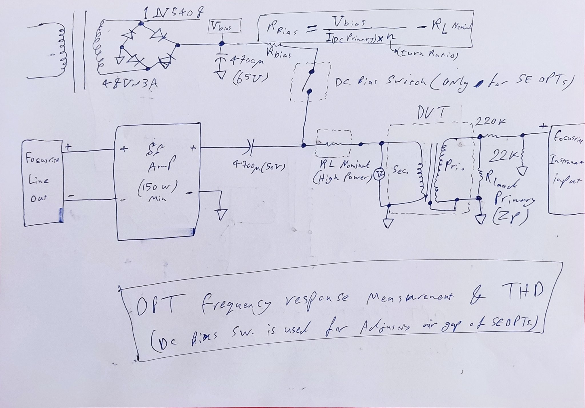

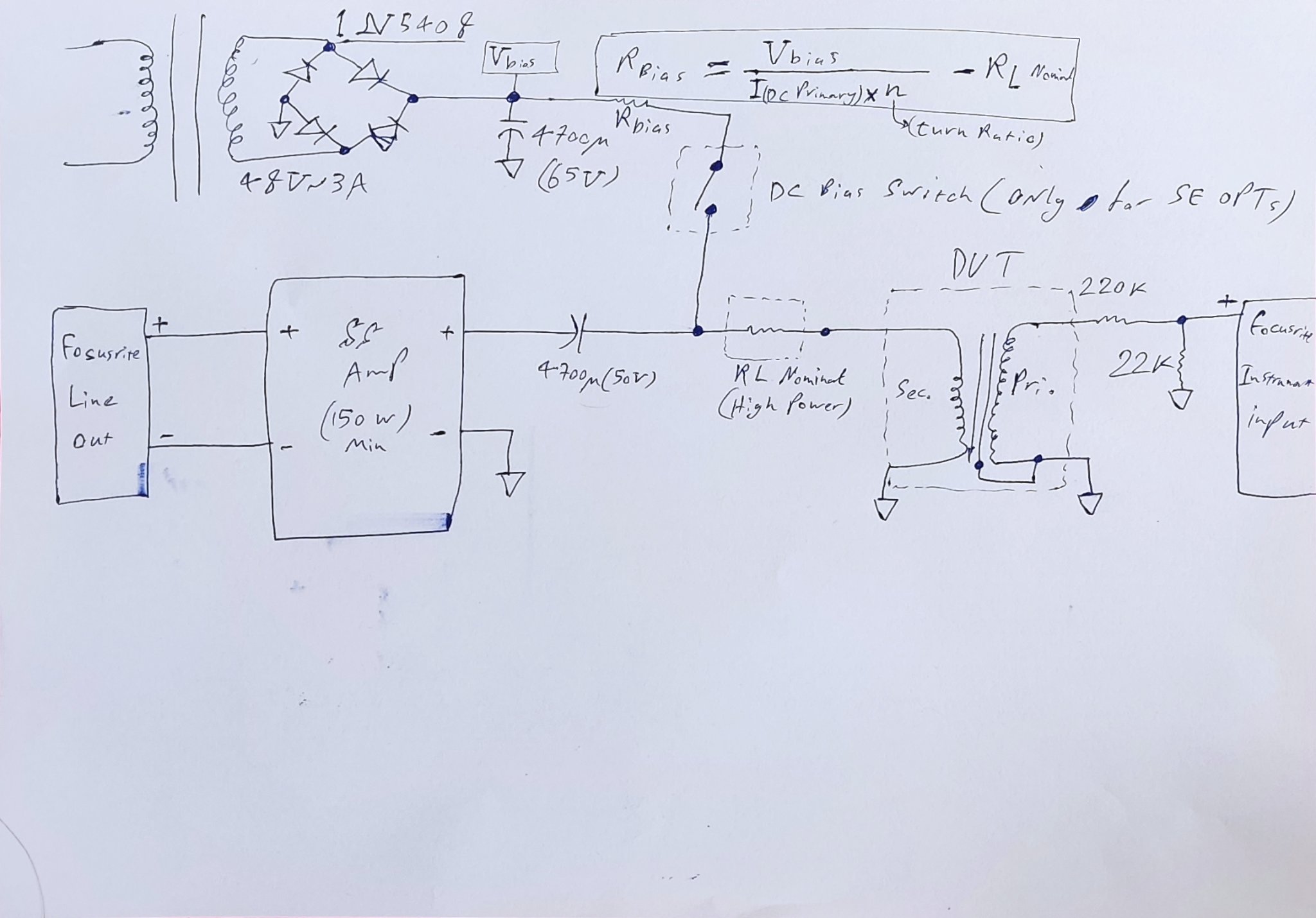

This is how I measure frequency response of my handmade OPTs. RL should be equal to nominal secondary impedance, and for measuring FR adjust the signal for 1W to max output power across secondary. THD will be measured at the same time.
The DC bias switch is for adjusting the air gap of SE OPT's and should be open in any other test.
I forgot to add primary load; There should be a resistor equal to nominal Zp or plate resistance of the driver tube connected across primary winding, so here is the correct diagram:

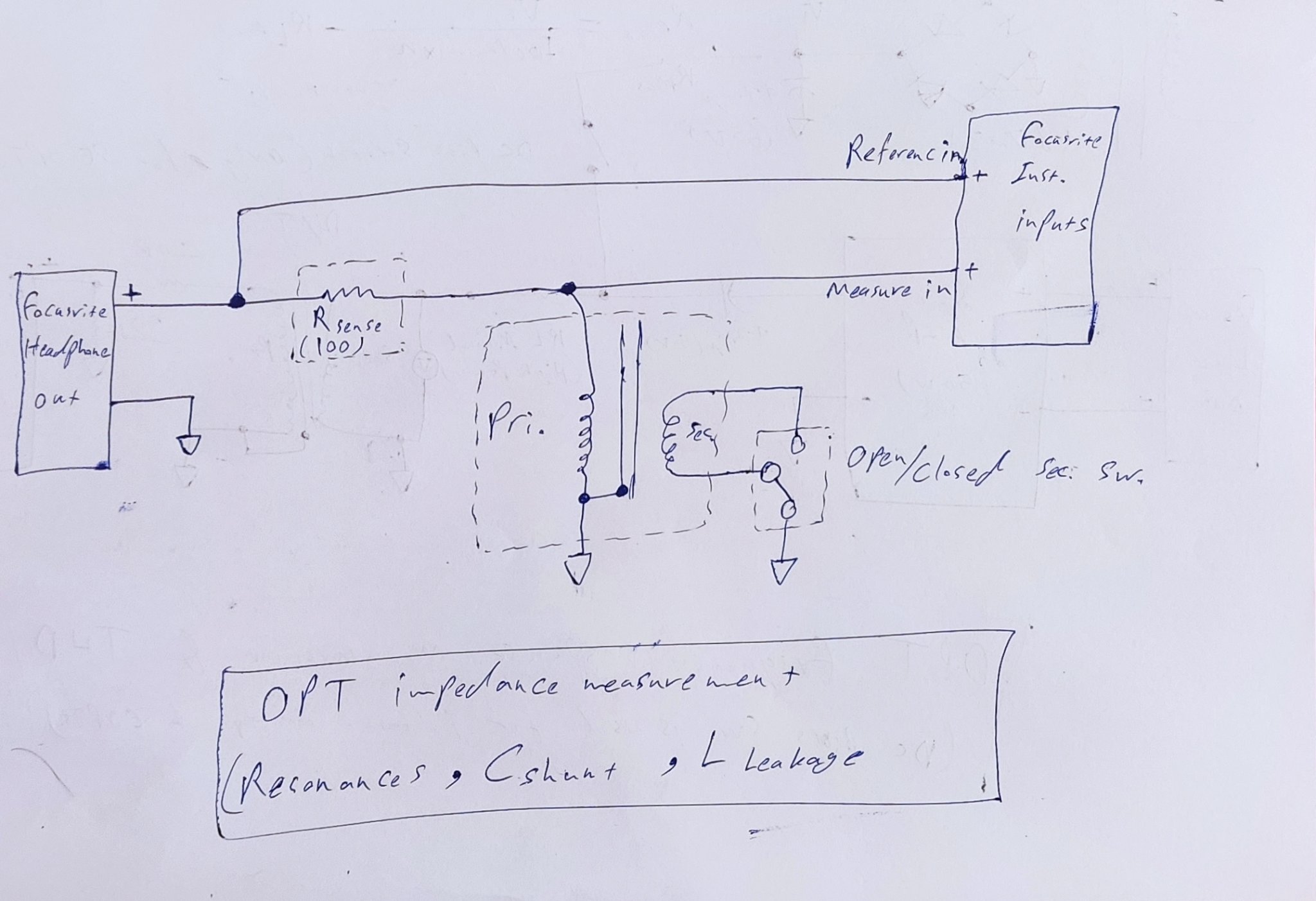

Also for measuring impedance and shunt C and leakage inductance use this:
Foe measuring impedance, the excitation voltage should be the max possible voltage of headphones output, also bear in mind that impedance measurement is at low signal so it won't show anything about low F response and primary inductance, but it will show overall shunt capacitance (measured at 20KHz with open secondary), and also leakage inductance (measured at 1KHz with closed secondary).
