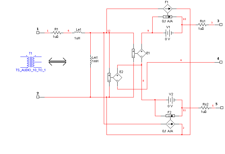

Here's the SPICE model for "AUdio Transformer 10:1
in Multisim:
.SUBCKT ts_audio_10_to_1 1 2 3 4 5
* EWB Version 4 - Transformer Model
* n= 10 Le= 1e-006 Lm= 0.001 Rp= 1e-006 Rs= 1e-006
Rp 1 6 1e-006ohm
Rs1 10 3 1e-006ohm
Rs2 11 5 5e-007ohm
Le 6 7 1e-006H
Lm 7 2 0.001H
E1 9 8 7 2 0.05
E2 8 4 7 2 0.05
V1 9 10 DC 0V
V2 8 11 DC 0V
F1 7 2 V1 0.1
F2 7 2 V2 0.1
.ENDS
You can adjust the values for 100:1 etc. I attach also a sketch of what the SPICE connections seem to be (node 12 on the schematic is node 7 in the sub-circuit model)

That model is backwards
The center tap should be on the primary and this will not work by just reversing pri for sec like a real transformer.
I'm going to take a crack at this because I have an entire Fender Deluxe Reverb-AMPAB763 modeled in Micro Cap with the exception of the O/P transformer.
Why is this so difficult to find?
The SPICE code and the pic really helped though. I should be able to go the other way with it.
