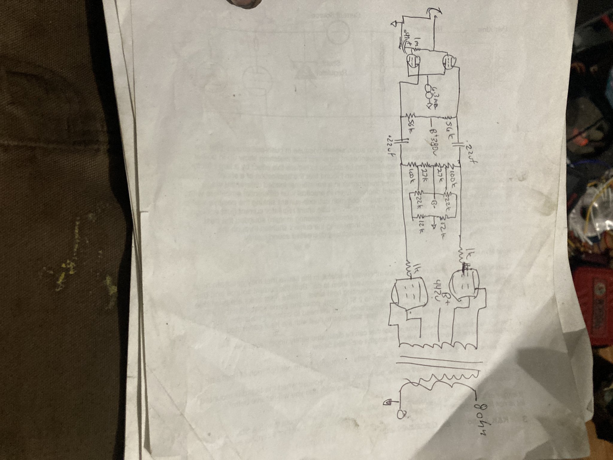

I am wanting to order two output transformers from electraprint. But not sure if I am giving them the correct data. Running el34 push pull ul, fixed bias at 40mA, B+ 450v
For electraprint
105w
4.6k plate to plate
100mA/100mA
50%ul taps
Load impedance 8 ohm
Would this be accurate?

105W seems very high. Electra-Print has very honest power ratings; a 25W rating will mean -1dB at 29Hz and 30kHz before the onset of core saturation. Edcor is another story…
Do you need 100 watts? With Electraprint I think 60 watts would suffice. UL taps would traditionally be at 43%, but personally I like them at 50%, sounds more triode-like.

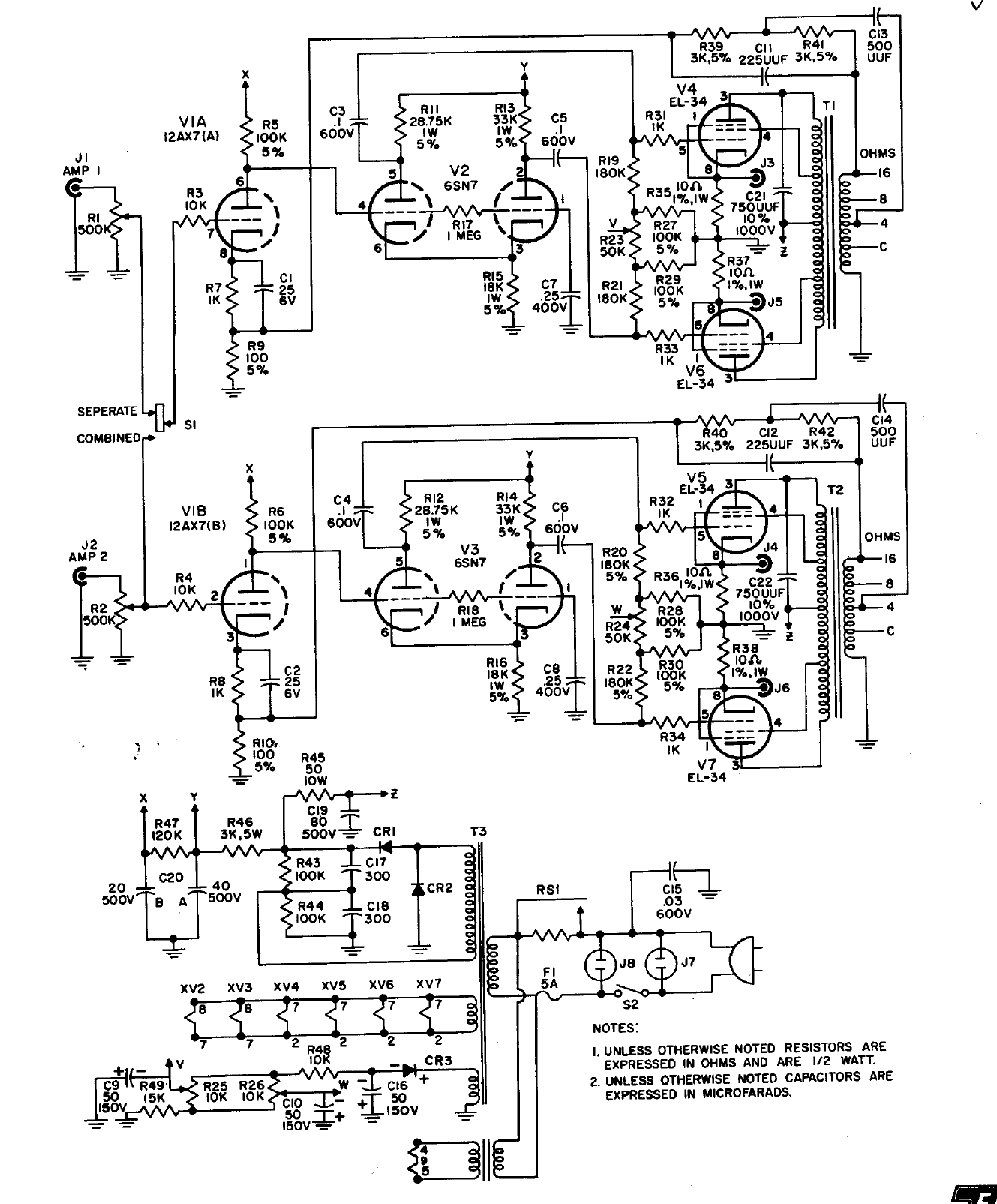

You gentlemen are correct. My error. It is a 50-60 watt amp. Give me a second and I’ll draw up a schematic
Ask Jack about his new enhanced A3 Iso-Linear circuit for use with EL34 tubes. It uses the same 50% screen taps you’re asking for.
