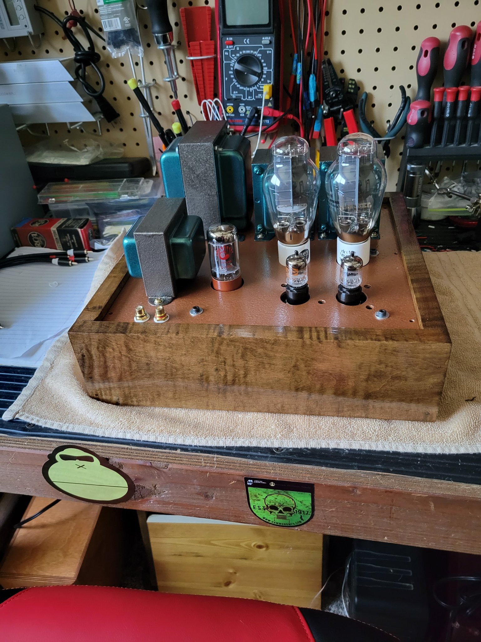

Here is a picture of a ver.1 Tubelab 300Bamp I built. Its pretty compact.
The power transformer is rotated 90° to the two OPT's. All three are very close to each other. The amp is dead quiet, and sounds really good.
lavane,
Good looking!
Some of the factors that might have contributed to your "dead Quiet" amplifier:
A non-steel chassis?
Proper reduction of all the types of ground loops, such as input circuit wiring, B+ wiring; all with short wire-length well planned controlled ground loops?
Perhaps DC for the 300B filaments?
Reactions: lavane

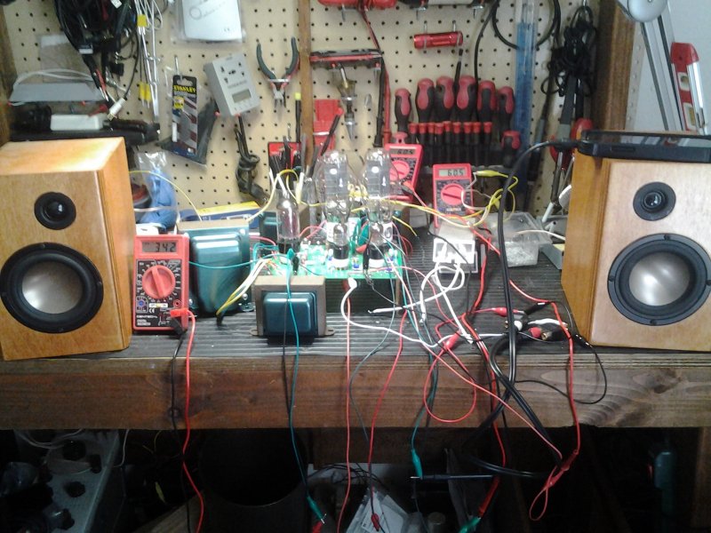

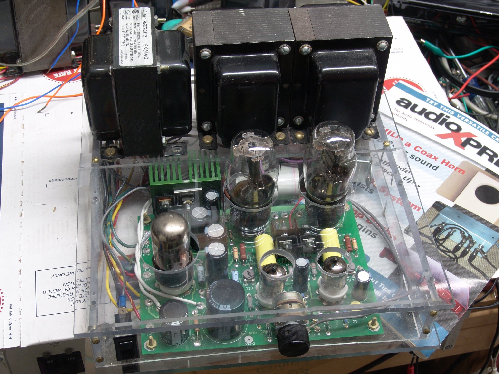

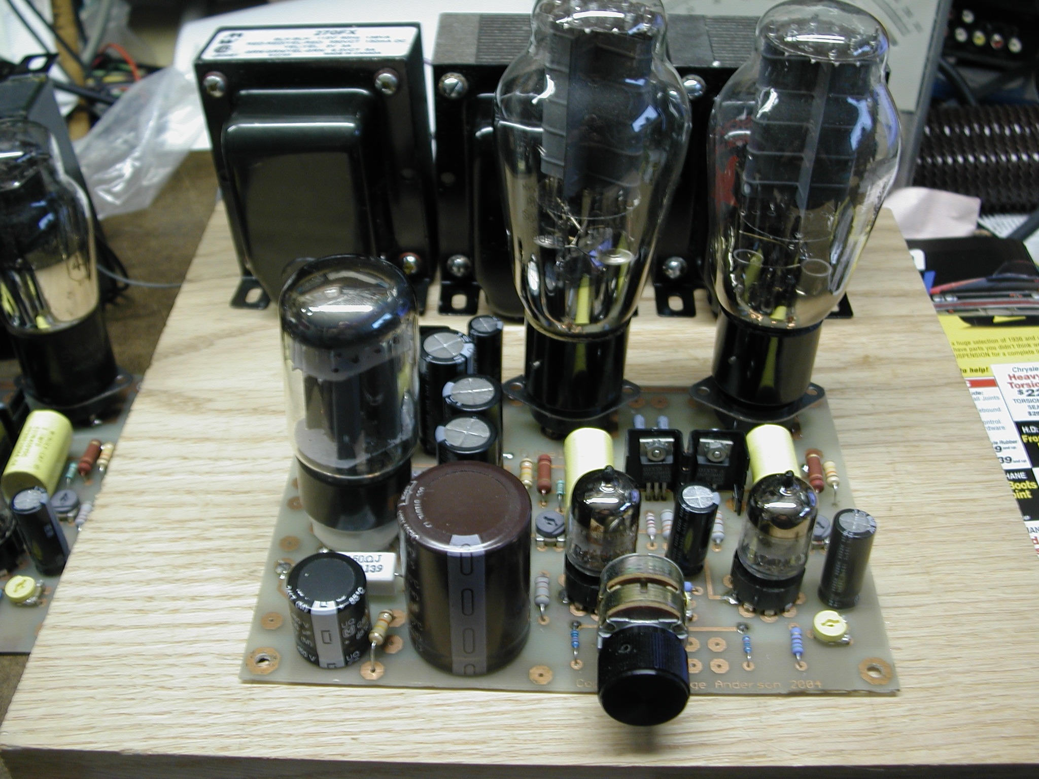

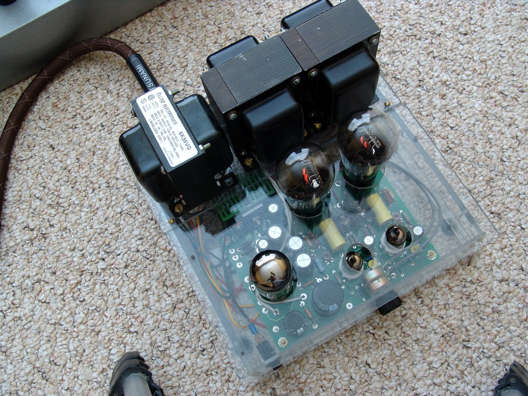

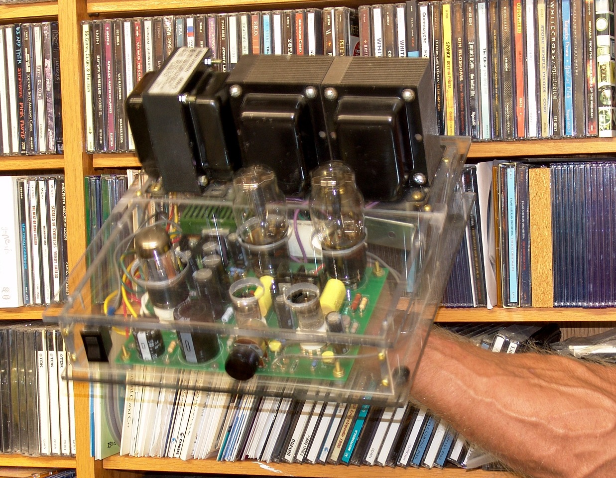

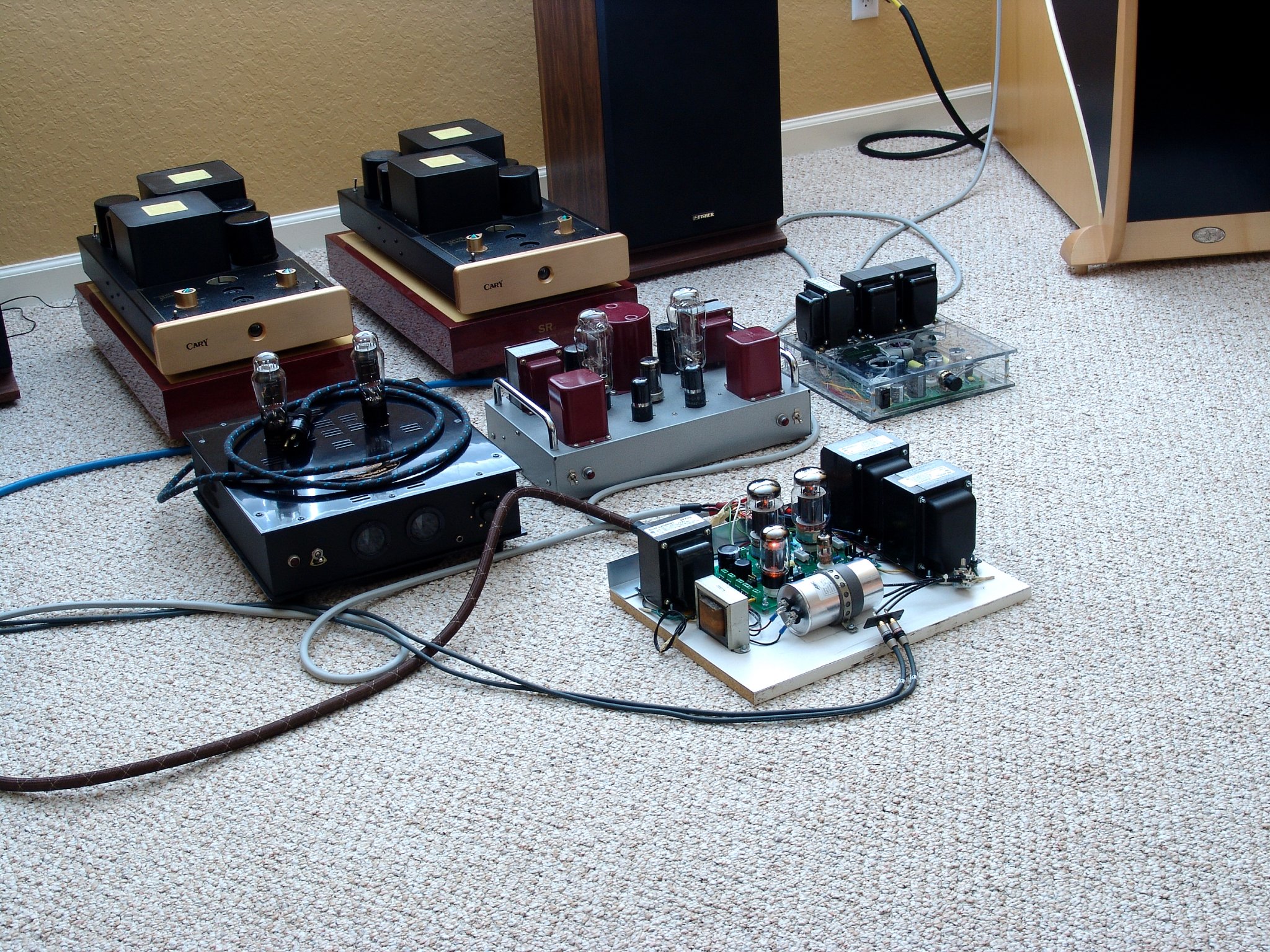

This picture shows the very first Tubelab TSE boards being tested over 20 years ago. Note the three transformers all lined up in a row looking nice. I had not yet made a case for any of them. There were three boards, one with 45 tubes, one with 2A3's and one with 300B's. All worked well and sounded great with my 87 dB Yamaha NS-10M Studio monitors. I put one board in a DIY clear Lexan case. Since the three transformers in a row looked nice, that's how I mounted them. I took it to a friend's house who had some Lowther based 102 dB horn speakers with active powered subwoofers built in and it was ugly, lots of HUMMMMMMM!
I brought the amp home and scoped the output and there was indeed a good bit of 60 Hz voltage on the output of the transformer next to the power transformer, and some measurable hum on the other OPT. Oddly the hum was loudest with no output tubes in the amp. Apparently, the DC current through the OPT will reduce the susceptibility to hum pickup. Rotating the power transformer 90 degrees made the hum vanish and it was indeed quiet on its next meeting with the 102 dB speakers. We drove one channel to full output (maybe 2 watts) and unplugged the input cable from the other channel. It was hard to tell if there was any sound from the quiet channel with the loud channel going, but no vibration could be felt on the subwoofer cone. If there was any coupling from one OPT to the other, it was not an issue.
After listening to the Lexan TSE on $10,000 worth of speakers, I fired up the first production quality SSE board for some OPT auditioning. Knowing that the OPT's mounted on the particle board were the worse sounding pair I had, I didn't bother to conceal them. All others were in unmarked cardboard boxes and connected into the SSE with clip leads. With 5 people present and 5 different sets of OPT's there were no clear cut winners, but the big Hammonds were unanimously the worst sounding through real sensitive speakers. I still have them and now, 20 years later I know how to make them sound good. They need to be driven by a tube with a very low plate resistance. A big TV sweep tube in UNSET mode with lots of local feedback feeding my old Yamaha NS-10s will do it.
The TSE was heard here with some NX-483 tubes from 1929. they sounded great then and are STILL IN THE AMP TODAY. Will they make it to 100 years old? I was rummaging through a flea market in Mount Dora Florida when I spotted an old Sparton radio chassis in the dirt seemingly unwanted. The owner wanted $20, I gave him $10. I kept the tubes and sold the chassis to a collector for $20. That's where the NX-483's came from. They are like a 45 with a 5 volt filament. Will any of the tubes being made today live for 90+ years?
