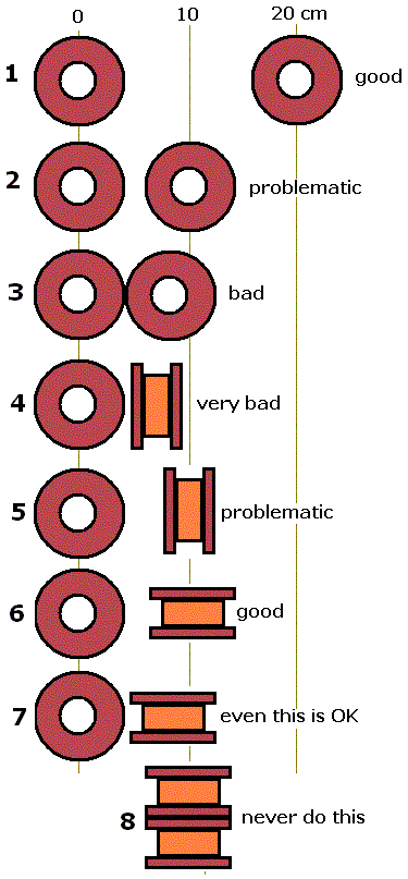

I've got more questions now, especially after seeing that graphic. Does number 8 refer to literally stacking ei transformers on top of each other? That was one of my ideas.
Does that graphic refer to toroidal transformers with the doughnuts? I was under the impression I didn't have to worry about toroidal placements. In fact, I was considering stacking a toroidal choke under the toroidal power transformer. Issue?

No, the pic is refering to xover inductors.
That graphic shows inductors wound on a round bobbin. These are not like a toroidal transformer. For one, the winding directions are different between the two (toroidal transformers have the winding wrapped around the band, going from ID to OD with each turn, whereas these inductors are typically wound around the outside circumference). Second, toroidal transformer placement is less critical because the secondary winding is wrapped around the inner primary. It’s due to the shielding behavior, not the shape, that makes the transformer less magnetically reactive to its neighbors.
