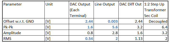

All, thanks for your response.
I just did some measurements to find out the signal levels at the DAC output of the Wolfson WM8740 of my Linn Sneaky DS. The amplitudes are listed below. So if I would use a step - up transformer with a turns ratio of 1:2, which means a voltage gain of two, then I could pick up GND-decoupled balanced signals at line level standard amplitude (2Vrms) at the secondary port of the transformer. That´s good, this means no preamplifier would be needed and I could go ahead with a passive pre-amp, i.e. an steppled (shunt?) attenuator. Unfortunately there are not much choices of 1:2 step-up line output transformers. The only two I found at Jensen are the JT-123-BMCF and the JT-123-BLCF. The down side of these transformers is however their rather low input impedance of 150Ohms which is not compatible with the DAC output specification that requires a load resistance at the output higher then 0.6-1kOhm.
Maybe I should consider a JFET buffer in between the DAC output and the transformer.
Markus

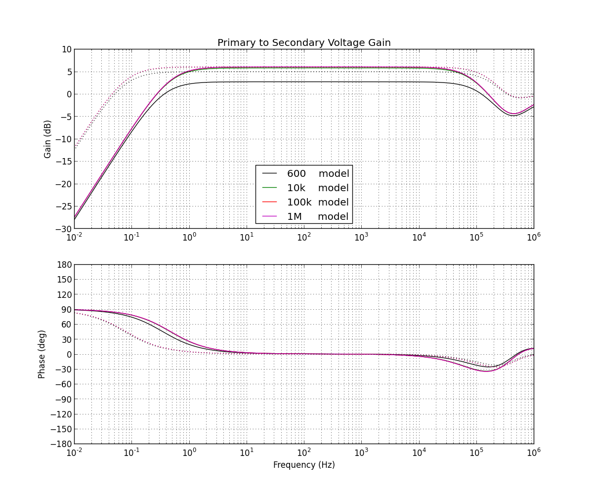

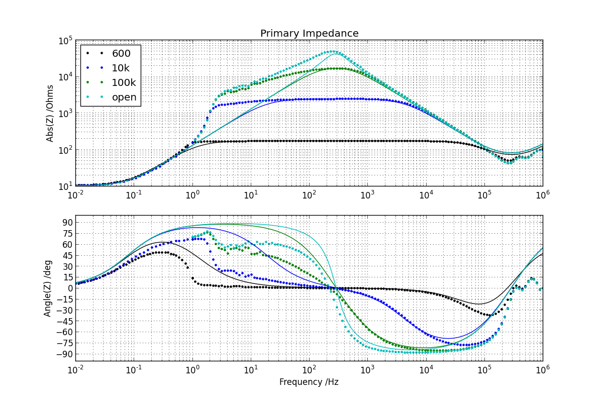

What I tried to show with the data-plots is the following
First plot: The measured frequency response of the impedance across the terminals of the primary coil for different load resistors (600R, 10k, 100k and inf.=open) across the terminals of the secondary coil. The transformer was operated in a 1:2 step up configuration. So the load resistor is mirrored back from the secondary coil to the primary coil by a factor of 1/2^2 = 1/4. (The dotted lines represent the measurement points, solid lines represent related response of the derived lumped model)
Second plot: The measured primary to secondary voltage gain frequency responses for different load resistances with a source with 0 Ohms output impedance.
Third plot: The modeled primary to secondary voltage gain frequency responses for different load resistances for the case of a 50 Ohms source output impedance ( solid lines) is compared with the gains in the case of an ideal voltage source, meaning zero output impedance. What you see that te bandwidth is narrowed down significantly as the source impedance increases.
Regarding the idea of combining a transformer with the Sabre DAC. Honestly I do not understand what the transformer should do for you. An ideal transformer transforms voltages to voltages and currents to currents according to the turns ratio. And accordingly it mirrors impedances from primary to secondary and vice versa by the turns ration squared. So a transformer will never work as an I-V converter for you. Furthermore, due to the coil resistances (10Ohms in the case of the JT-123-BMCF) it could never serve as a low resistance virtual GND.
