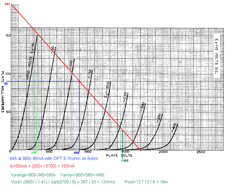

Yes, with the 900V and 90mA at 11.4Vrms we are near to the limit of the output characteristics of 845, near to A2 class operation with higher distortion level.
In the future I will make other test at 1100V and 70mA

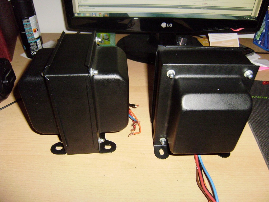

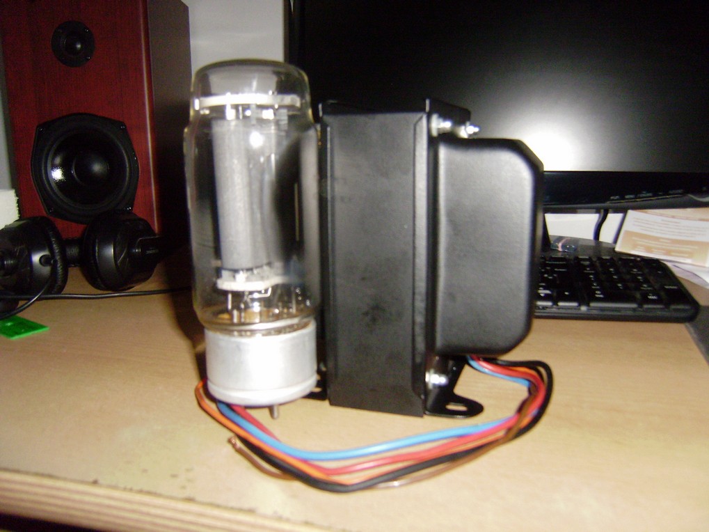

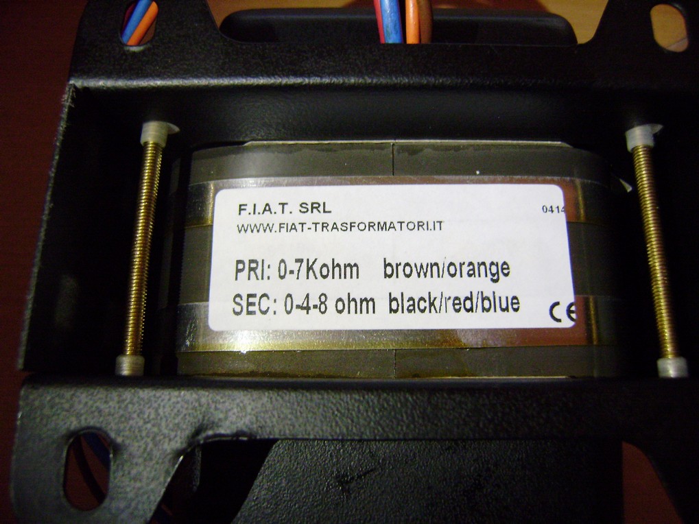

After about one month from my payment I have received a pair of SE transformers for my GM-70 tube amplifier.
Double C core, 0.1mm laminated. I saw pictures from AudioDesign (0.35mm laminated), but my transformers are not 'bare'. I did not ask for special aesthetics, but they really surprised me. I do recommend Fiat SRL to everyone.
Just for the record, I do not have any type of benefit for recommending this company. Just another happy customer.
P.S. I think that picture can't describe how big and heavy they are 😀

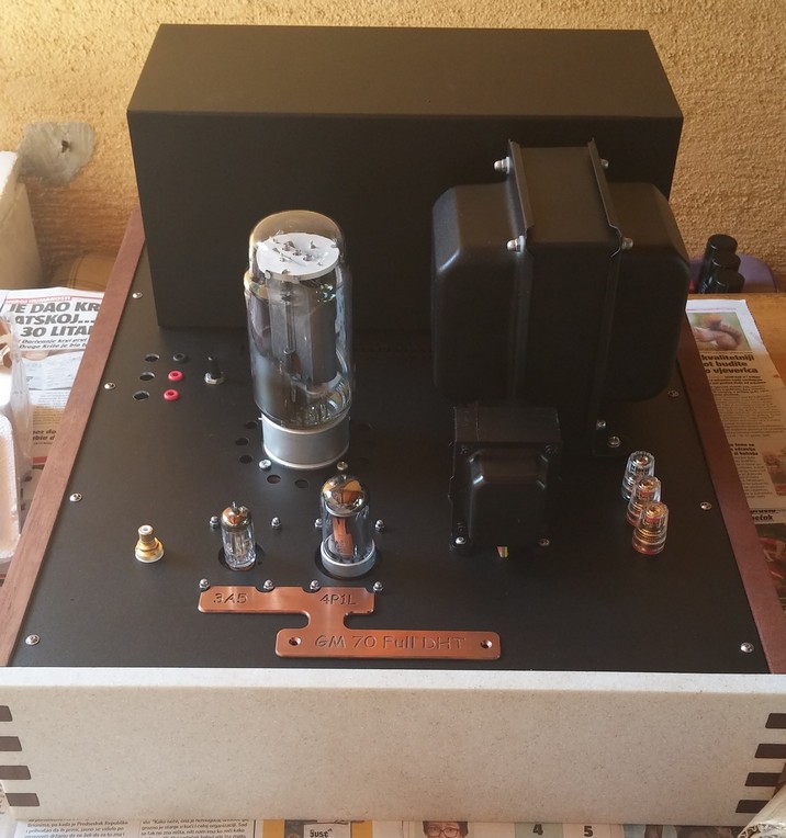

Amps are finished and working very very good! I'm very happy with the end result.
Full size pictures:
Input tube is 3A5 (DCC90, sections in parallel)-->4P1L(triode)-->interstage-->GM-70 (1100V 90mA)-->Fiat transformer (double C core, 0.1mm laminations)
Once again I highly recommend Fiat transformers.
