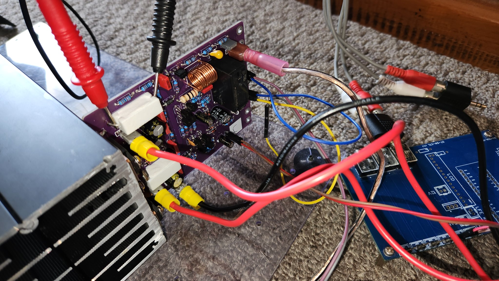

Sorry for yet another post but found this one a rather interesting scenario. But I was running this amp for an hour or 2, ran amazing without an issue until the short circuit detection kicked in. I turned off the amp and found a immediate drain of the caps. I turn the amp on after a bit, everything back to normal. Short circuit kicks in again this time the power supply was completely shorted considering the nice screeching sound before shutting off itself. The weird thing was only Q16/Q17 where the only devices damaged which is most likely an indication that the bias current somehow spiked to critical levels. The VBE servo and the power darlingtons where thermally coupled to a large aluminium heatsink.
Changes I have made:
Changed the VAS and CCS transistors for the output stage from KSA992/KSC1845 to 2SA1201/2SC2911 in case the VAS and CCS where getting hot considering they are only small BJTs with 6mA going through them
I tested the removed VAS and CCS transistors and they appear to still be transistors and not a resistor, diode, or jumper.

Remote troubleshooting can be difficult but I have a few observations/suggestions. RV1 is wired so that the lidle current should greatly decrease if the wiper goes resistive, so that probably is not the problem.
The output-protection circuitry protects the speakers but not the amplifier. Q14/Q15 and their associated circuitry are there to protect the output transistors -- but they didn't. I also note that the -3dB points of R21/C10 and R22/C11 are about 3.3KHz. That suggests something, in terms of the "screeching" sound you heard -- the transistors could be triggering on and off due an oscillation condition, but the circuit as shown looks reasonable in terms of stability. Therefore there's a fault or situation that is NOT on the schematic I would take a look at C4 to see if it's open or if one of its connections has gone resistive. A cold solder perhaps?
I'm puzzled by the presence of D1 and D2. If the output offset voltage exceeds their turn-on voltage, the amplifier basically goes open-loop. Wouldn't that be a bad thing??

The emitter/base/collector connections on Q12 also are suspect, along with R13/14. Is Q12 board-mounted or connected via wires?

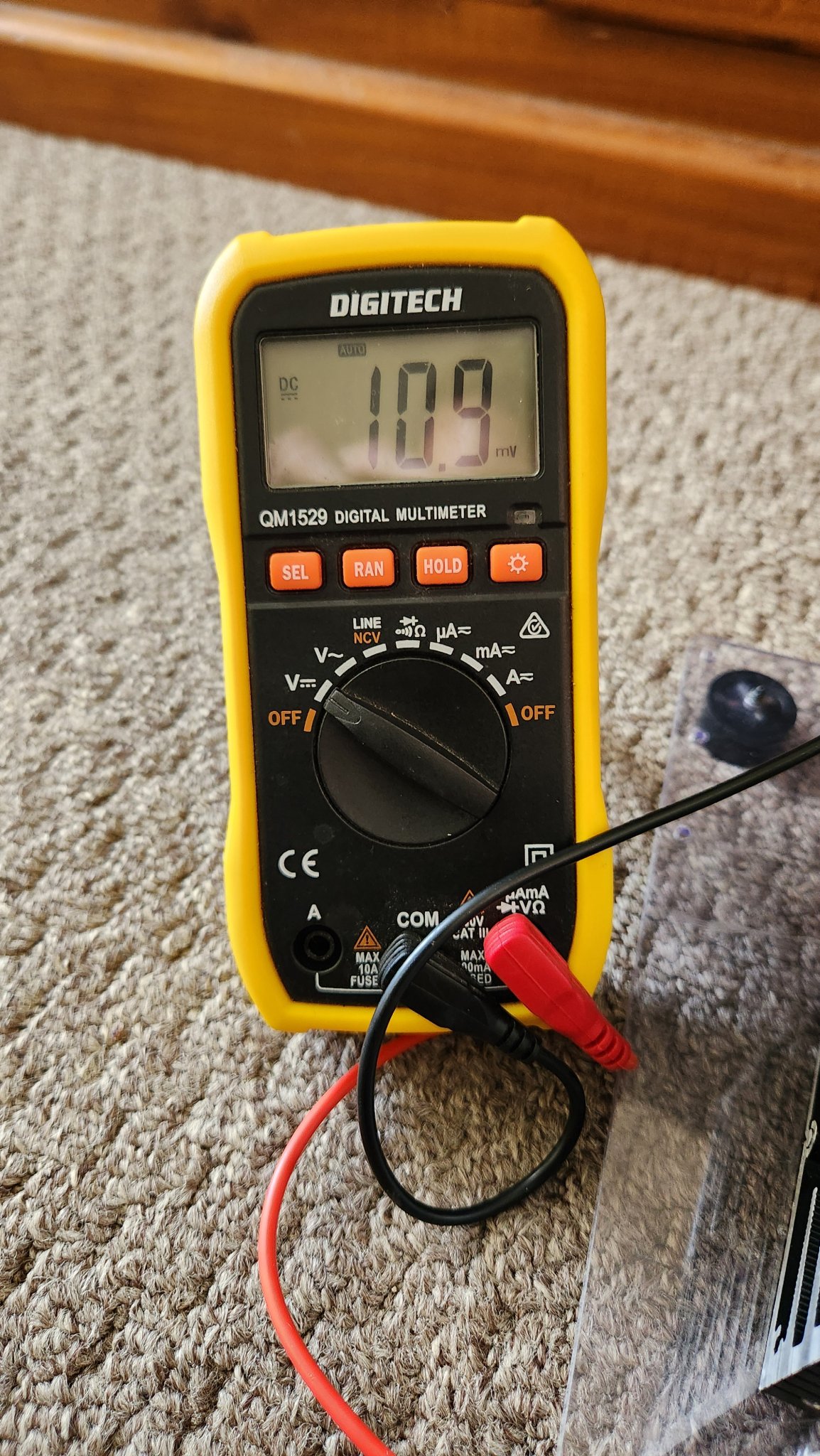

Ive just performed some tests and found some rather interesting results.
So I ran the amp with the bias very low and the amp seemed fine, obviously there would be +100% crossover distortion but the amp stayed at a constant 1.2mV drop across the emitter resistor. The VAS and CCS even stayed cool. Its when I apply bias that the issue arrises. The system even with a bit of bias climbs and eventually turns into chernobyl. I will record a couple of videos but it was rather interesting. So it makes me wonder what kind of oscillation is present or if I screwed something up in the VAS stage.

Normally fast changing bias indicates bad thermals. Maybe this has something to do with it. Now to fix the VAS heating. Censored Profanity
It's not unusual for a solution to one problem to cause a problem in a different scenario. In the case where the diodes turn on to prevent damage to the capacitors, the speaker could suffer. What priority should the designer consider???Self puts those diodes (some times two in series in each direction) across the feedback cap to prevent damage to it in fault conditions. That's because he uses a low voltage polar cap as it usually sees negligible DC and AC voltage across it. Personally I always use / replace it with a bipolar Nichicon Muse ES rated to at least rail voltage. Bulkier and more expensive but more elegant, I think.
Yes you need to fix that problem, the output transistor(s?) need to be well-coupled to the heat sink and Q12. Good catch there.

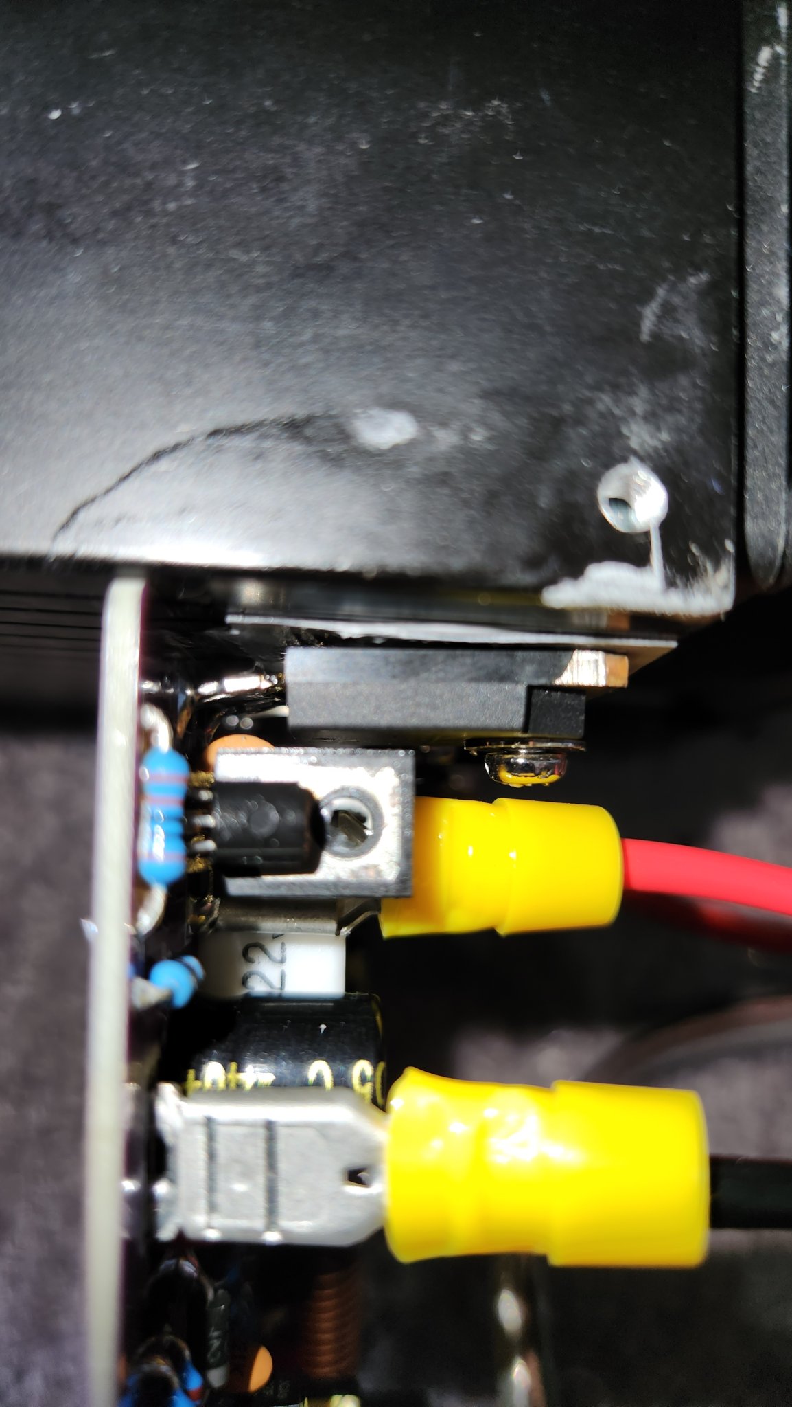

The amp still goes thermal runaway I'll have to get mica pads and see if i can better mount the transistors, or make up some copper plates as a heatspreader
You just about have to have a thermal-resistance problem between your transistors and heat sink. If you drilled/tapped the mounting holes in the HS perhaps you didn't go deep enough so you can't properly secure one or more of your transistors to the HS. To make it easier to get them started, taps have a taper on their end so in the case of a blind hole (it's not through-drilled) the threads near the bottom aren't completely formed-- which might prevent the screw(s) from going down far enough There's a type of tap called a "bottoming tap" with an almost nonexistent taper that can address that. They're used after the one with the long taper is used. They may not be commonly-available for smaller taps. I've seen them for Imperial threads but don't recall seeing them for metric threads....but they just about HAVE to be available somewhere. If all else fails, grinding a long-taper tap's end down will get you one.....but don't totally get rid of that taper or it may be impossible to get the tap properly started into the hole.The amp still goes thermal runaway I'll have to get mica pads and see if i can better mount the transistors, or make up some copper plates as a heatspreader
If the hole is thru-drilled, you still could have a problem with the threads if you didn't run the tap down far enough. I have done that to myself. There are numerous ways to shoot yourself in the foot here.

Another possible issue is the thermal lag between the output transistors and Q12. If Q12 is too far away, thermally speaking, the relatively-long delay plus an attendant temperature gradient might be a problem. It's not clear how different your bench test setup and final packaging system are. Perhaps worth thinking about.
