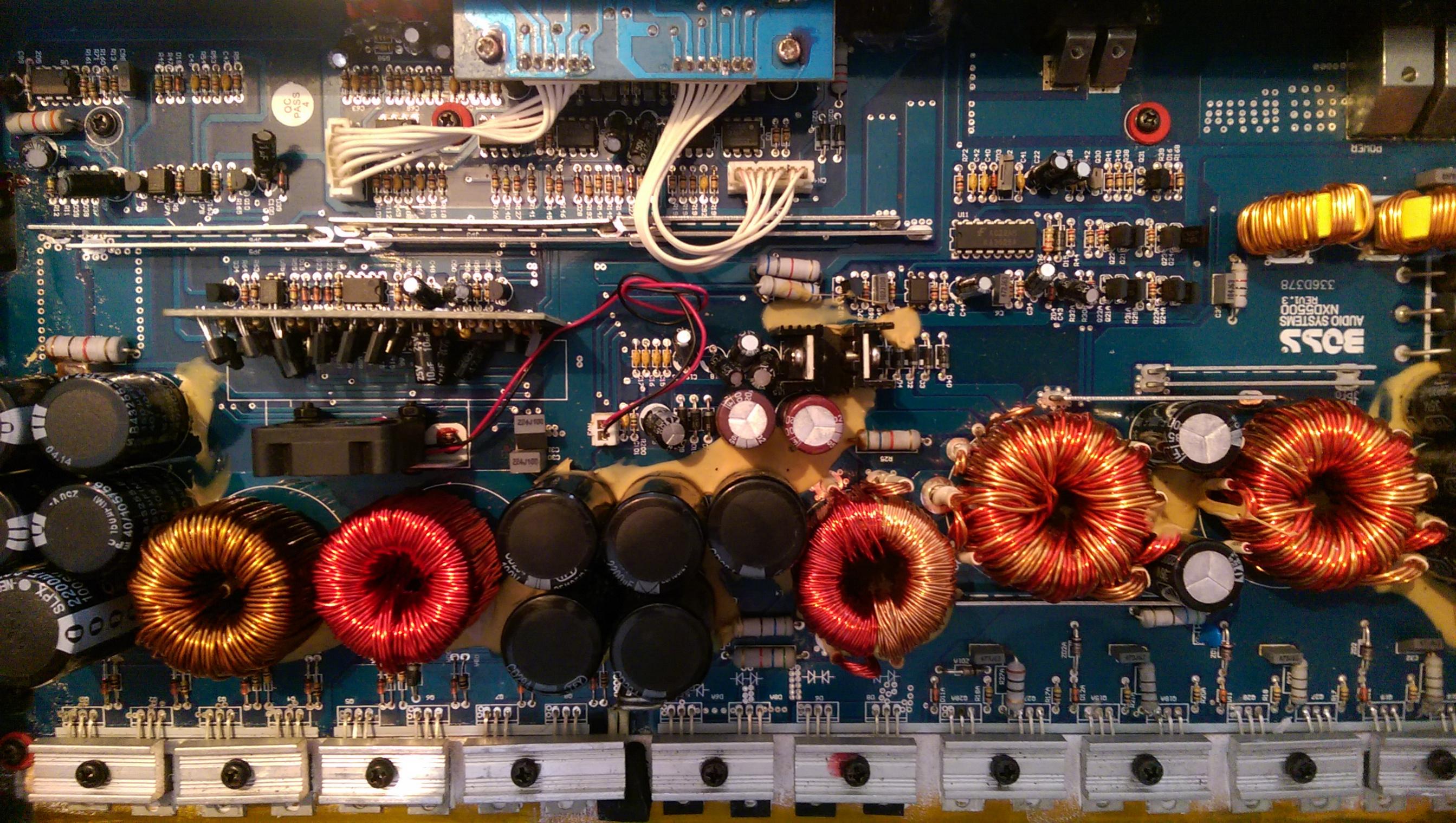

What causes an output inductor to run very hot?
Could be HF oscillation. Is it air core, or wound on a resistor?
It's wound on a double stacked torrid. I had to rewind this one. It had burned and cooked the output caps, too. What's funny is that only one runs hot. The other doesn't.
It's a Boss Audio NXD5500. I'm out of the house for a bit, today. I will post a picture when I get back.

Perry, I had a feeling that about the core being damaged. The one I wound was shorted and had been hot to begin with. The other showed no signs and even now, runs cool. But it did blow the caps, too. I'm thinking I need 2 cores and some more wire. Just start from scratch with both. I will check the voltage swing first.
Andrew, they are inductors. Lower left in the picture.

Either the core is damaged/wrong one or the wire you used is too resistive.
I had trouble when I designed my first class d amp and used the wrong inductor core.
The core reached 120 degrees C !
Changed the core to t106-2 and it barely gets warm now.

I checked the r-r swing. I do have half the voltage at the point that they meet. Nice clean square wave. Going into the first, I have the same pattern and voltage as at the FETs. Half that at the second inductor. Leaving the second inductor, I get a distorted triangle wave. It stays the same through the caps and to the positive speaker post. But it plays well with no audible distortion.
A slight residual carrier waveform can be expected at high sensitivity settings. If you don't see the triangle waveform at 5v/div, it's likely OK.
