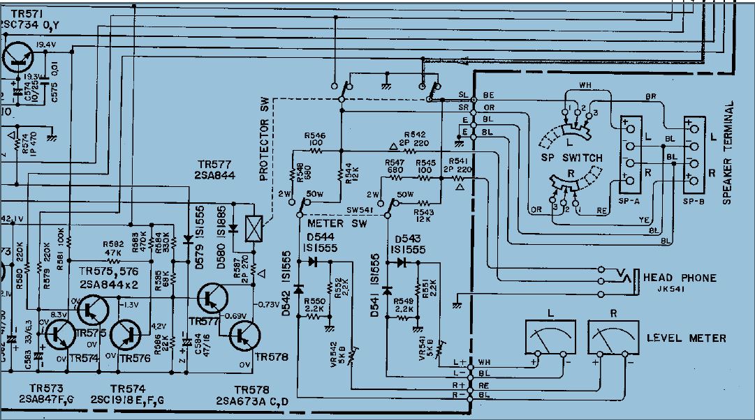

I am trying to understand the components in the Yamaha CA610II circuit diagram attached and how they affect the headphone output impedance
My goal is to insert a switch to change the output impedance depending on the headphone I am using.
I’d also like to know how to calculate the output impedance from the headphone out from the circuit diagram!

It will be about 220 ohms. This is because a 220ohms resistor is placed in series with the output from the speaker o/p point, and that has presumably a very low output impedance.
To change it just change the pair of 220 resistors R541/542.

A dedicated headphone amp would have a low impedance output and so not allow variations in headphone driver impedance to affect the response and damping. The resistor method is the time honoured (cheap) way of doing it. You could use lower value resistors (calculate the wattage needed) and use a switchable shunt resistor to alter level. That would lower impedance considerably.

Thanks mooly. How do I calculate the wattage needed for lower value resistor?
Take the wattage of the amp, say 50 watt rms and calculate the worst case scenario.
50 wrms is 20 volts rms (assuming an 8 ohm specified amp) and as W=V squared/R so then V = squareroot of 8 * 50.
Take your lower resistor value, say 100 ohm and calculate the total current with no headphone attached (that's the worst case) which is R=220 + 100 giving 330 ohms total. I =V/R which is 20/330 and so the current is 0.06 amps.
W=I squared times R and so the resistor needs to be able to handle 0.36 watt rms.
That's worst case for a 50 wrms amp delivering a voltage of 20 volts rms to the resistor network. So in practice a 0.5 or watt would be fine.

If you want a lower impedance using your power amp, and given that the 220R gives the right volume, I would....
Measure or find out from the headphone spec what it's impedance is.
Use a 1 watt resistor (x2 for L&R of course) in parallel with the headphones of roughly half that value.
Have a series resistor of adequate wattage that gives a good volume setting similar to the standard 220R's volume. Probably 50R or so so you'll need a 10w power resistor.
This way your headphones will see an effective output impedance of the 2 resistors in parallel (even though they're not physically in parallel) and will be low enough to give some electrical damping that you don't get with 220R. If it sounds better then it was worth doing.
