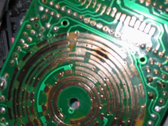

I've installed a new bridge and still no DC coming out. I get 440v AC in my multimeter. How this can happen? I'm lost, my multimeter works well in other readings. What the hell is going on?
How a 230v trafo can give 440v AC after rectifying is a complete mistery to me.
You may have fried your multimeter. I killed one with 700VAC once, it gave very strange readings.
Take the amp to a tech.
yeah i suspected the multimeter went wrong. I've done some testing to find out it doesn't read DC anymore, now all is AC. Having said that, my problems are not resolved. Now i have 440 v
DC where it should be 280v. Volts readings are ok. It reads my house 230v accurately and i tried with a dc transformer that i got and it reads 12v well but instead of dc gives ac which is what is wrong with my multimeter.
So give the high voltage ? It is a 230v trafo.
