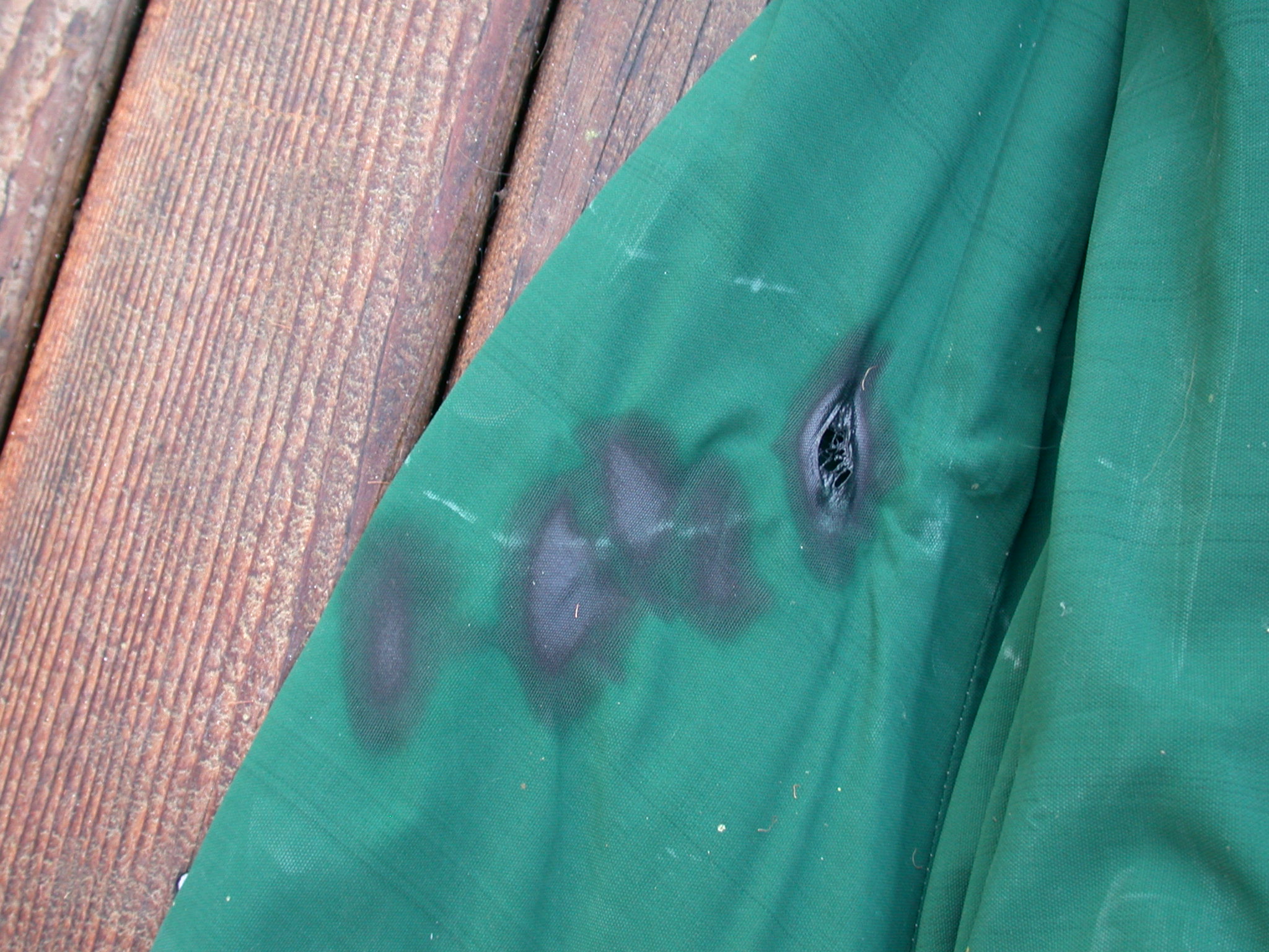

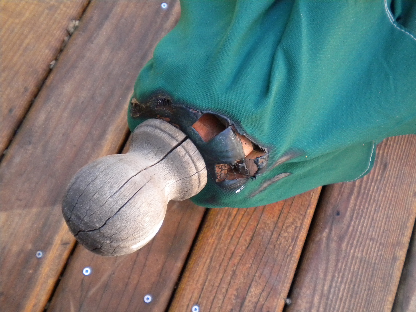

As bizarre as this is going to sound....After eating lunch, we noticed that the patio umbrella on our deck was smoldering!😱
Apparently during the storms of the past couple of weeks one of our window screens blew off and the low-angle winter sun was reflecting off of the low E window coating and onto the umbrella causing it to spontaneously combust.
That's our best guess.....If anyone has another explanation please post.
We hurriedly took it down, put it in the shade and snapped the pics.
Scary stuff, as we live in an extreme fire hazard area and our deck and house are both slathered with linseed oil.

Did you consider the possibility of spontaneous combustion caused by fresh linseed oil fumes trapped under (and in) a hot umbrella canopy? Did you apply linseed oil to the wooden umbrella frame?
Just a wild idea...

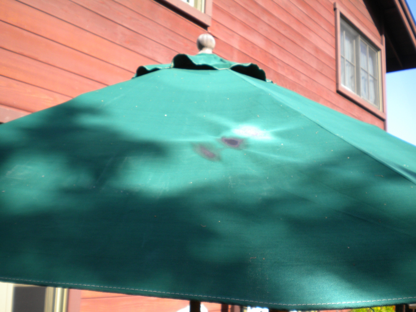

The linseed oil isn't that fresh. We re-stained the deck several months ago and the house hasn't been stained in a few years.
The umbrella was down since the storms, my girlfriend put it up yesterday morning and noticed the smoldering right after lunch. We have pretty much confirmed that it was the sun reflecting off of the window, see pics. The first pic is seconds before we took it down, note the burned spots and the concentrated sun spot. I took the second pic this morning, and you can see the additional burn mark from the above sun spot.
I'm still puzzled why there are burn "spots" and not a track based on the suns position. Our best guess on that is that the sun was shining through tree branches behind the house.
Needless to say, the screen is getting back on the window today.

What fascinates me is that the "flat" window glass focused the light. How did that happen? Must not be as flat as it should be.
While the glass was manufactured flat, once it is installed in a double paned insulating unit, the difference in air pressure created during manufacture causes the thin glass to be bowed inward a bit, creating a concave lens effect. All of my windows are this way and I can see the lensing effect by looking at the reflection. The sun is often focused to a point on the lawn at times😱

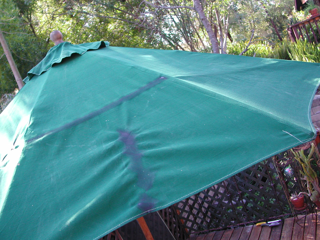

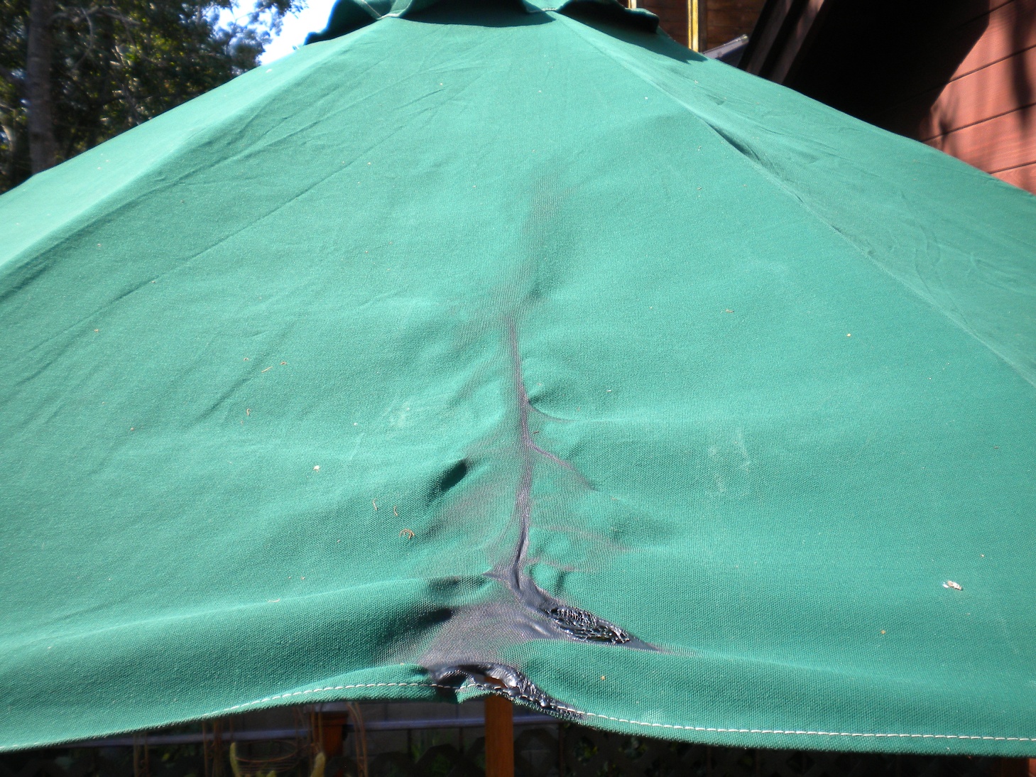

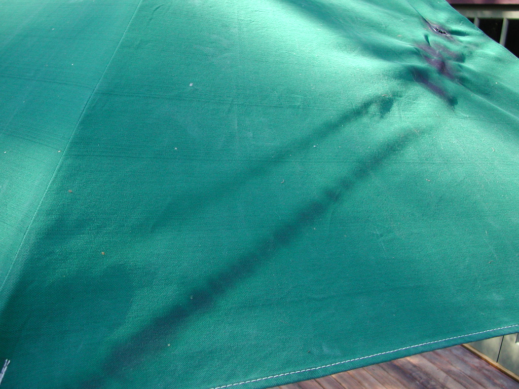

Well, strangely enough, even after we put the screen back on the window, we had some more straight scorch marks on the umbrella today. This is one sort of long straight line across several panels of the umbrella.....from what I have no idea. At this point I don't think I'm interested in finding out....even in the name of science.
It was hot & sunny again today, hotter than yesterday.
I took it down today and it's staying down.
