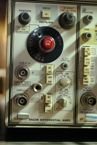

when you measure regulator or power supply noise you should bandwidth limit taking the measurement over time -- this is one reason I hang onto an ancient Tektronix D13 storage scope, with a bandwidth adjustable differential amplifier -- (5A22N)
of course, which bandwidth ? -- Texas Instruments uses a 10 second sample from 100 milliHz to 10 Hz, Linear Tech uses 10Hz to 100kHz !
(I use 10Hz to 100kHz).
Here's the setup which Linear Tech uses -- (fwiw I use an "OREO" cookie tin, but the folks in California prefer Danish butter cookies):
probing is important too -- using the ground clip of your scope probe is out of the question when you are measuring in the low microvolts . take a look at Linear Tech's Application Note 83 for more hints.
occasionally you can find very good noise measurement amplifiers on EBay -- there is an outboard differential amplifier from Tektronix, the ADA400A which will work with their last line of analog scopes (like the 2465). I was going to have some circuit boards cut for a noise measurement amplifier which would fit into the HP465A chasis -- haven't gotten around to it yet although the prototype works very nicely. This setup uses the SSM2019 -- a very low noise differential amplifier from Analog. I need someone to motivate me to have the boards done.
