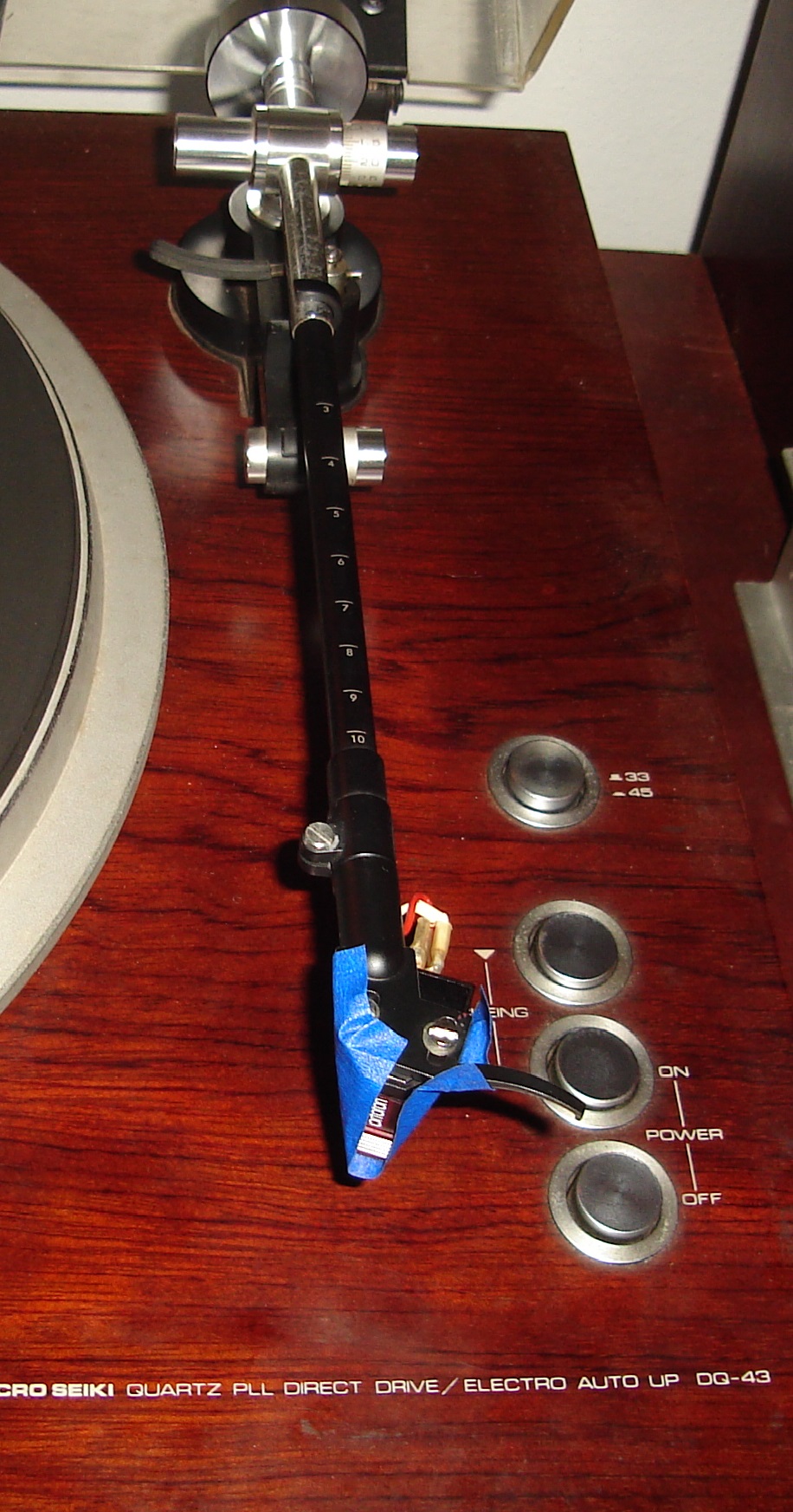

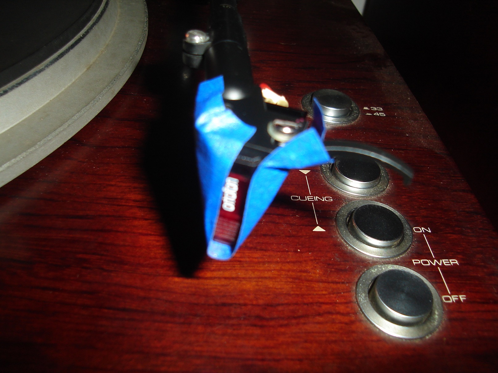

I want to alert the Diy community about what happened to this product and I would like to know what they think.
I bought a capsule Ortofon 2M Red in Needle Doctor via E-Comerce and when it came time to install it, there were two problems. These inconveniences of the once famous brand have already been reported in other forums ... It is the first and last capsule that I will use from this factory, I already changed my mind ..
1) The needle protector (guard) is not held in place, it falls off! It is totally inoperative.
2) The needle, regulated with the vertical pressure of work indicated, is dangerously close to the vinyl, and as I could see by looking at photos of it on the official page, in the capsule that I have received the needle remains at a height lower than the one that should.
Reading in other forums. I see that my problem is quite common.
Other users have reported similar problems, even in higher models. With respect to the height, it seems that the cantilever moves forward or backward, by a poor fixation of it. This fixation consists of a mini plastic clamp that does not exert enough pressure to hold the rod in its optimum pre-calculated / calculated place.
If we clean the needle with the proper procedure, using the back brush forward, several users have reported up to the cantilever detachment! In my particular case, that did not work, so I had to apply additional pressure acting on the back of it. Now it is in its right place. But I do not know for how long it will be, when I clean the diamond with the brush repeatedly, I have the feeling that your anger is moving forward. This time increasing the height beyond the ideal! .
Why does this happen ?
Are you sending third countries to assemble this capsule?
Therefore, there is no quality control in the models that are assembled outside of Denmark?
If someone from this forum asks me, I will attach pictures and explanatory photos with pleasure !

Hi
I've been using Ortofon cartridges (OMB series, 2M series) for 20 years with no problem.
Today I'm using a 2M Blue with a TEAC 550 turn-table. It works perfect with 2g of tracking force.
The bottom of the cartridge isn't close to the disc.
The needle protector holds in place and I can clean the needle according to the procedure.
I think there is an abnormal big defect with yours with unknown origin. You have to contact your retailer.

Boys ....
I do not think it's an imitation, but the quality of this product leaves much to be desired. I will put here several comments from users with problems.
Start with this, the connection pins are not firmly attached to the plastic body. (and I noticed something of that, it seems that the plastic of the body is not firm, they moved axially!) When you push the plugs of the cables, they slide in! Oh my God ! I have been a user for more than 40 years of cartridges of all kinds, and installed many in the store where I worked, including Ortofón. What this user relates never happened to me with any cartridge. This in addition to unprecedented is a scam. There are no excuses from the manufacturer.

Other :
Here is the cantilever problem that is displaced by poor fixation. It has to be at the right position , point !
If it is too far out, little signal, if it is very deep, good signal, (but perhaps excessive signal causes distortion) will play on the vinyl at the least irregularity of the same. ,
Ortofon applied a drop of glue on the cantilever fixing on some models to solve this problem ..... brilliant solution ! 😱

There is a third problem that I did not mention: The extraction of the needle to assemble the cartridge is an adventure for few.
I'm talking about the model with bolts and nuts. If you do not remove the protector, you can not put the screws. Ok? That says Ortofón in the instructions and it is clear. Well, look at this sentence :

I don't understand !
You don't need to remove the protector to screw the cartridge on the shell.
But you should use the shortest ones provided in the package.
The protector is hold in place with a little clip at the back end. May be yours is broken.
The needle assembly is easy to remove : you have to apply a little force mainly horizontaly (exactly in the same direction as the cantiliver).
The design made by Ortofon works perfectly.
Obviously yours is broken or it is a fake.
