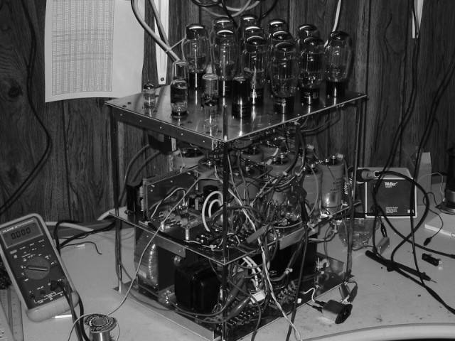

Recently constructed OTL amp from Glass Audio magazine and have some problems with it. I use 6 (6AS7) per channel and everything else is the same as published in the magazine. Amp is working fine with 4 ohm and 8 ohm load but very unstable with 16 ohm load. Very unstable means dc fluctuation on the output aprox. 1 Hz rate .I am seeing that on 8 ohm load too but on higher power output.
Any help will be appreciated.
Thanks.
P.S. Here some pics. from construction

Sounds like motorboating to me. It's usually caused by coupling through the power supply. The reason it only shows up on a 16 Ohm load is that the 16 Ohm load doesn't load the amplifier as heavily, so it has a little more gain, and if its stability is marginal, that's enough to start oscillation.
There are two ways of curing motorboating:
You attack the symptoms and reduce the audio coupling capacitors to half or a quarter their original value.
You attack the problem and regulate the HT to the driver stages.
By the way, I couldn't see a connection from the earth pin of the mains IEC to the chassis of the amplifier...

DC offset is less then 100mV on 4 and 8 ohm load.
DC fluctuation on 16 ohm load is +/- 5v or more.
Picture shows construction detail. Amp is ready and all grounds are connected.
Yesterday I spoke with Mr. Rozenblit who designs this amp and looks like this is normal for this amp.
I tried to lower feedback and that help a lot but hum level rises up to unacceptable level. Seems to me that I need regulated +/- 150 V supply.

Hi.
I don’t think this problem is related to tube microphony. I run tests with resistive load.
In my opinion I think that ground is OK.I use star configuration. Center point is on filter capacitors (8x1100uFD/200v) see pictures.
Coupling caps are: C3 3mFd instead 2.2uF and C4/C5 0.2uF instead 0.1uF.

You might try going to the exact values in the original schematic. When you have that many caps within a global feedback loop, you have to stagger their respective time constants to avoid the risk of motorboating which will get worse with increasing open loop gain especially under light reactive load. This will occur because the open loop low frequency phase shift under these conditions may reach 180 degrees at some low frequency where there is still feedback reduced open loop gain causing low frequency oscillation.
