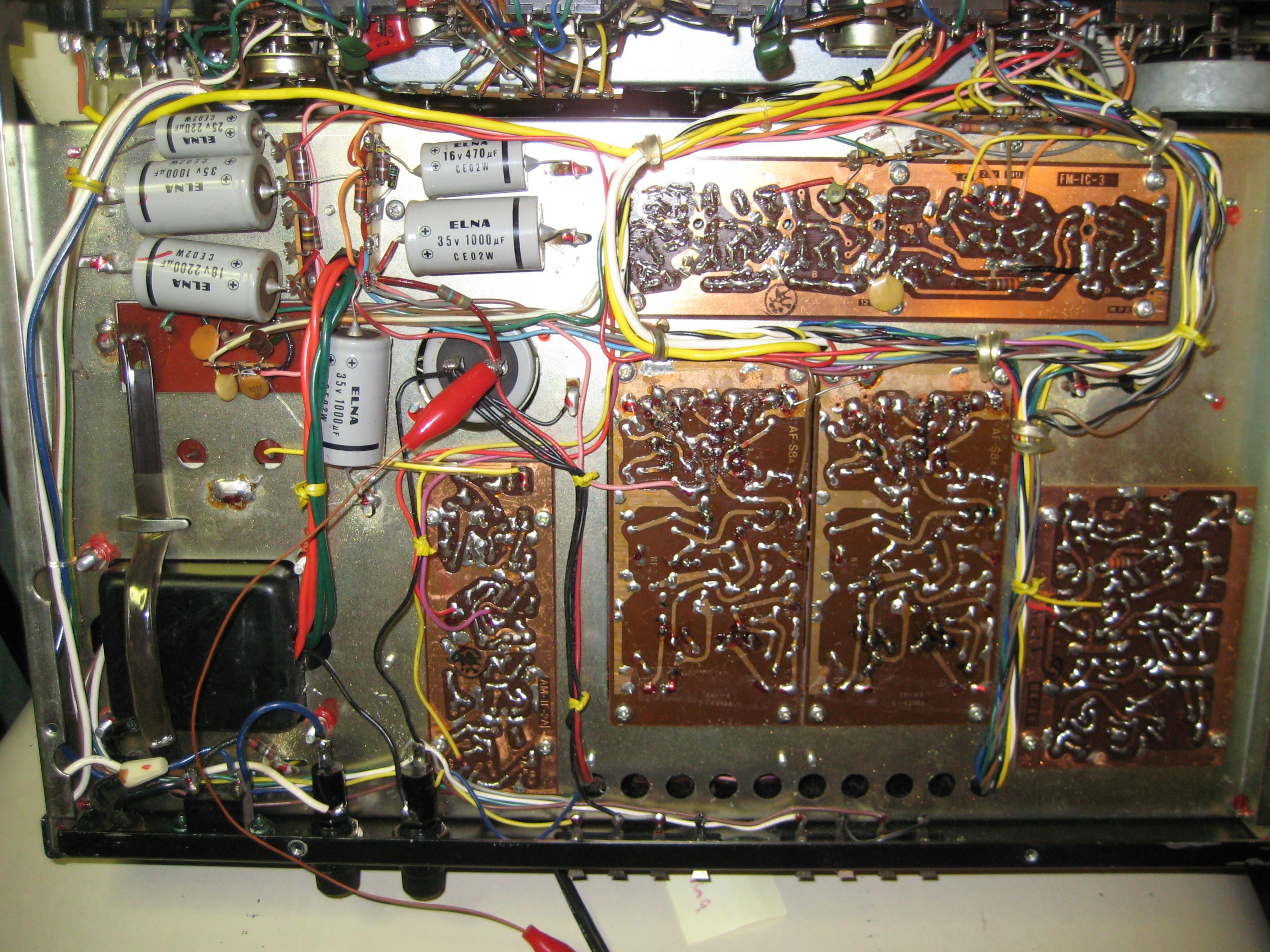

I am not posting about a very desirable piece of gear, just a recently acquired, old, inexpensive, late 1960's receiver made by Rolland Electronics and branded Rolecor. Probably 12 to 15 watts per channel.
The first thing I did was test the DC offset at the speaker terminals and got nearly 1 volt one each side.
Although my ability to read schematics is minimal, I did spend a fair bit of time looking online for one but without success. No technical info at all actually.
I managed to determine what I thought were the differential pairs on the amplifier boards and substituted newer ones plus replaced all electrolytic capacitors on those boards. This managed to reduce DC offset down to about 0.5 volts.
I started removing and checking (DMM on diode setting) other transistors on the board. There was a pair of TO39's of which one was bad. I replaced those pairs with a complimentary pair of pairs of TO126 transistors which I was told would make a satisfactory replacement. Pinout pattern accounted for.
Still no reduction of DC offset below 0.5 volts.
Have now checked all other TO92 transistors present which tested OK. There are some of what I believe to be Germanium transistors (TO1?) that I have not yet removed and checked.
Can anyone sort of steer me in right direction by advising what other causes might produce DC offset of 0.5 volts and how I can get it down to a more acceptable level?
My limited experience tells me this is simple receiver based on how much "open space" there is inside. It is not crowded to the point of anything being inaccessible or even inconvenient to get at.

As its a simple amp then maybe there is no trim pot to set the DC offset ?
I found quasi amps to be worst for DC offsets. My own designs always have a trim pot in the current mirror or in the LTP to adjust DC offset.

There is such a single large capacitor. I thought it was odd for it to only have two terminals as the only other single large cap I've seen on a stereo chassis was inside a friend's large Marantz receiver but it was a dual layer.
The value of said cap is 63V 2200uF. The local shop I go to has a 100V 2200uF on their website but out of stock. Another shop also has one listed on their website but it's farther afield and more expensive.
If local is a no go, I'll get one sent from one of the usual online vendors. That's always my Plan B as it involves a 100KM round trip to avoid the extra time and expense of international shipping and the Canadian duty charged if shipped across the border.

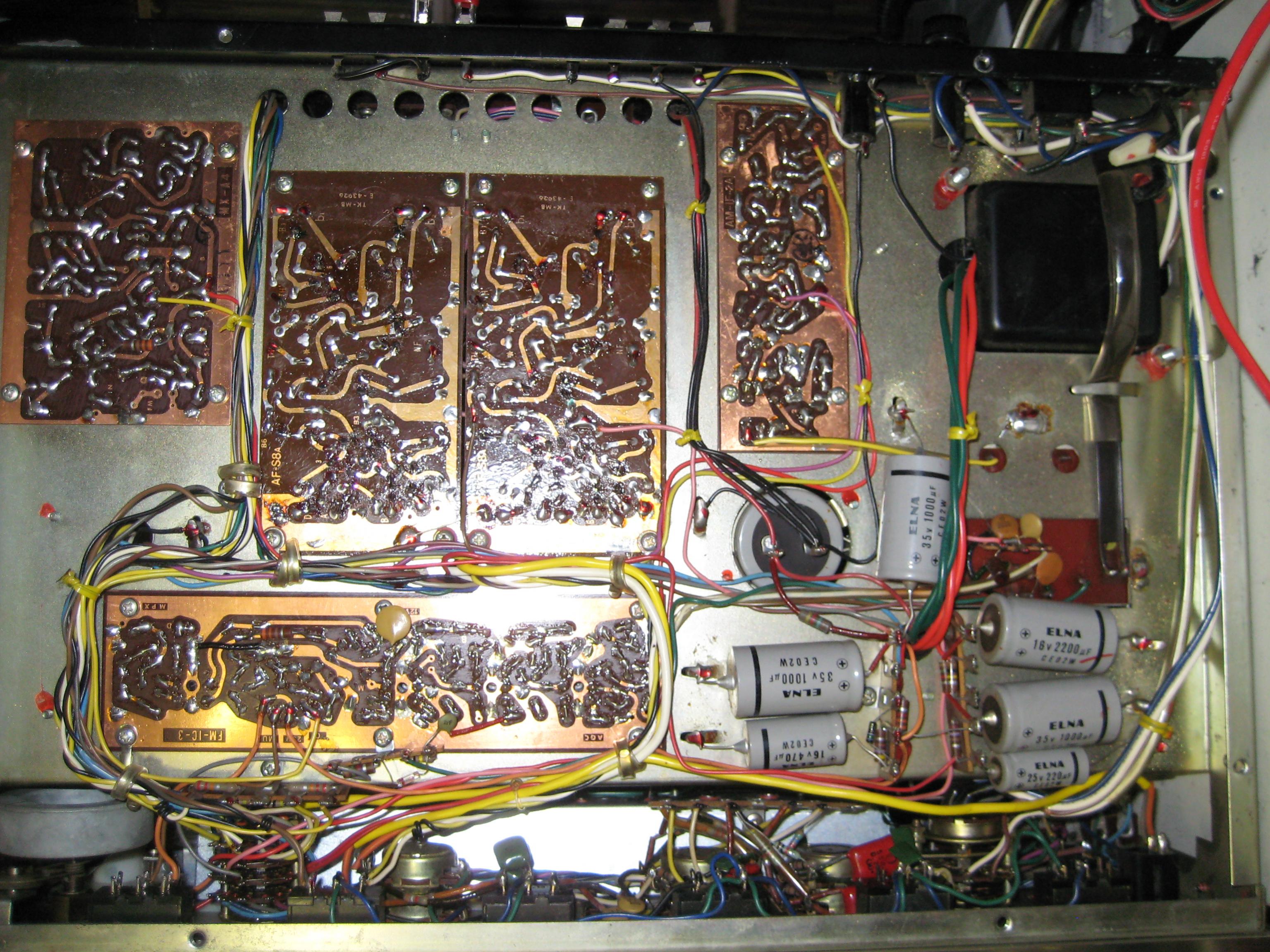

I was somewhat less than diligent over the last couple of days. When first obtained, the receiver exhibited nearly 1V DC offset on each channel. After installing what electrolytics I did replace, DC offset went to 0.5V each channel.
But I got lazy. Since Both were more or less symmetrical, I expected them to stay that way so only bothered checking one side. After replacing the original TO39 pairs (2SA & 2SC497) with TO126 pairs (KSA1220 & KSC2690) I saw no change to DC offset in the channel i was monitoring but the other, I learned yesterday, was 11V and I'm unsure as to why this would be.
And apologies for the filth. A brush 'n' blow was going to be my final act.

That amplifier has one main power cap (lots of little ones) and two Output caps (which appear to be new).
With NO load, there WILL be "DC" at the speaker terminals. There is a large thump at power-up. With speaker, the output cap will charge-up and the output DC voltage fall exponentially to zero. With no load at all, the output cap has no charge path and the speaker terminal will sit at half-supply "forever". This amp has 1.5K resistors from cap to ground which will tend to zero but very slowly. And if those caps leak, never quite zero. In fact a 1,000uFd cap is likely to leak near 1mA, which in 1.5K would be 1.5V, so "nearly 1V" is on the good side.
Put a 10-100 Ohm resistor on the speaker terminal. Power up, wait. If it goes down and down to below 1V, I would forget about it.
I would be more concerned that the *other* side of the cap sits near half the supply voltage, a happy amplifier ready to swing either way. If it is a 40V supply, it may sit at 16V or 22V, these old amps were not precision DC machines (also you "center" bias allowing for sag). An unhappy amp will show 2V or 38V or worse.

Good pics and I can only agree with PRR's comments and suggestions.

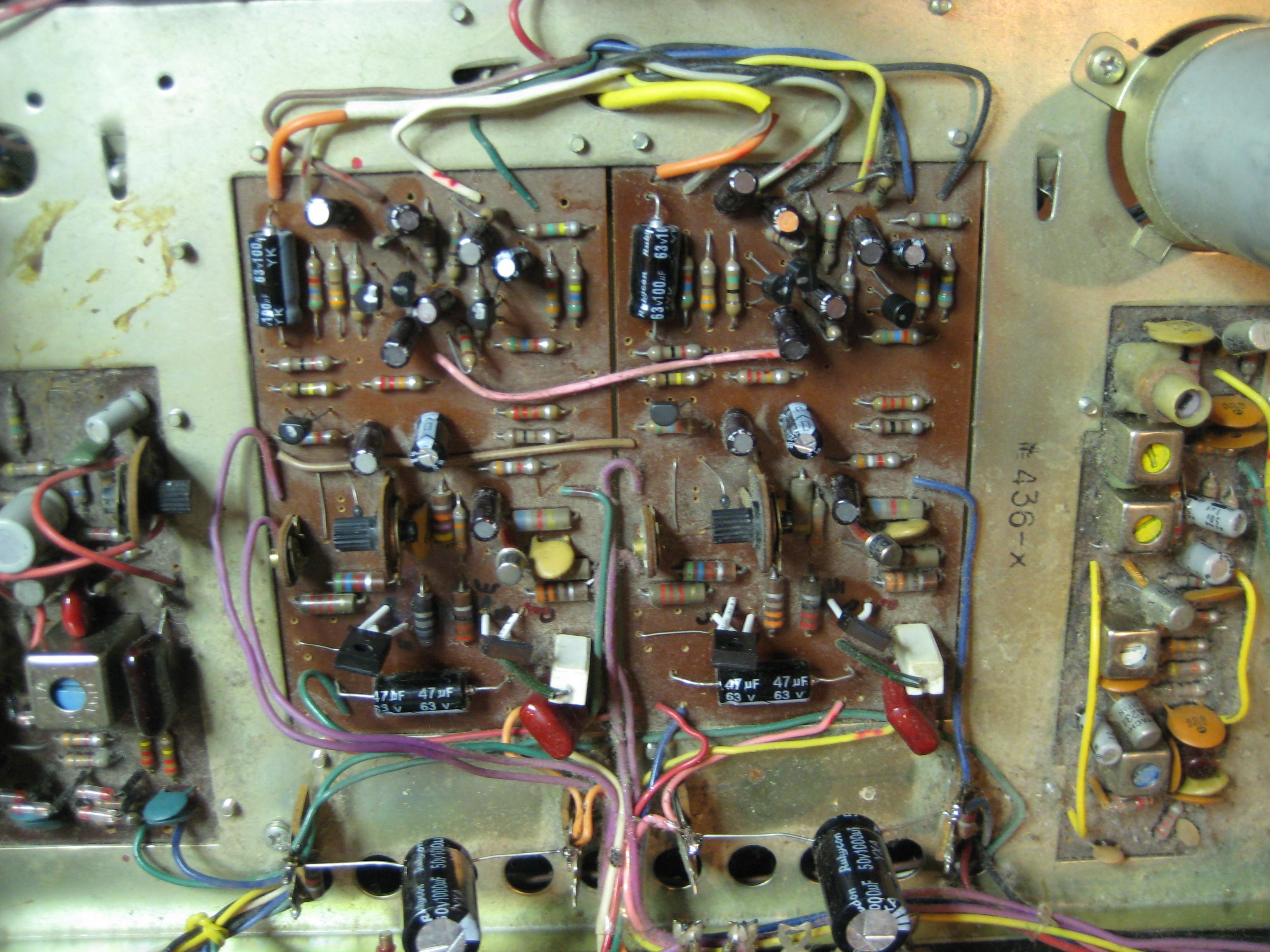

After reading the recent opinions, it seems that there was no problem to start with if 900mV offset was normal. But there is a problem now.
If bridging the +/- speaker terminals with a resistor (I used 5W 47 ohm) was to reduce that number, it did. The left side with 0.5V became about 12mV and the right side with 11V became about 8.5V and that resistor heated up.
So somewhere along the line I goofed. I had to have installed something incorrectly to create such a disparity.
I am very glad I did have a "before" photo of the boards after all that I could refer to because I installed one of those new 1000uF coupling caps backwards.
Since both boards were twins of each other regarding capacitor polarity, I assumed (why oh why do I still do that) that those larger caps would be likewise. But, on examining that photo, I saw right away they were mirror image.
I reversed the "offending" capacitor and with those resistors in place, I now get 12mV DC offset on each side. Without resistors - 0.5 volts.
I feel somewhat elated now that both channels are equal.

Guess the wrongly installed electrolytic was in the channel labelled »1«? Your pics show orange and pink wires coming from the power amp PCBs. These need to be connected to the 'lytics' positive terminals, as in channel 2.
I'd replace at least the erratically reversed capacitor by a new one, it might have become severely damaged or unreliable at least. Better, replace both by axially leaded new ones with a capacity of 2,200 µF, as the LF roll-off for 1,000 µF @ 4 ohms is meagre 40 Hz.
