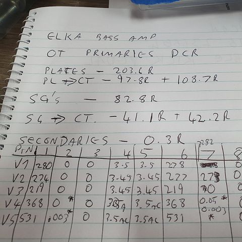

Hi I have an old 60's italian made 50w bass amp on the bench with some issues. Basically there's hardly any sound out of channel 1 and nothing at all out. I have replaced all the electolytics, new valves and some of the audio caps in the preamp section. I tested the OT primaries and they're giving me 98 and 102 ohms but after further checking I've noticed that there are 5 wires for the OT primaries instead of 3. If this OT were blown could I replace it with a standard marshall 50w OT or would it have to have 5? It runs on 2 el34s and 5 preamp tubes.

Yes they are connected to the screens...I have tested for voltage and bias all seem pretty normal around 508v screens, 512v plates, -45v bias and 3.3vac heaters. I'm getting around 100r between the UL windings

You should have More voltage on the Screens than the voltage on the Plates. That is for traditional UL output transformers.
Unless . . .
1. There is a resistor from the UL tap to the screen Or,
2. There is a separate winding for the UL taps, and its center tap is connected to a lower voltage; or a separate UL winding has Much higher DCR.
3. Is it possible someone swapped the plate and screen connections?

I find the pic you provided a bit difficult to read due to "photobucket" logo.
Btw, what kind of preamp tubes ? judging by the heaters wiring i guess ECC83 / ECC81
It seems like all cathodes are at 0V ... are tubes ok?
Yes its an Elka bass amp been looking online for a schematic but can't find anything. Yes there is a resistor between the ul taps and the screen
Yes the tubes are all new... I am getting unstable dc readings on most of preamp pin 2 and 7 lugs....jumping around constantly when I put the multimeter on the mv selection and very low readings when I use the V setting. These unstable readings are signed by an asterisk.
V5 is a 12au7 the other 4 are 12ax7's. Tried installing a new output jack and before soldering the wires on again, I tested the common and 8ohm tap secondary and I'm getting 1.3r
Are preamp tubes "warm" ? Can you see if Heaters are on ?
I don't get how all cathodes are at 0V. It's your meter ok?
Could it be using grid leak for bias?
Appears to be very unusual for bass geetar amplifiers, due to blocking distortion. But only a schematic can tell for sure.
3.3VAC heaters? Shouldnt this be 6.3 for EL34s and either 6.3 or 12.6 for preamp tubes?
Or is this 2x3.3VAC measured on each half of a GND (or bias voltage)?
The still unanswered question is about this: Screen 508V Plate 512V
Why is the screen voltage 4V less than the plate voltage?
Swapping plate and screen connections can do that. And that will give a lot less power out.
Either there are resistors from the UL taps to the screens, Or, There are separate Screen UL windings and Plate windings. (that is a very expensive way to build an output transformer). How many guitar amp manufacturers will pay the extra $$$?
Most UL output transformer windings are essentially electrically connected this way: Plate winding all the way to the UL tap, and then continuing on to the Center tap. Another winding from the Center tap, to the UL tap, and then continuing on to the plate winding. That way, there is more B+ voltage drop from the Center tap to the plate tap, than there is from the Center tap to the UL tap. From the Center tap to the UL tap, has Both the screen current plus the plate current. From the UL tap to the plate tap, there is only the plate current. Ohms law. Does that make sense?
