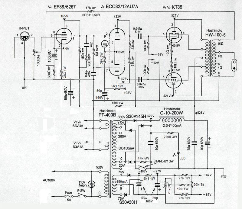

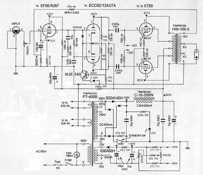

Check the circuit diagramme, where is the rectifier for the 529V DC?
For the anode HT output, assume a full wave bridge rectifier is being used to get the 525 volts. Also, the high heater to cathode voltage on the driver 12AU7 is of concern....hopefully the heater winding is "floating" or biased to some positive voltage to keep the max heater/cathode voltage within spec....
Why don't change the EF86 in pentode to connecting as triode, will have better curves and enough gain, Maybe can reduce the NFB to a few db.
I like the bias pot balance of this schematic to match the two half waves. but how can you check that the match is correct ?
One friend told me if put to iron pin on the OPT when you can not feel any magnet field half waves are matched, but is possible to check without oscilloscope?
between katodes pin 8 of KT88 should measure ZERO 0mV DC at idle but the sense resistor should be 10ohm matcheds perfectly, so TP for each KT88. (some KT 88 have metal base connected to kathode , but not JJ KT88, easy TP all ready available in commercial amps)
first between grd and TP pin 8 you check global bias and then fine tune balance bias between TP , everytime this test should be made to check pp stage

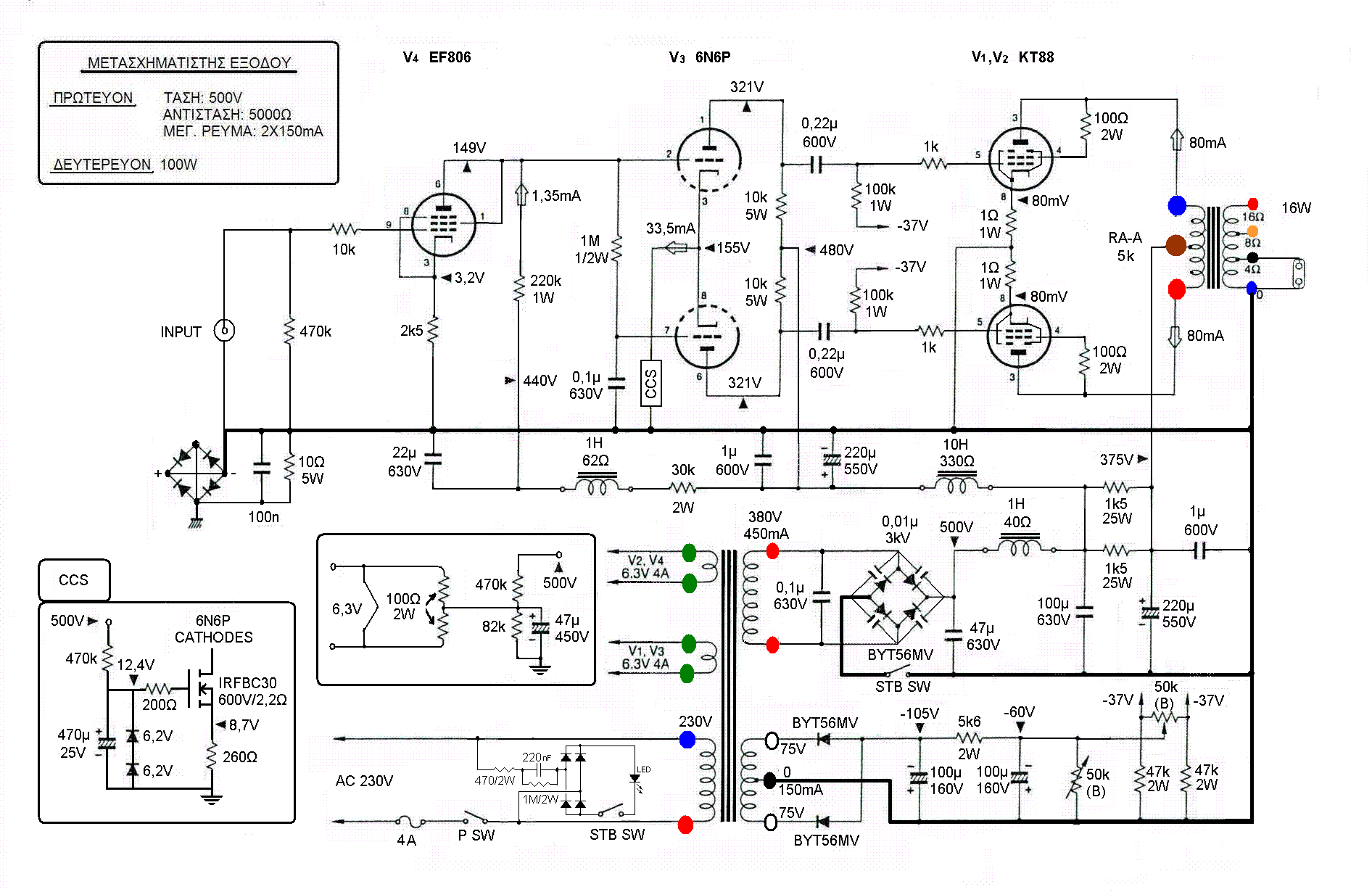

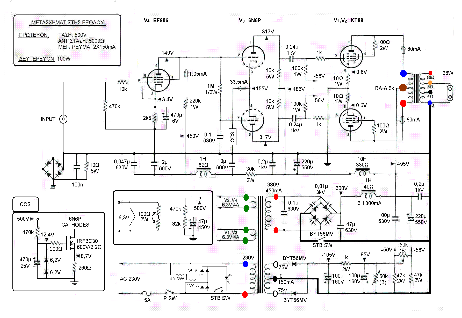

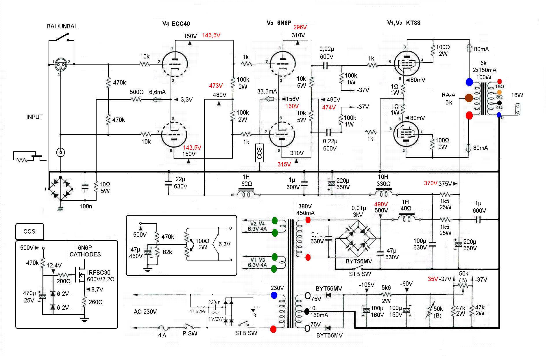

New member and I just can't resist to post here.
The schematic at the entry post is exactly what I built some eight years ago only with
different OTPs and chokes. In fact, this was my first ever attempt to tubes world and
I was attracted by simplicity. I found out that this is a design to move rather inefficient
speakers, not my preference. Over the years I modified it extensively, learning everything I know about tubes. The most important issues of this design are in the phase splitter
having the same psu rail with the power tubes and of course exceeding nominal cathode to heater voltage. Below are the current status schematics
Unbalanced class AB version
Unbalanded class A version
Balanced class A version

Nice work though.
I am reading Lenard articles about new schematics for modern amps and Opens my mind not to stick on old school circuit building. Articles about negative feed back, bootstrap mechanism, opamp as preamp driver and power supply regulations are things we really have to consider to imolement in our design.
I' m glad you like it Vincenti. But please, keep in mind that these schematics are not a professional's recomendation. It's just my personal experimentation and educational trip in tubes constructions. They do work flawlessly but there is no performance documentation.
