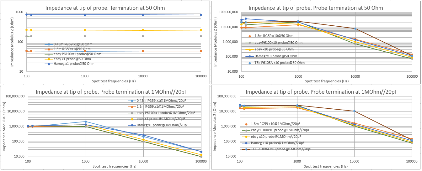

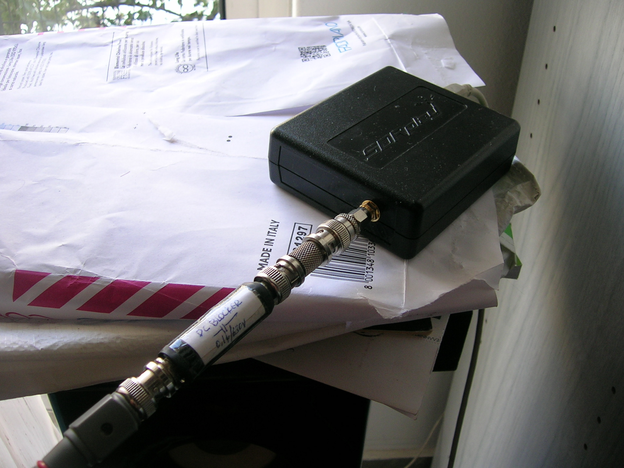

Here is some low frequency impedance measurements taken at the tip of probes (DER DE-5000). showing the loading effect a probe imposes on the probed circuit.
For impedance data at higher frequencies, a nanoVNA will be handy (when it will arrive)
George

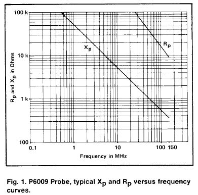

Some vendors provide the effective input impedance info. Attached for the Tek P6009 X100 probe I recently bought.
The P6009 is only rated to 100 MHz but actually measures to 200 MHz in the scope (2nS rise time). Its also good for 1500V so I can recommend it for working on tube stuff.
Other vendors have similar info but in my experience a good vintage Tek or HP probe will usually have better waveform fidelity than a cheap new probe.
Its interesting that a X100 probe input impedance can drop so much at high frequencies. Probably not an issue for audio.

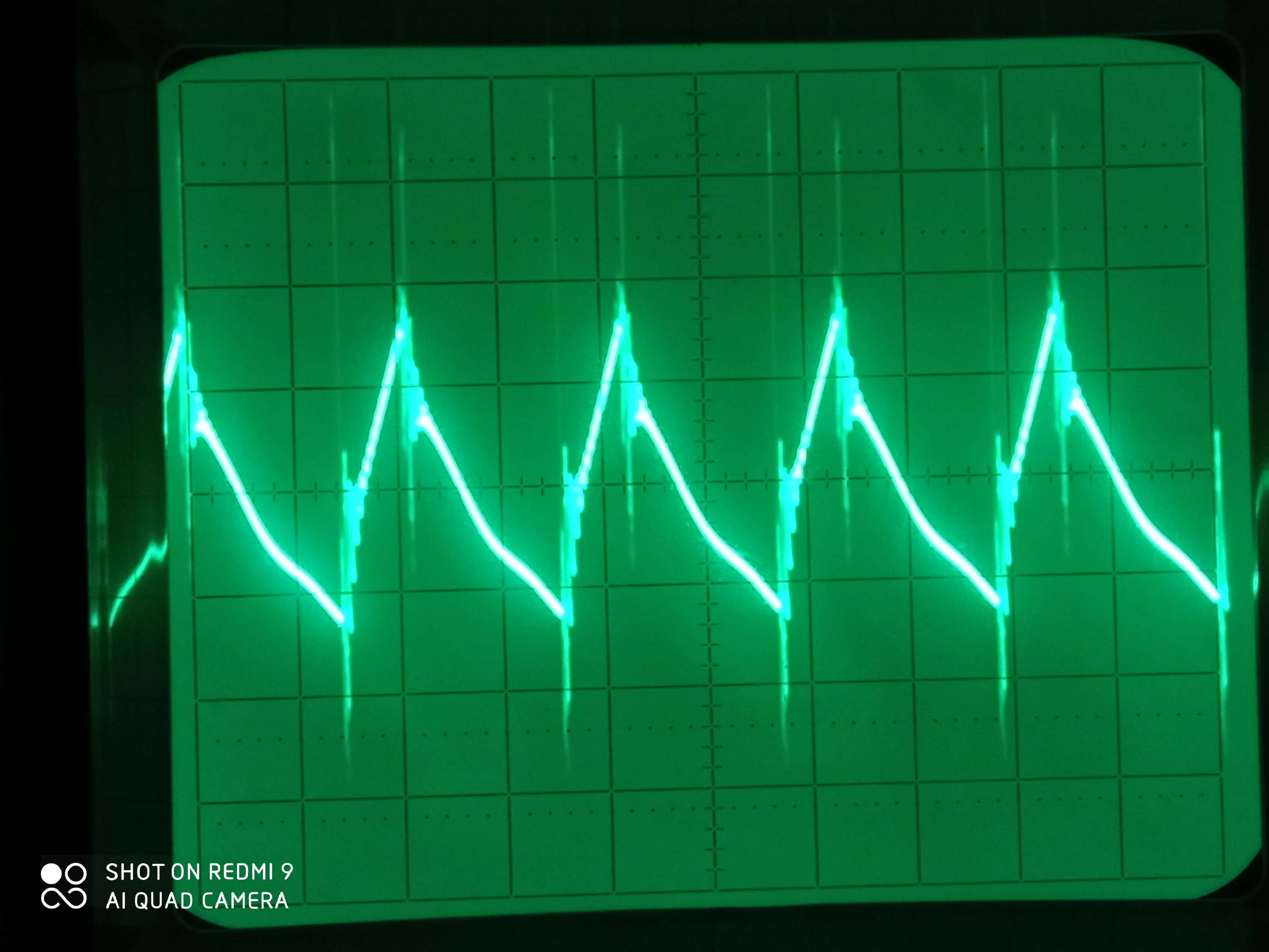

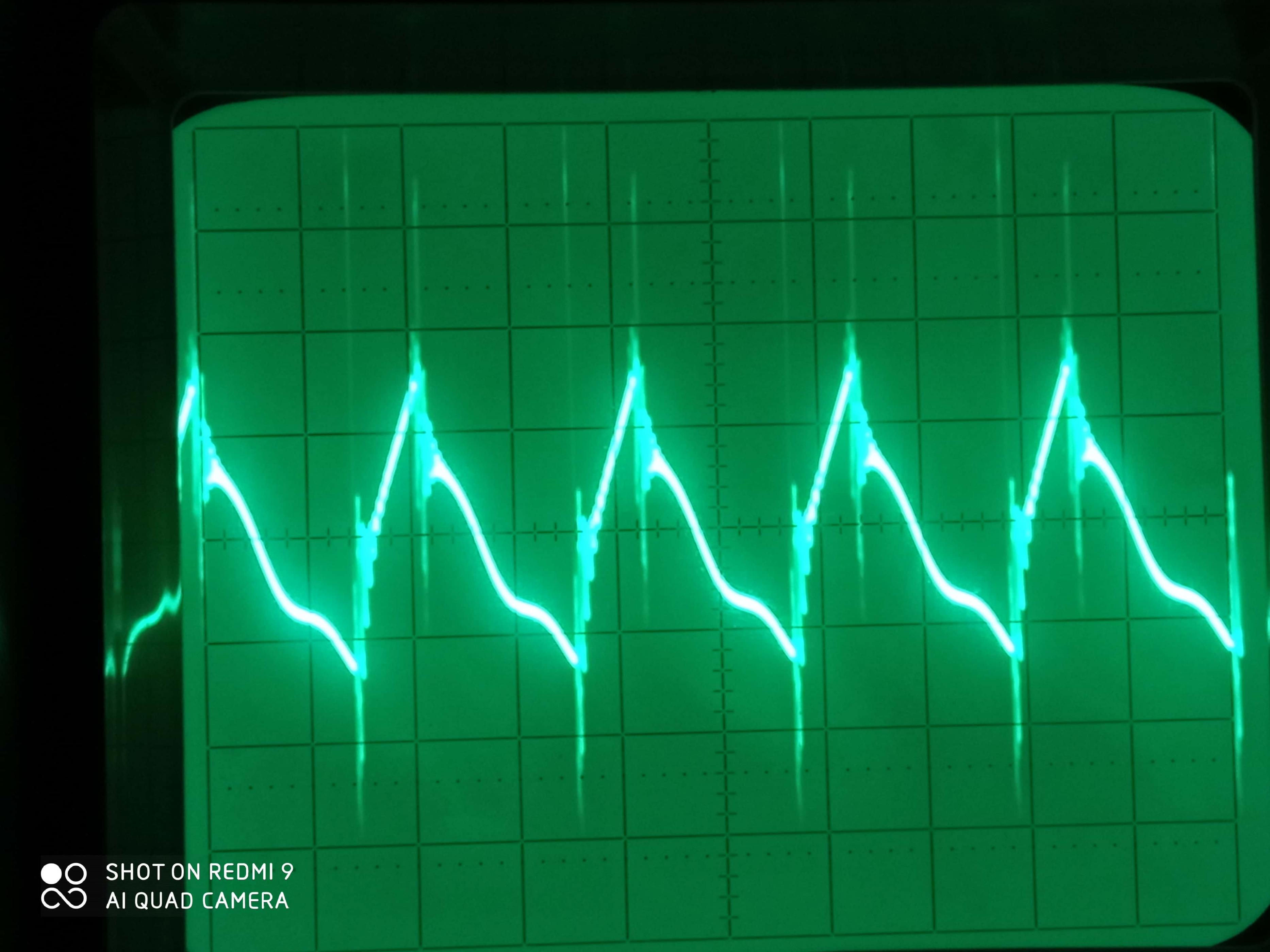

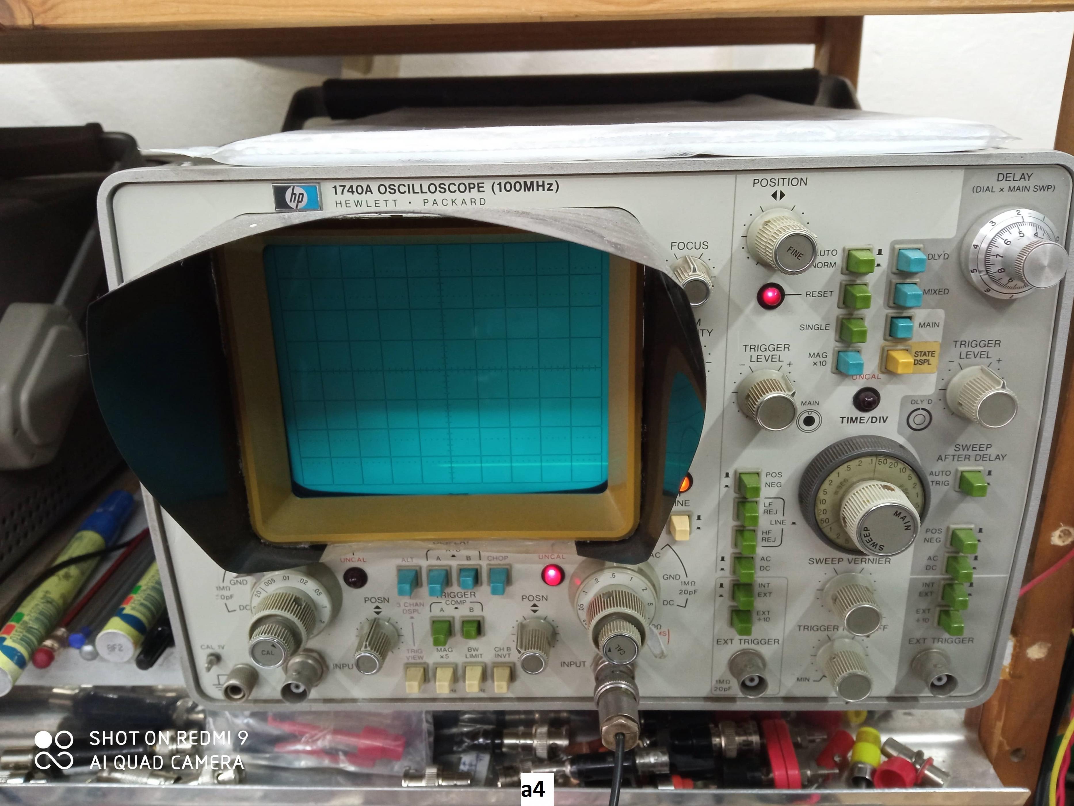

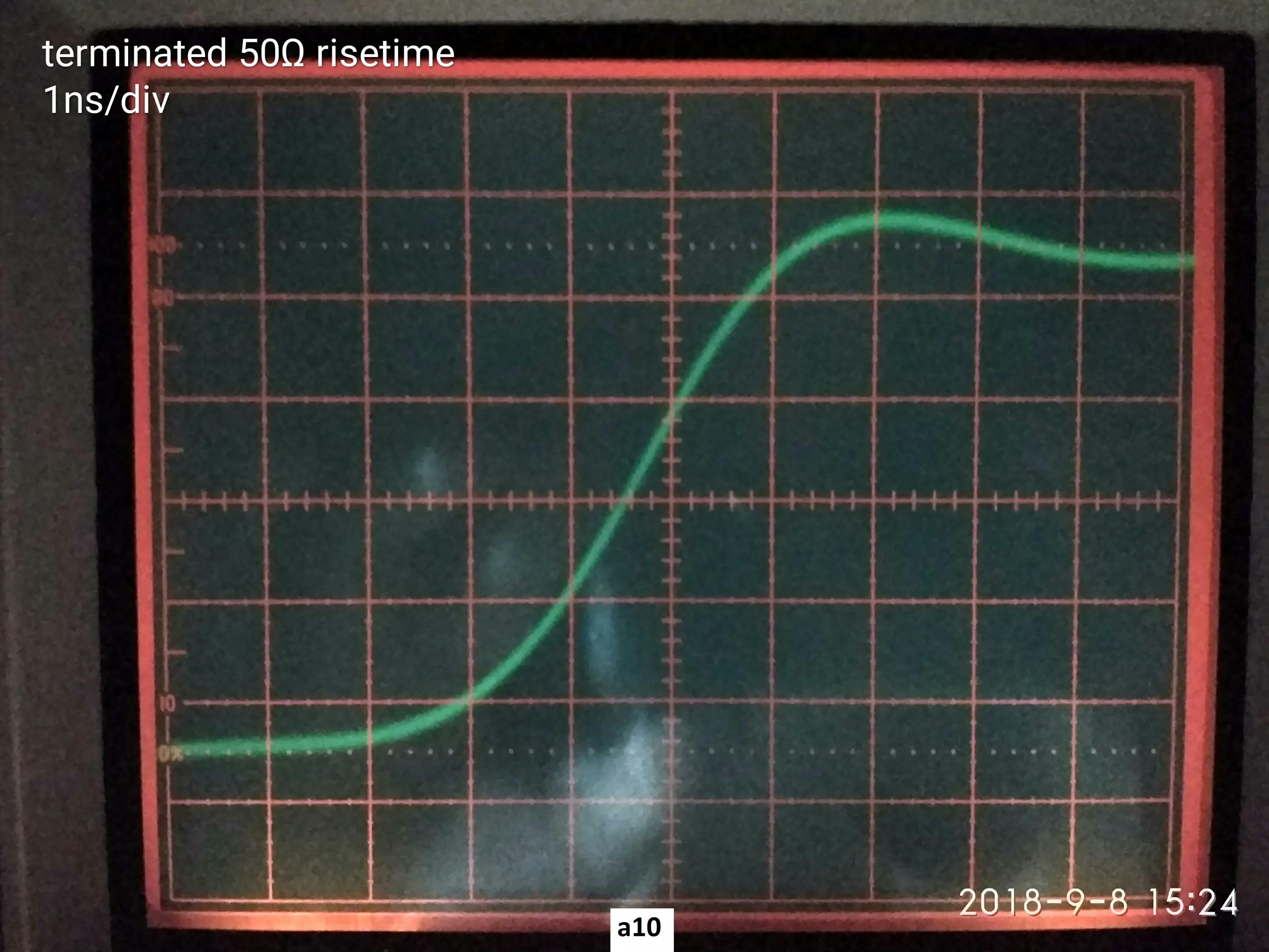

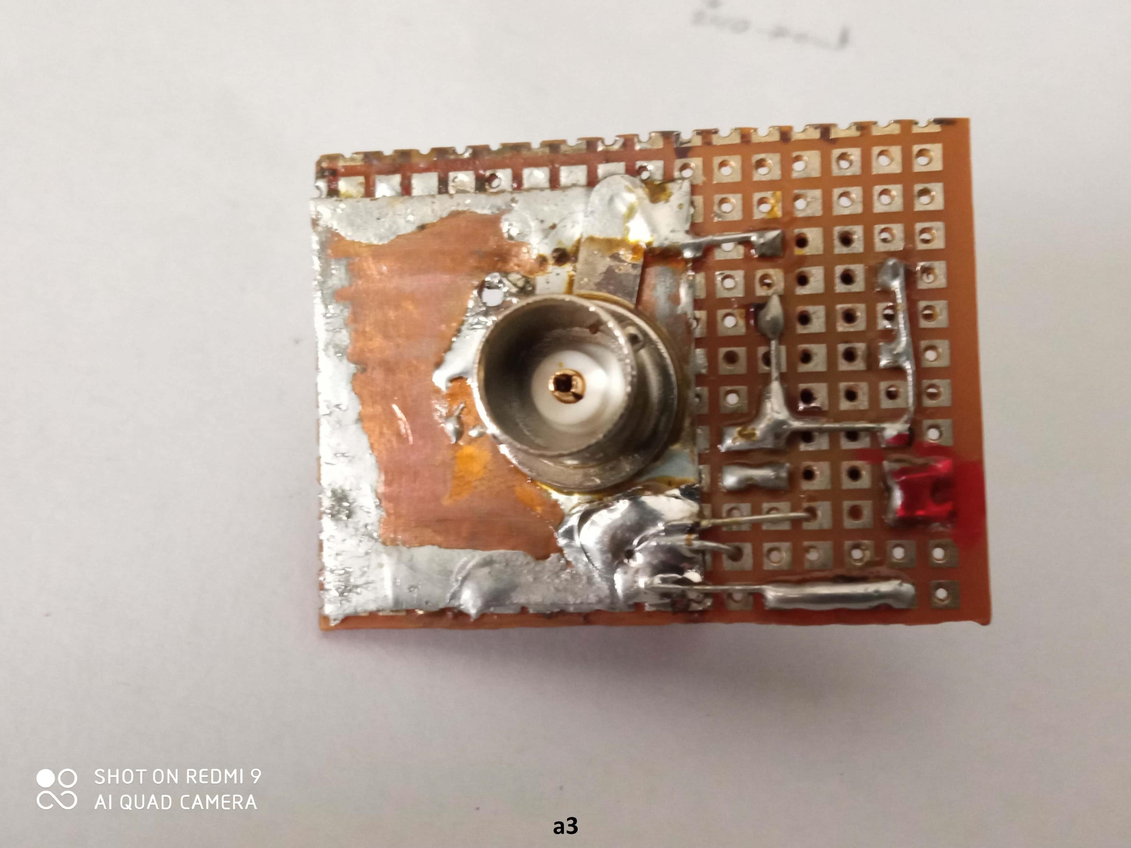

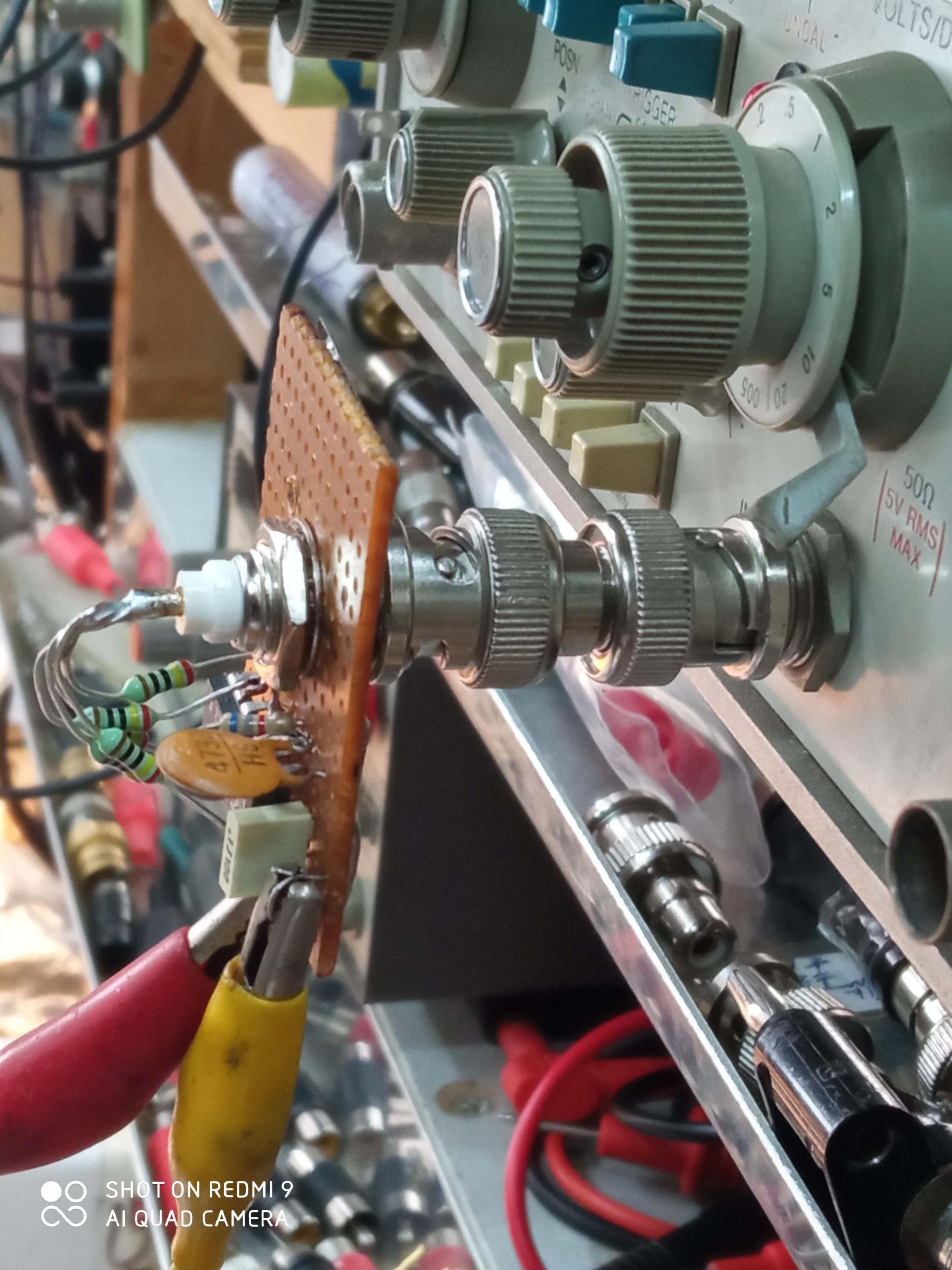

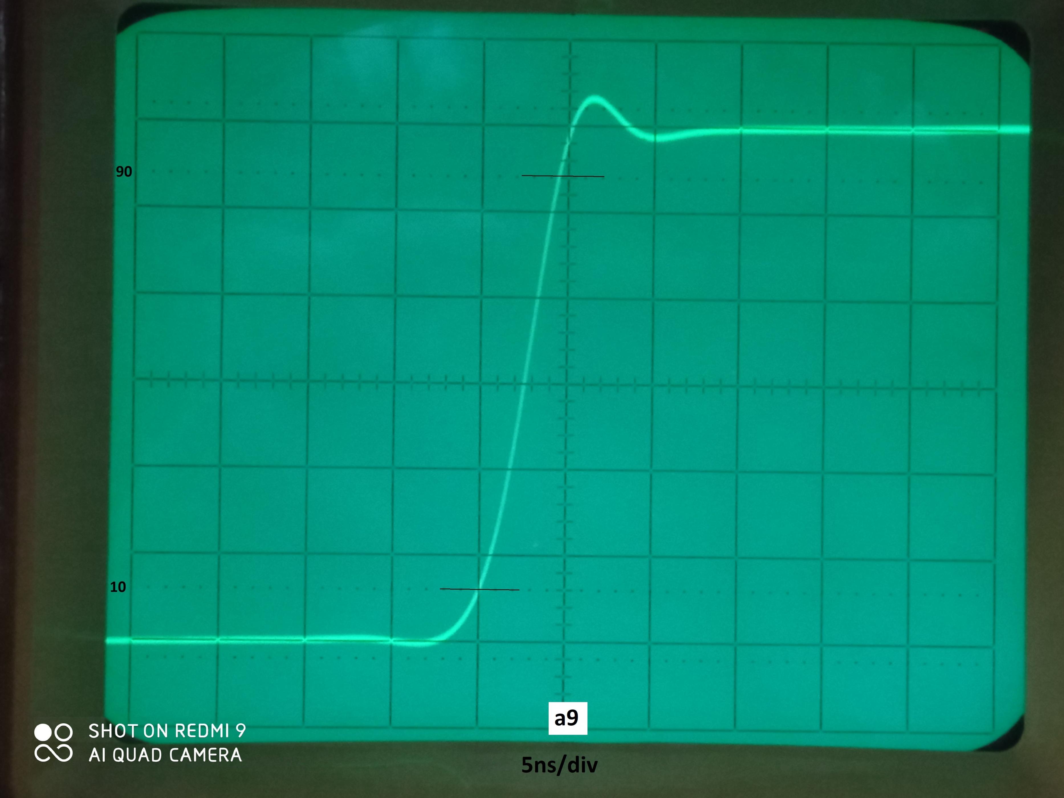

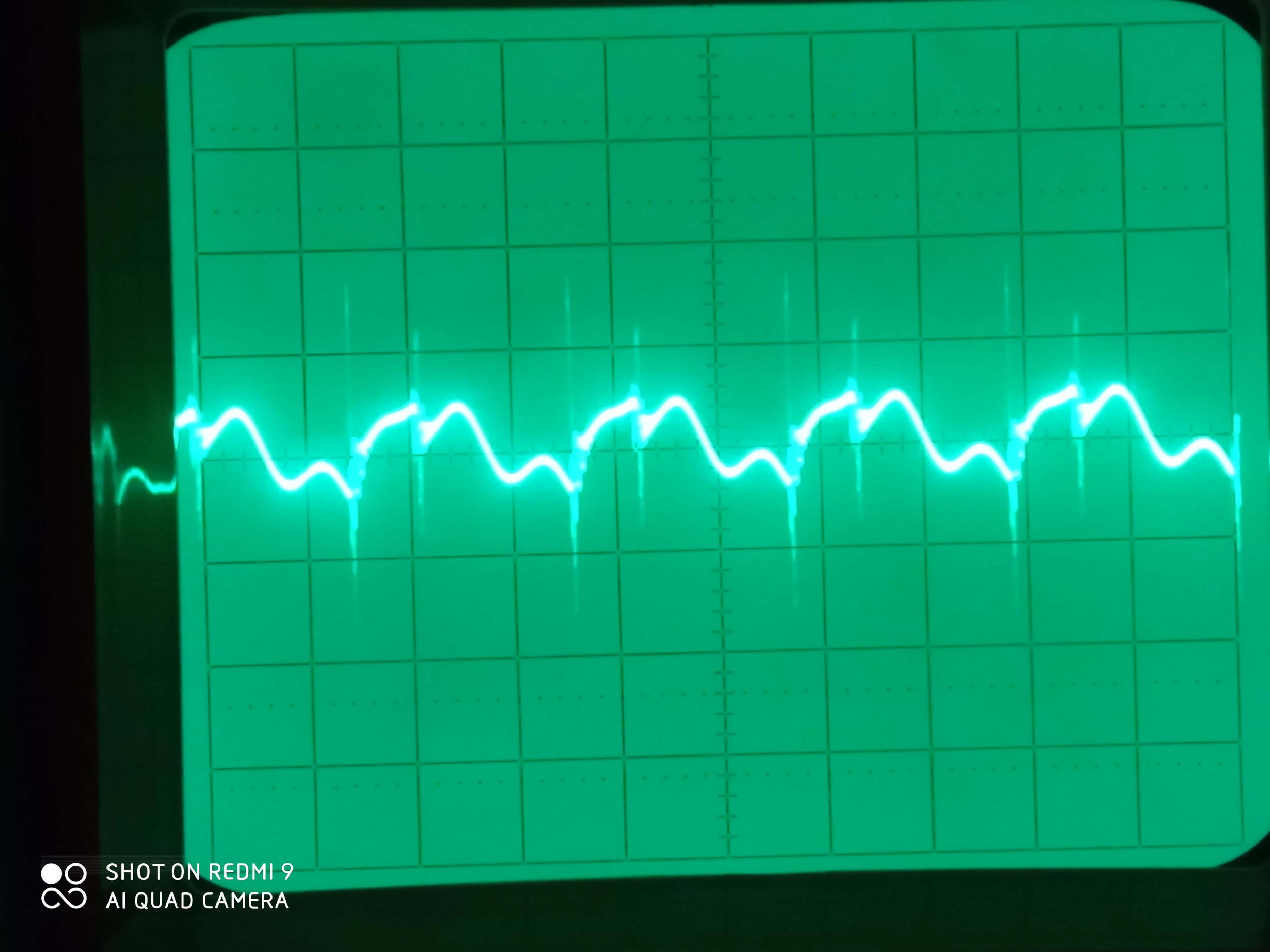

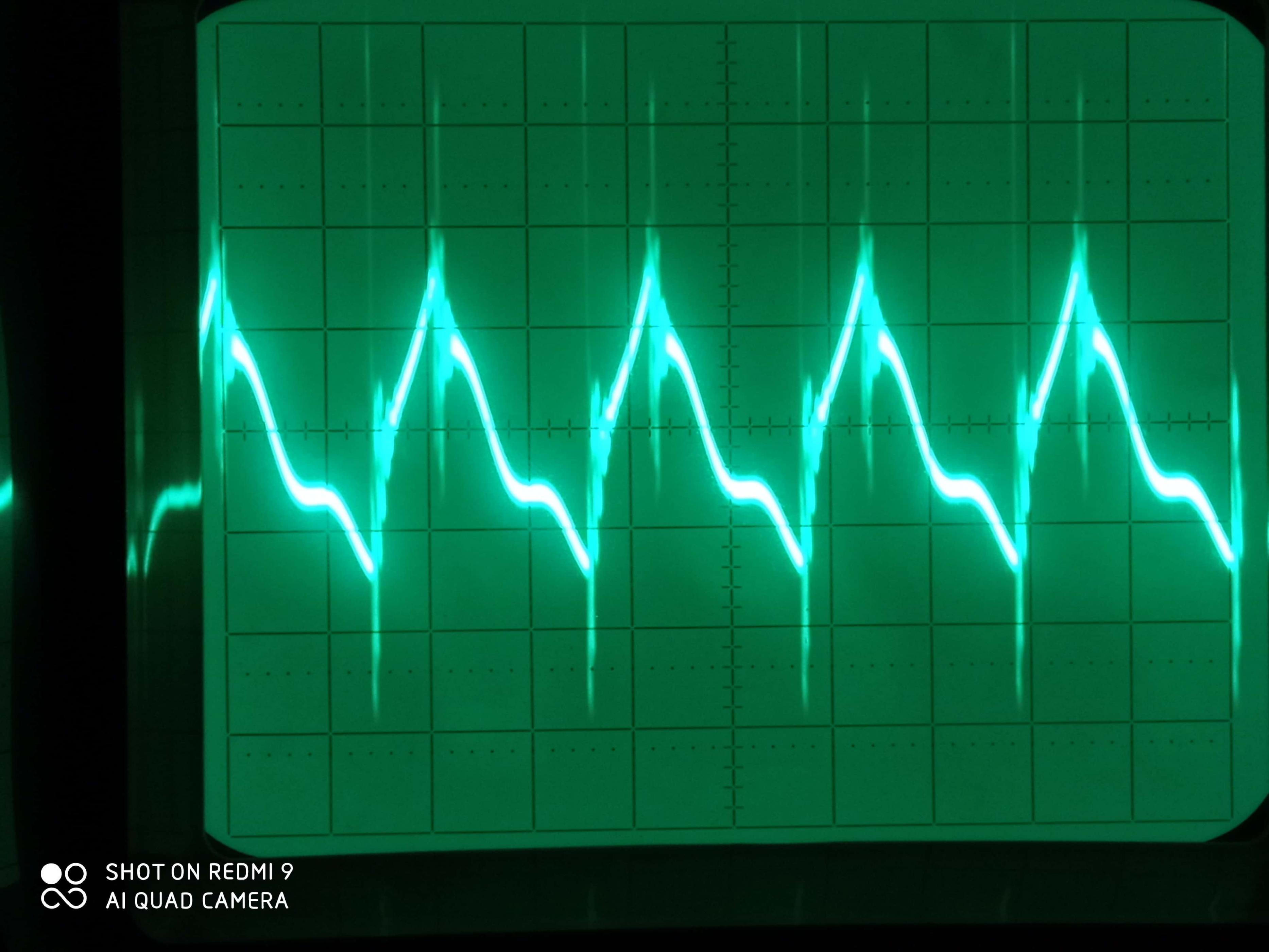

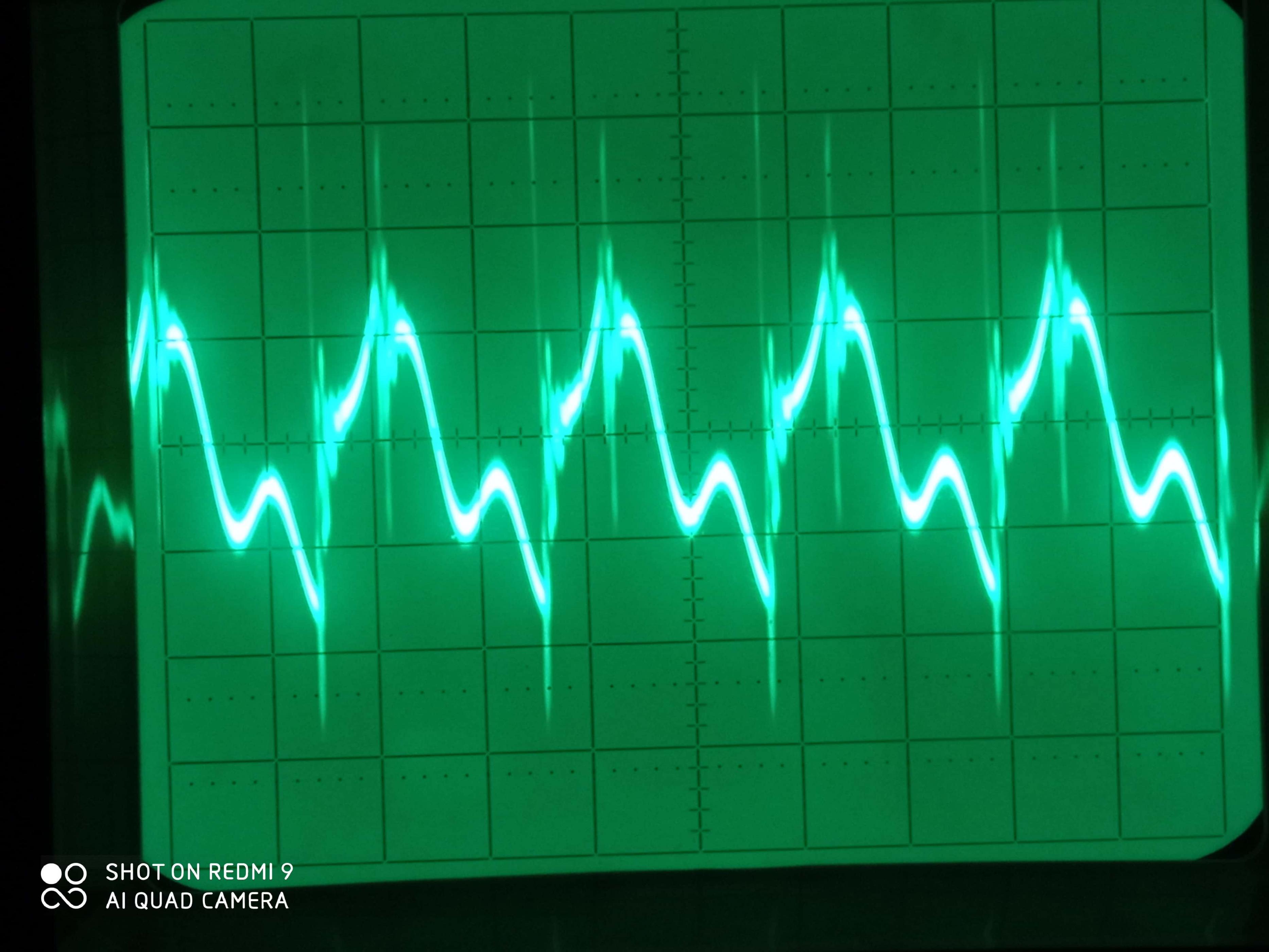

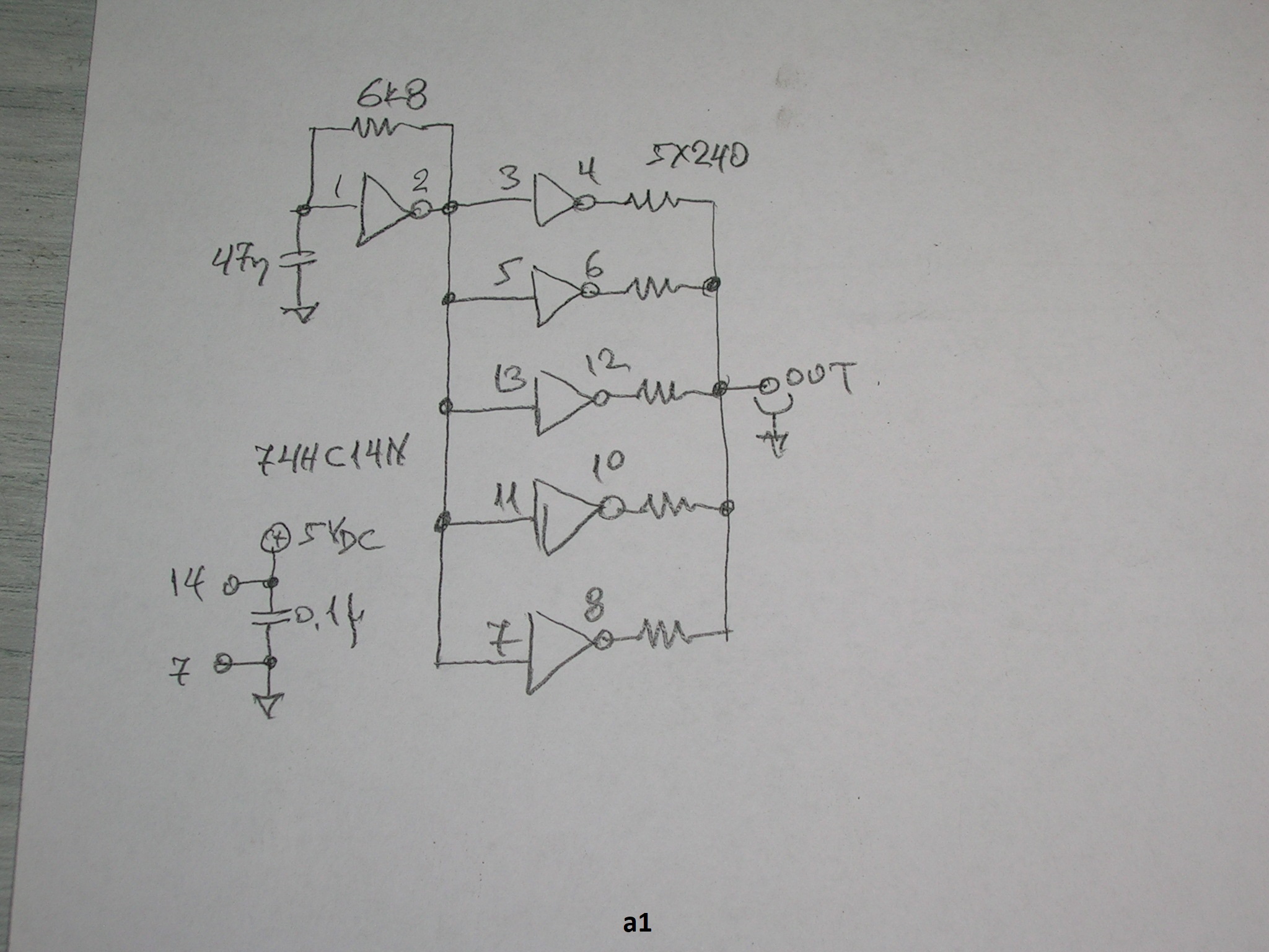

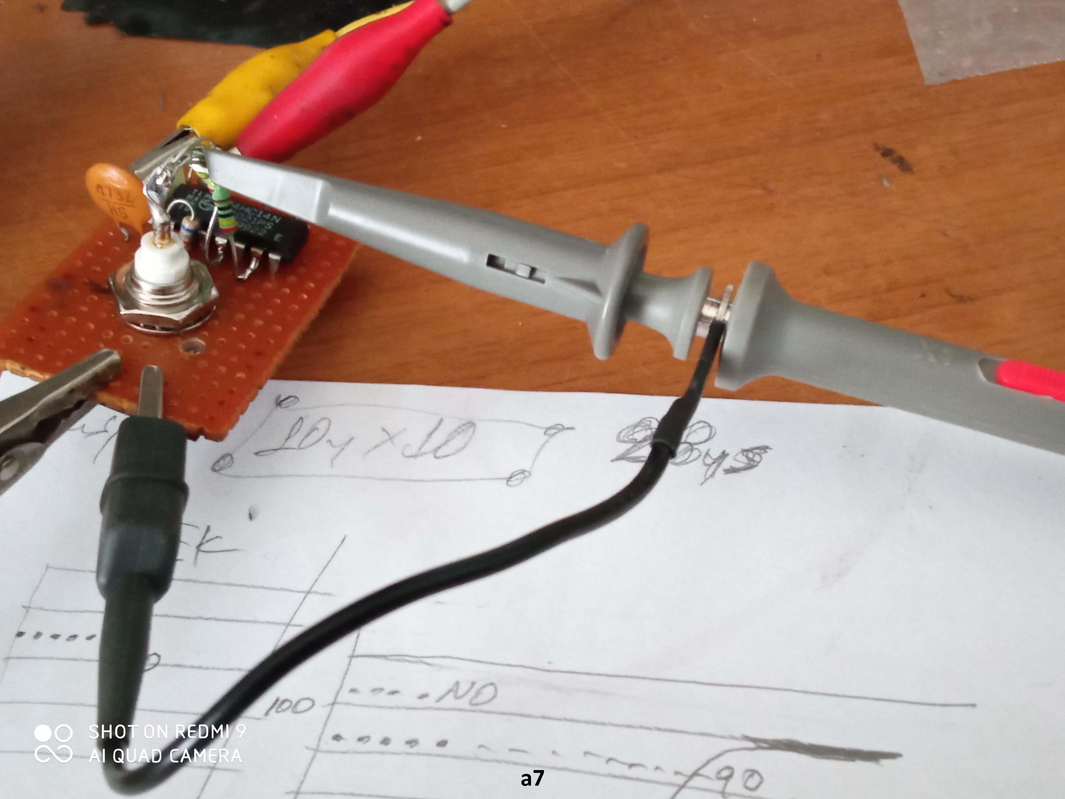

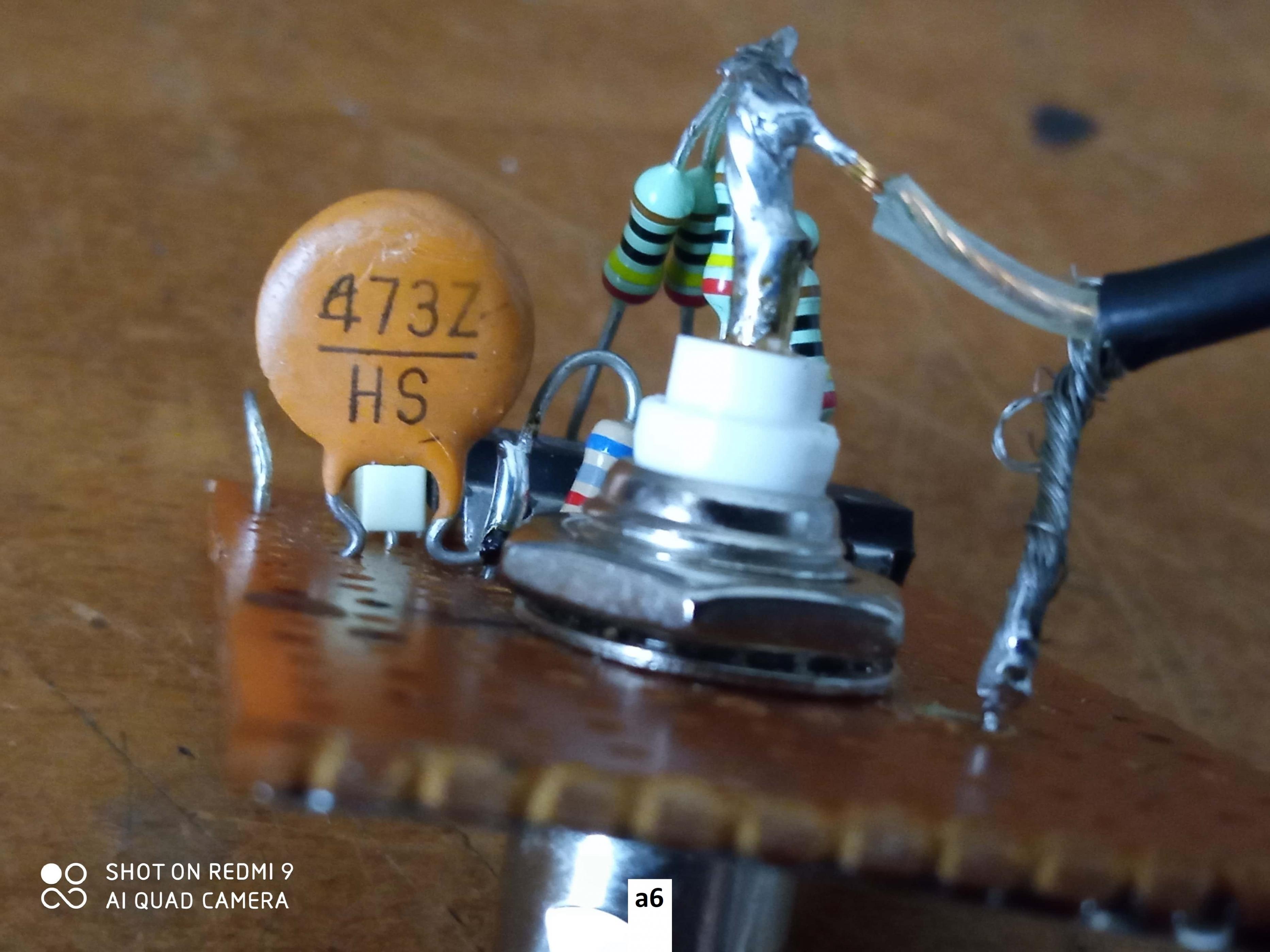

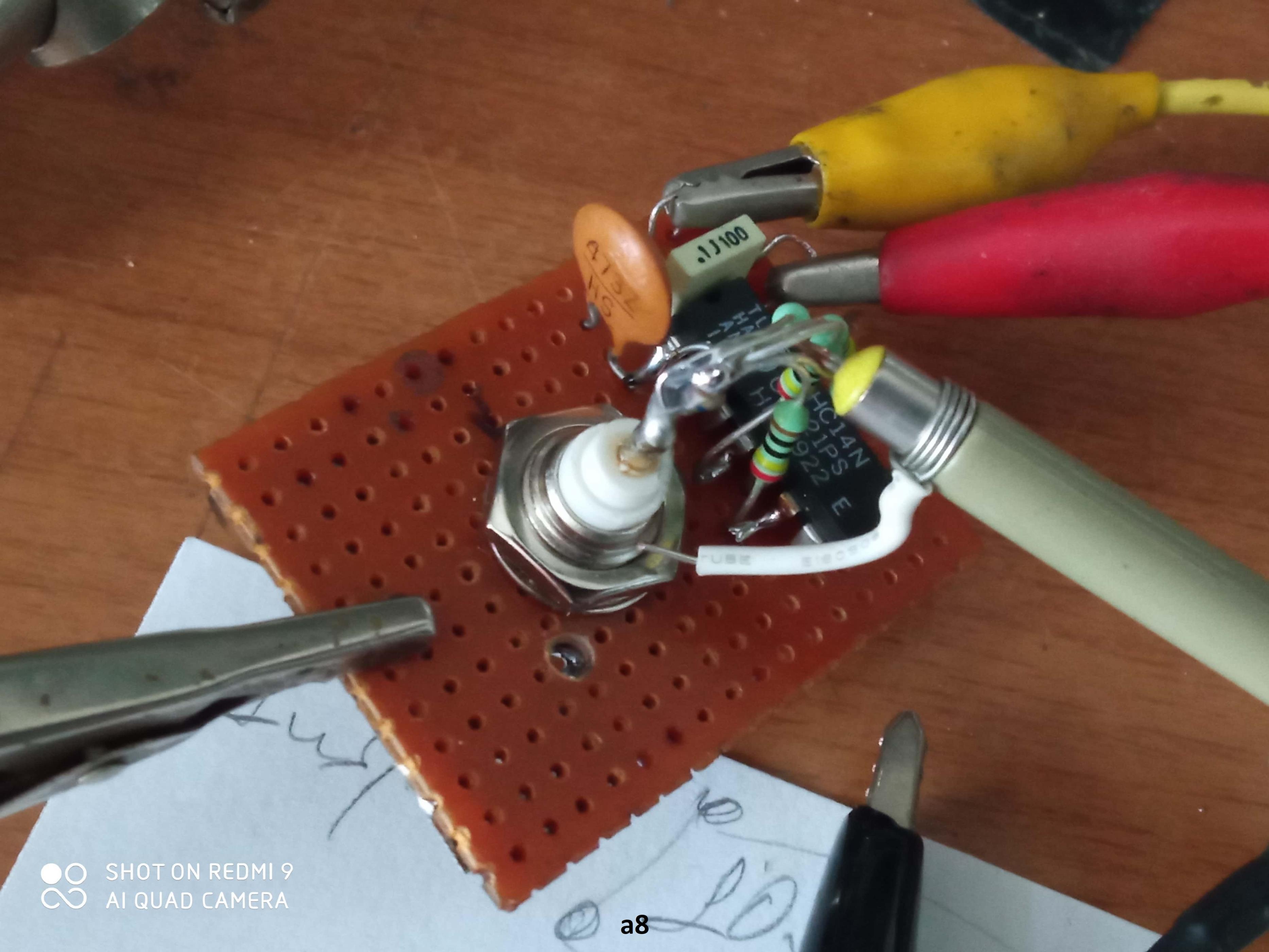

1st post
I took some shots of an 100MHz BW oscilloscope screen to show the effect of probe and input impedance.
A diy step generator producing a 2.2-2.5ns rise time (10%-90%) step.
Generator Rout:48 Ohm
Oscilloscope Rin 1 MOhm//20pF or 50 Ohm selectable.
a1 schematic

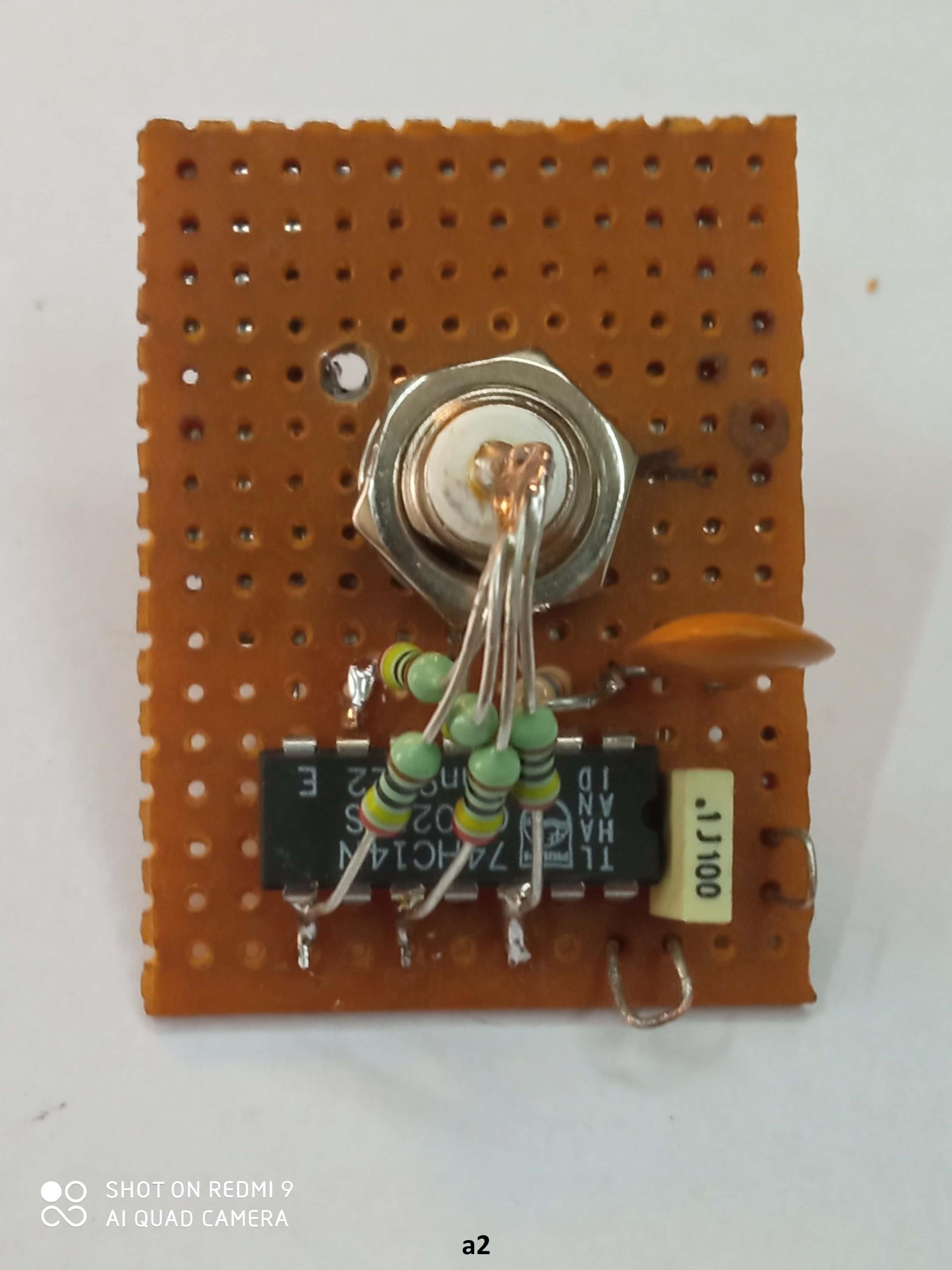

a2 top side
a3 bottom side
a4 HP1741A
a5 direct connection
a6 cable connection
a7 probe with long gnd lead
a8 probe with short gnd lead
a9 pulse on HP1741A
a10 pulse on TEK 475
George

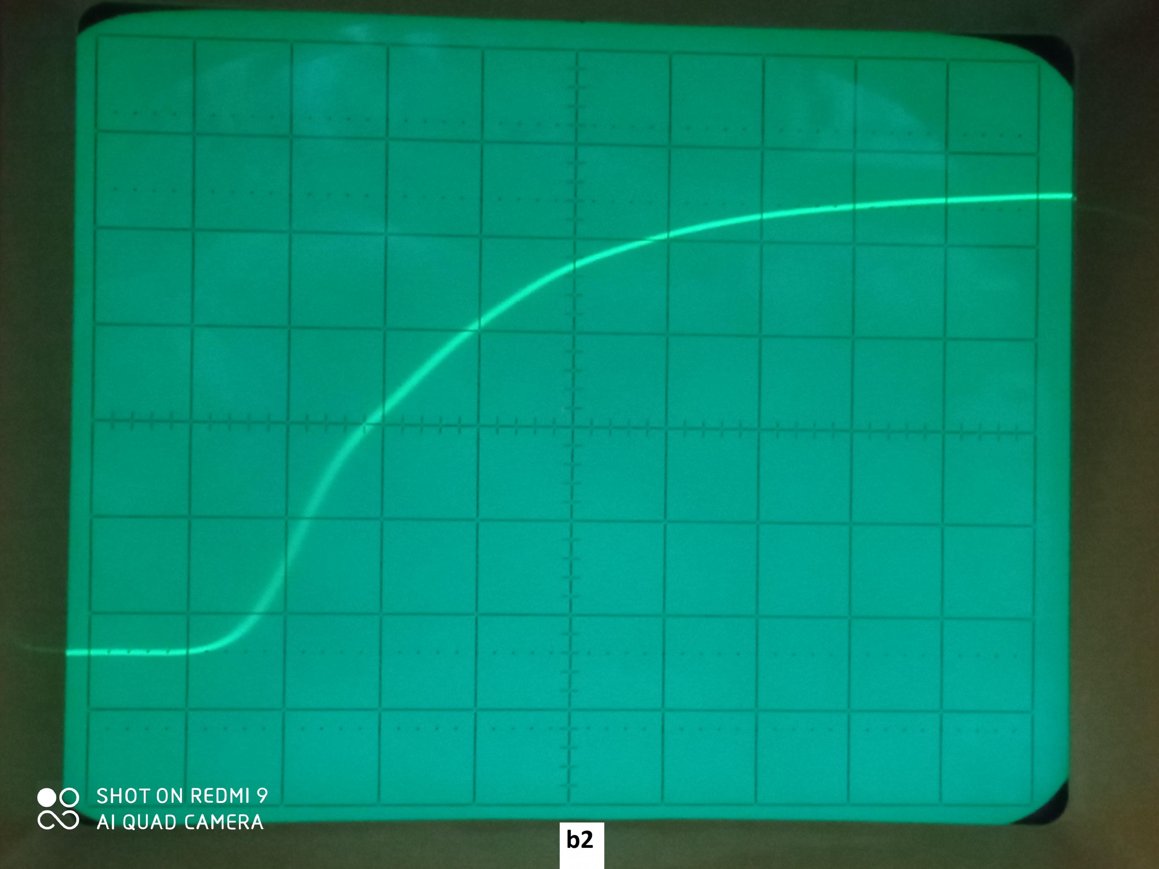

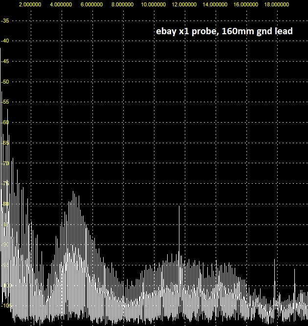

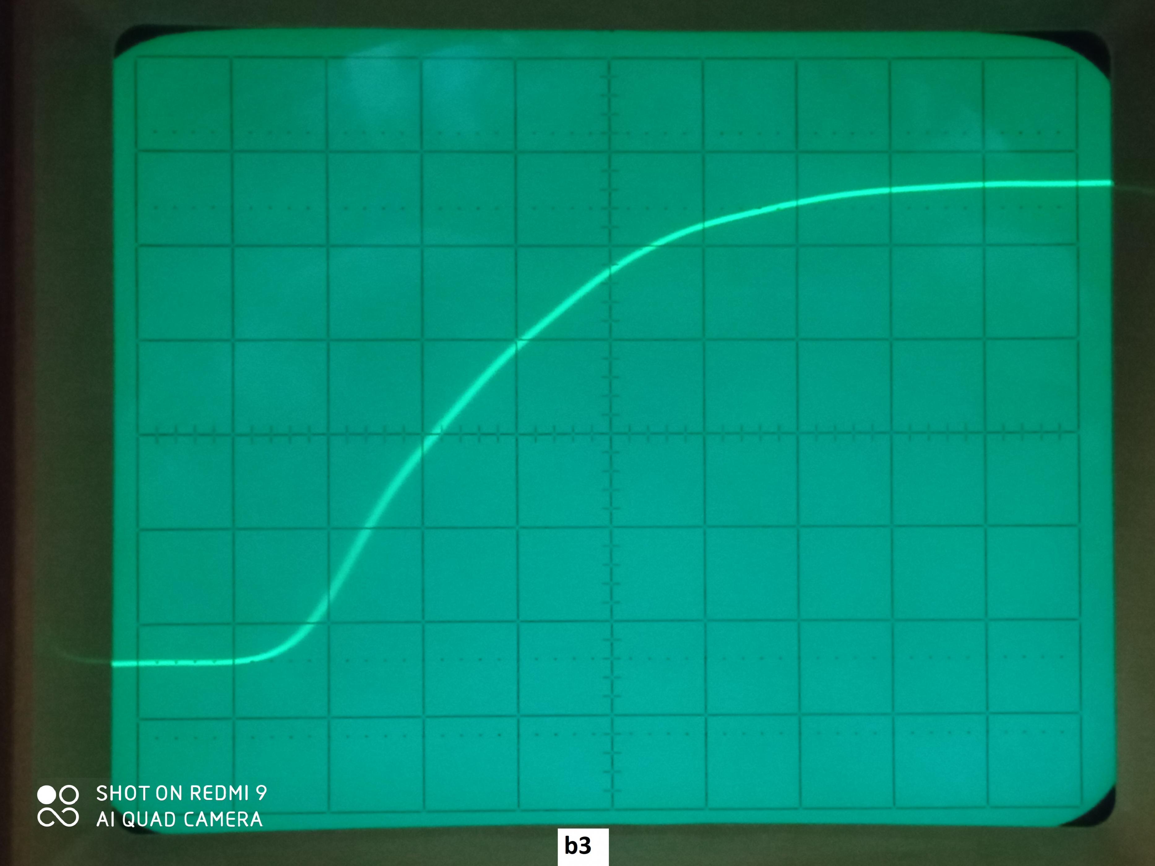

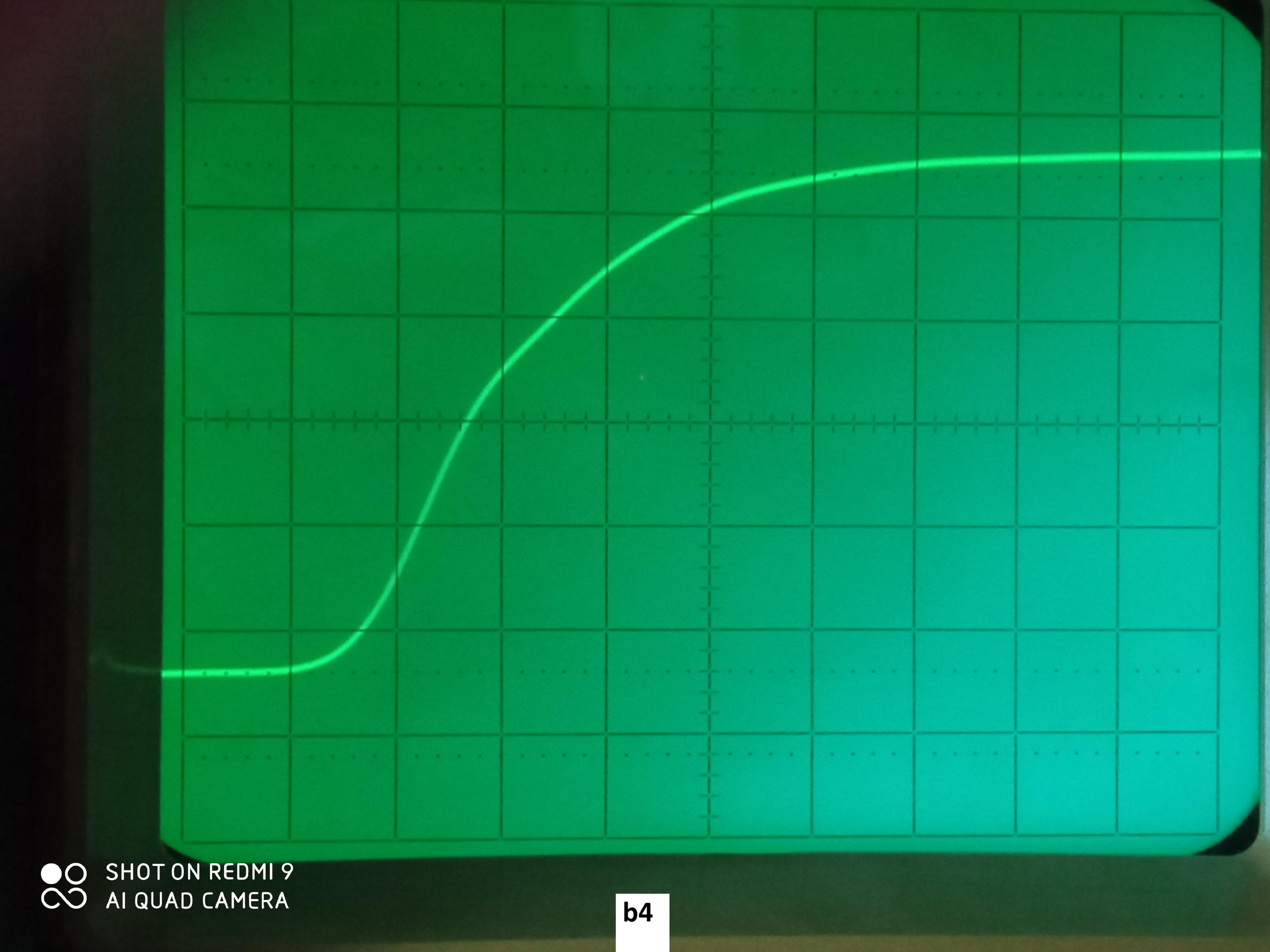

2nd post
(x1)probes to 1 MOhm//20pF input.
1V/div - 5ns/div
Step generator connected through:
b1 male to male BNC adaptor
b2 e-bay 100MHz (x1)probe with a ground lead length of 23mm
b3 same e-bay 100MHz (x1)probe, now with a ground lead length of 160mm
b4 e-bay P6100 (x1)probe with a ground lead length of 23mm
b5 same e-bay P6100 (x1)probe, now with a ground lead length of 160mm
George

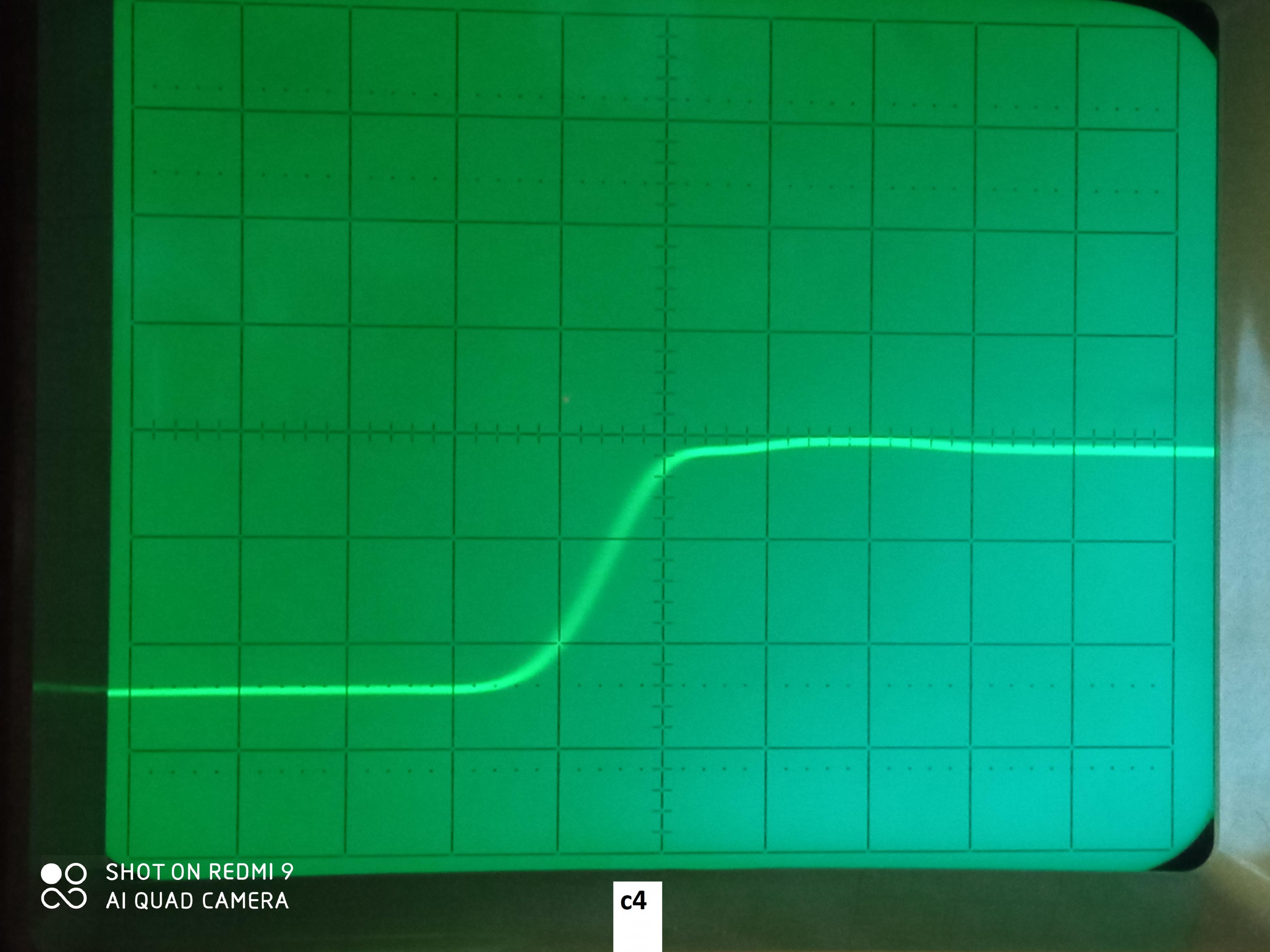

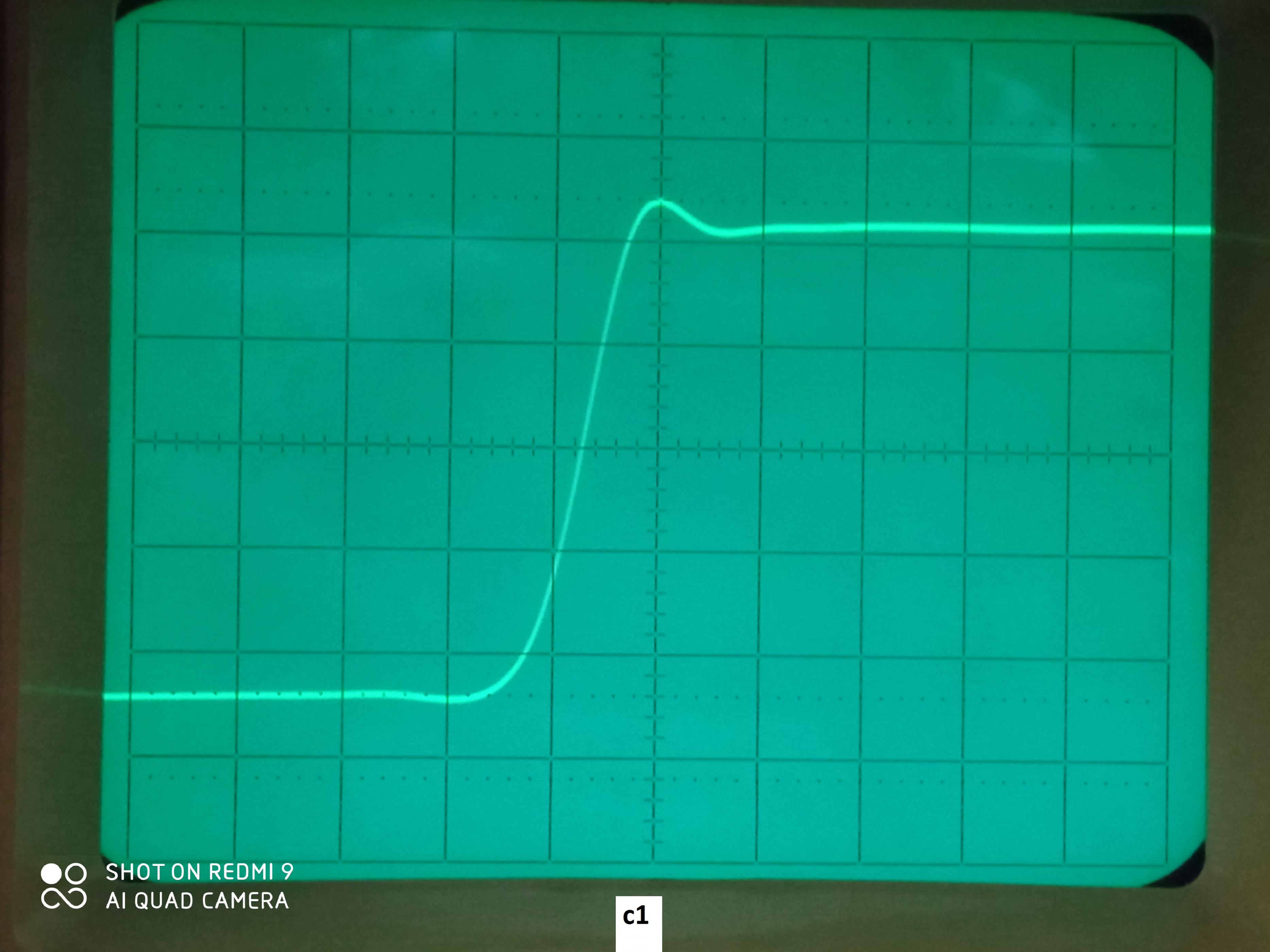

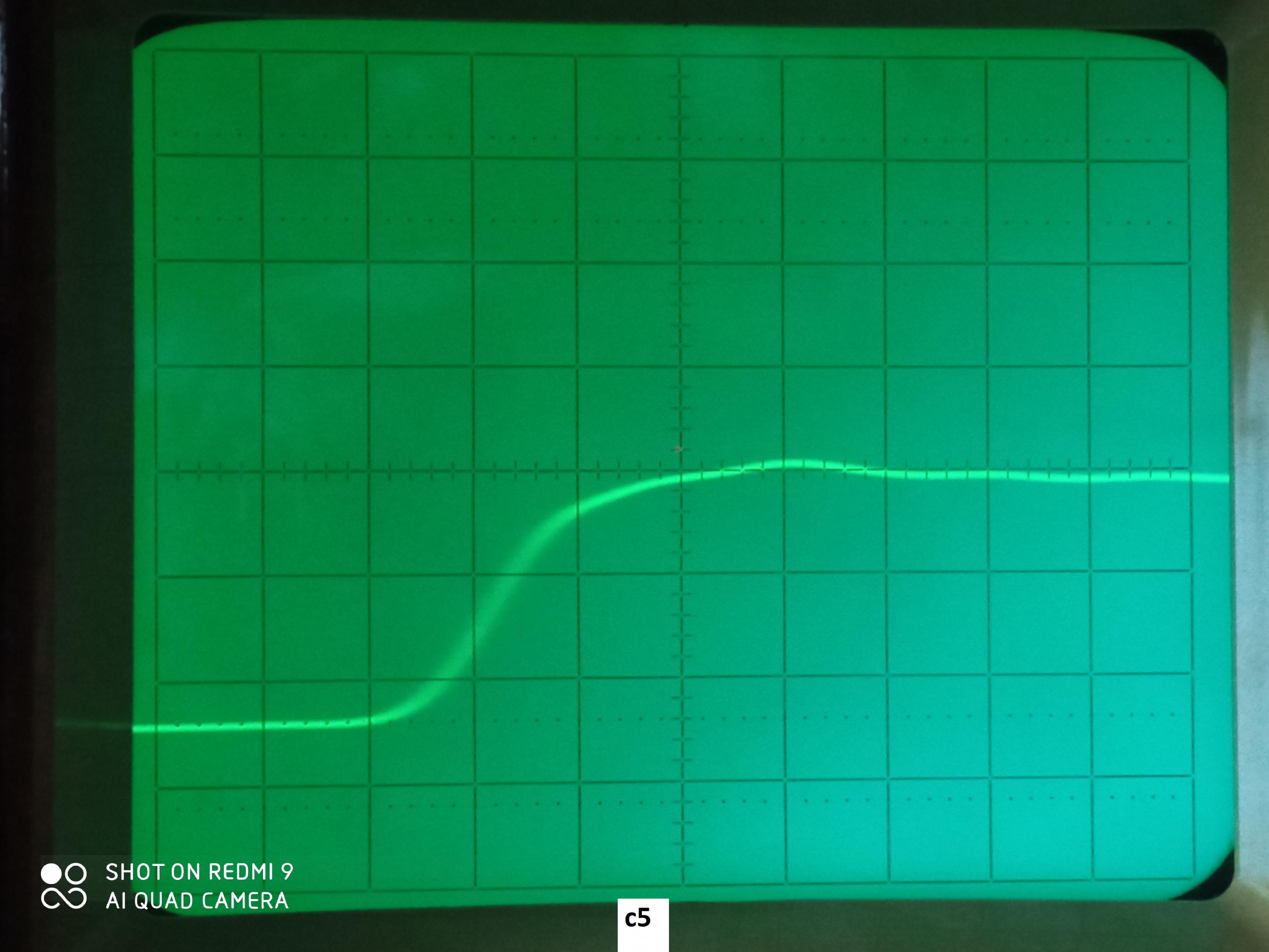

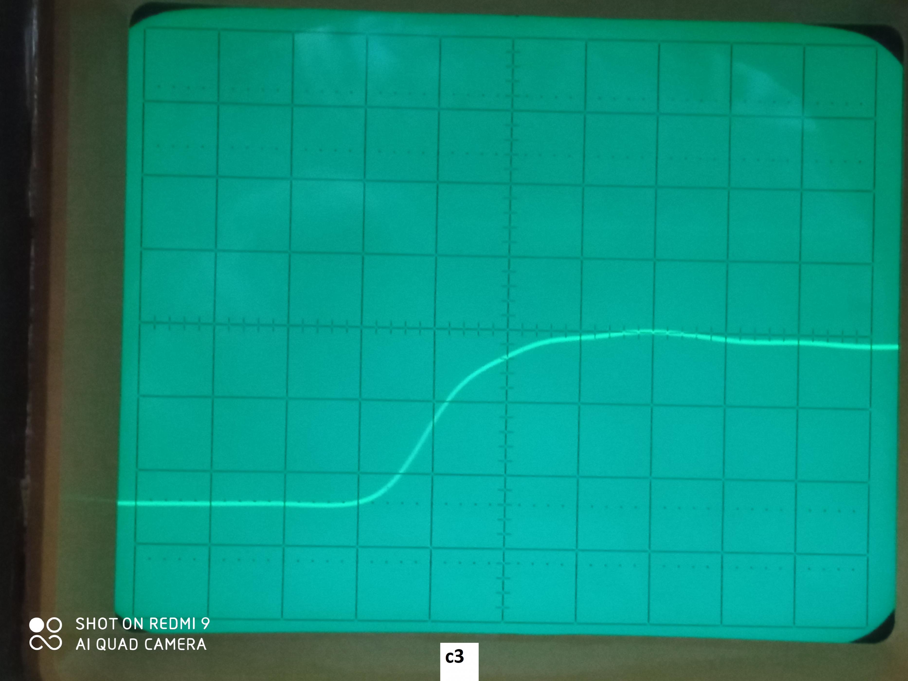

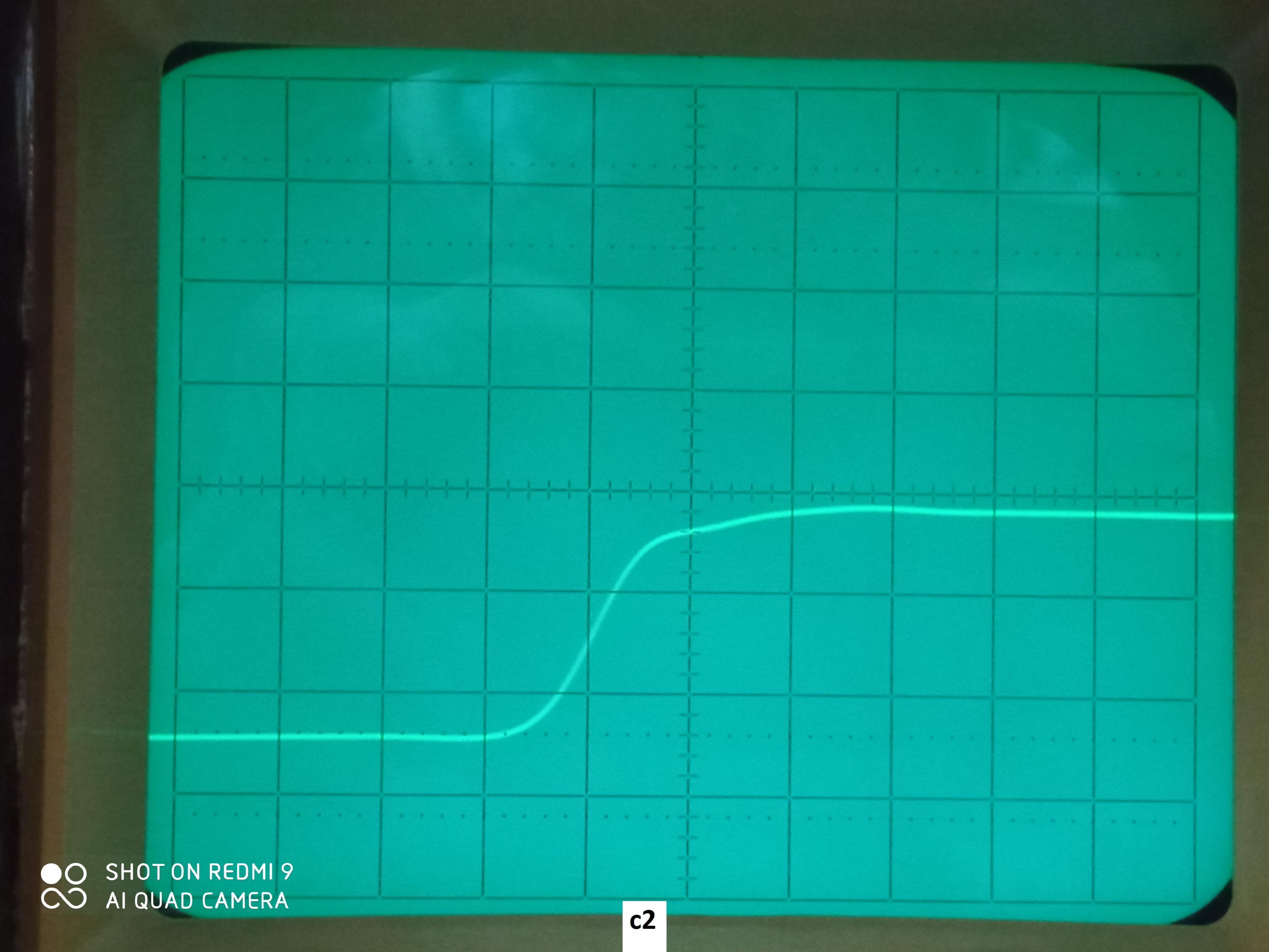

3rd post
(x1)probes to 50 Ohm input
.5V/div - 5ns/div
c1 male to male BNC adaptor
c2 e-bay 100MHz (x1)probe (x1) with a ground lead length of 23mm
c3 same e-bay 100MHz (x1)probe, now with a ground lead length of 160mm
c4 e-bay P6100 (x1)probe with a ground lead length of 23mm
c5 same e-bay P6100 (x1)probe, now with a ground lead length of 160mm
George

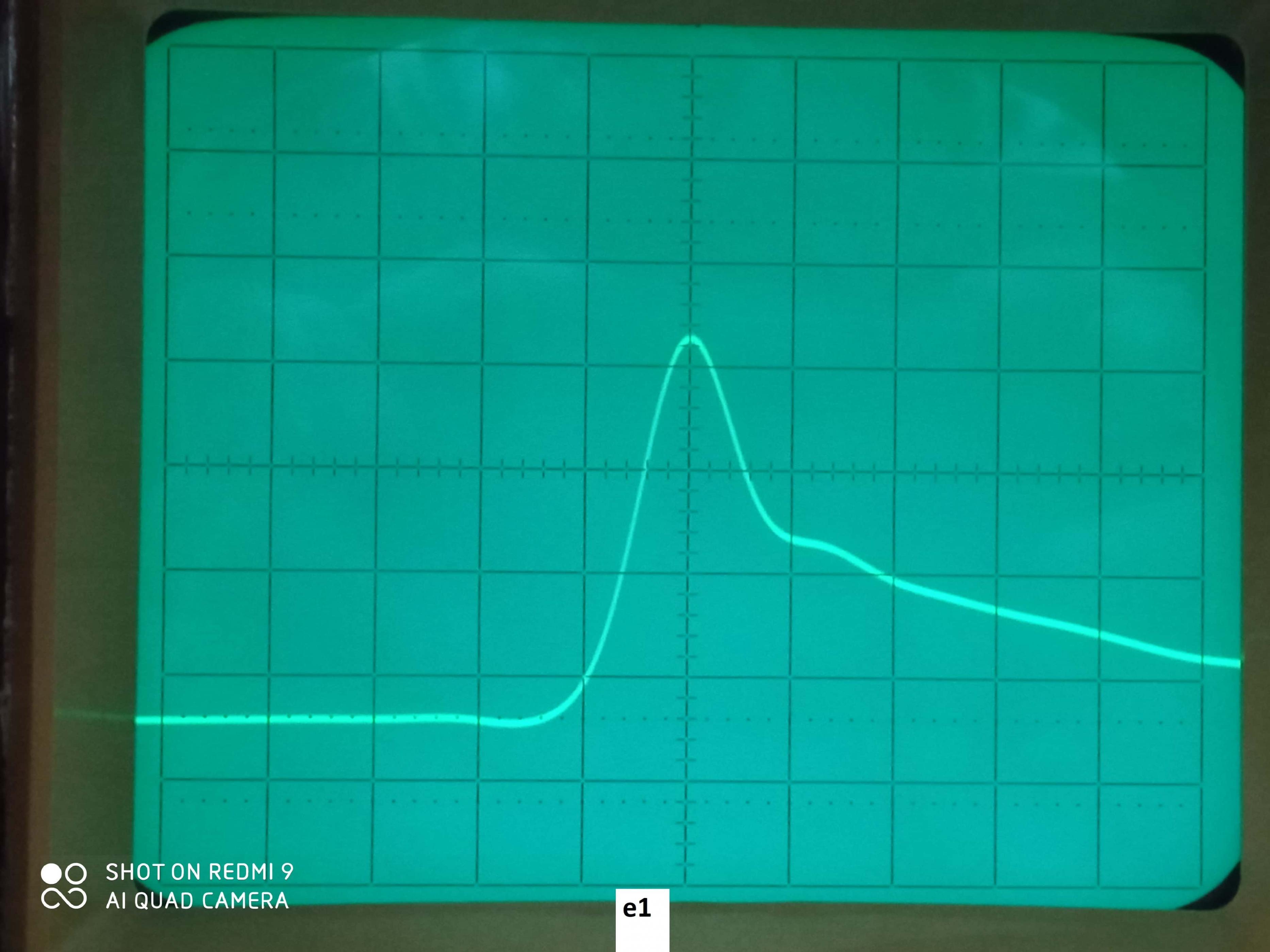

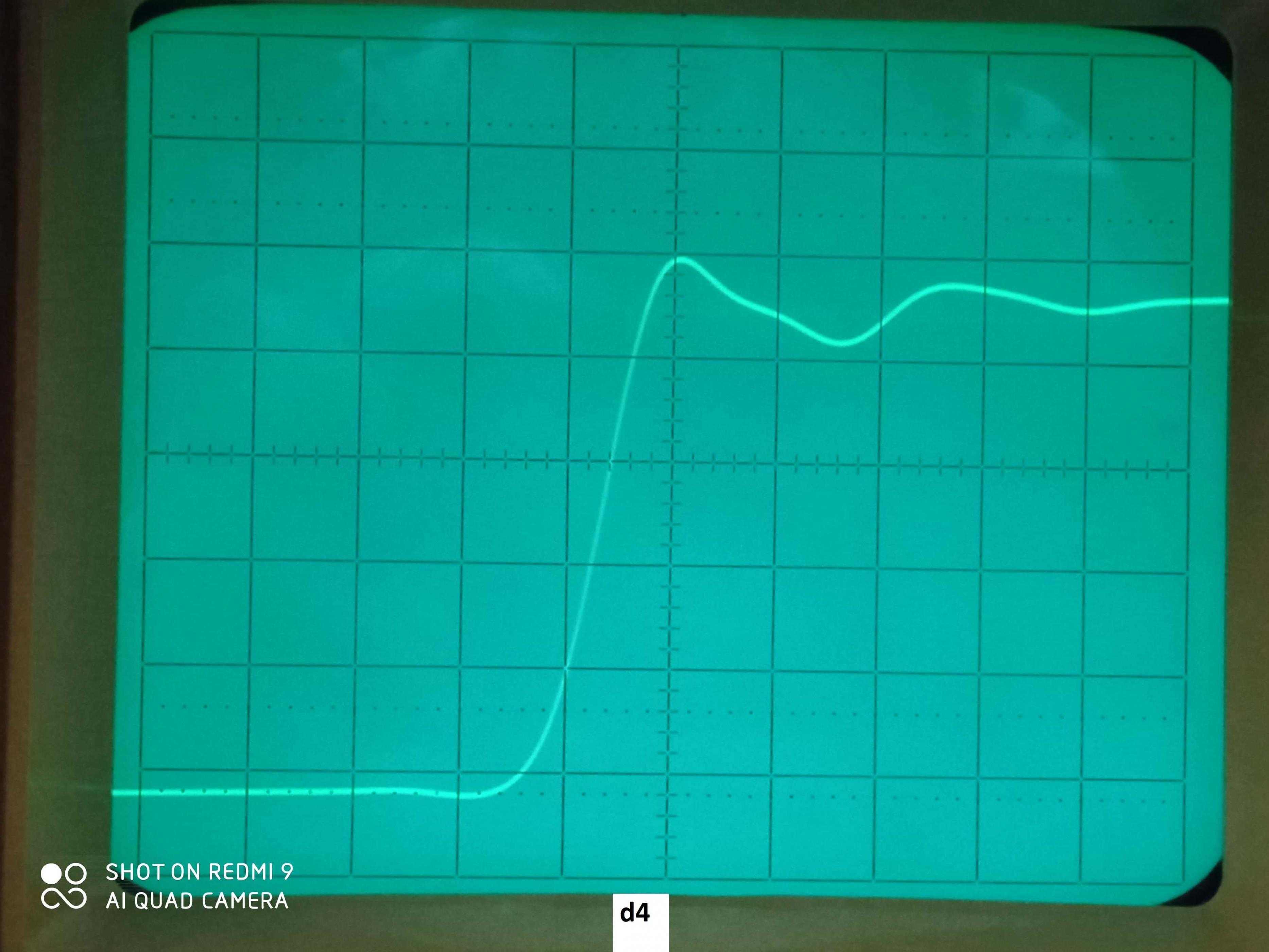

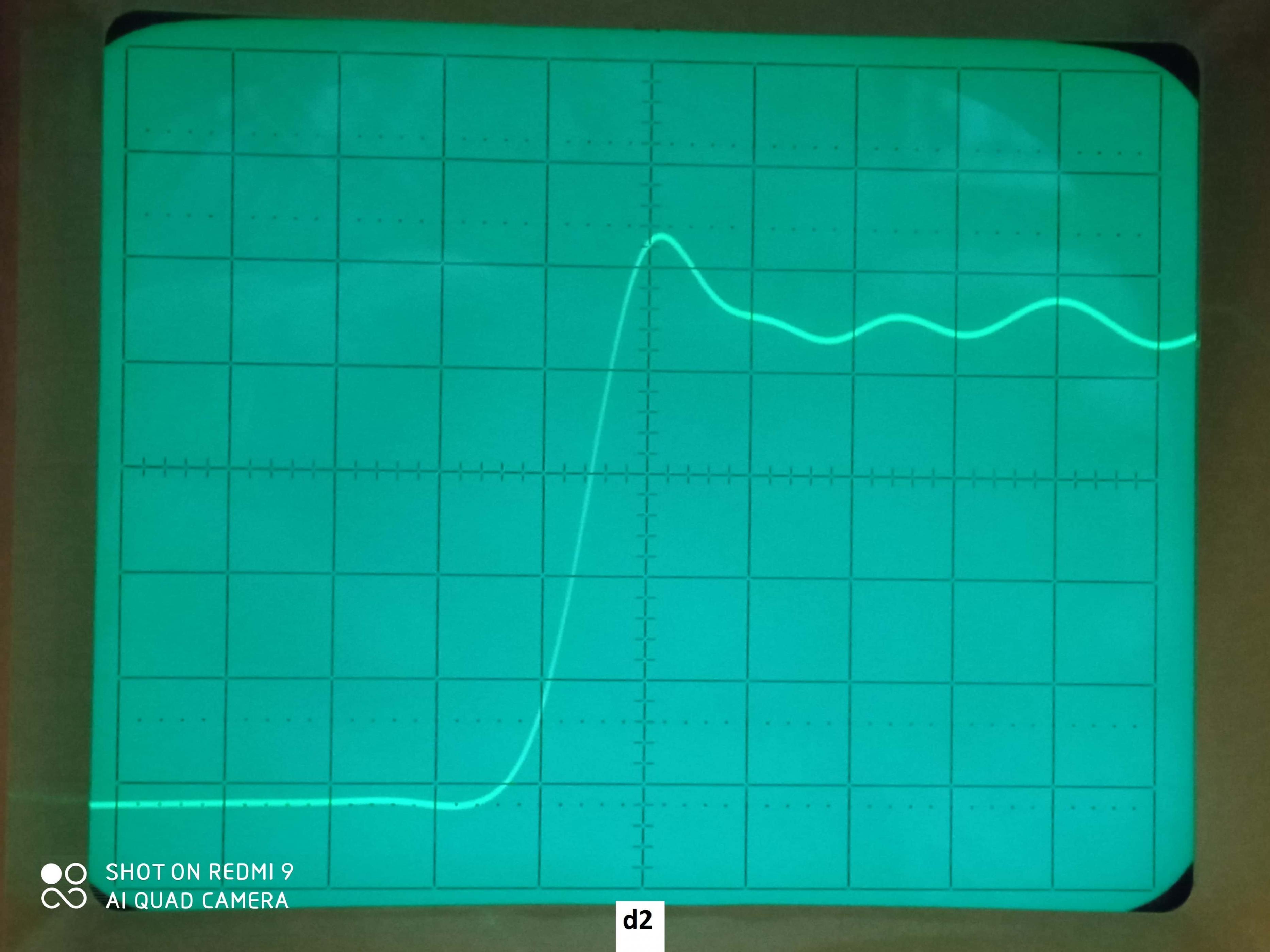

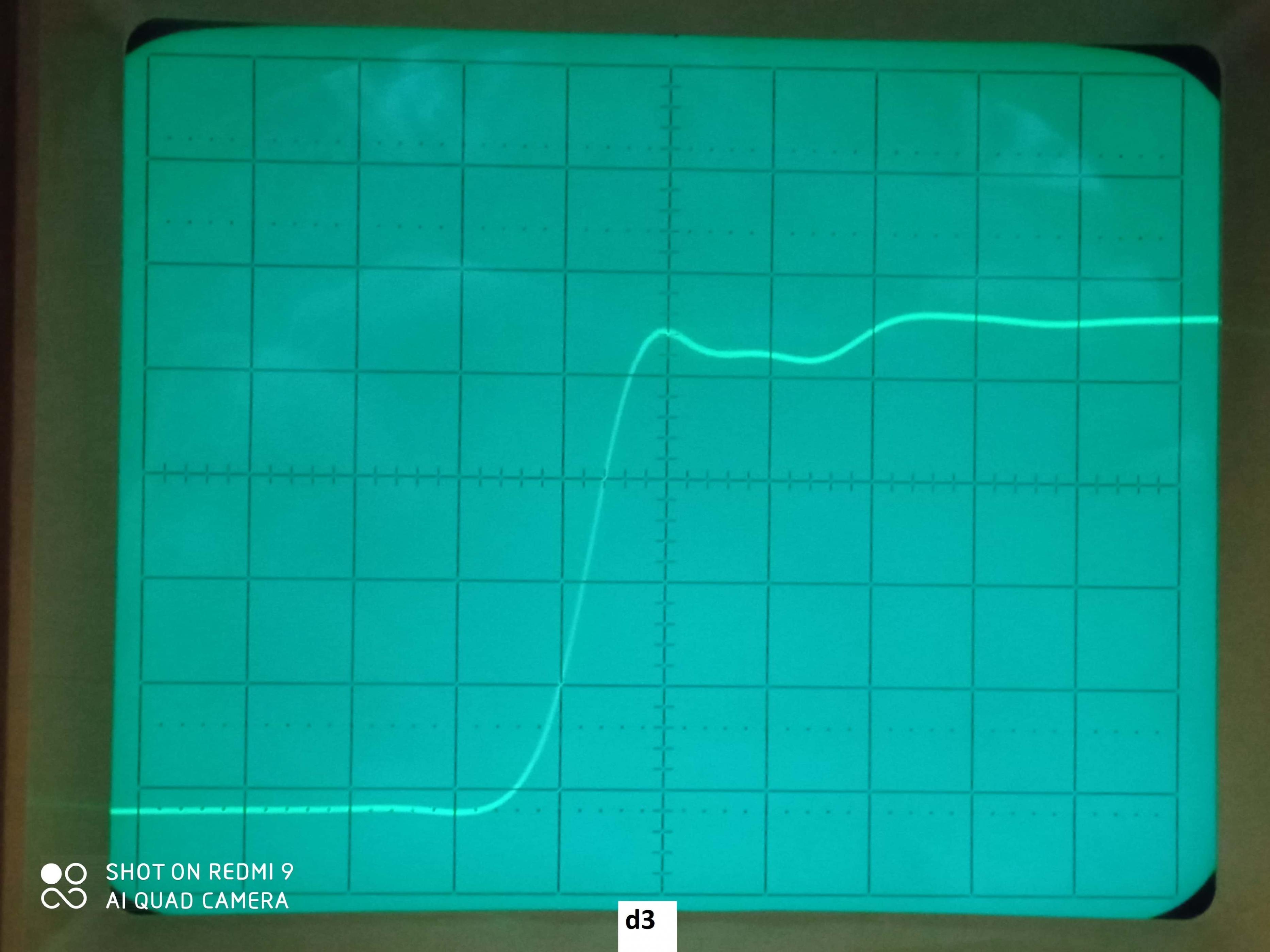

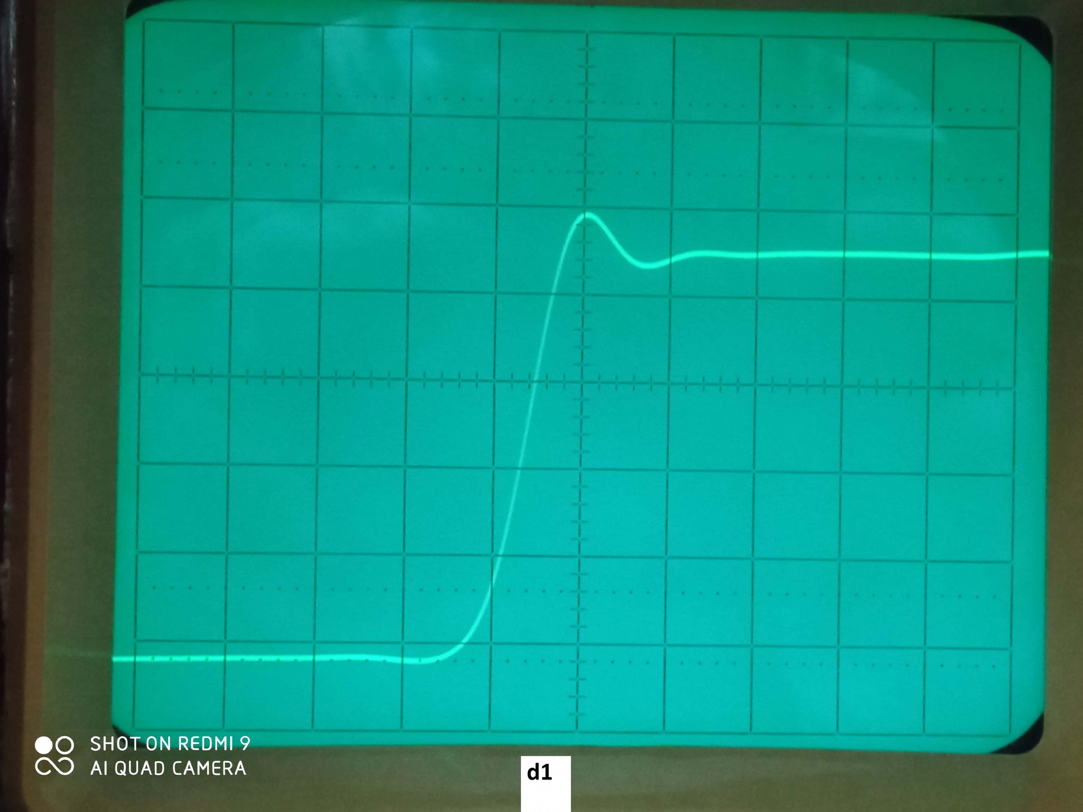

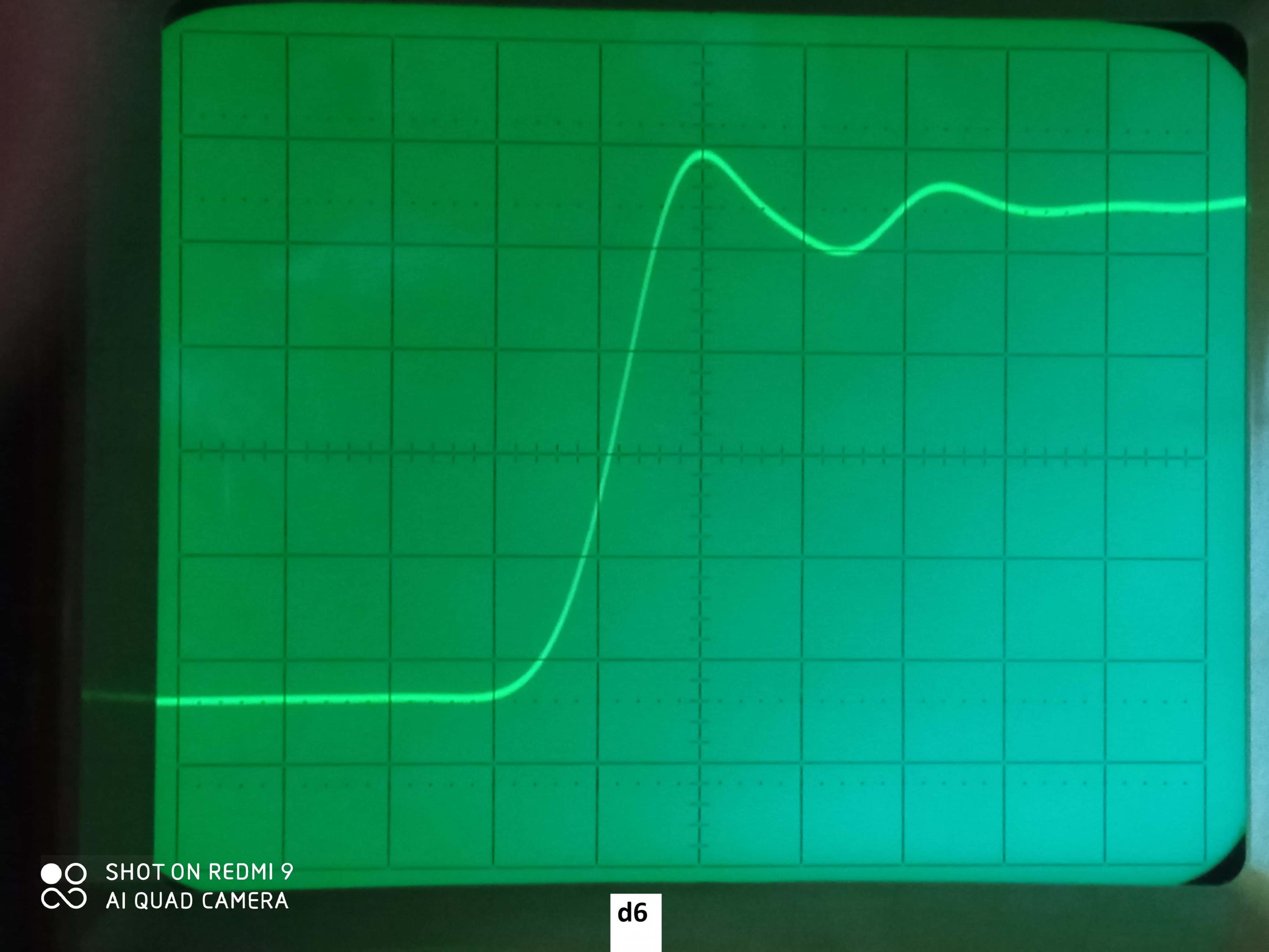

4th post
(x10)probes to 1 MOhm//20pF input.
.1V/div - 5ns/div
d1 TEK P6108A 100MHz (x10)probe with a ground lead length of 23mm
d2 TEK P6108A 100MHz (x10)probe (x10) with a ground lead length of 180mm
d3 e-bay 100MHz (x10)probe with a ground lead length of 23mm
d4 same e-bay 100MHz (x10)probe, now with a ground lead length of 160mm
d5 e-bay P6100 (x10)probe with a ground lead length of 23mm
d6 same e-bay P6100 (x10)probe, now with a ground lead length of 160mm
George

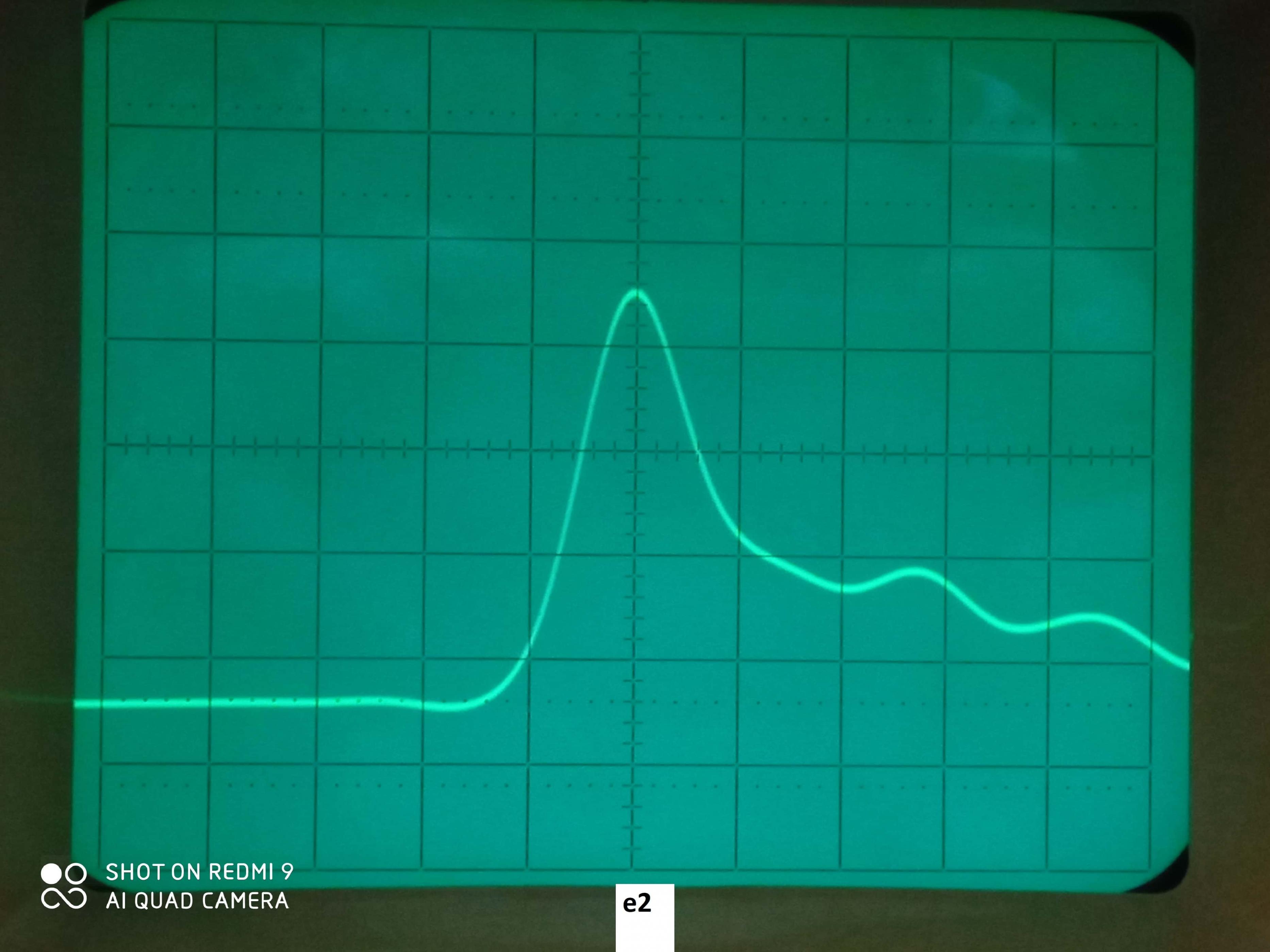

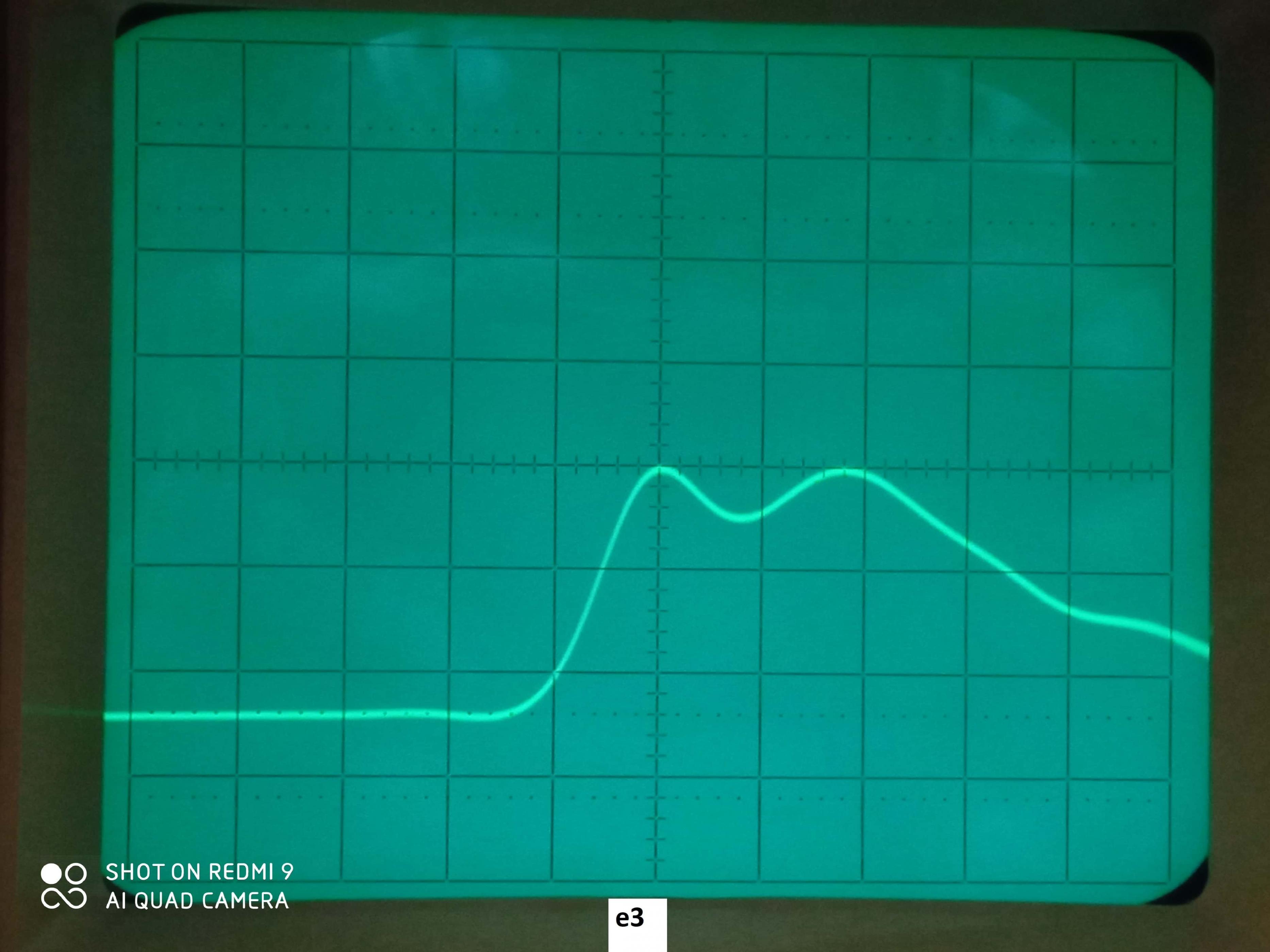

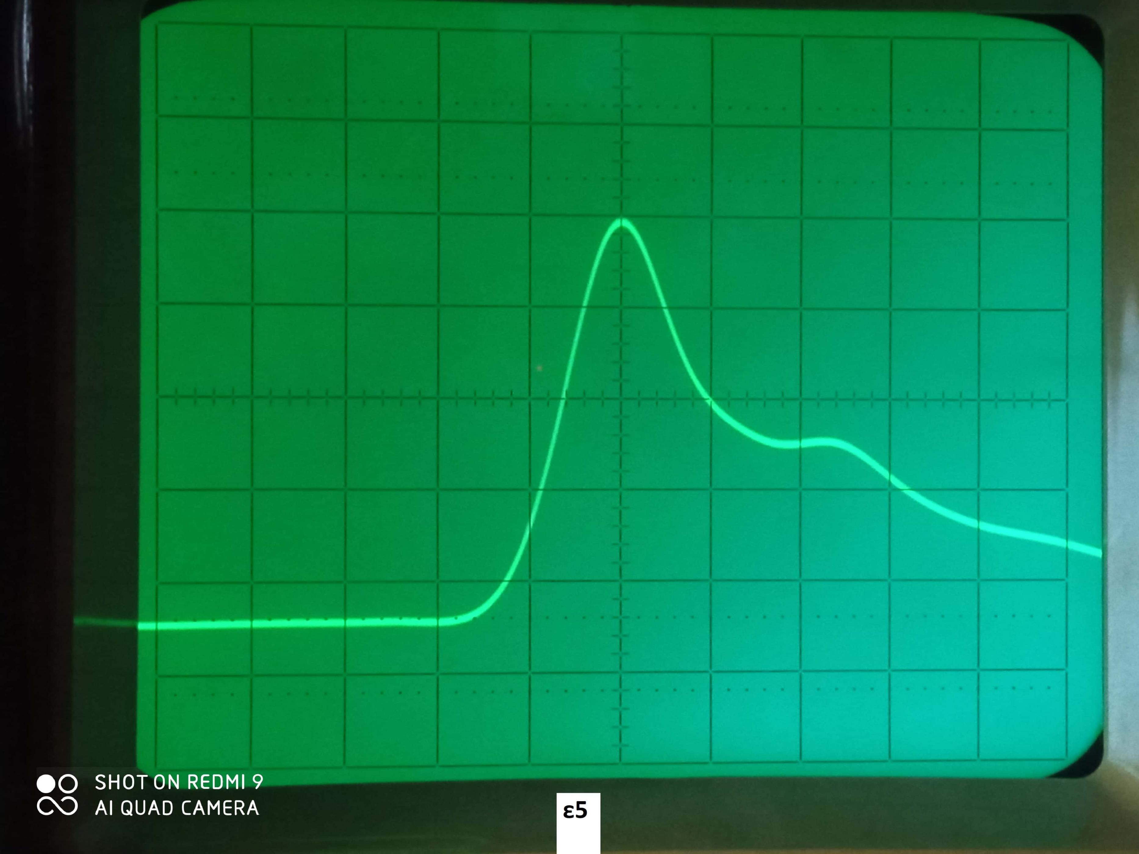

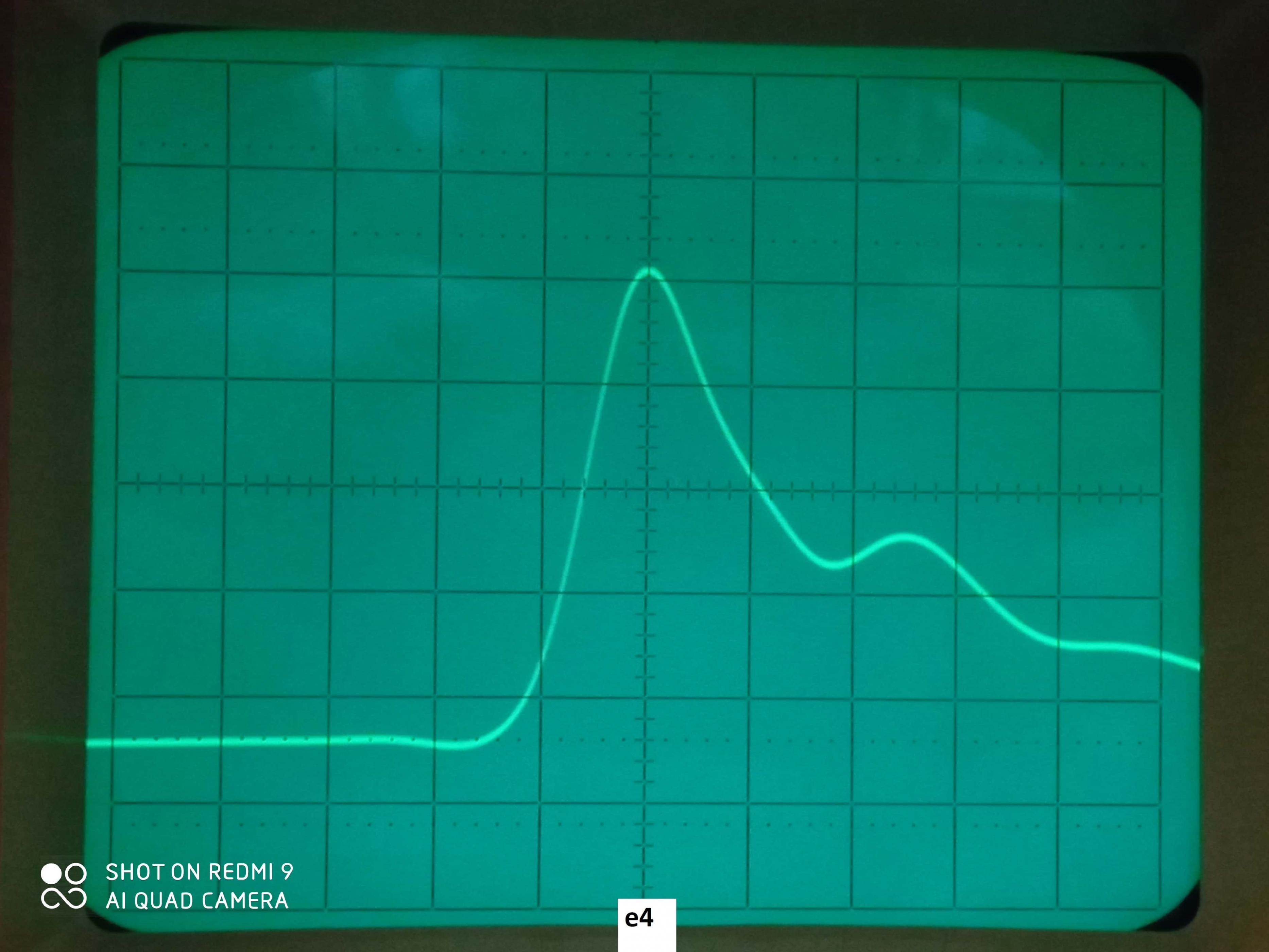

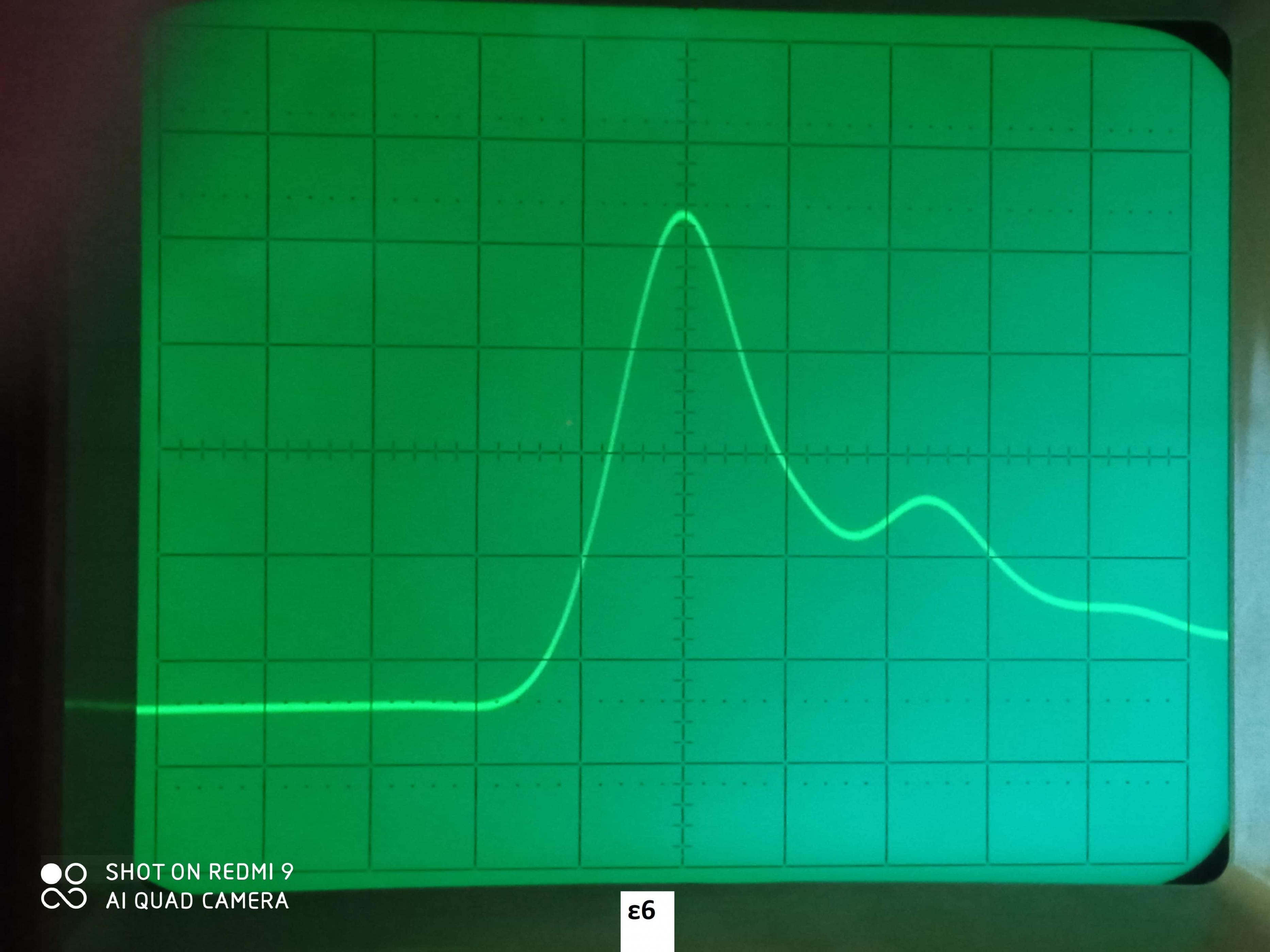

5th post
(x10)probes to 50 Ohm input
.05V/div - 5ns/div
e1 TEK P6108A 100MHz (x10)probe with a ground lead length of 23mm
e2 TEK P6108A 100MHz (x10)probe (x10) with a ground lead length of 180mm
e3 e-bay 100MHz (x10)probe with a ground lead length of 23mm
e4 same e-bay 100MHz (x10)probe, now with a ground lead length of 160mm
e5 e-bay P6100 (x10)probe with a ground lead length of 23mm
e6 same e-bay P6100 (x10)probe, now with a ground lead length of 160mm
George

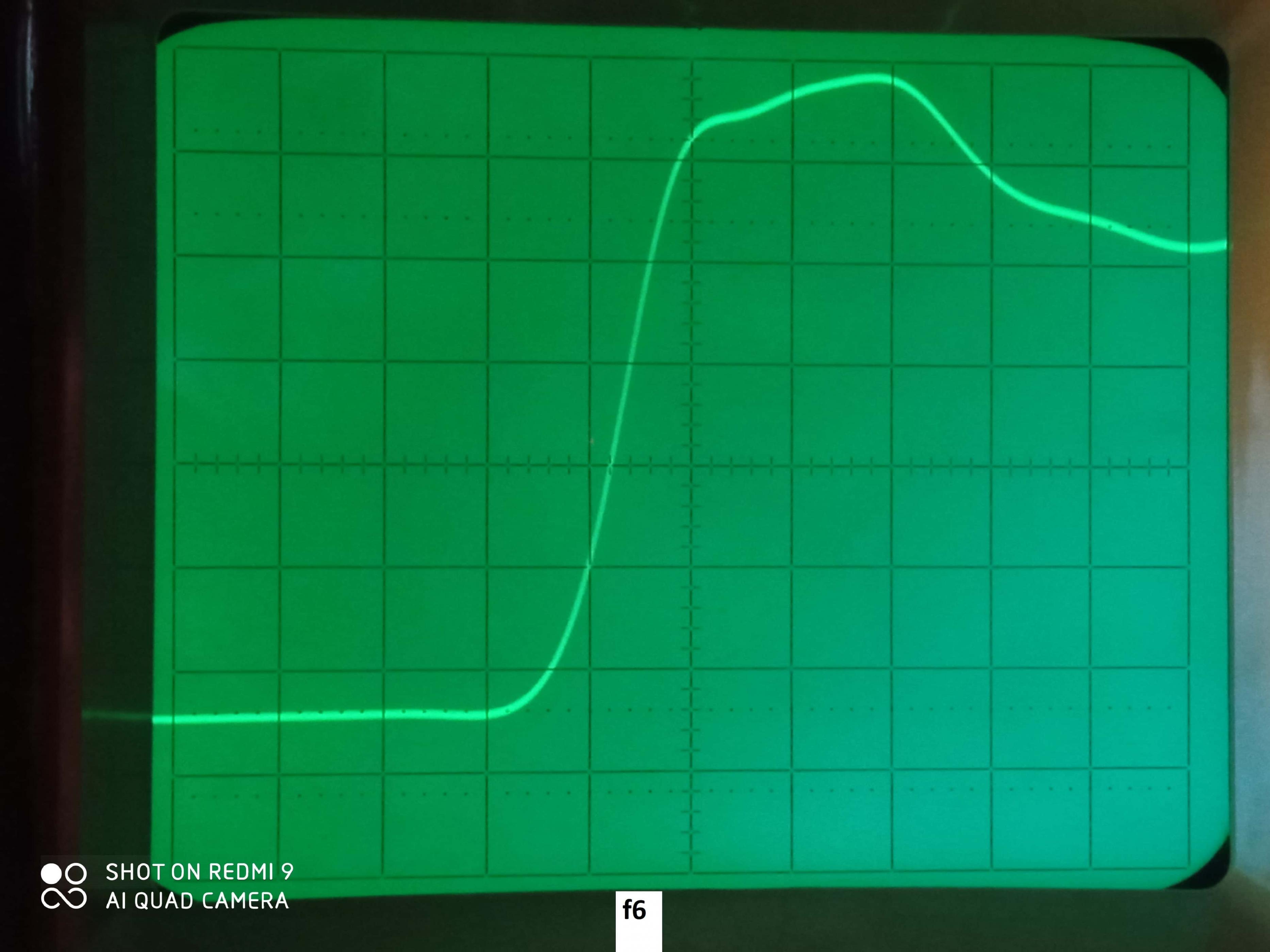

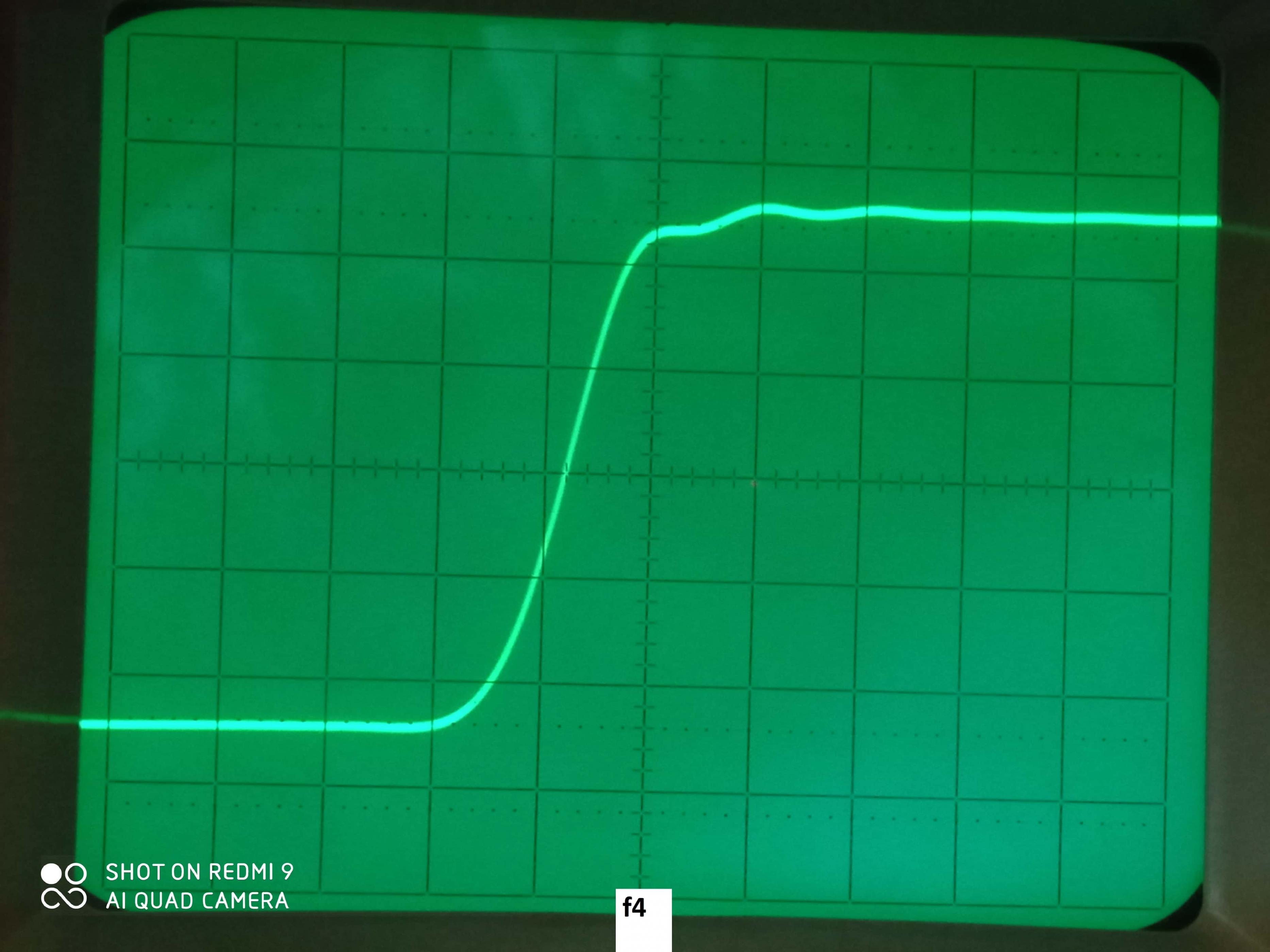

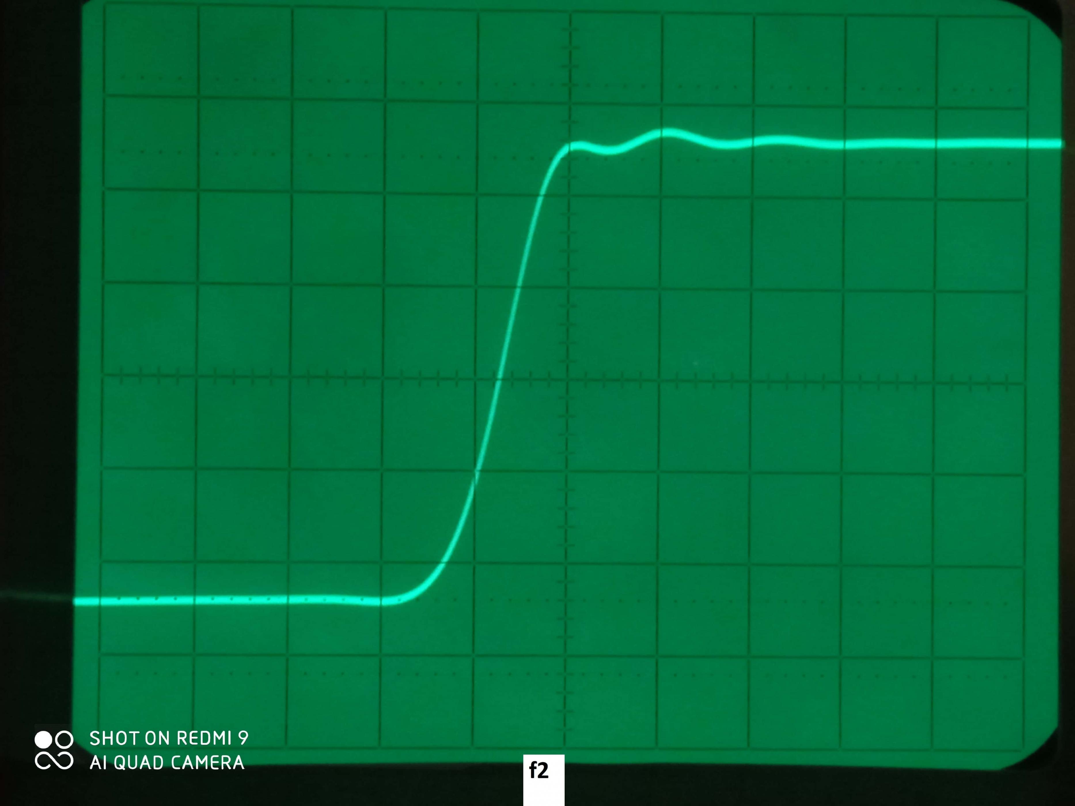

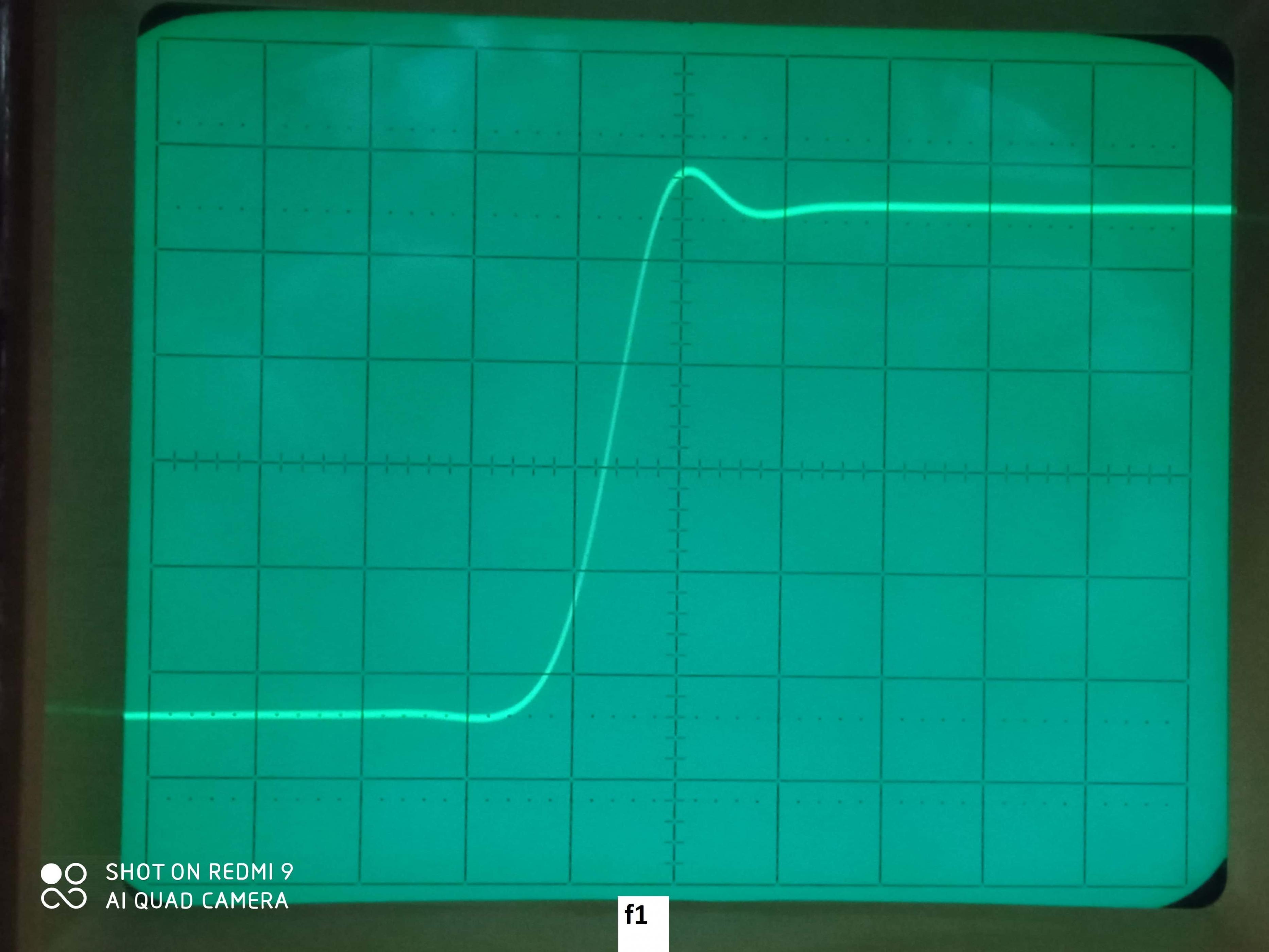

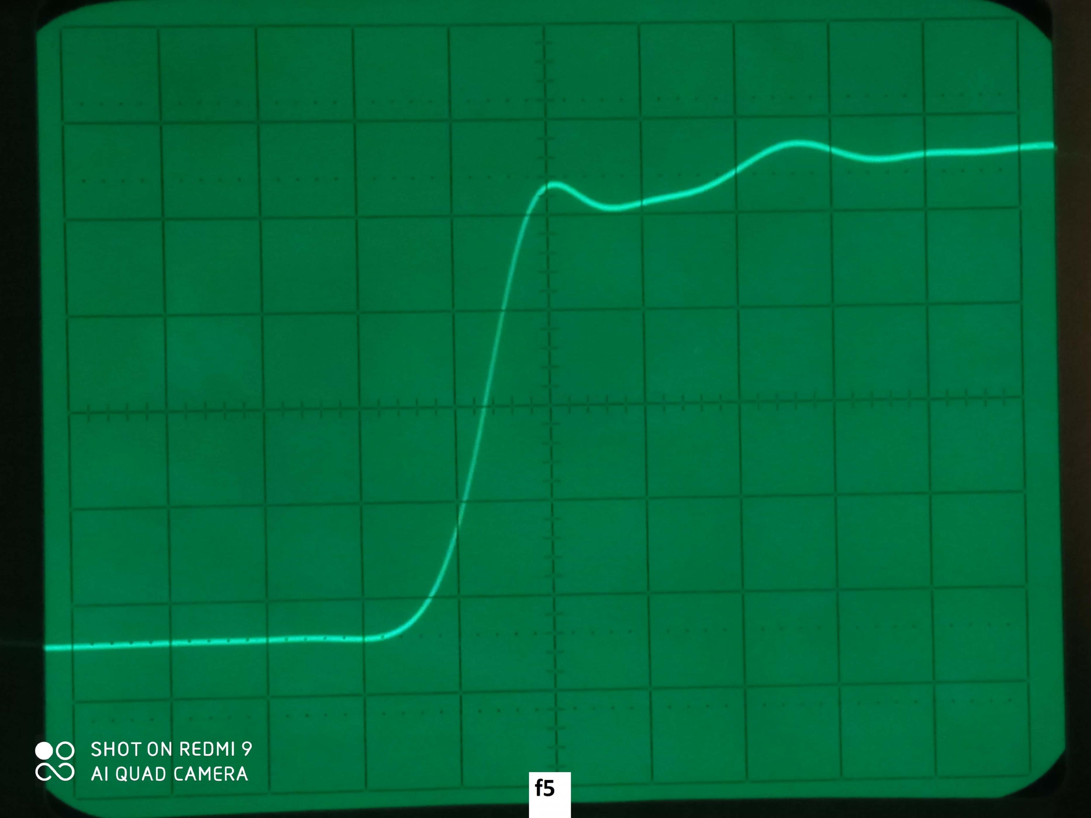

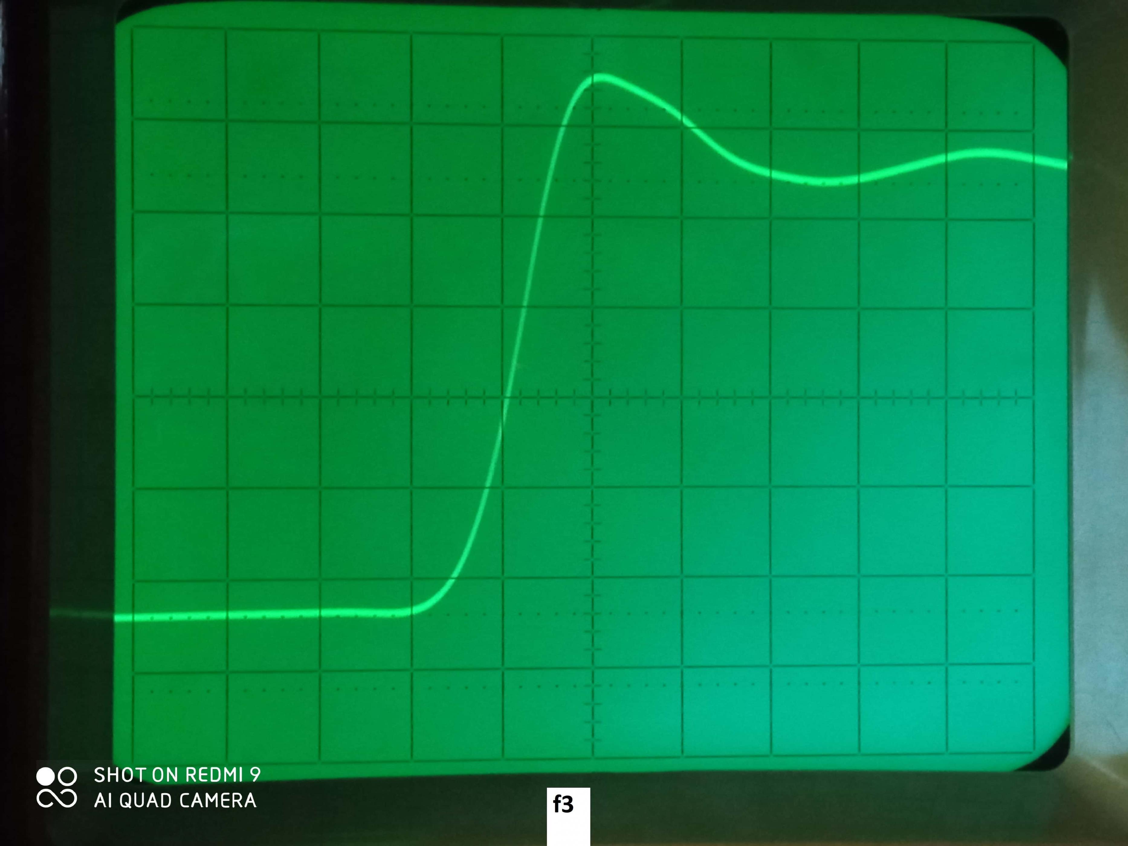

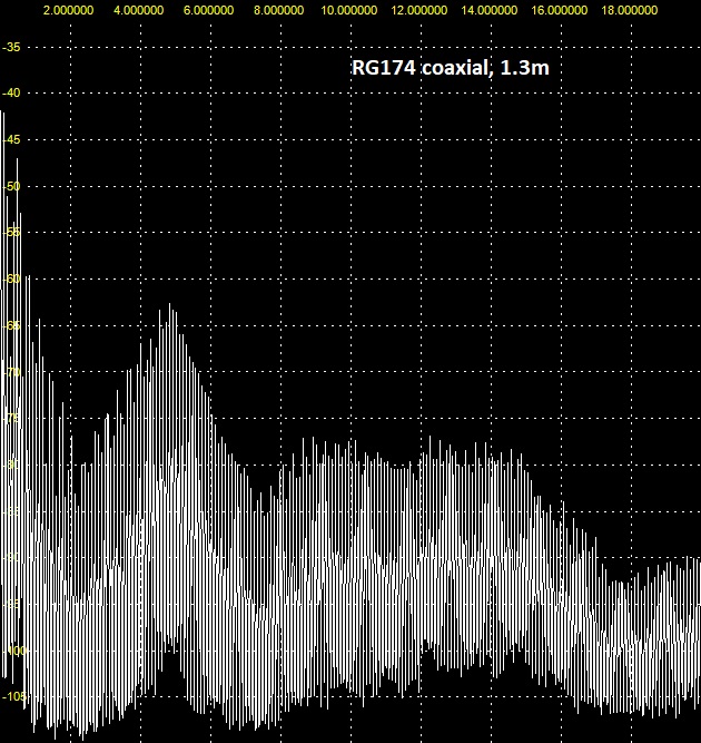

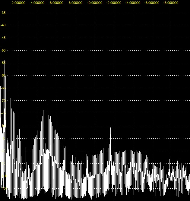

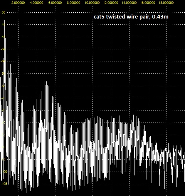

6th post
cables to 1 MOhm//20pF input.
1V/div - 5ns/div
f1 male to male BNC adaptor
f2 0.43m long RG174 coaxial cable, directly soldered to the gen out
f3 0.43m long twisted CAT5 pair, directly soldered to the gen out
f4 0.43m long audio coaxial cable, directly soldered to the gen out
f5 1.3m long RG174 coaxial cable, directly soldered to the gen out
f6 1.3m long twisted CAT5 pair, directly soldered to the gen out
f7 1.3m long audio coaxial cable, directly soldered to the gen out
George

George

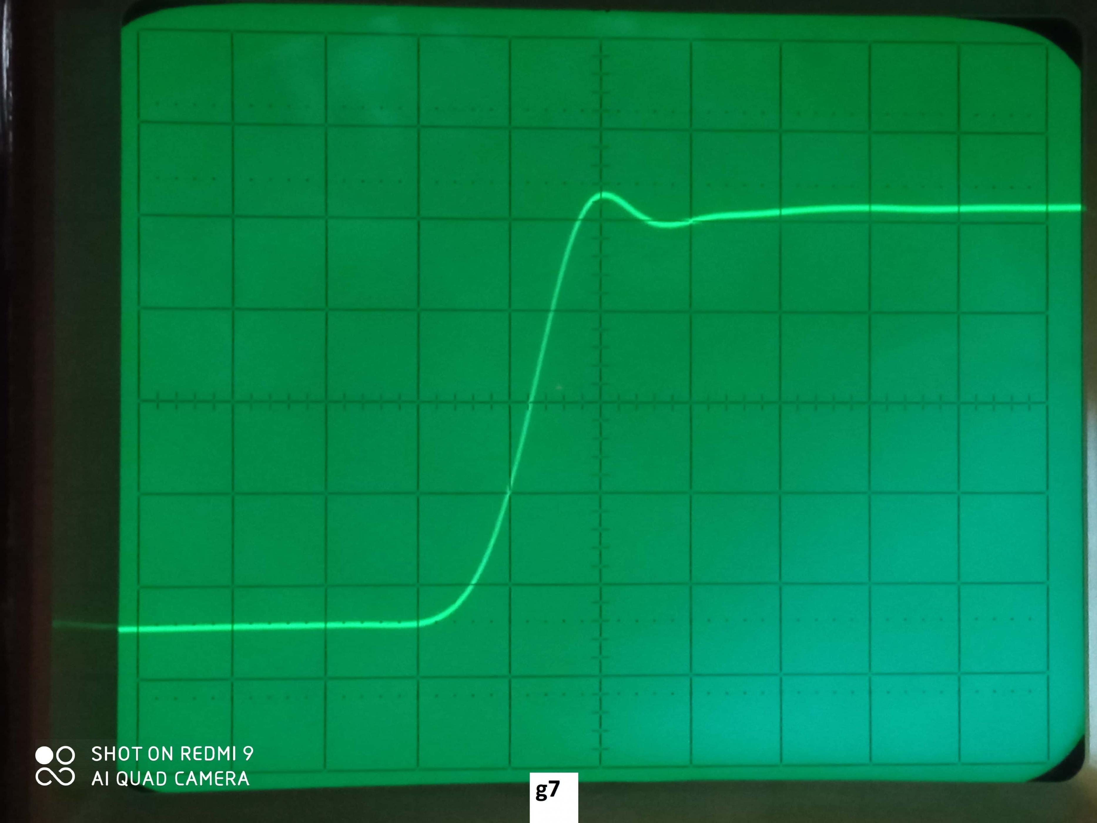

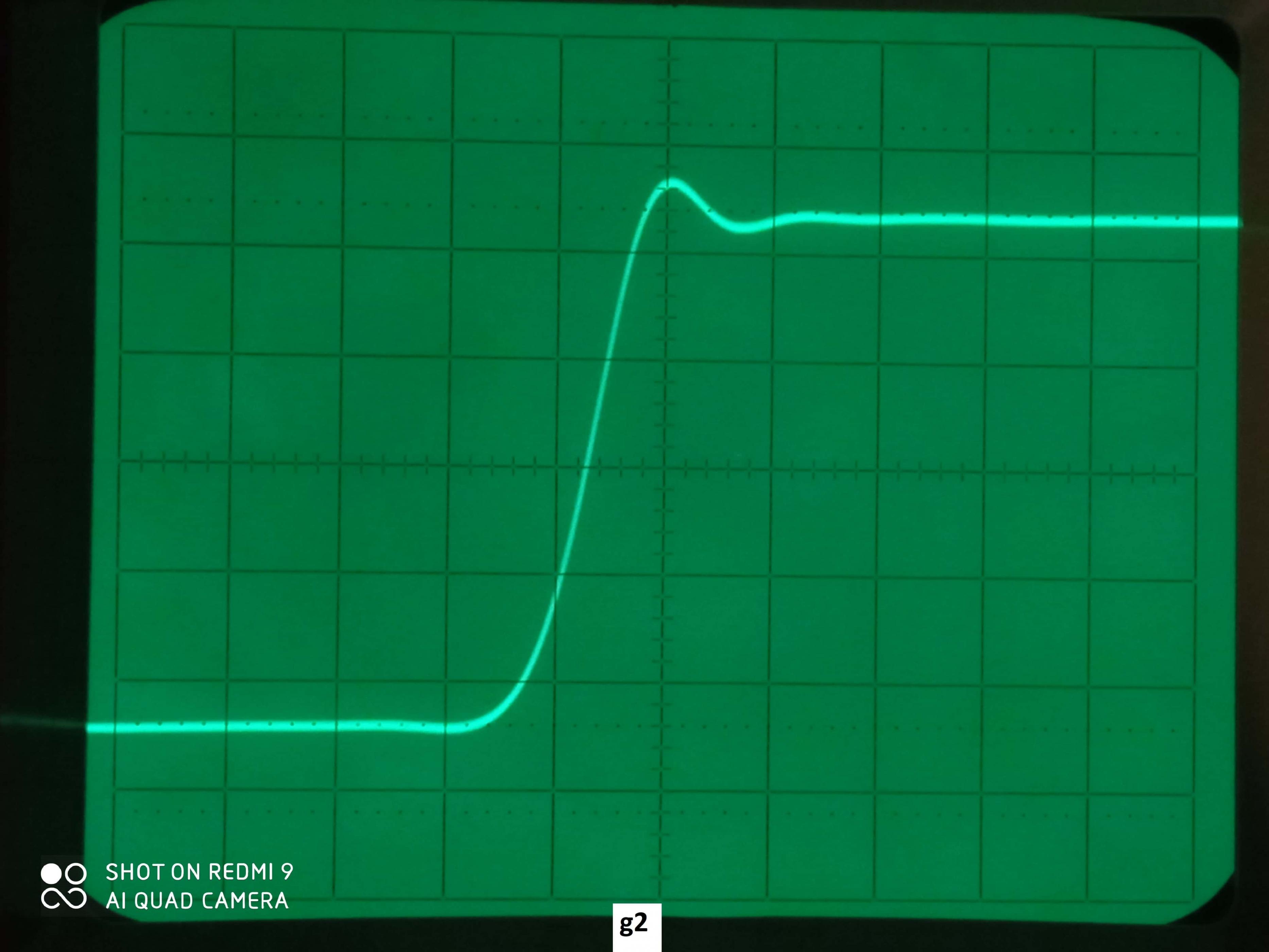

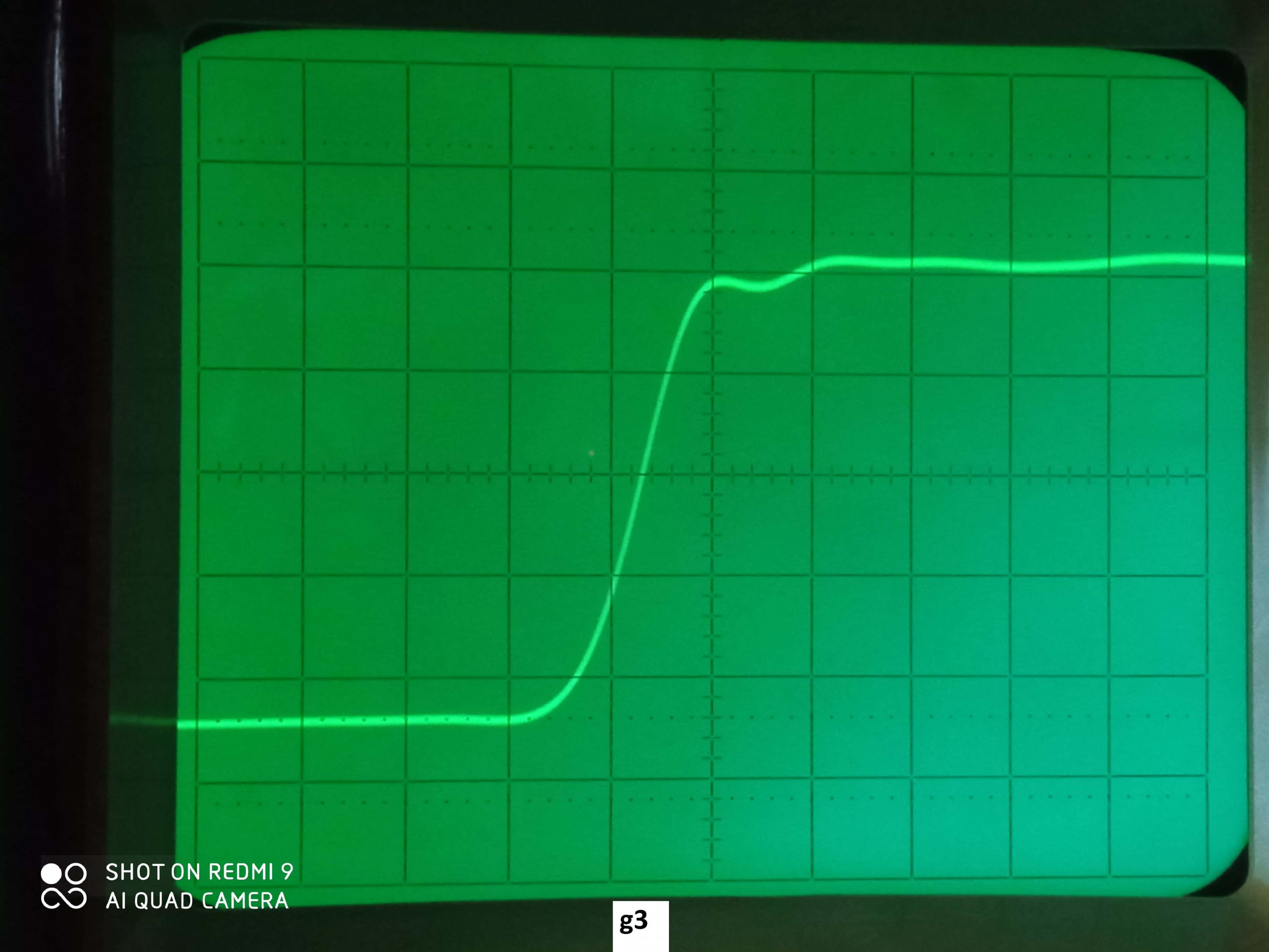

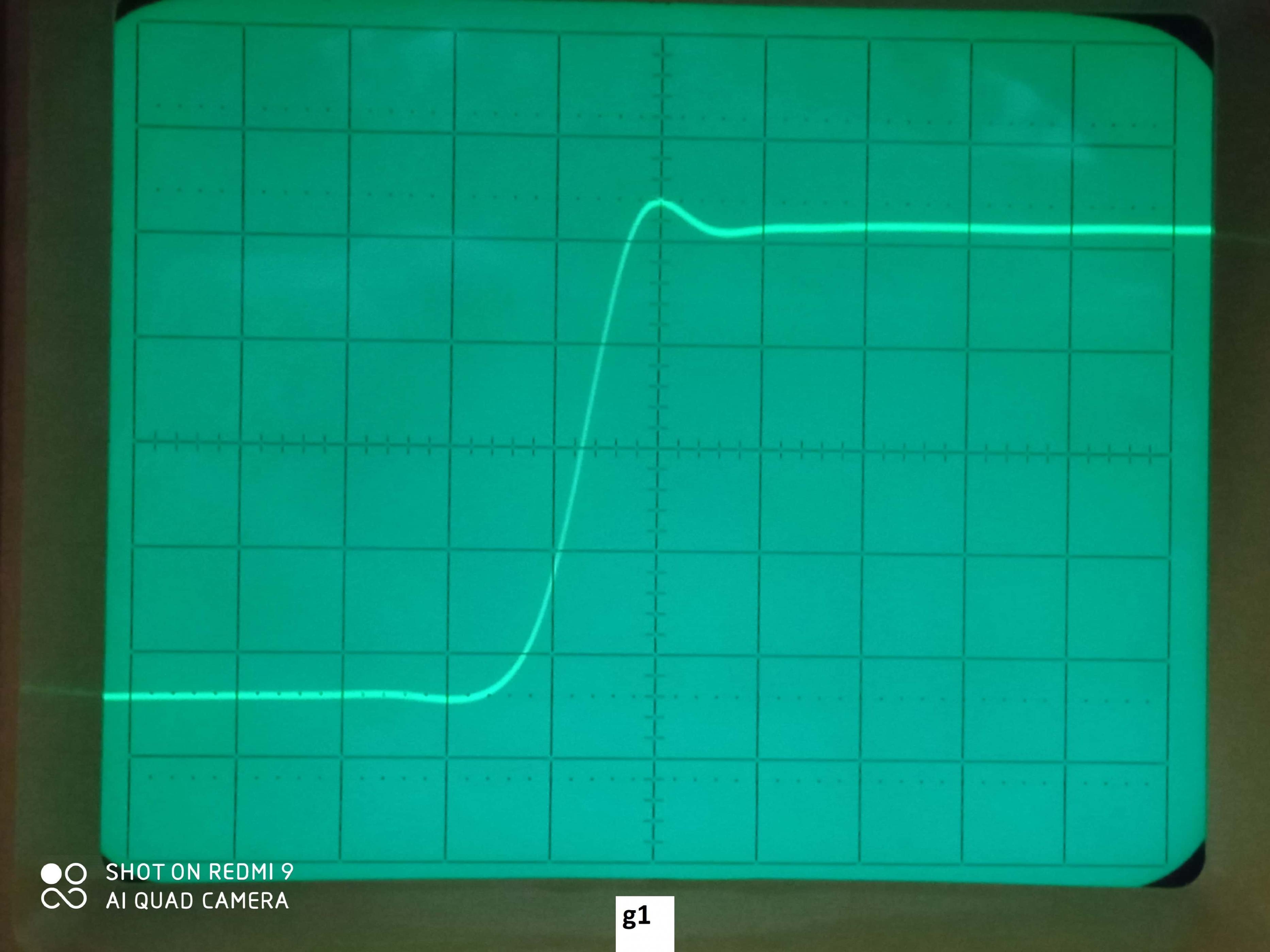

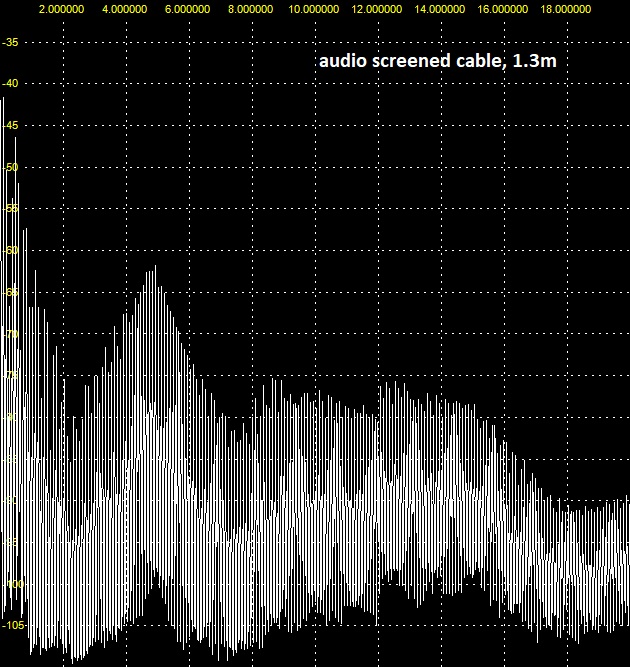

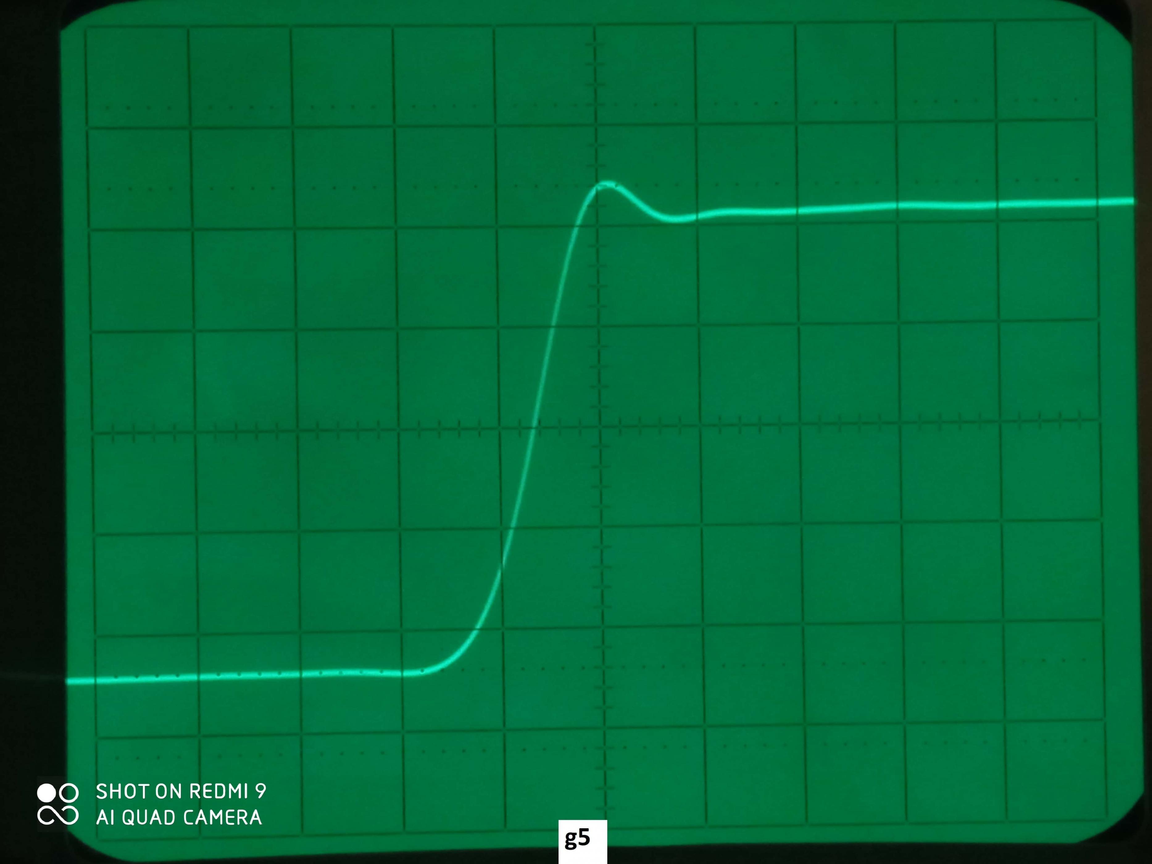

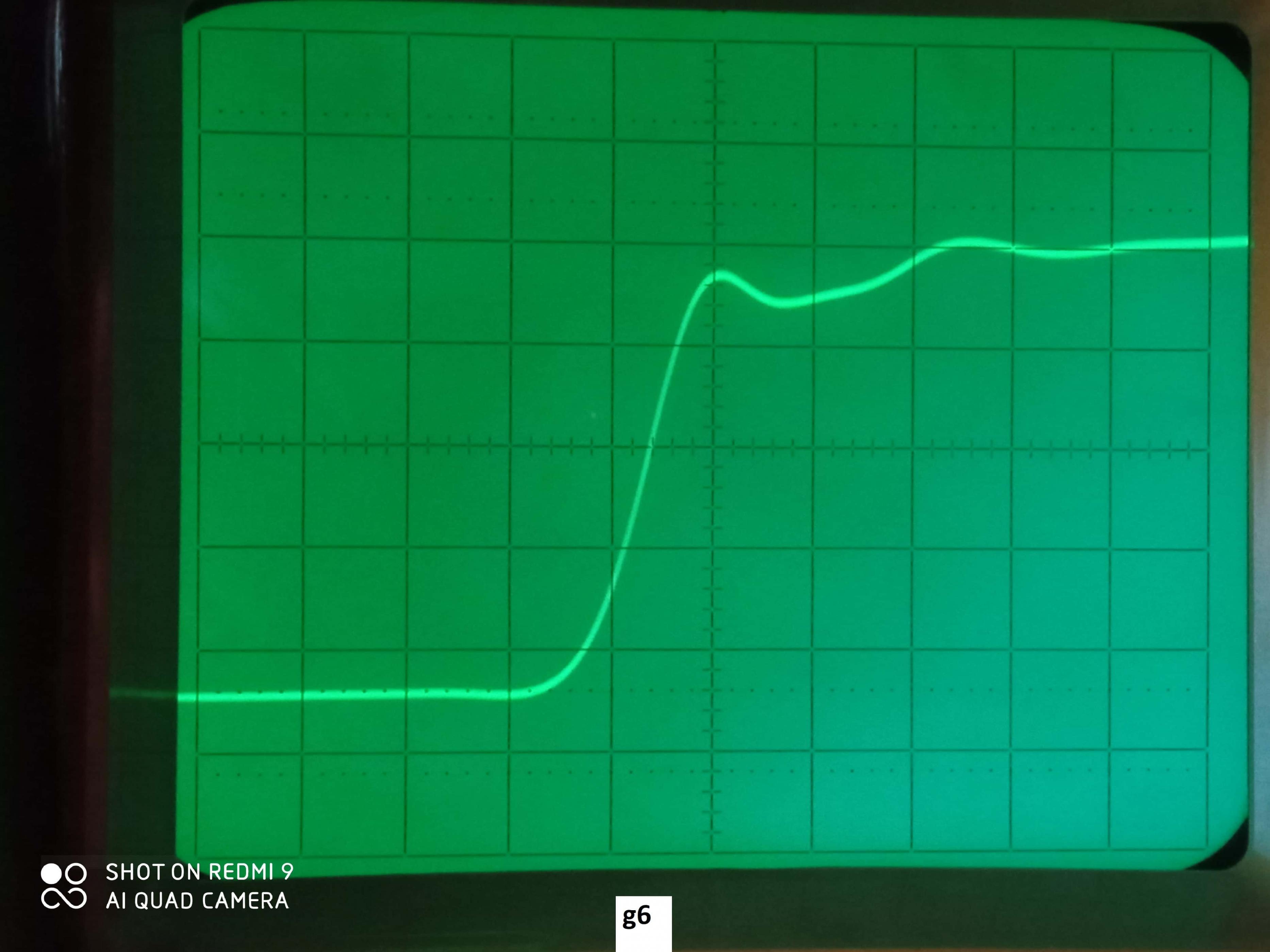

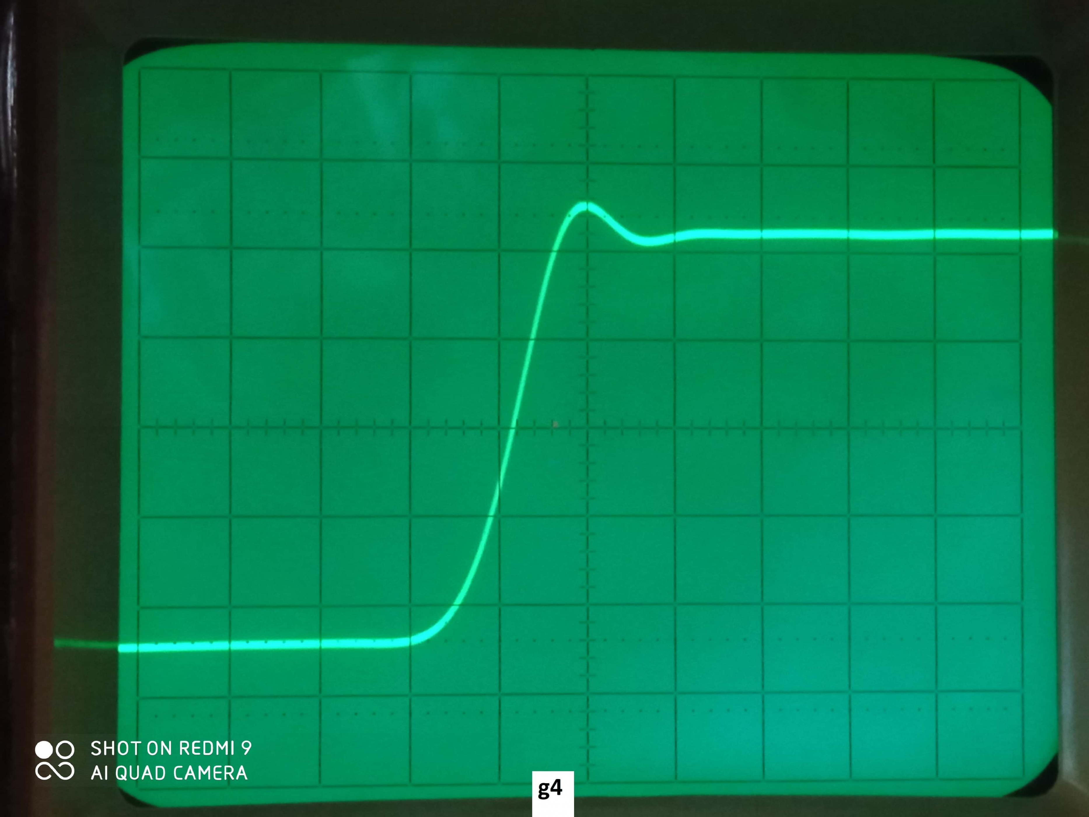

7th post (last one)
cables to 50 Ohm input.
1V/div - 5ns/div
g1 male to male BNC adaptor
g2 0.43m long RG174 coaxial cable, directly soldered to the gen out
g3 0.43m long twisted CAT5 pair, directly soldered to the gen out
g4 0.43m long audio coaxial cable, directly soldered to the gen out
g5 1.3m long RG174 coaxial cable, directly soldered to the gen out
g6 1.3m long twisted CAT5 pair, directly soldered to the gen out
g7 1.3m long audio coaxial cable, directly soldered to the gen out
George
1V/div - 5ns/div
George

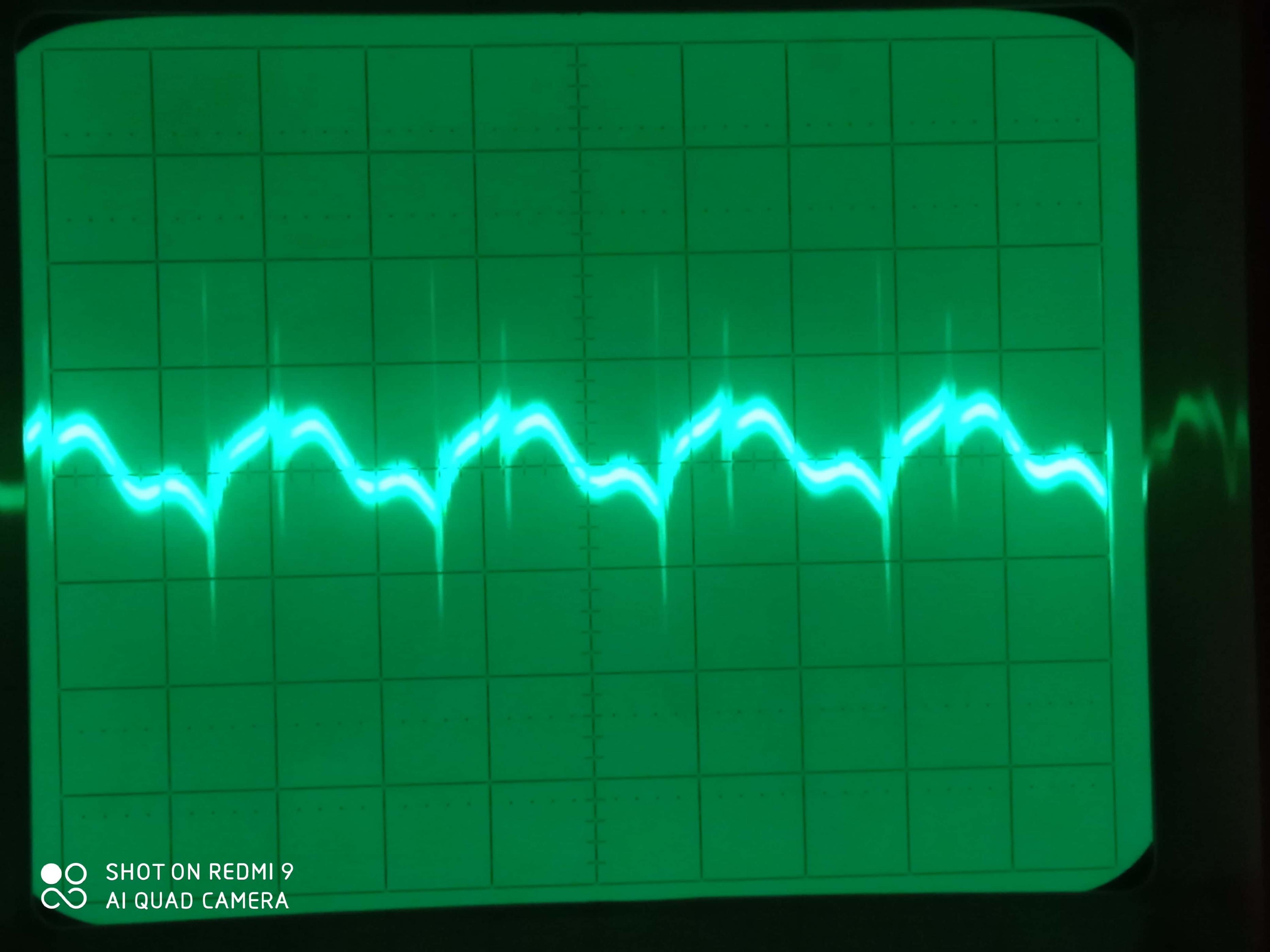

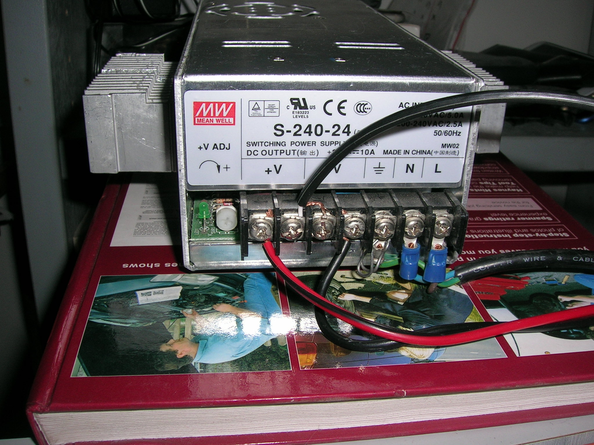

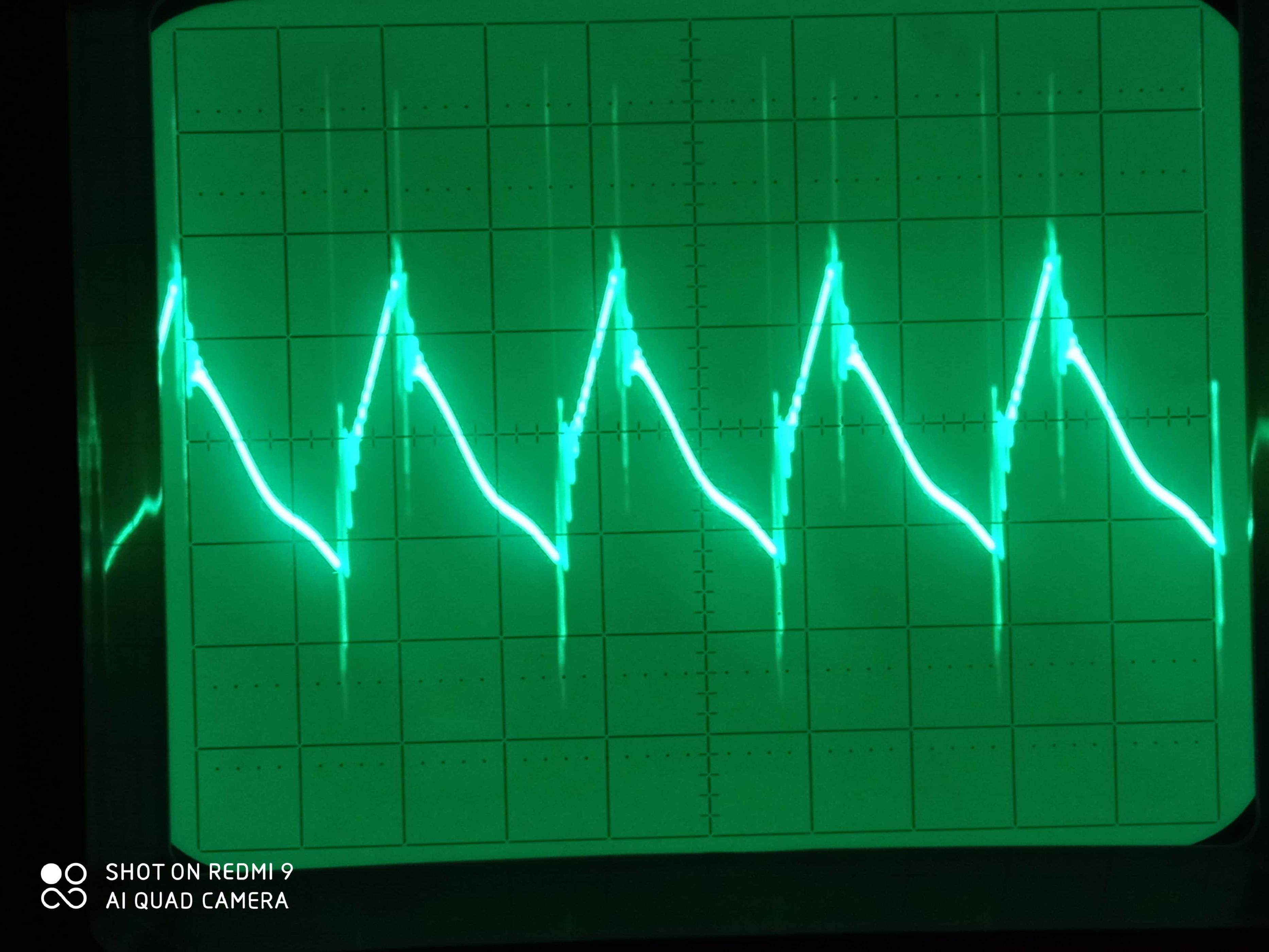

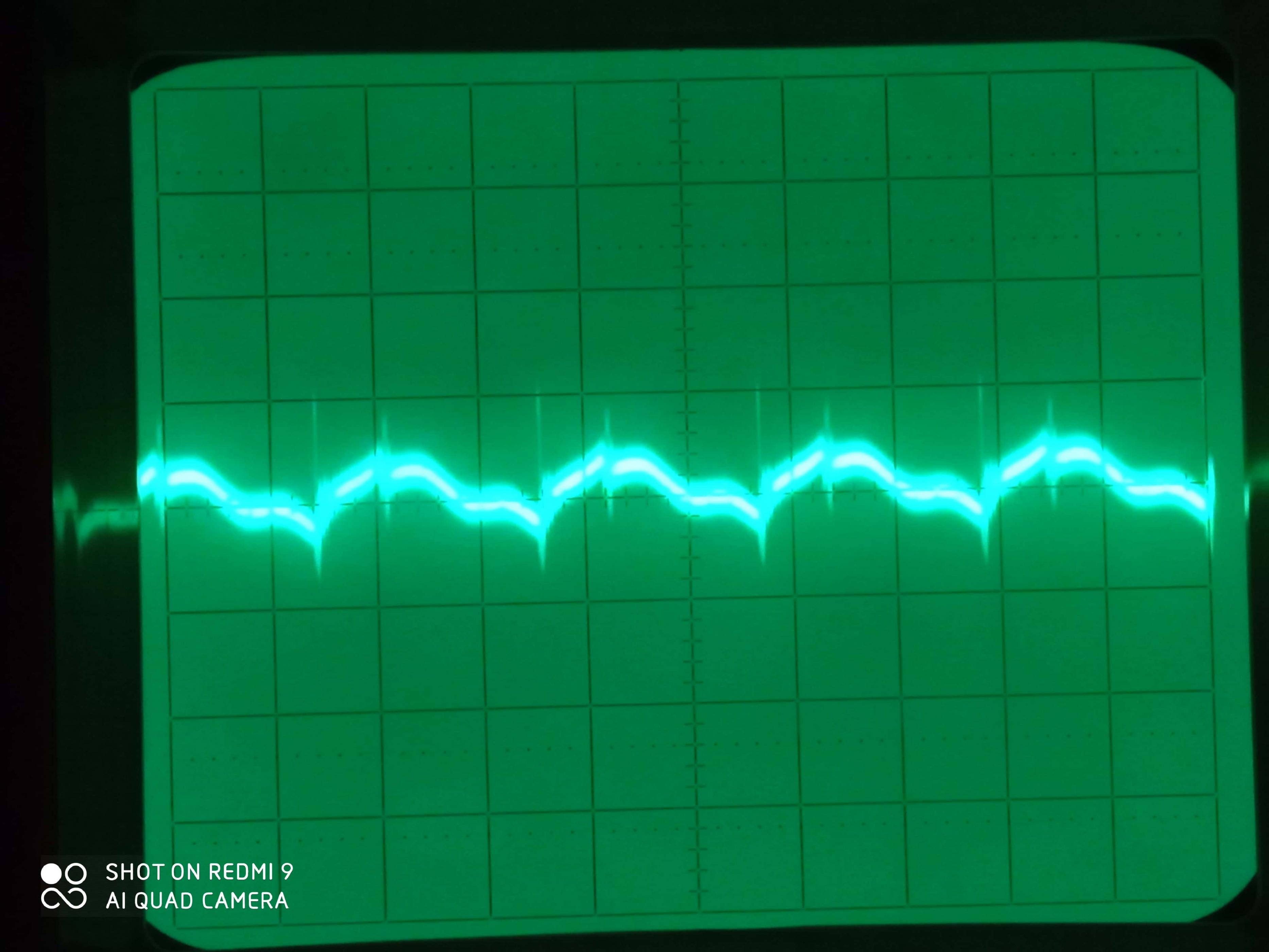

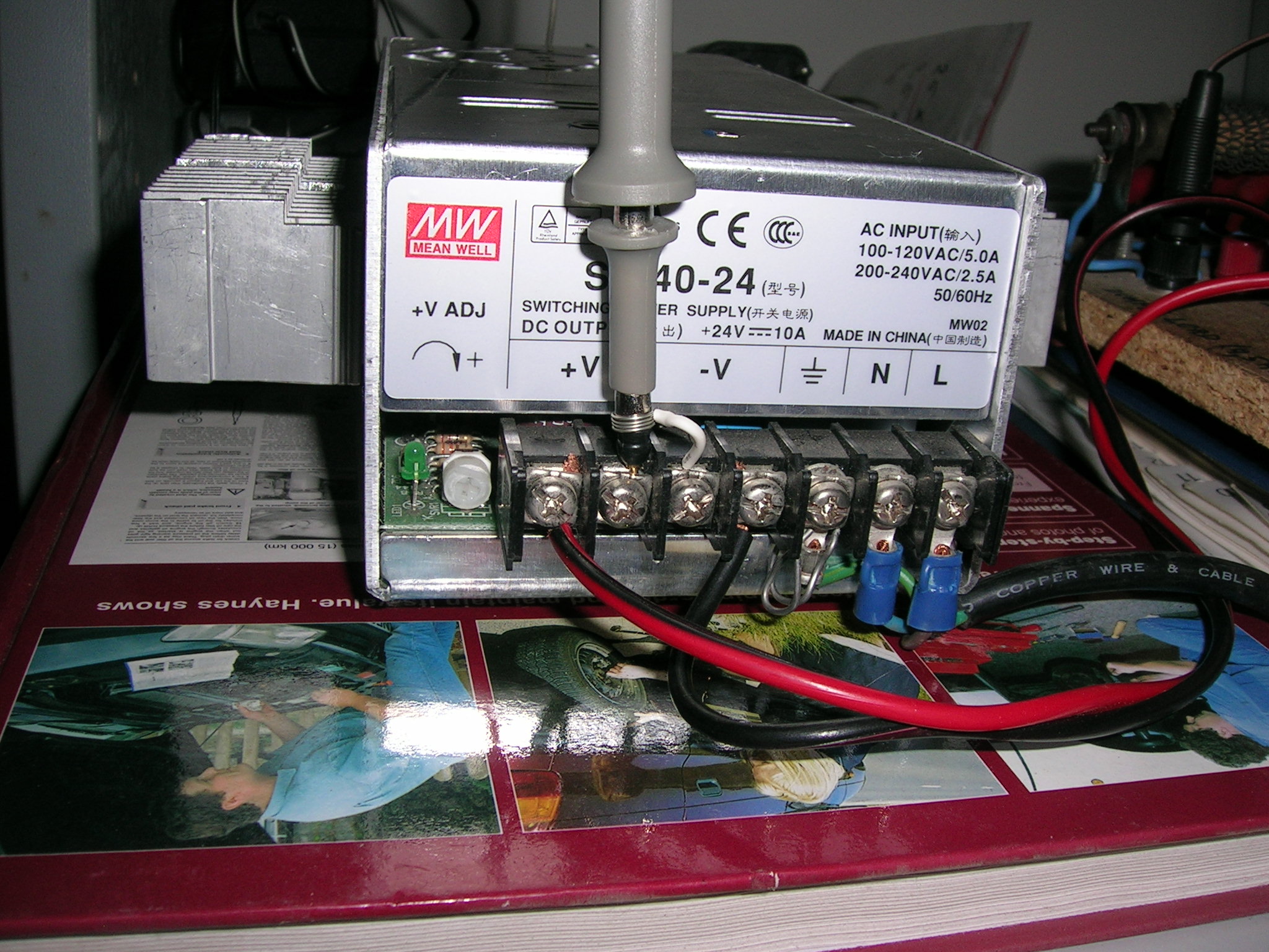

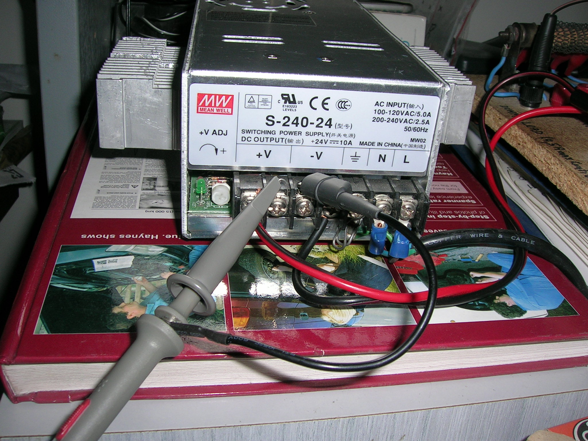

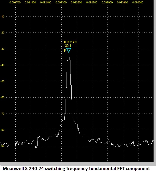

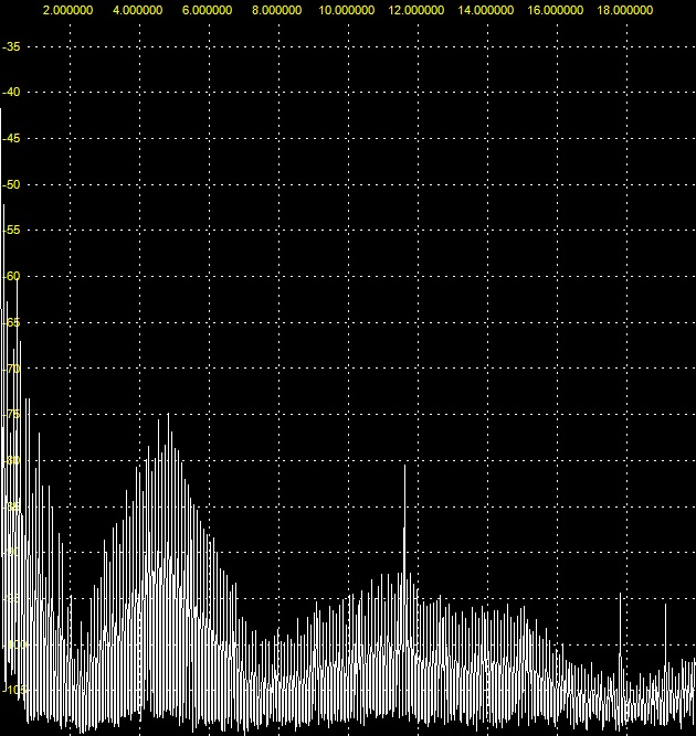

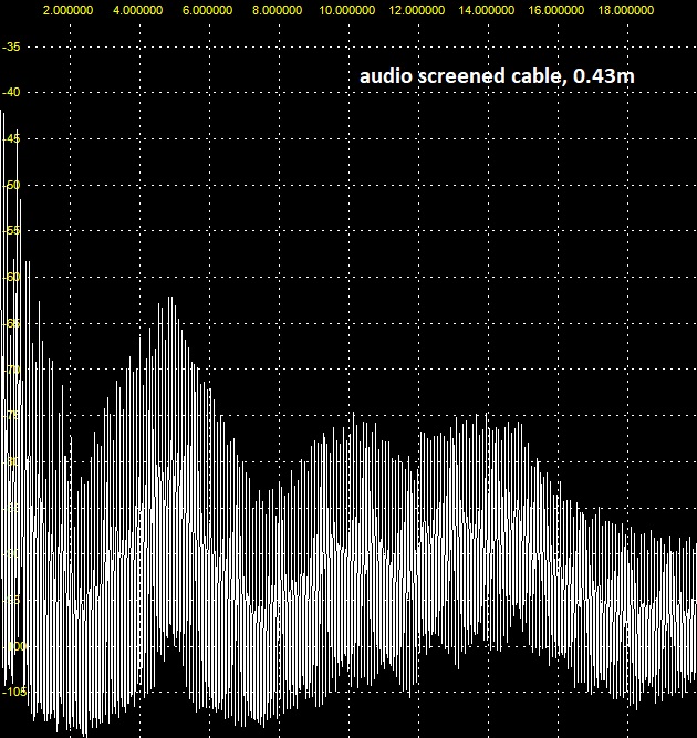

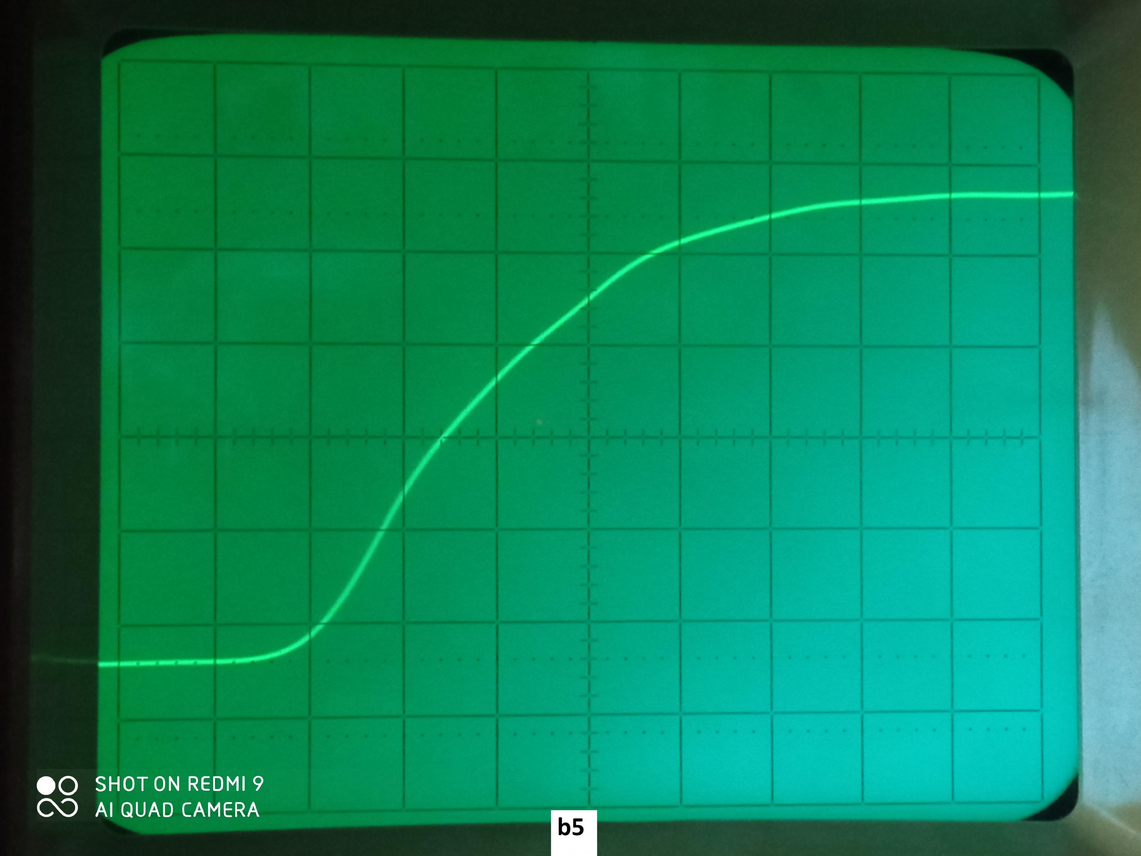

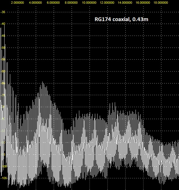

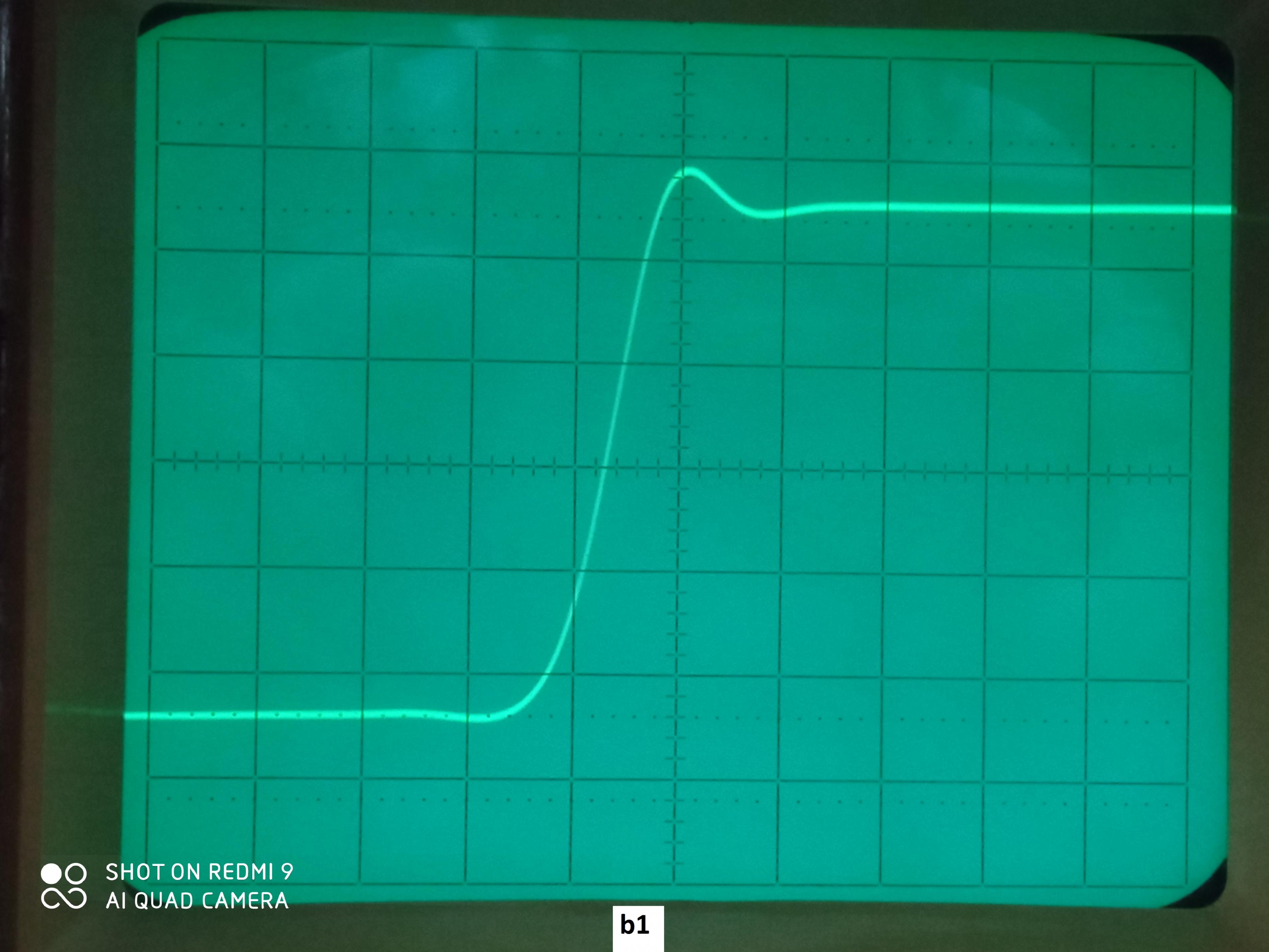

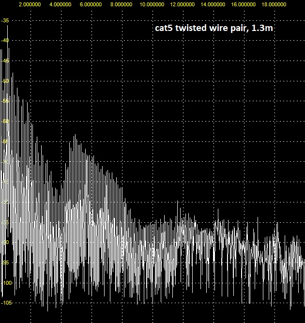

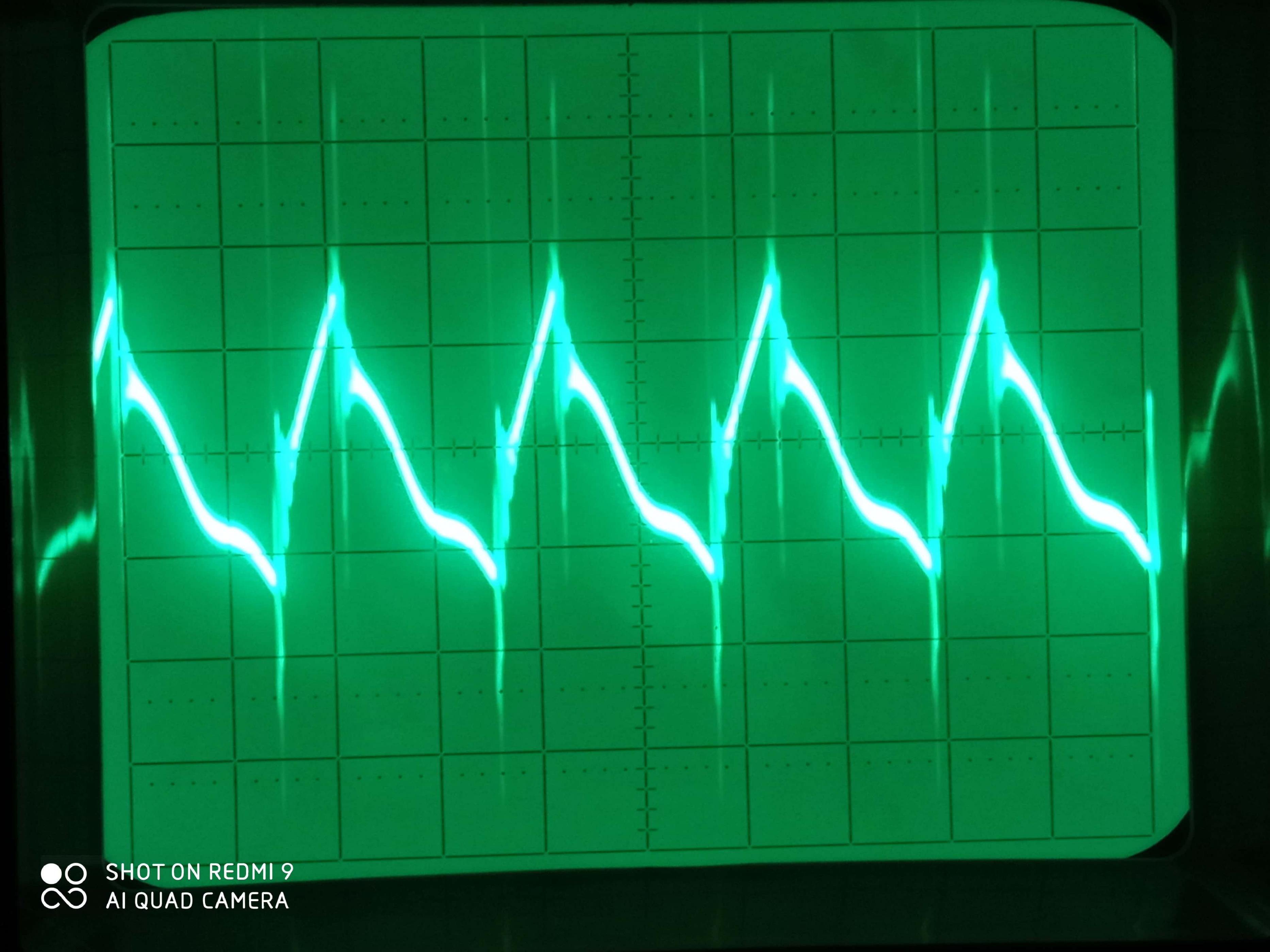

Here is the probing on a Meanwell S240-24 SMPS output on 3 Ohm load (8A)
Attachments are in pairs Oscilloscope screen and it’s FFT
Oscilloscope input set to 50 Ohm. All oscilloscope screenshots are .01V/div _ 5μsec/div
FFt is through a 50 Ohm input SDR (SDRplay RSP1A). All are harmonics of 92.4kHz switching freq.
George
George
continuous
