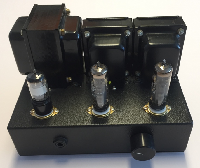

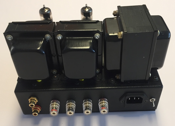

This is the finished amplifier. Magic eye tube is EAM86. The chassis is a standard electrical metal enclousure box 222 x 146 x 56 mm. Easy to source, as example: RS components 517-3260. If you choose this one, be sure to have proper drilling bits because it much thicker than regular aluminium enclousures such as Hammond 1444-1172 (a good choice for this amplifier, because it is bigger and you could increase the space between output and power transformer). I powder coated it after drilling.
