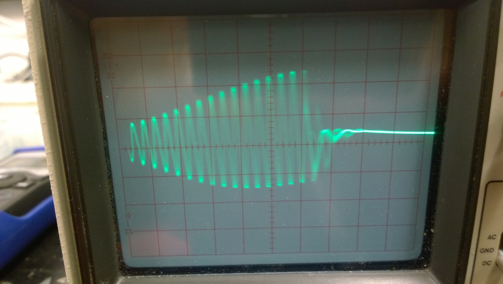

I was given a pair of Musical Fidelity X-A200 monoblocks to look at for a friend.
One was supposedly working, the other had a massive turn-on thump and gross distortion.
I repaired the problem one - it needed caps, a couple of resistors and some transistors. It now works perfectly.
However, when testing I noticed the other, supposedly working one had a really high level of hiss. Music plays and doesn't sound distorted but the hiss is always present even with the input shorted.
The amp biases up correctly and bias is stable. It doesn't seem to get any hotter than the working one
Broke out the 'scope and below is what I see on the speaker terminals. It's the same with or without a load connected.
Pictures are at 2v/div. So there appears to be an 8v p-p burst oscillation.

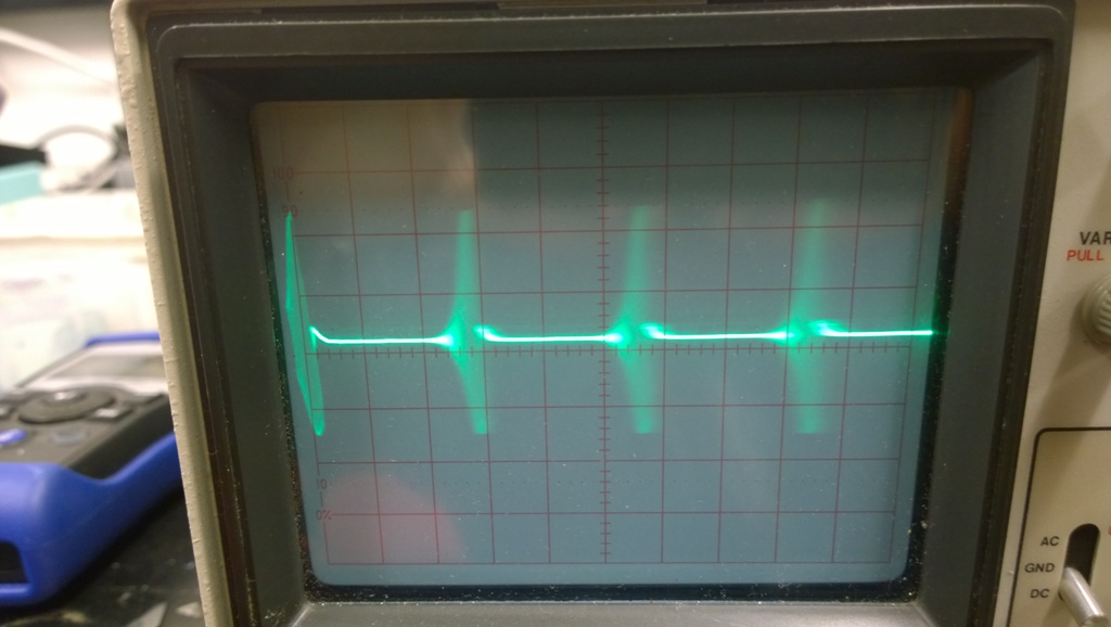

Picture 1 is at 10us/div so the bursts are at about 35kHz.
Picture 2 is at 0.5us/div zoomed into one of the bursts showing about a 5MHz oscillation.
The other amp (the one I repaired doesn't show anything).

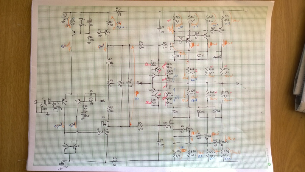

Picture 3 is a rough (very rough) tracing of the circuit from when I had the other amp apart.
All small sig transistors are mpsa42 & 92 and input pair up to VAS seems pretty standard.
The cfp output stage is a buz901 & 906 driving parallel mag1832 & 2013 (2sc5200 & 2sa1493 in my repaired and working amp). This is the part I'm not too familiar with...
Anyone seen this type of oscillation before who might be able to point me in the direction of a cure?

Is their a Zobel network / Boucherot cell across between the output and ground not shown on the circuit diagram?
If so is the resistor and capacitor intact? They can help to keep the output stage stable.
Yes, not shown on diagram. 3 x parallel 15R resistors and 220nF cap to ground, 3R3 resistor and coil to binding posts.
Seem to test ok.
I haven't seen this type of instability from dodgy zobel though.... has anyone?

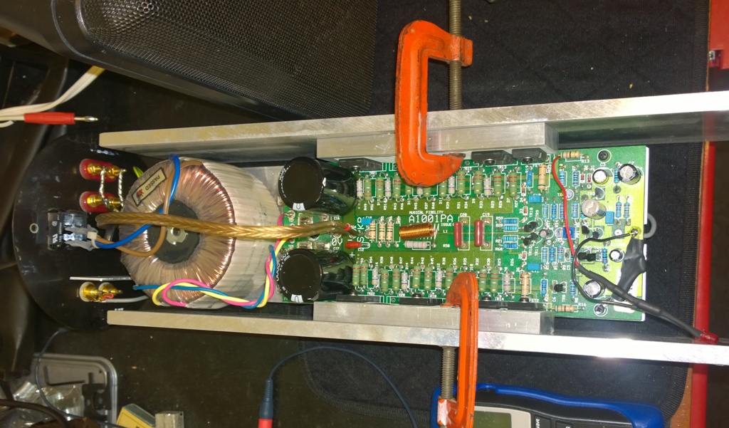

Here's the other one I had out and mounted to a temporary heatsink while testing...
The instability frequency tends to make me think it is the output stage oscillating.
The resistors and capacitors in series with the MOSFET gates along with the 5R Zobel network look like trial and error design to keep the output stage from oscillating. The transistor type change could require another round of experimentation to keep the stage from oscillating.

Interestingly, I removed the amp from its case and clamped it to some temporary flat bar heatsinks as per my earlier pic....
Now the oscillation is a constant 2V p-p 5MHz without the 35kHz "burst"...
Since the actual case is grounded I grounded my temporary heatsinks together to the mains earth tag and the "Burst" comes back as per my first post...

I tacked a 180pf across each of the two 330pf caps on the mosfet gates...
Now I notice the following changes...
Oscillation looks much like in post one but a bit blurrier(?) on the scope.
I also noticed the bias value (across output emitter resistor) had decreased from 20mV to 8mv... Tried to adjust bias and it rises to 10mV at about 60% on the pot and then drops to 0. When it drops to 0 the oscillation also disappears. When I turn the pot back down the bias suddenly re-appears at about 10mV and can be adjusted down from there. When the bias comes back the oscillation comes back.
I removed the ground connection from the heatsinks and see the following:
5MHz oscillation of varying amplitude but about half what it was previously.
Bias is back to being fully adjustable throughout range of pot.
Shape of envelope of oscillation amplitude varies with adjustment of pot!

The 470pf could be to try and stop rf (radio frequency) interference getting into the amp via the speaker leads acting as long wire aerials.
If there a problem around the 330pf caps then bridging them would kill the oscillation instantly.
The fact its changed when you remove the amp from its case is pointing to something critical in the grounding of it all. No screws missing when its all assembled ?
Faults like this are hard to diagnose without having it in front of you. Using your scope, select the main grounding point in the amp for the scope probe ground and then check the ground points in the amp with the scope. Make sure that they are at ground and that no hash/oscillation is seen. Make sure the input ground is clean and also the feedback ground return on C4.

Oooh. Now that does sound interesting. Could the original cap in the Zobel be open circuit ?
That's the weird thing. The cap reads 220nF on the Peak LCR meter. The 15R resistors read 15R! There's continuity from the ground side of the cap to ground, from the cap to the resistors and from the output side of the resistors to the output stage!
I replaced the 220nF with a 470nF and left the resistors alone - stable!
It's back in its box and playing music and all is well with the world...
I can only think that these things are right on the edge of instability and something's drifted just enough to push it over the edge!
Part of it must stem from capacitance across the silpad insulating the outputs to ground...
Makes me really dislike amp designers who design things so close to broken!

That all sounds very promising. Normally the Zobel network is pretty uncritical, 47nf, 470nf 4.7 ohm, 15 ohm, it doesn't normally make any real difference as long as 'something' is there.
It would be interesting to try a new 220nf for curiosity but the 470nf will be fine.
Things like that are weird, and as you say, it may well be a design on the edge of instability.
