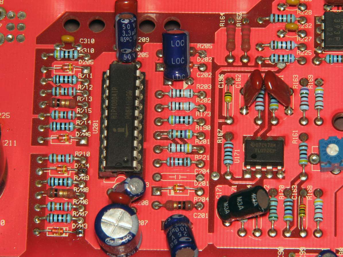

I was referring to the IC in the center of the board. See attached.
The photos I have don't show the resistors you need very well. It's common to see 100 ohm resistors in the amps with parallel diodes. This one has no diodes. The photos look like the resistors may be 10 ohms. This is not definitive. If you're not rushed to get it repaired, give it some time to see if someone can give you a definitive answer.
If the outputs failed, It's unlikely that the 40N10 will work. The IRF3710Z is all that I found that worked universally in the 4080 amps.
