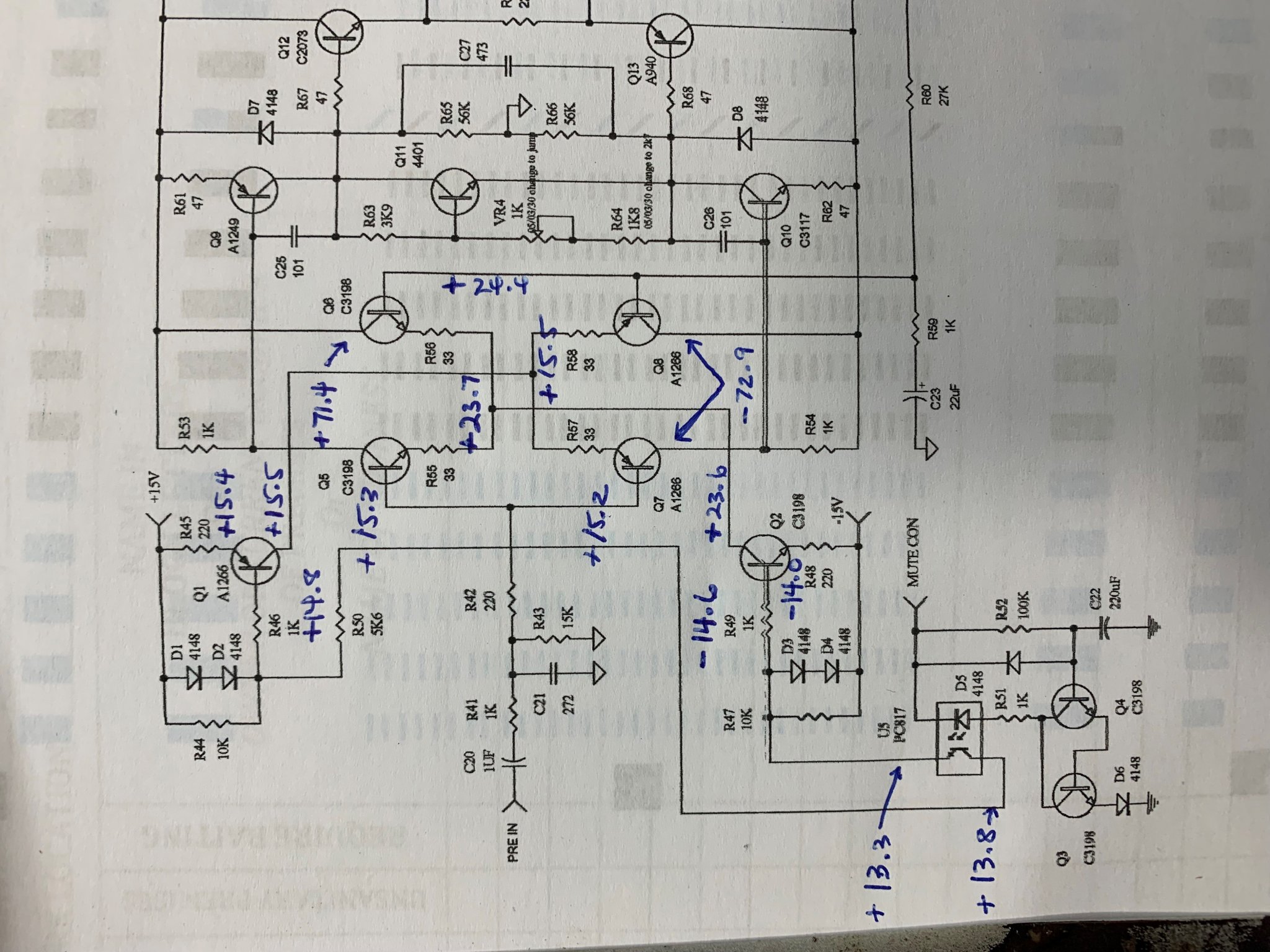

yes, I am seeing some strange DC values, if I remove the component it tests ok out of circuit, replaced the components with new and the DC values measured are the same. I've attached a copy of the clarion schematic and placed the respective DC values I'm measuring alongside the corresponding component. All are taken with respect to power terminal ground, with RCAs- no audio connected.
Does it cause excessive current draw when a load is touched to the speaker terminals or does the voltage simply drain away?
with a load connected it draws high current and pulls the PS down.

Is R49 within tolerance?
Yes, it measures 998ohms
Do you have the base and emitter voltages backwards for Q2?
no I remeasured with your asking and its the same, it tested good on diode check, no leakage out of circuit. I just swapped it with Q2 from the R-ch and the voltages remain the same. I've also checked continuity between those transistors in the differential pair and its ok.

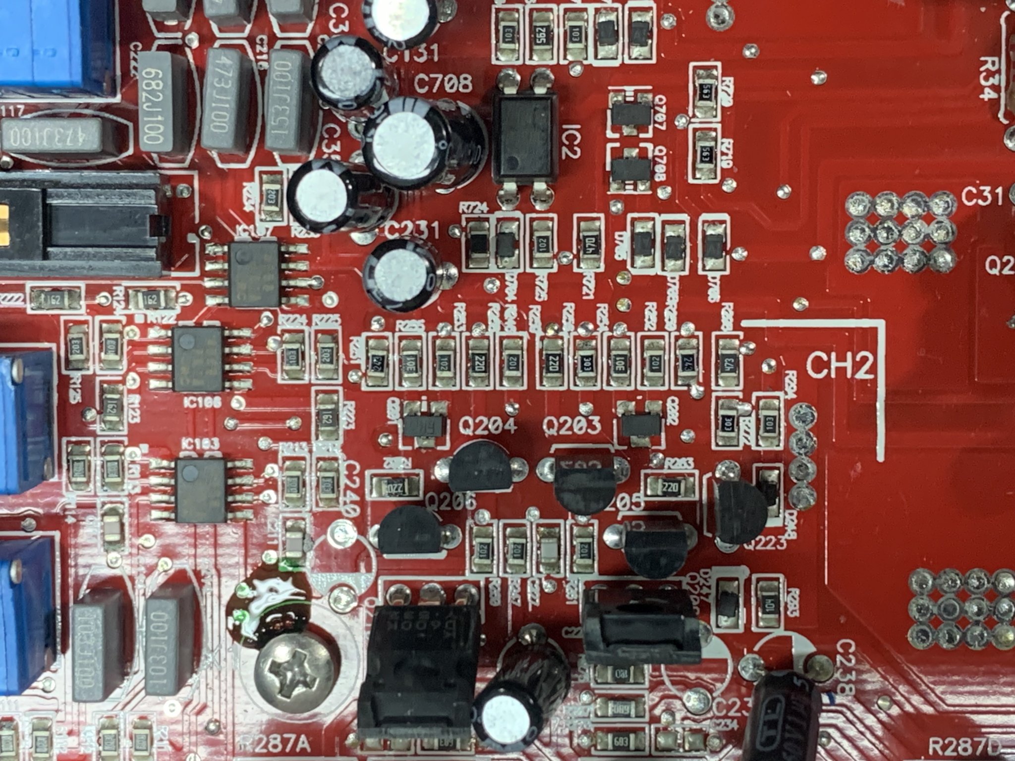

I did some tracing and troubleshooting, this is what I found:
i removed all four transistors from the diff. pairs, all tested good out of circuit. I powered and compared voltages with the R-ch for the Q2, this seems to be working correctly and the -14.6 measured at the collector is being cascaded down from higher up in the circuit.
Comparing resistances with the working R-ch, the only disparity I'm finding is Q9 (B631K),
B to C measures; R-ch around 8mega ohms, on the L-ch, it measures 1.9kohm. I've removed Q9, Q10, Q11 from the circuit and the resistance is still there.
Without Q5, Q6, Q7, Q8, Q9, Q10, Q11, Q12, Q13, i still measure 1.9kohm on the B/C pads of Q9. I've cleaned thoroughly with alcohol and dried with the heat gun, I've also soldered two wires to the B/C pads and applied 30v with PS, I didn't measure any current draw and nothing heated up. I now measure 3.9kohms between the B/C pads of Q9.
The PCB isn't burnt, I'm sorta leaning to this PCB is conductive.... this amplifier operates at +/- 72v rails.
all transistors Q5 to Q13 were tested ok and resoldered to PCB, powered up and voila, +62vdc at the L-ch spk terminal again.😡
