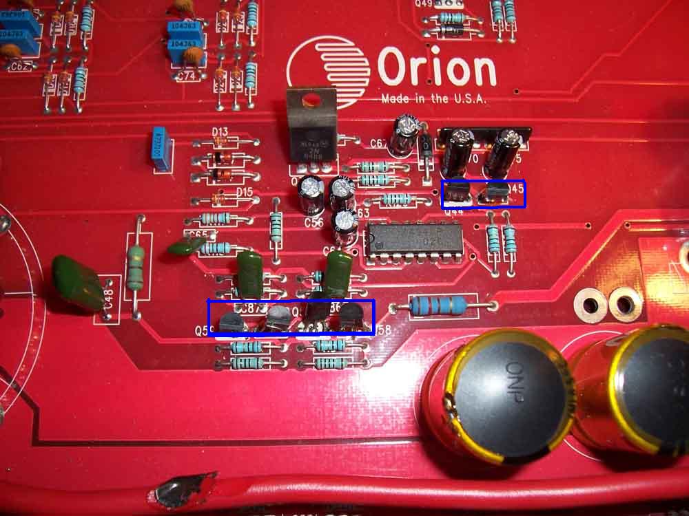

i cant understand where my power is going i cant find it anywhere.
i have 12v on the center leg of the power supply and 12v on the torridial transformer. i also have 12v on the first leg of Q44. and the 3rd leg of Q45.
other than this i cant find < .5v anywhere else and i cant see anything else burnt any ideas?
i have 2 big caps that are 3300uF 35v and when i put my ESR meter on them they start super high around 4 and over ~1 min it drops to .07. is this normal? what does this mean?
also i replaced the transistors in the blue boxes

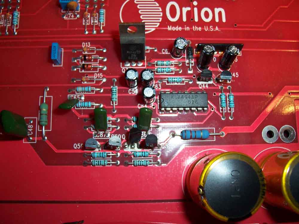

Post the DC voltage on the 494.

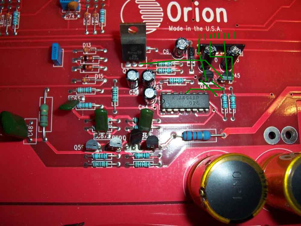

the A56 at location Q44 is attached to a black strip thing with 8 pins on it that i have never seen before and i dont know what it is. the base (the middle leg) is attached to this thing. i tried to draw lines showing where everything goes to
MPSA06 location Q45
E - 0
B - 0
C - 13v
i just want to make sure that according to my picture that the emitter is on the left the base in the middle and the collector is on the right

That strip is a a resistor network. It's 4 independent resistors, all the same value.
It doesn't appear that you're getting remote voltage. Follow the trace from the remote terminal to the resistor network to see where it's being lost.
is it possible that i dont have a remote power? i dont have a terminal for it. the only thing i have is "remote gain" which is a female plug like a headphone jack.
You have to have remote voltage connected to the 5-pin plug for it to power up. Look on the cover to see which terminal is remote.
ok i figured out what was going on. i applied remote power and the second i do my power supply starts getting hot.
i am getting more action at my 494 now
