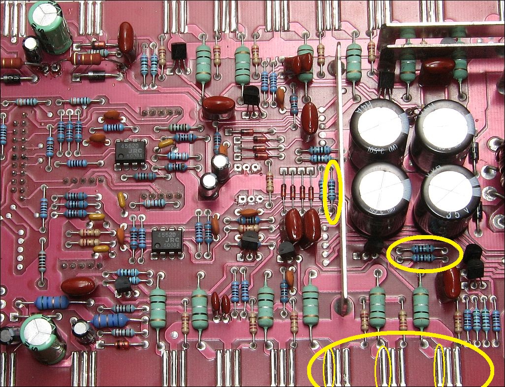

I'm fairly sure they're the missing transistors in the attached photo. Marked 2N5639?

I've f..ed it up - I tried to make one channel clip, seems I did not pay attention to the temps. because bottom 3 fets are getting hot loading the power supply to 10A (regarding remote on/off), but wanted to continue probing the muting jfets so I lifted the 3 source pins.
Power up (without speaker load) was fine again, but idle current was almost double ~1.8A - suspicious.
Gate of the muting jfet is slowly creeping up to -28V and staying there.
Not sure what happened, I did not short anything during measurements but the two resistors (below the 4 1000µF caps) are burnt now. Those are 75k right?
The single marked resistor is starting to get brown, but still fine.
I've read in other threads the metal bars (clamping down the mosfets) are hard to remove and will likely damage them when removed with force. Any advise removing the bars? Heat and pray?
See attached.
75 ohms.
For mute, the gate voltage starts at 0v. As the gate drops towards -20 (I've never seen -28) the jfet releases the audio.
The 3 output transistors are bipolar transistors with a base, collector and emitter. It's likely only one of the 3 shorted. Remove it and reinstall the other two so you can continue testing.

The drive circuit may have been damaged when the outputs failed. There are only 2 drivers. Pull them to confirm that they're OK. Pull and check the protection circuit transistors as well.
Lifting the emitter of the transistors isn't generally a problem but pulling one terminal of the emitter resistors can damage the protection circuit transistors.
When you replace the tape, I'd recommend using high-temperature silicone tape.
In short power up/down cycles, measure the DCV across each of the emitter resistors. They should all read 0.000v DC. Do any read higher?
