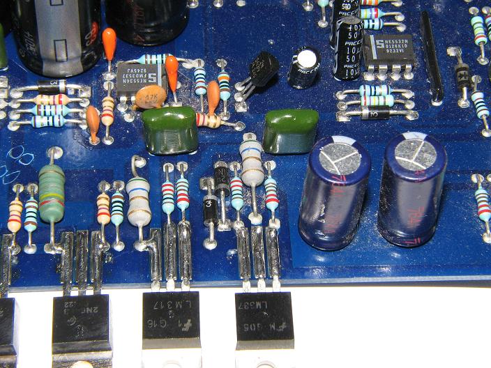

The opamps are not getting any voltage; tested referencing both amp ground and non-bridging terminals yields nothing. Something is not giving them any power I believe. Could it be the rects or the two missing LM transistors?
Speaker terminal outputs do not have any DC across them referencing non-bridging terminals. I'll test again measuring amp ground but I think its zero also.
I put new LM317 and LM337 regulators in but the LM317 isnt doing so hot. After ~10 seconds of being powered up it gets very hot. its still measuring out OK with the DVM, for now.
I found a 470uF cap near the LM317 shorted.
The opAmps are getting +- 13vDC.
The LM317 near the shorted cap is still getting a little hot but not like before. Someone previously replaced the 5.6 ohm resistor for a 1.0 ohm coming off of this LM317's 3rd leg, but I changed it back to as close as I had available - a 4.7ohm resistor.
Is 4.7 ohms too low for the LM317? 4.7 is more common than 5.6.
Picture courtesy of Perry.
The cap that was shorted is the one closest to the LM337.

The 4.7 ohm shouldn't be causing it to run hotter. Although resistors are sometimes used to drop a few volts before the regulator (so the regulator won't have to dissipate as much heat), I don't think that's the purpose of the resistor here. Connect the 1 ohm that you removed from the amp in series with the 4.7. If the temperature of the regulator decreases, you know it's the 4.7 that's causing it to run hot. If the regulator continues to run hot, you know that there's another cause.
The 5543 op-amps have a 2.7 ohm resistor in series with their power supply pins. Do they all have the same voltage drop across them?
Are they all within tolerance?
I'm assuming that these regulators feed the 5534s and the other two regs feed the rest of the op-amps. Correct me if that's wrong.
