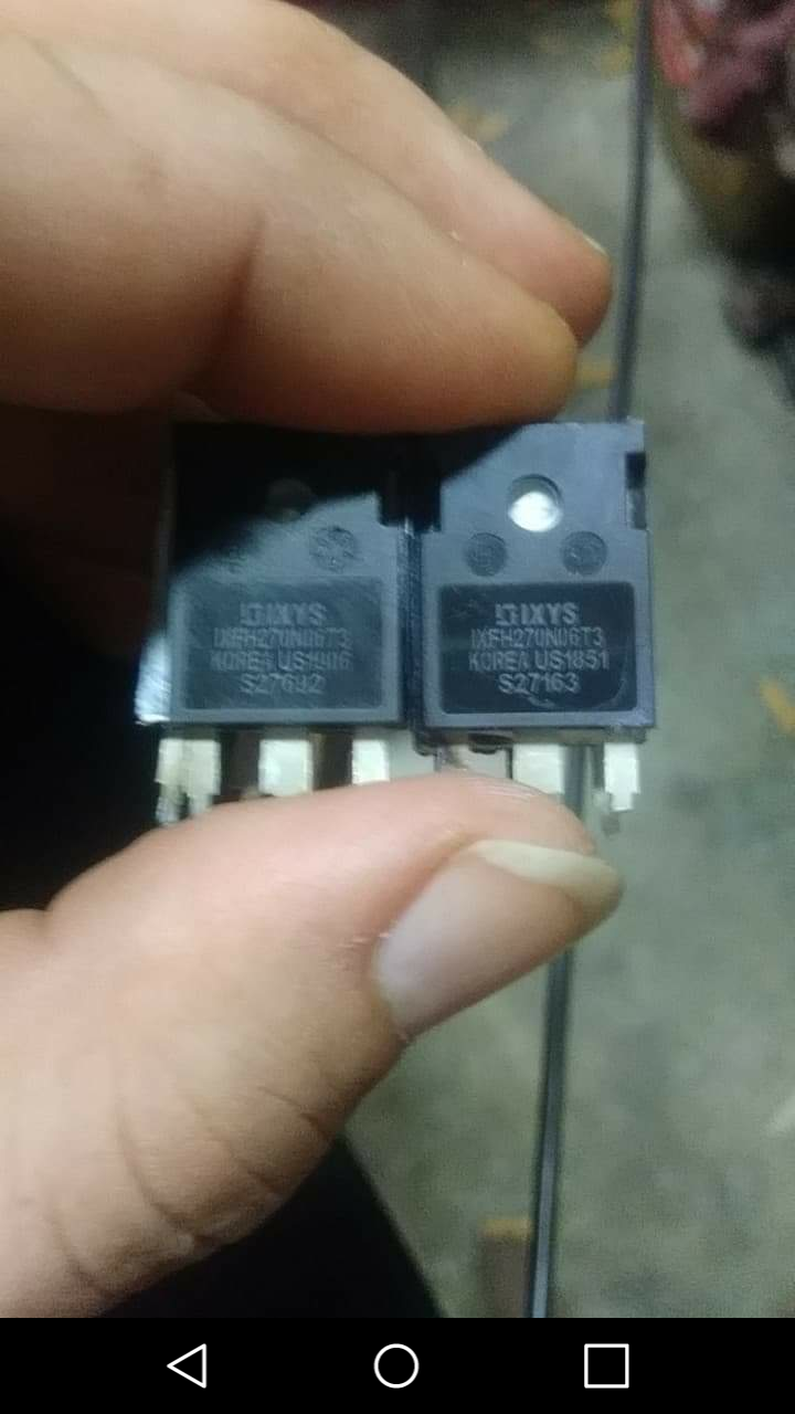

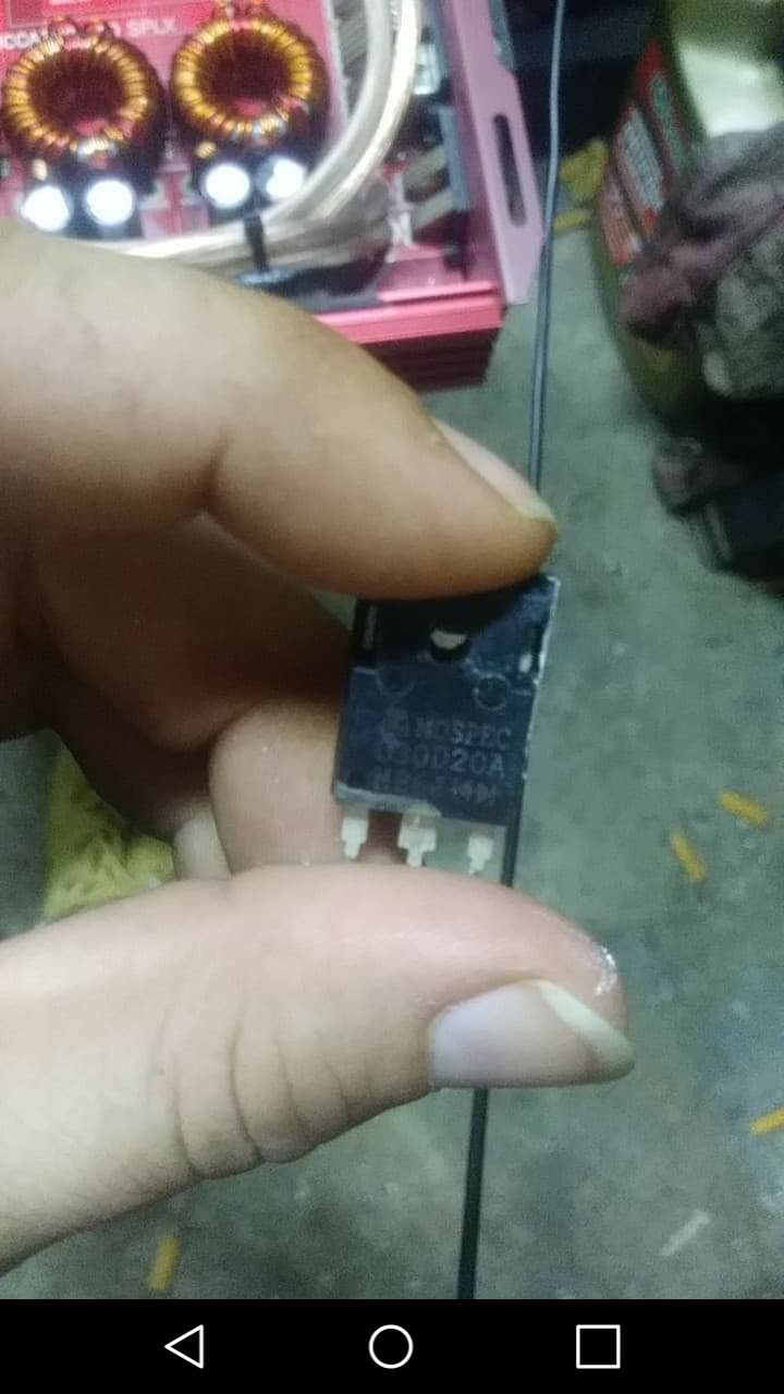

Hello everyone I ended up with a blown orion splx 3k and I am in search of some parts and help to get it back up and running. I have removed all the bad power supply fets and 1 bad rectifier. I'm trying to locate replacement parts as well as some pieces that were lost before I received the amp. I need 2 factory mica isolators as well but I can't find them either. The only part I can locate is the rectifiers. Any help is greatly appreciated. Thank you in advance. I can email or message pics of the fets but not sure how to post them on here. But ill type out the numbers on the fets.
Ixys
Ixfh270n06t3
Korea US1851
S27163
Ixys
Ixfh270n06t3
Korea US1906
S27692
Ixys
Ixfh270n06t3
Korea US1851
S27163
Ixys
Ixfh270n06t3
Korea US1906
S27692
I found that but I have two different fets with different numbers however the long number is the same.

The "long number" is the part number and twillar linked the correct part. The other numbers/letters are batch codes. You do not want to mix banks with different batch codes unless you test to make sure they will work with one another.
The Mospec U30D20A will be your part number.
Find a reputable source, eBay is a gamble in which the house holds the odds. Good luck and great amp
