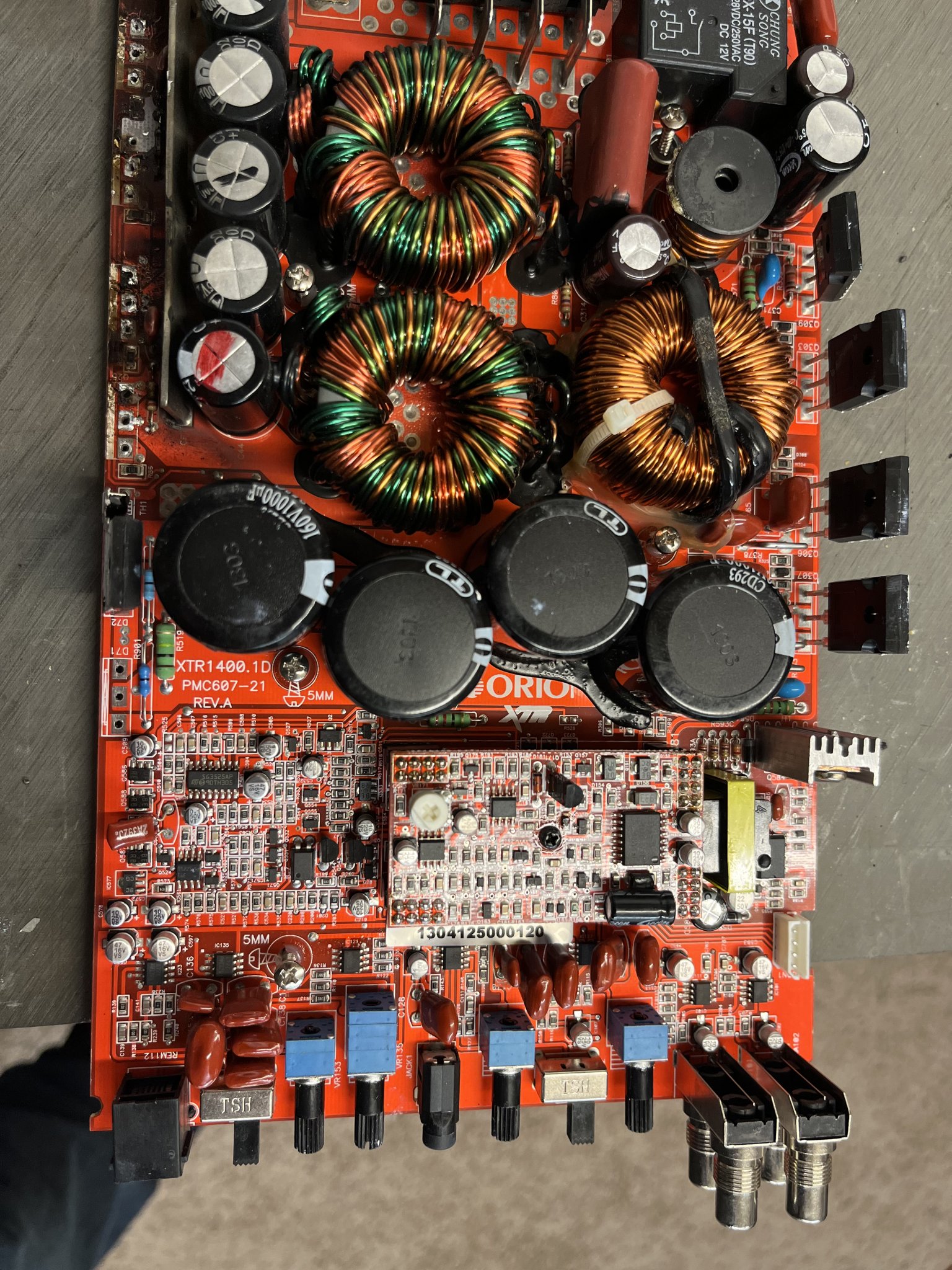

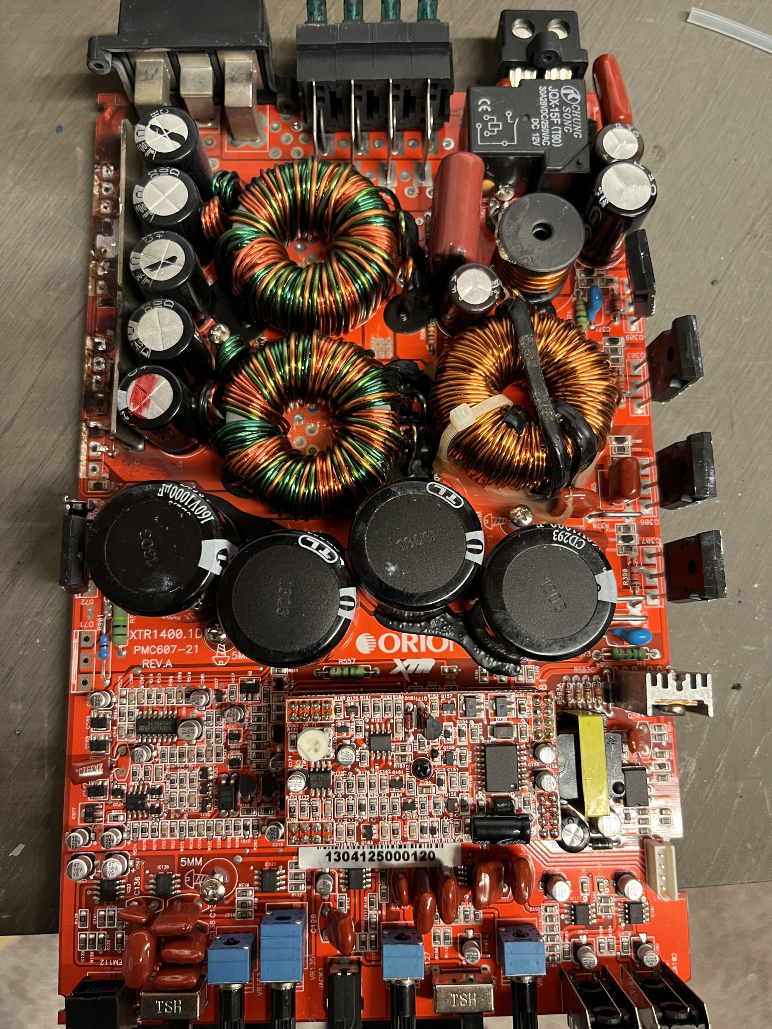

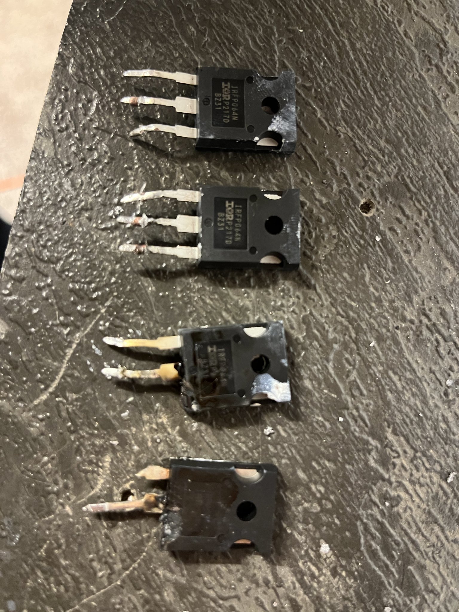

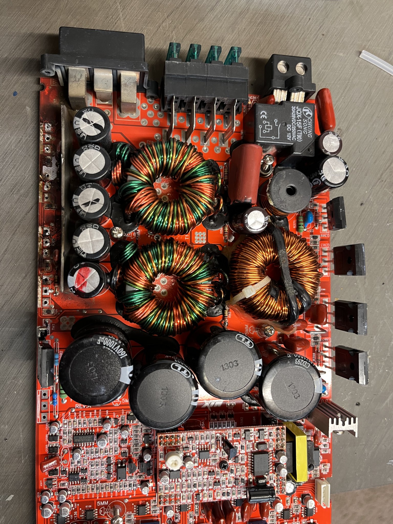

Here are some pictures.

The term 'continuity' is vague. It's best to use ohms or diode-check and state the precise reading on the meter's display.
There is a lot of via damage shown on the FETs. You may have to solder both top and bottom on those connection (and possibly more) to re-establish good connections.
Do you know how to use a scope?
Are you sure that there are no solder bridges on the connections you desoldered?
Hi Perry
I have looked up online briefly to learn how to use the oscilloscope. I have managed to get readings on where the transistors are.
One is 5 volts and the other reading is 12 v
I agree there is a lot of damage
I am going to clean up the soldering and try and get some of the soot off to clearly see the board.
I am not pleased with the soldering job.
The second blow up beat up the chip quite a bit.

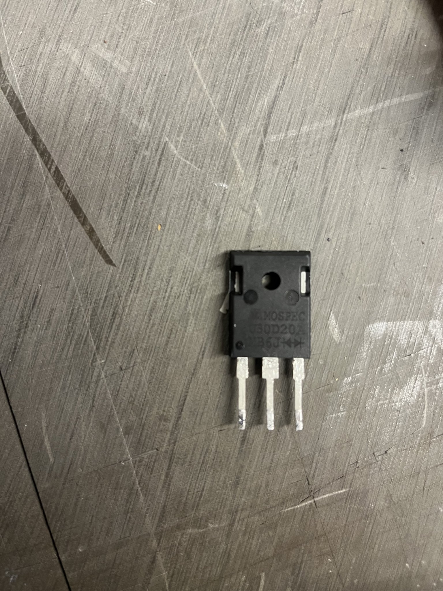

Based on one of your posts I believe I had a bipolar transistor ? that is toasted. I’m thinking this may have caused the greif.
I have attached a picture of the transistor that I believe is defective.
I’m going to order a few more transistors to replace them.

Wait until you get the scope to check the drive signals. A multimeter can be used but it's not definitive.
That's a rectifier in the photo.

HI Perry
I Removed the original solder and cleaned the board as good as possible and installed new Transistors as well as a new rectifier.
My oscilloscope showed 24 vdc and 5.3 vdc when i tested it.
I have installed it and tested. it works great
Thank you for the assistance.
