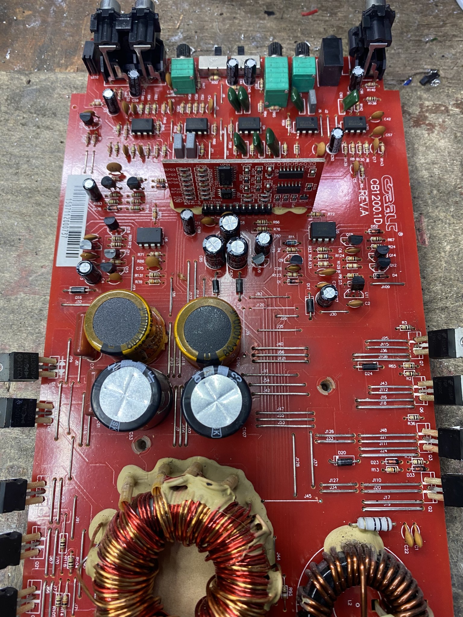

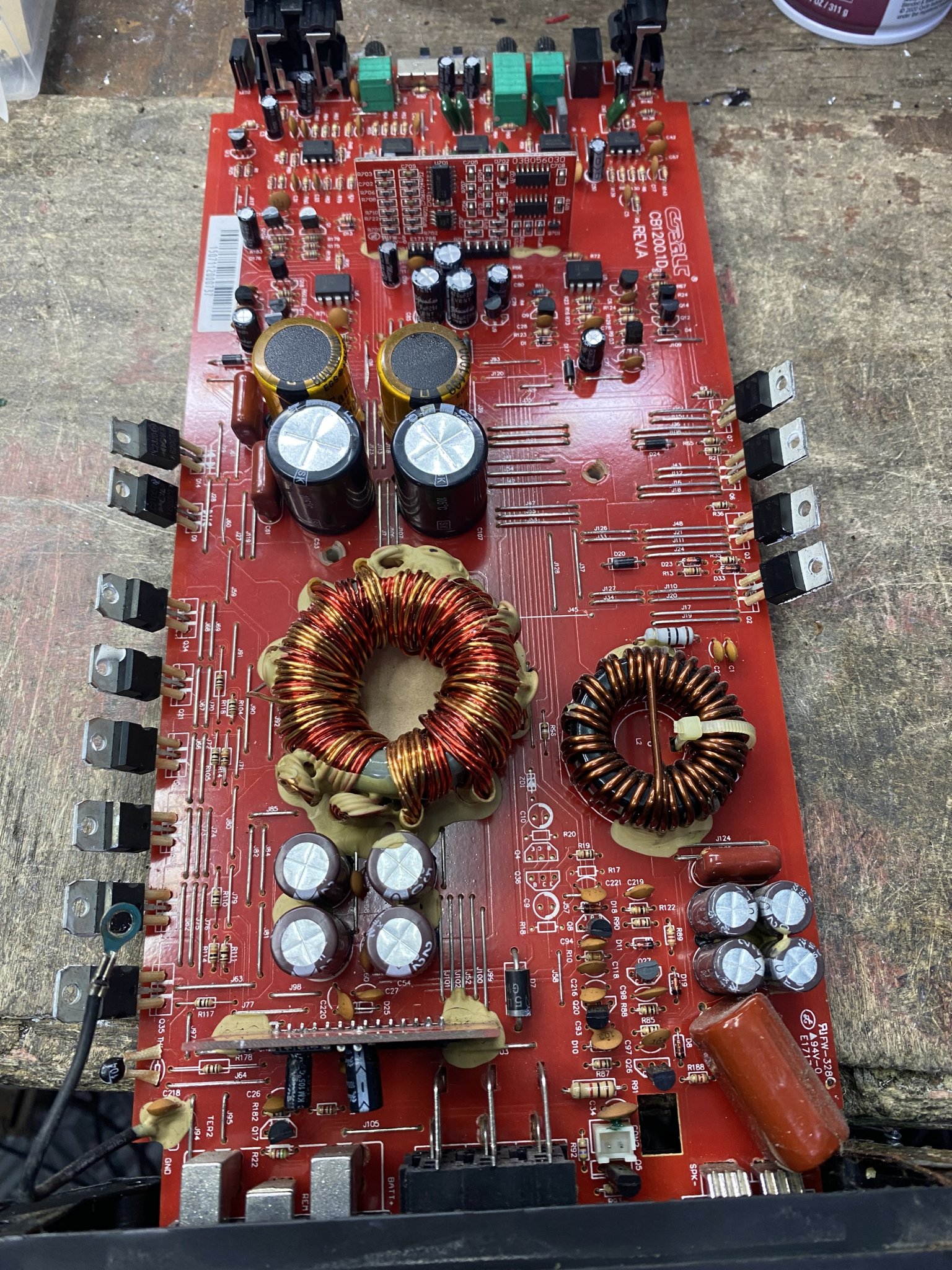

This happened often in a different type of amplifier when the drive for half of the output FETs was defective.
What type of scope do you have?
Found it,a rusty leg on a transistor in the drive circuit and the optocoupler.

After replacing the parts rail is equal now. I gave it a run and all seem ok.
