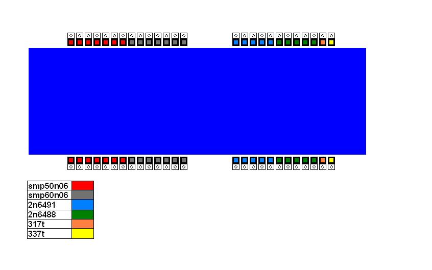

I'm hoping someone might have nudies of an Orion 2250SX here? I just got a real basket case: this amp has no outputs or power supply transistors attached! From some searching it looks like outputs on this are 2n6488/6491's, correct? I have no clue what the power supply uses though, need some help here. There also appears to be a missing optocoupler mid board, are both of them the same part number?

Thanks for that! I've also found (from various pictures I have found) that there are some 317/337 regulators on the one side of the board by the outputs, is there anything mixed in with the 50n06's on the power supply side of the board? My problem is lack of good photos of the ps section at this point..

It seems they mixed the 2n6488 transistors with the 2n6491 transistors. The quantities of them in this amplifier make no sense. One side has five 2n6491 and seven 2n6488. the other side {yellow side} has eleven 2n6488 and one 6491.
the 2n6491 is PNP (as far as I know) and the 2n6488 is NPN.. so they shouldn't be interchangeable.

the workmanship was decent and the amplifier didn't show signs of repair but I'm believe it was repaired and the repair person didn't get the correct parts.
Because there are more 2n6488 transistors , I'm guessing the 2n6491 NPN are the transistors put in place of the originals.

from what I've gathered, the first five of each output are 2n6491 the second five are 2n6488, the 317t and 337t
here is what I have so far. I will try to finish at least the parts which commonly fail. This is my first time working with a 2250sx. I see why the output is the common failure point. The power supply is stout and can take abuse. the outputs are weak compared to amplifiers like a Lanzar 2500.
Nice pic iamsonic!!! So you have a pretty butchered up amp too? I am thinking of running all rfp50n06's in the ps section on the one I have. There are sooo many parts pulled on the amp I have it's nuts.. I am just going to take things slowly and go section by section, starting with the PS first. This definitely is/has been a treasure hunt so far!
[got it]All of the power supply FETs were SMP60N06s. The others were replacements.
What about the outputs? did I get them right?

(there are 2n6488 and 2n6491 transistors where the 317t and 337t go. and the rest are in there willy-nilly.)

the power supply in the amp I'm working on seems good so I'm happy there and the caps are all very nice. Getting the output sorted out is the hard part. Before pulling the rails and finding out the transistor mix up I found one output transistor which was reading a short across the outside legs and I thought.. man it can't be this easy...

I think the radial version uses 6488s and 6491 for the regulators. The 6488s would have the black band of the zener diodes connected to the base leg of the 6488.
