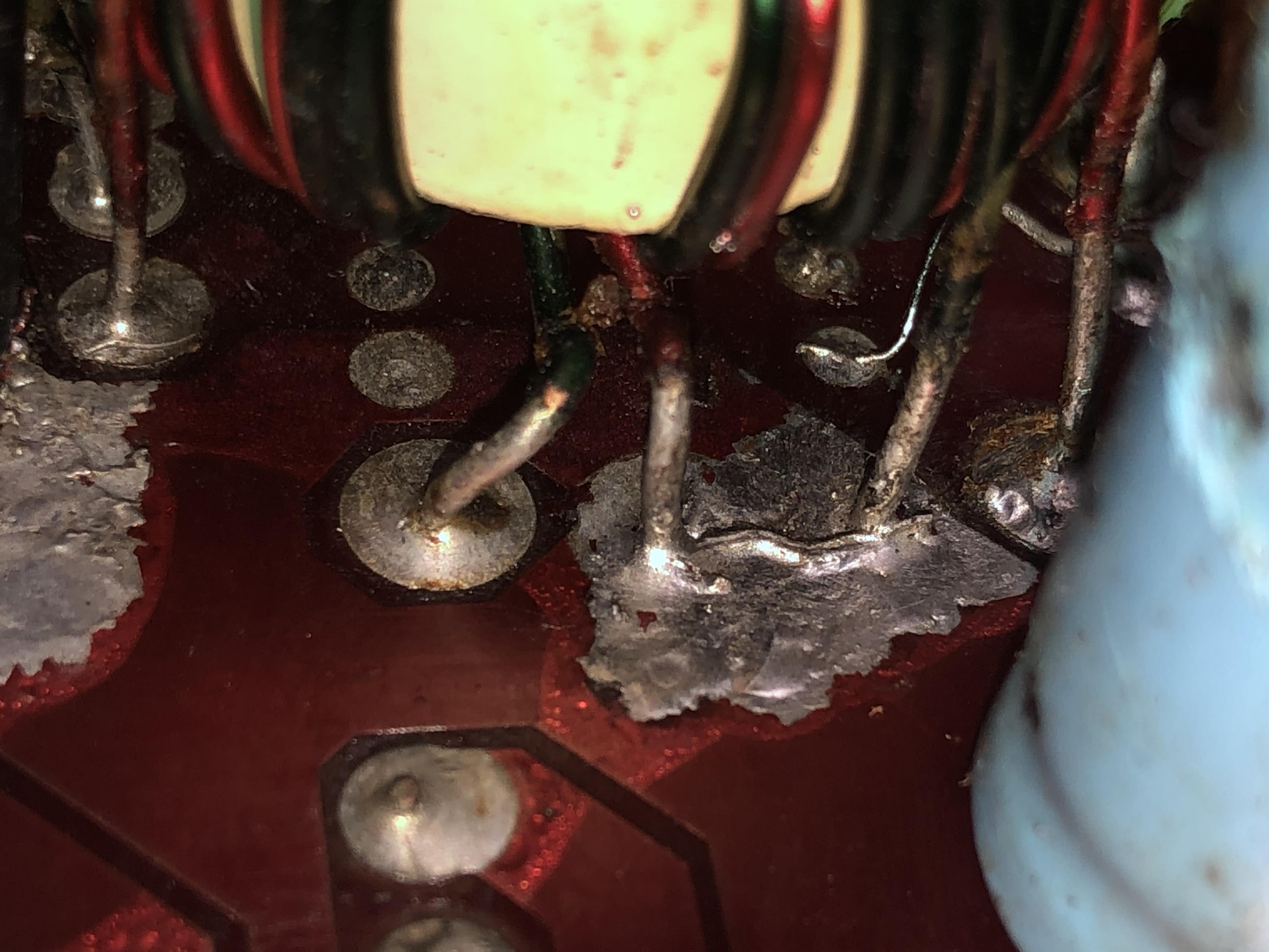

So last night I went to install some POT's on one of my 225's that just had resistors in place when I bought it. After that I figured I'd redo the wiring as it was a hack job but the amp worked. In the process of redoing the power wire I seen a spark go through the power supply and now I'm blowing fuses 🙁 . Just wanted to know before starting the troubleshooting process what the issue may be? Nothing was hooked up obviously but did I cause a ground?
Thanks in advance,

Redoing it as in removing the old power wire which wasn't going through the board just soldered to top. Putting new power wire through the board and getting ready to solder I seen a spark go the power supply.
I unsoldered the old wire, stripped it back and put it through the circuit board. It was just laying on top. When I went to being soldering I seen a spark go through the power supply and heard a small pop sound maybe? Hard to explain because I've done many repairs and never experienced this 😕
If the power wires were not connected to a power source, the spark was likely nothing more than capacitors discharging.
It could have damaged a component that's not likely. It's more likely that you have a solder bridge somewhere that's causing the short.
Post a photo of the board in your amp.

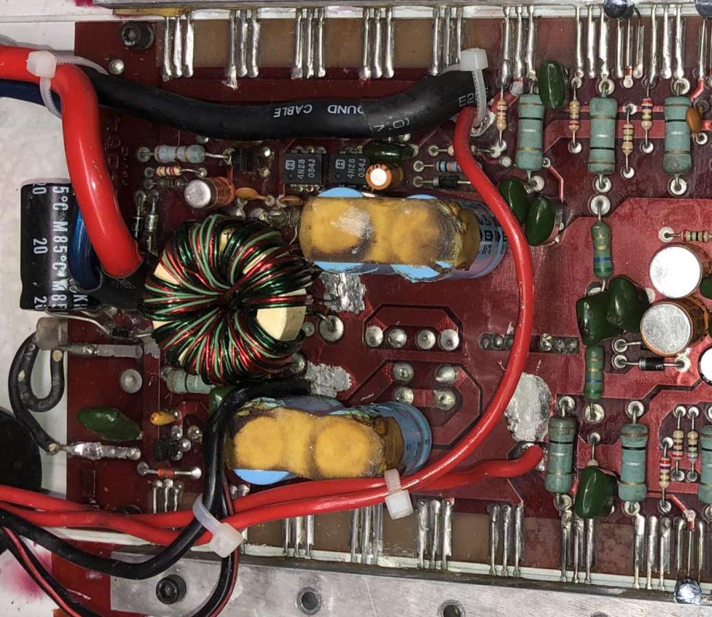

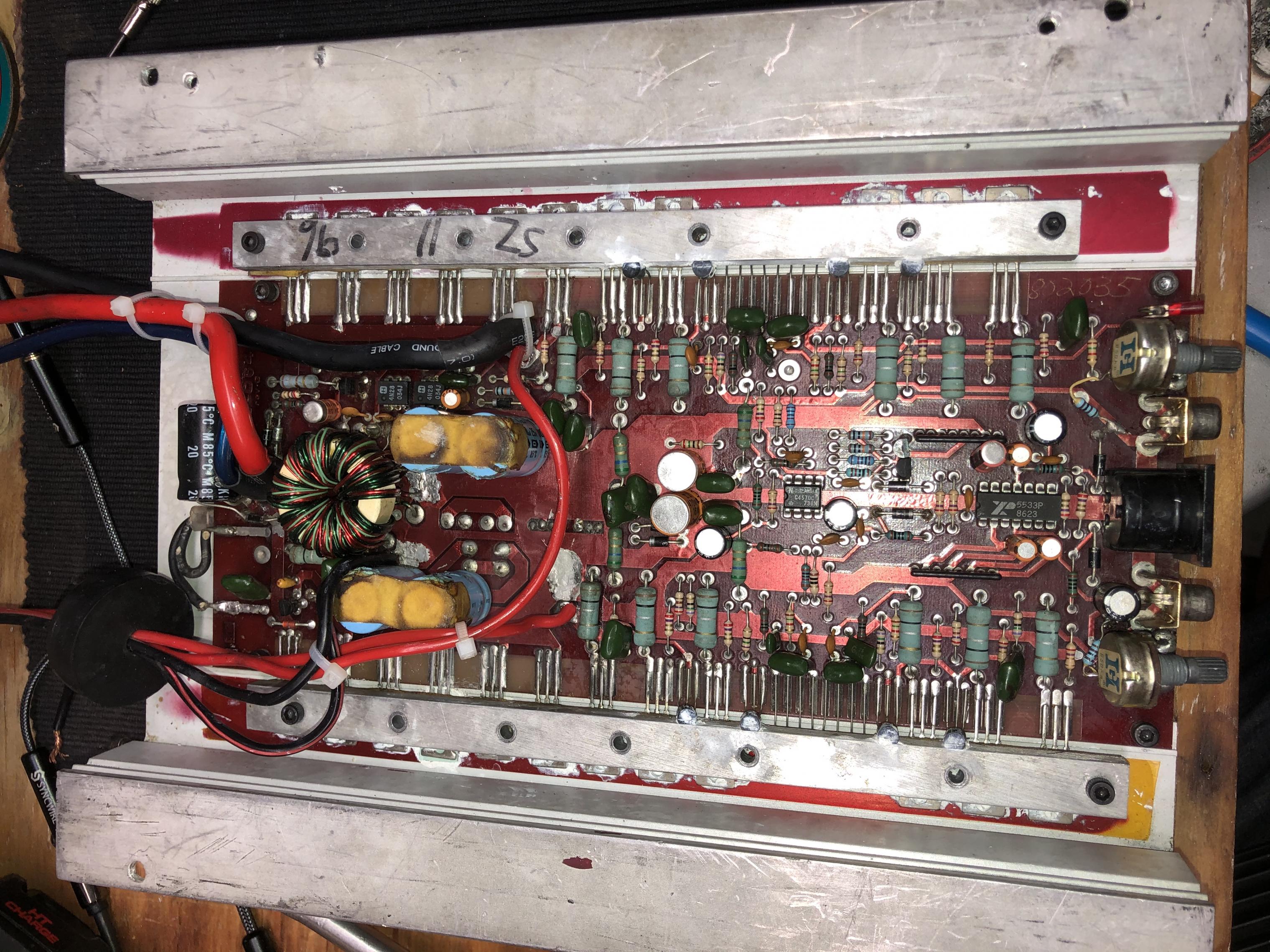

Ok I ended up going back over the board. I'm no longer blowing fuses but I'm only getting power to 3 legs on the power supply. I cleaned up some wiring on the two legs you'll see near each other that looked like they were just soldered to the board. I also notice that there is a lead going to 1 leg that connects to a resistor that is on the bottom of the board. Basically I need to get power to the rest of the legs and I think it'll work again.
Various notes...
In these old amps, the capacitors actually need to be replaced. Before you change any, I'd like to know (would be helpful to others) which ones are leaking. To determine which are leaky, heat the terminals. Which emit a fishy sort of smell?

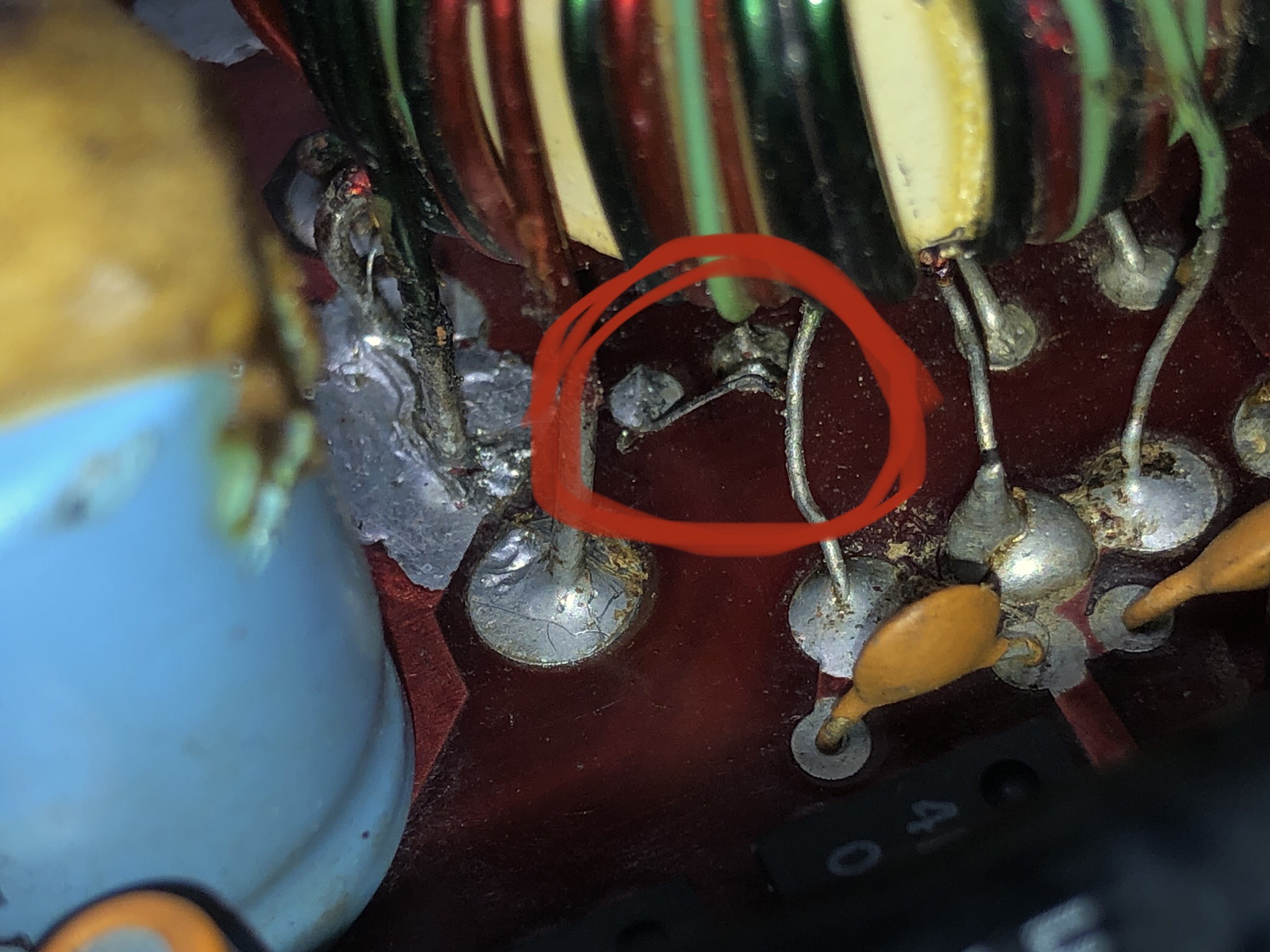

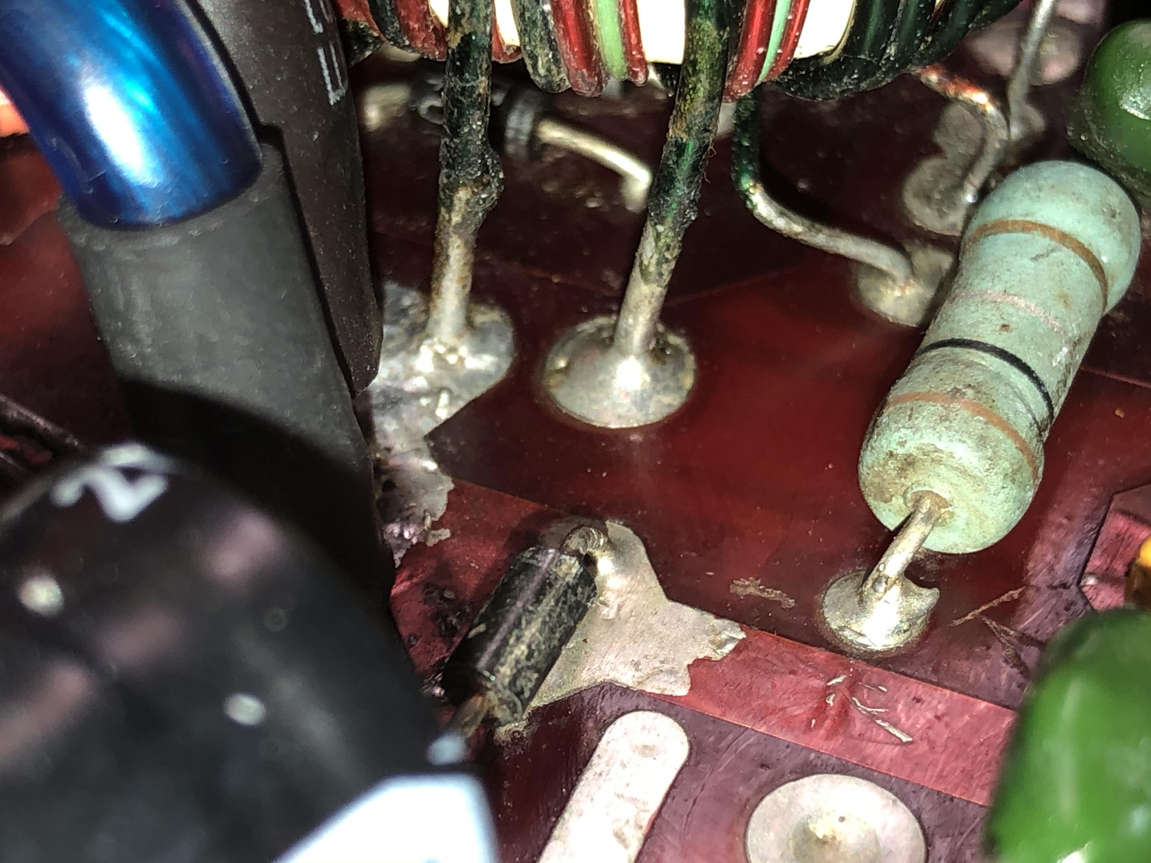

The windings on the transformer appear to have bad connections. They look like they're pulling out. To make the connections as they should be, you need to desolder completely and scrape the wire to bare copper. Tin the leads then resolder them into the board.
On the transformer, there are 4 groups of windings. The 4 windings in each group should read 0 ohms to the others in that group.

Ok I'll do that and thanks for the reply. As of now no o scope. I'll edit my signature and also post my findings when I get back on that board within a day or so.

Did this amp ever power up?
Did all 16 pads for the transformer have wire in them?

I was talking about opening up the mint one for comparison. I have't had the time to remove the transformer yet.
For now, just confirm that all 16 transformer pads have wires in them. Make sure that none are broken.

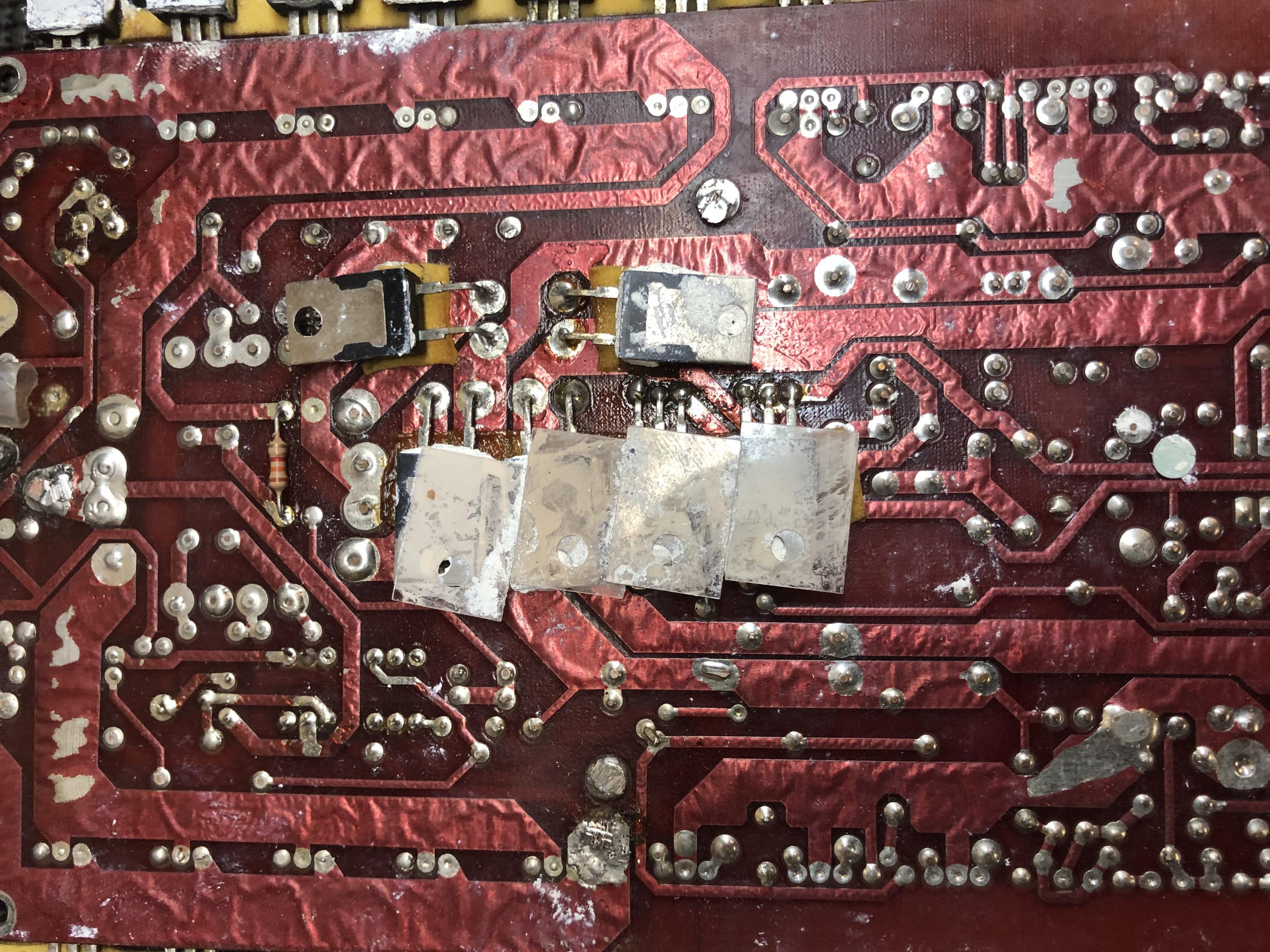

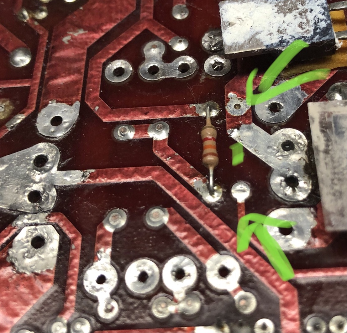

Finally got back to this...

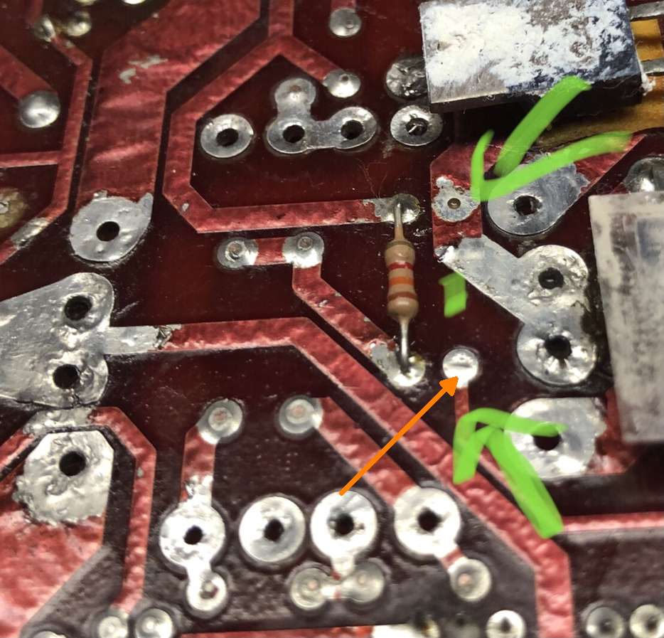

And here is what I found. Pretty sure whoever repaired it jumpered some wire to makeup for missing component. Now I need to know what really goes here. Tested caps and 1 was bad replaced all 4
So, a direct connection?
The missing resistor is likely a 120 ohm, 2w (? Confirm that a 2w fits) resistor. Some of the older amps didn't have that resistor installed between the primary and secondary grounds. Having a resistor there will make troubleshooting a bit easier but it's not critical. I'd install one before you return the amp to service.
