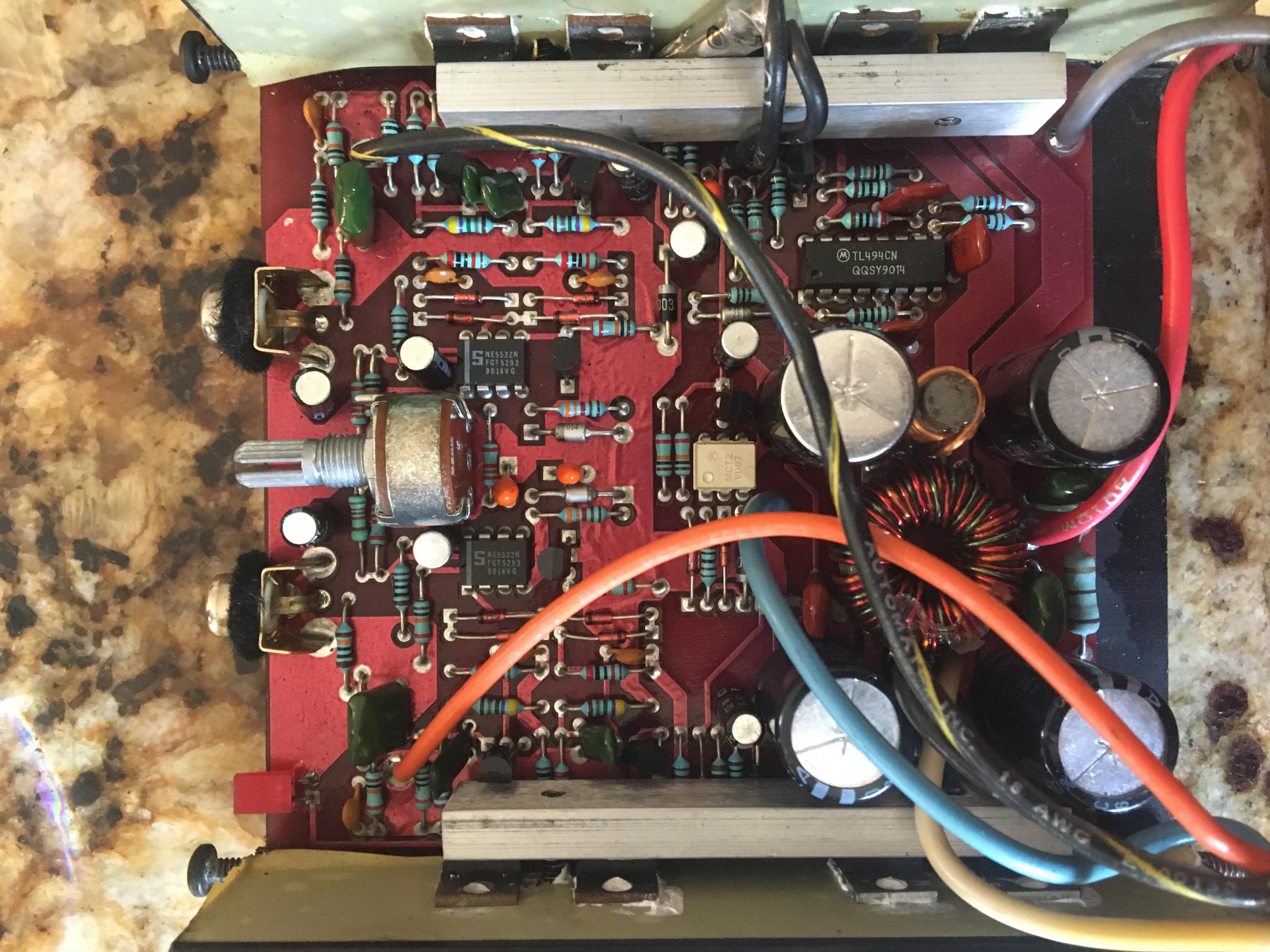

Is there a chance anyone would have a schematic for a Orion 220GT?
I have one that has developed a problem and would like to try and diagnose and repair it.
It looks like it is a relatively simple amplifier and may be a good one to learn a bit about amplifier repair.

It is blowing the 10A fuse that I installed in line.
I replaced it and the amp came on but it blew the fuse again as soon as I connected the RCA's with a signal running through them.
I have replaced the amp with a substitute amp for the mean time and the substitute is working fine so I'm sure the problem is with the amp.
I can't see anything that looks as if it were hot or burnt inside of the amp.

With nothing connected to the amp, what is the resistance between the B+ wire and the RCA shields on the amp?
Gently push/pull/twist the power transformer while checking to see if it changes.
The resistance between B+ and the RCA shields is 3.78 M ohms.
It does not change when applying tension to the transformer.

Post the DC voltage on all pins of the TL494. Copy and paste the following into your reply. Look up the datasheet for the 494 if you don't know the pin numbering configuration.

I put the amp on the bench tonight to try and get the TL494 pin voltages.
The amplifier is now blowing the fuse (7.5A) immediately upon the application of power without anything else connected to the amplifier. The power led comes on and the fuse blows immediately. I tried a fast and slow blow fuse.
Nothing is noticeably hot in the amp.
I guess something totally failed upon the last power up or it was just taking a bit for the fuse to blow.

That would typically indicate that the output transistors have failed. Check them with a multimeter set to ohms. You should not read anything near 0 ohms across the legs of any of the output transistors with any combination of meter to terminal. To be consistent, check each transistor, leg 1-2, 1-3 and then 2-3.

I was able to return to testing the mosfets in the amp and it appears that one of the IRF542 mosfets have gone bad.
From my research, it appears that IRF540’s would be suitable replacements for the pair.
Does that sound correct to you?

The IRF540 should be OK. The 540N causes problems in some amps that use the 540 so make sure that you don't order those.

I have ordered the mosfets for the amp and will check all of the caps and replace if necessary.
It will be nice to revive the amp and place it back into a working old school system.
