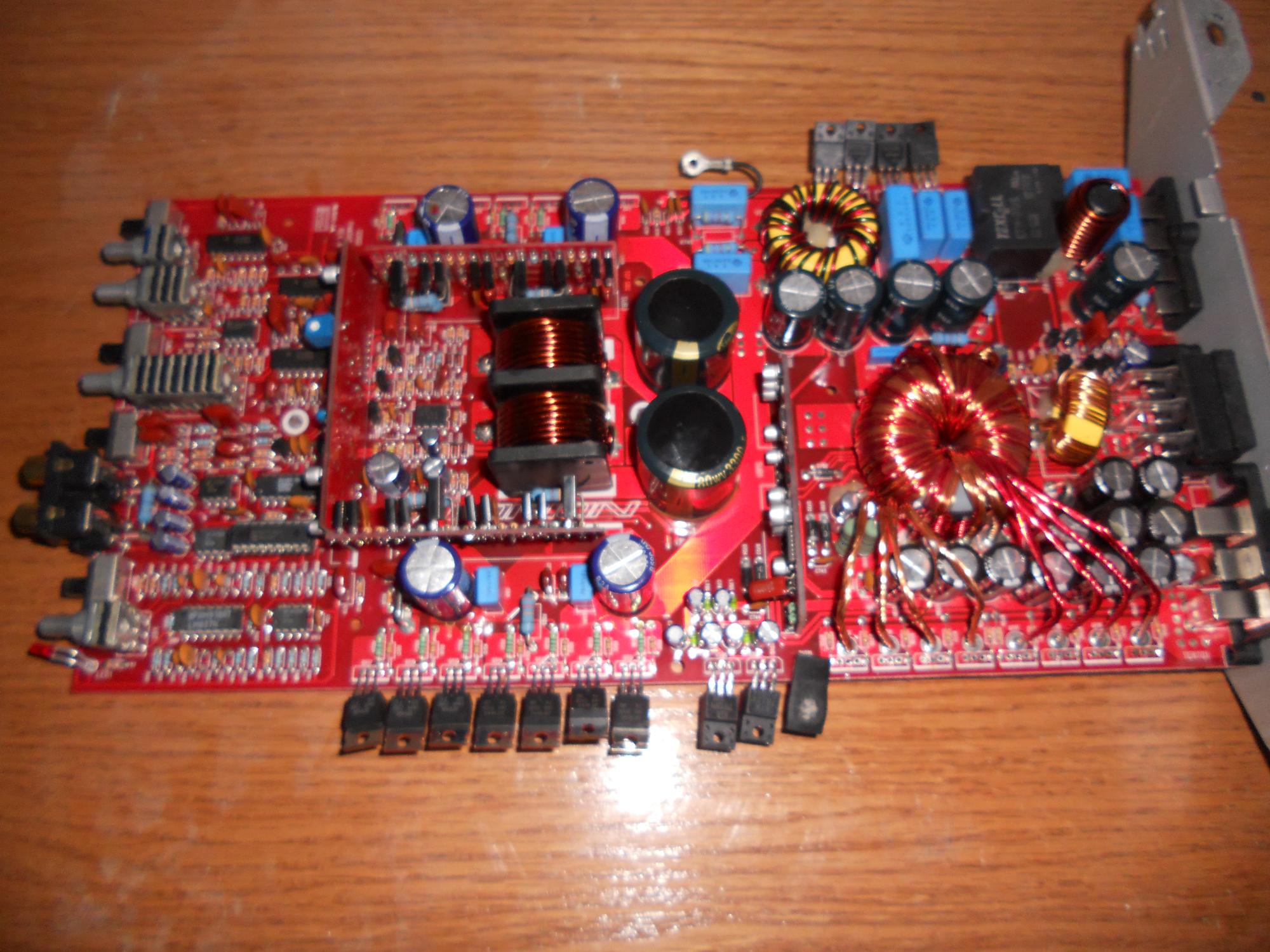

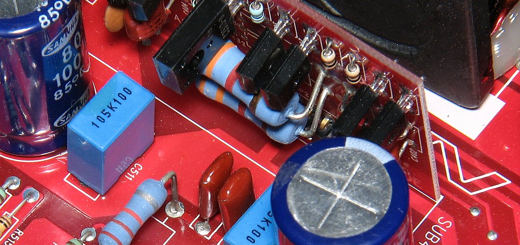

Does anyone know the value of theese ??
Im guessing they are a 3.3K resistor ..
Just wondering if thats correct Since they got hot and faded the color bands a lil..
They are measuring 2.766K out of the board So im just gonna replace them
All 4 read different 1 measures 1k another one measures 2k one measure 2.7 k one reads 2.5k they are all bad evryone of them got very hot at some point on both driverboards..
They are all out of the board right now and still get the same readings ANd i know my meter works 100% since i tested brand new resistors and they all check dead on
Also do not forget to check the power transistors. You may have a shorted
transistor to blown 4 resistors or heated them up.
They all measure the same as the first driverboard If you look at the backside of both driverboards thoose resistors got so hot they unsolderd themselfs from the board and made the driverboard black where they sit
