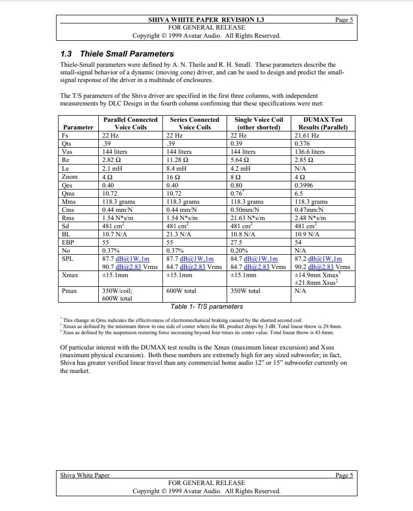

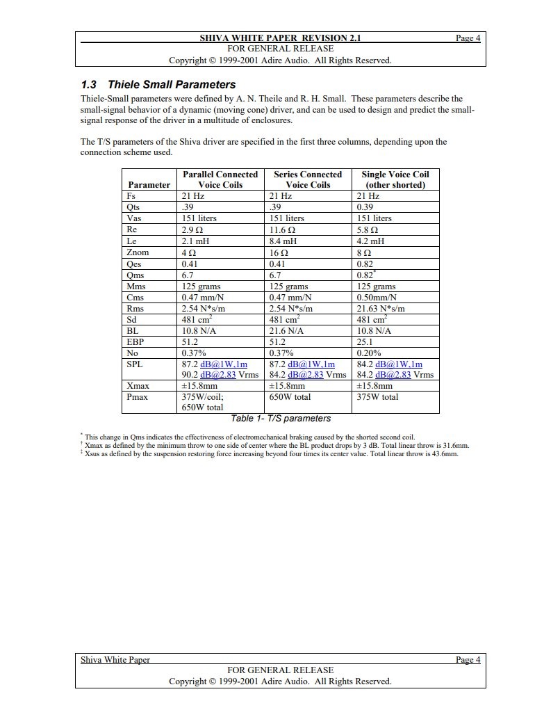

Original Bass List Shiva TS Parms
As former Bass List member, I purchased four of original Shiva from first production. Does anyone one have the TS parameters for these? I'm assuming there have been some improvements over the years. -Btw, I used my four in 2' diameter X 6' sonotubes tuned to 15.5hz if memory serves. Preparing to pull them out for low-q acoustic suspension experiment. I ran across a nice paper possibly by Dan Wiggins? Maybe my vintage Shivas can be substituted? Thinking about building two subs with two Shiva each with q~0.5. TIA!
PDF's are working fine on Win10 (21H2) & Chrome 103.0.5060.134, not sure what might be happening on any other platform.
Anyhoo, herewith the TSP sections from both PDF's.
David.
