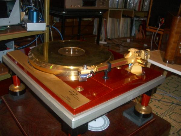

Maybe this is known to everybody. But I haven't seen the deck since. It had a metal platter, probably 10 cm thick. On the otside there was this drive shaft/rod, also 10 cm. The idler-wheel was magnetic. It was basically a rubber-insulated magnetic rod. But even that might not be simple. Chance is that the driving rod/wheel will have to be floating somehow.

I think you are referring to the Teragaki designed Seiko-Epson Sigma series turntables. The Sigma 2000 was released in 1987, followed by the Sigma 3000 and 5000 in 1994. Very limited edition models, only about 30 to 40 units were made and the Sigma 5000 costed about 32,000,000 Yen when released. I have been trying to locate magazines which reviewed this deck but unfortunately was unable to find any.
It could be Teragaki. I couldn't say. I googled Teragaki Seiko-Epson Sigma. There are quite a few of these ultra high-end decks out there. Back when I saw this deck, Thorens and Nakamichi were pretty much the only ones to make these kind of "prestige" decks. That's probably not true. But there were a lot fewer manufacturers back then.
