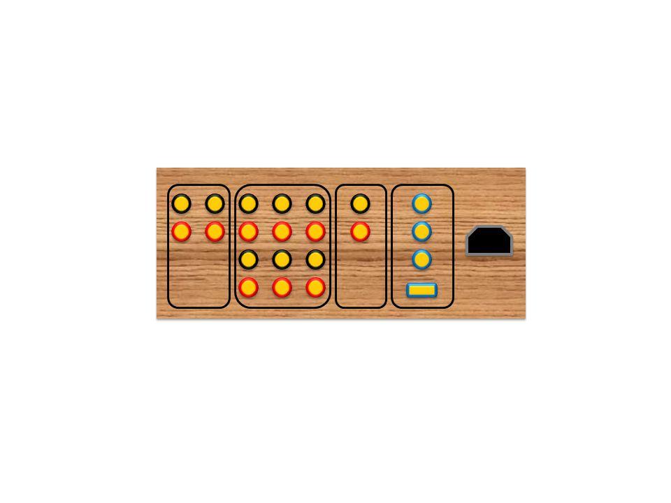

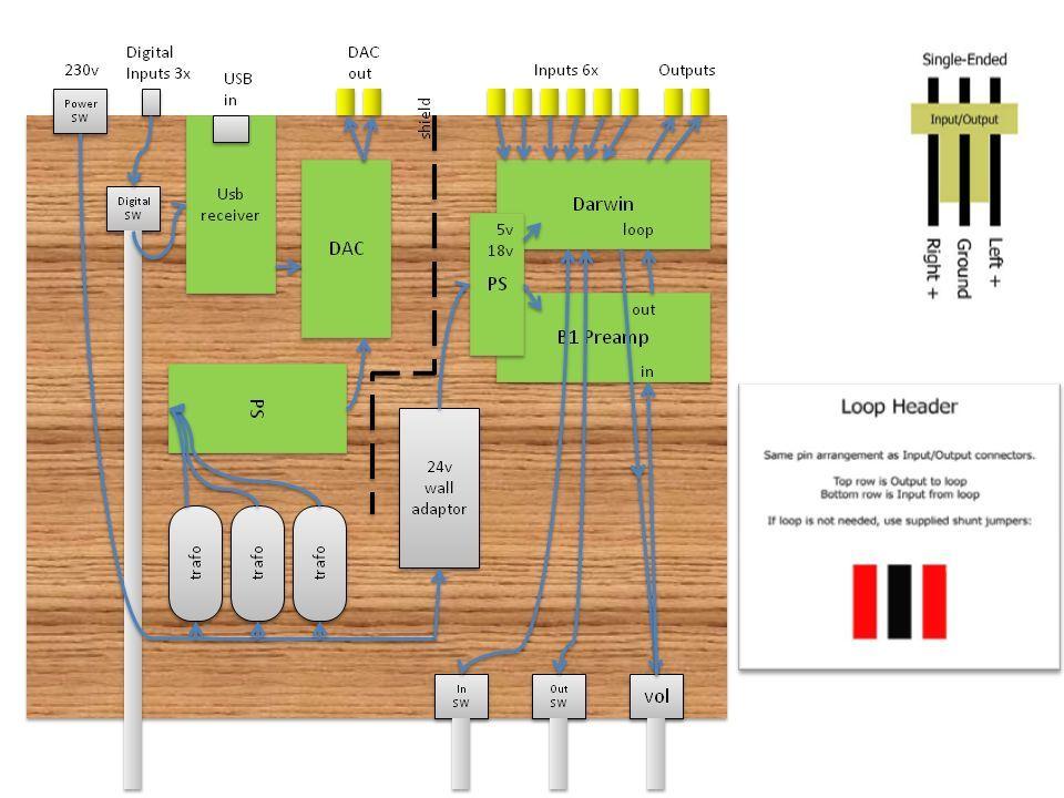

I am building this all-in-one DAC / Preamplifier combo. I use a Darwin input selector from Twisted Pear Audio, a B1 buffer (Pass Lab design) and an Opus DAC again from TPA.
Any feedback on the design?
