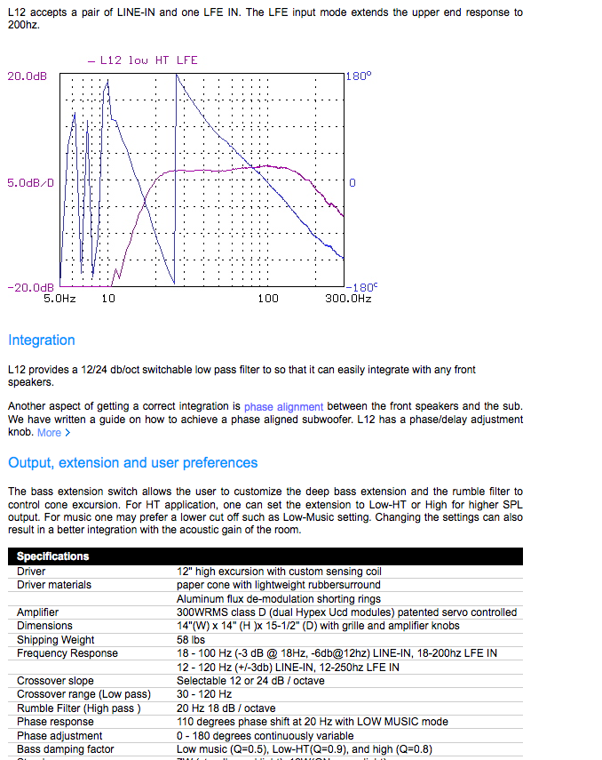

I've decided on dual 12" sealed subs to match with the Genelecs. The subs I would most like to use (Rythmik L12) does not have a speaker output. It does have an LFE input, which to my understanding bypasses all the subwoofer processing, allowing for external processing. I'll be crossing over around 120Hz to smooth out a big dip related to floor bounce at my listening position .

Ashley makes decent kit, the unit you linked reminds me of some of their units I owned back in the 1970s.The subs I would most like to use (Rythmik L12) does not have a speaker output. It does have an LFE input, which to my understanding bypasses all the subwoofer processing, allowing for external processing.
I found this an option for external crossovers[/URL] but I don't know if it's a decent piece of kit. Looks like it sells for around $250 USD.
The variable output level at the crossover frequency is a nice feature, “Linkwitz-Riley”, "Butterworth" or something "in between" ;^).
It has a fixed 20Hz third order high pass filter, which will cut some (likely around 3 or 4 dB) of the Rythmic L12 response down low. Down below 20 Hz, as little as 5 dB reduction sounds only half as loud, so not a trivial problem if you are not using additional parametric or 1/3 octave EQ.
The Rythmic L12 LFE input still includes all low frequency processing, but raises the upper crossover point to 250 Hz, looks like the slope may be first order.
