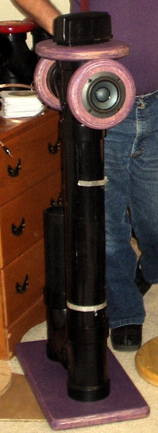

Here's an application. Bipolar Disorders
Using an Optimus branded version of the Linneaum tweeter I made a pair of ABS transmission lines with the Vifa BC11sg06-12. I had no issues with sensitivity and in fact had to pad the tweeters.
These speakers have an open and full sound up to "loud" where they become a bit harsh. Bass is very even down to about 70hz I guess then peters out. These sound very good when augmented by a sub.
