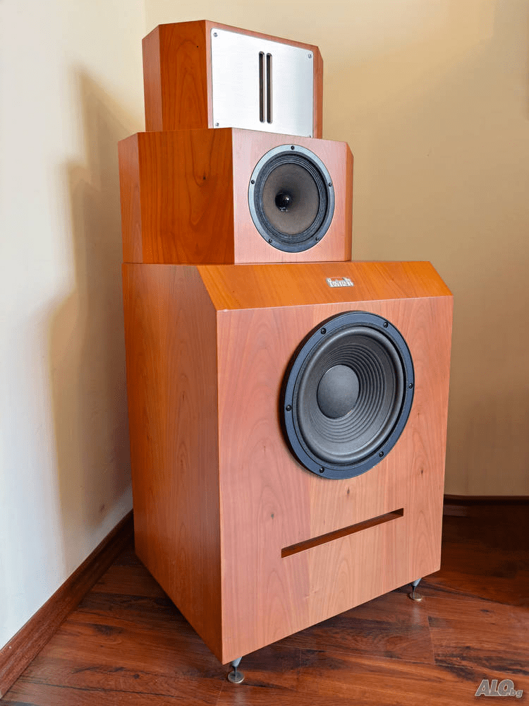

Could you please describe what capacitors are you using in the crossover?
Interesting speakers!
Can you please tell me what speaker drivers you are using, I can see that the midrange is from Supravox, a brand I really like!
And what is the price for the pair?
Thanks!
Thanks!
Yes - the midrange is Supravox - 165 GMF.
The low frequencies are Audax - PR240M6.
The high frequencies are Hi Vi Swan RT 2-Pro.
Years ago you came to me for a demonstration.
Come again!

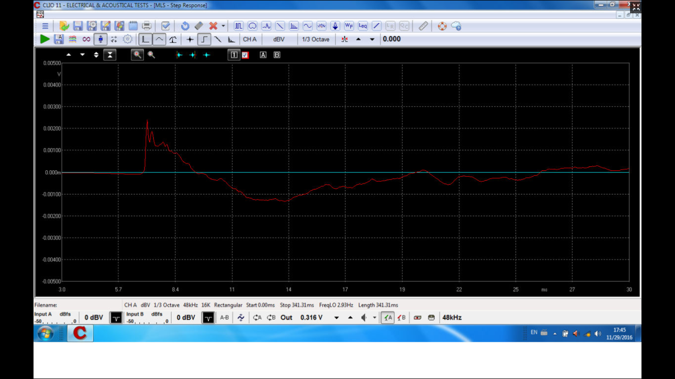

Answer for TNT
It is not easy in simple words, but I will try to explain the design aspect with popular logic.
When some speakers have very good Time Aligned – ie. smaller possible (any resultant) distortions, then the direct signal along the axis lines incl. and the reflections will collectively have less distortion reaching the listener. Other speakers with Time Distortion will have more "dirt" coming and from reflections as well.
The directionality of the individual drivers is hardly a factor in this aspect.

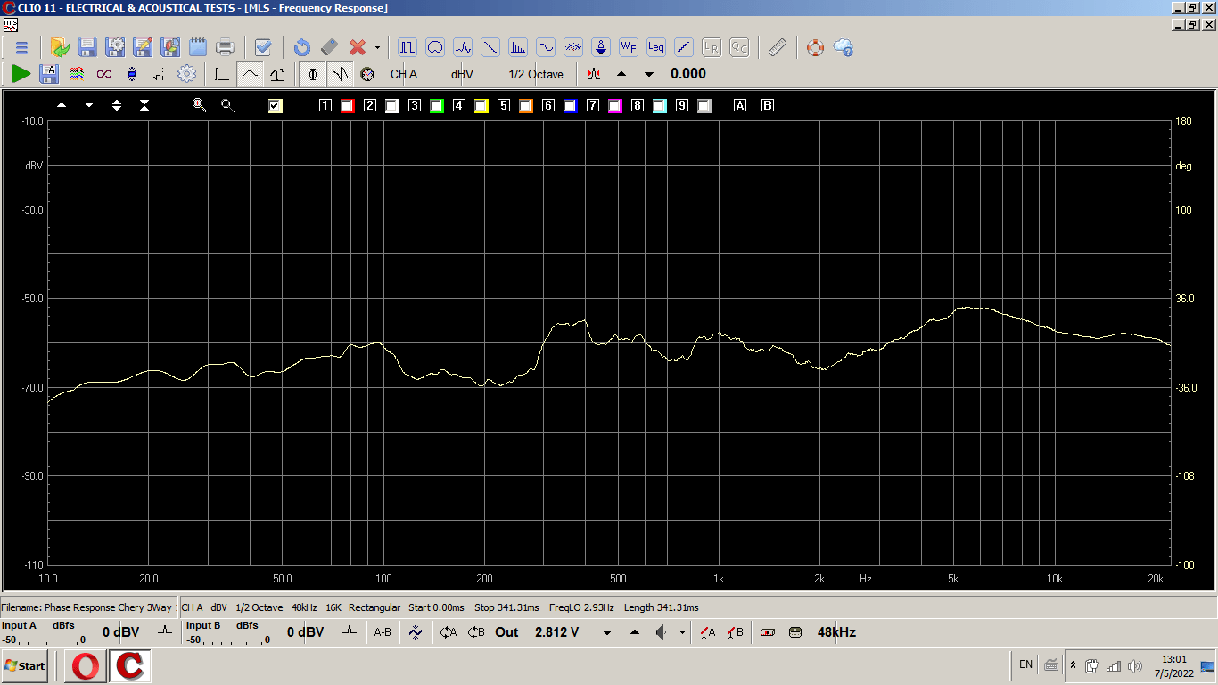

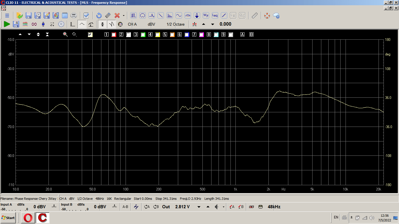

To mbrennwa
I will look for the desired files and possibly make actual measurements.
Phase response with 10" Audax
Phase response with 10" Vifa
Clarification!I was more interested in the SPL, not (acoustic) phase.
The average SPL is always based on the driver with the lowest sensitivity.
In this case, the mids and highs are equalized relative to the bass driver.
In the specific case - the Sensitivity is 89 db with 10" Vifa bass driver or 91db with 10" Audax bass driver.
And last but not least - clarification is needed: What level do we supply to the given DUT ?
It is usually 1 watt per 1 meter.
In this sense, SPL and Sensitivity are close and almost the same parameters.
Ok, I got confused by your post #14, because it mentioned "phase response" and the plots show two y-axes (dBV on the left, phase on the right). Are you saying the plots in your post #14 are the SPL curves?
Anyway, the curves extend down to 10 Hz. Either you have an anechoic chamber, or you are showing the response including the room response. I am interested in the anechoic SPL curves.
Please clarify.
Can you post the impulse response data (data file, not graphics)?
Please clarify.
The graphs from post #14 are phase characteristics!
