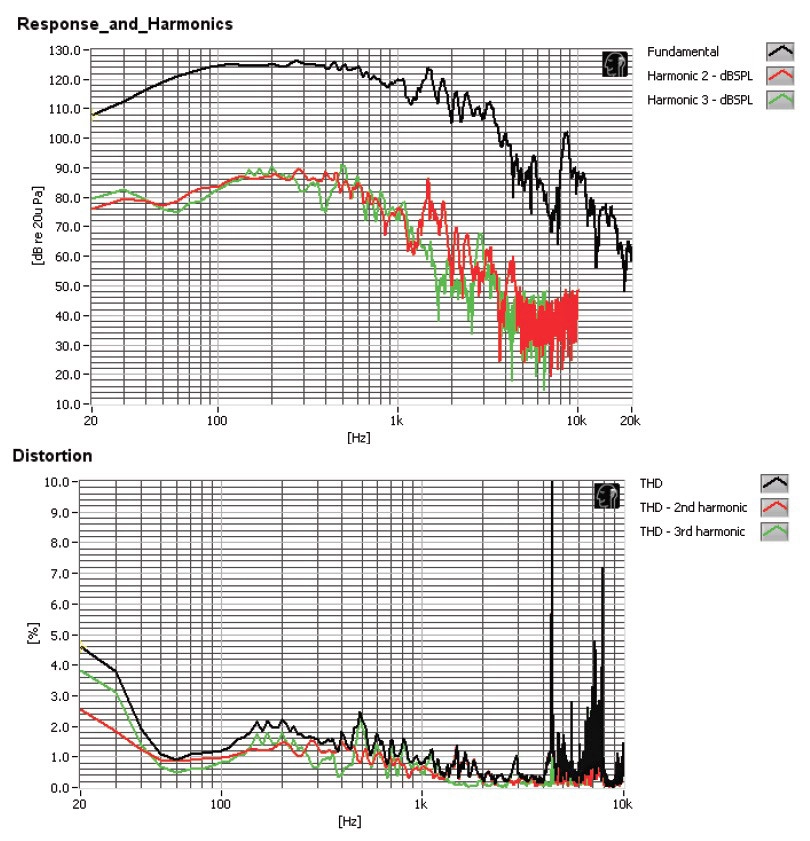

but i think it is interesting just how bad prosound subwoofer drivers are above 80 hz considering their stellar efficiency. for example look at this distortion chart from the following link:
https://audioxpress.com/article/Test-Bench-Eighteen-Sound-18TLW3000-18-Dual-Voice-Coil-Woofer
distortion is lowest at around 60 hz, then doubles by 150 hz ... and this test is in FREE AIR which disadvantages lower frequencies
so this sub is perfectly optimized for its intended frequency range. the rise in distortion at lowest frequencies is unavoidable due to high excursions but the bump around 150-200 hz could have been designed out ... but there was no reason to as this driver will never see those frequencies.
for this particular driver the XO could be stretched to maybe 100 hz, and with some other drivers maybe to 120 hz but i still find it fascinating how true subwoofers like this exhibit this mess right above intended crossover frequency while woofers of similar size do not. to us lay men a paper cone is a paper cone but clearly there is more to it than that. subwoofer, woofer, midrange and full range cones appear to behave differently and it's not about the diameter of the cone. or it may be down to suspension or something else, but the effect is clearly seen in basically all subwoofers Vance Dickason has tested even though he doesn't talk about this.
