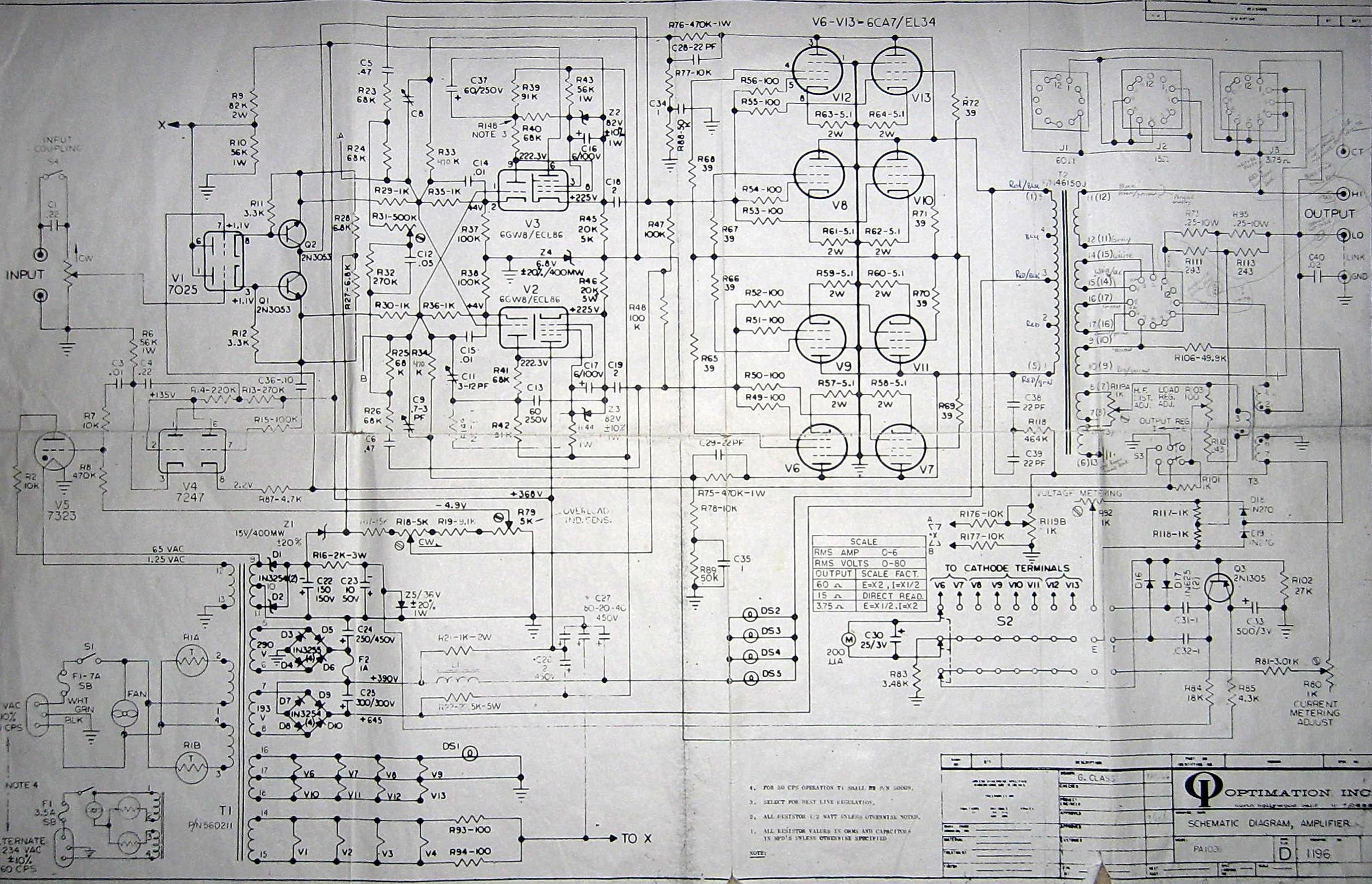

He didn't specified the full tube complement but I have the schematic of the Optimation PA-1006 which looks pretty close. (very likely another variation of the same circuit ?). This is the only schematic I've ever found and the original was a poor quality underexposed picture. I've cleaned it a little bit and re-adjusted exposition/gamma parameters, it's still far from perfect but mostly legible. From the schematic you can see it's a very complex amp using fully balanced circuits and many adjustments and other refinements. (even the overload indicator uses a special 7323 subminiature thyratron tube !). Engineering specs are probably outstanding but industrial grade/laboratory amplifiers (like the Krohn-Hite, Optimation, etc...) are usually poorly rated by Audiophiles for some reasons I don't know... They looks impressive and being industrial/professional purpose amps very well built.

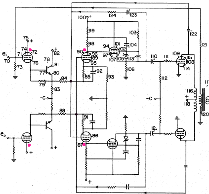

Thanks for the schematic. I'm curious how similar it is to his patent schematic below:
Definitely some similarity. Have to trace out the feedbacks yet.
Well, I see the same positve Fdbk inner loop, and the "local" output plate feedbacks to the 6GW8 triode cathodes.(also to the crossed triode grids)
In the patent drawing, there are series caps in the "local" plate Fdbks. I have wondered if these were small caps or large ones. Small caps would allow the local Fdbk to increase with frequency (so reducing the global Fdbk with frequency. The PA-1006 does have 22pF caps across 470K resistors, so "local" N Fdbk starts increasing around 3600 Hz. There's actually two similar freq. shaping networks in series. So, in effect, the N Fdbk transitions from global to "local" as the freq. increases.

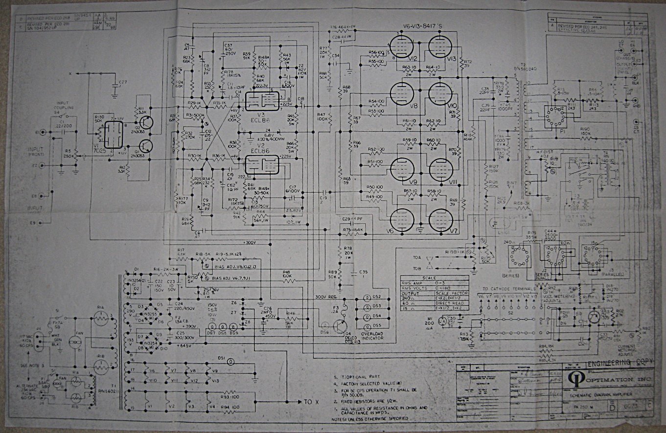

I found a PA-250 schematic someone sent me years ago, I hope they don't mind me posting it. Looks quite similar to the PA-1006 schematic already posted, except for the 8417 output tubes.
I think they were asking some questions about it. Probably was over my head at the time, I don't recall. Maybe if they are still around they can get some answers here finally.
The interesting thing to me is the apparent frequency selective transition from global N Fdbk to "local" N Fdbk at higher freqs. And the inner positive Fdbk loop for high gain, as in Wolcott's patent. The rest of the design seems like massive overkill and could be simplified for audio. Especially that phase splitter. And use TV Sweep tubes with a low primary Z OT (just 2 tubes for 100 Watt out). Twin/Crazy drive of course too. Still have to make that 0.01% distortion spec...
