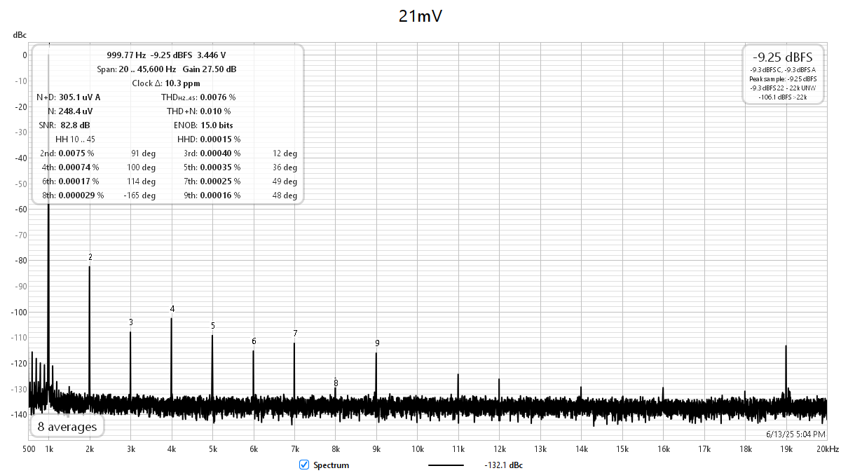

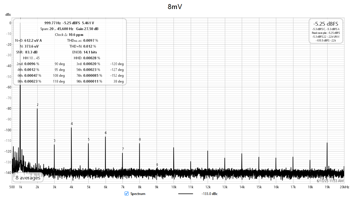

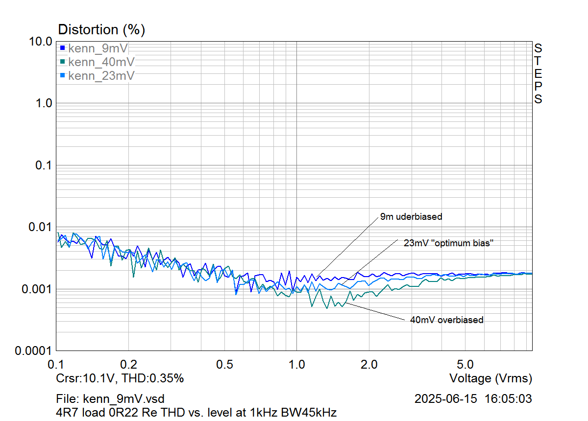

Simulators (MicroCap, LTSpice) show +/- similar values. But how about real amplifiers? Is it a general rule? My experience says that sometimes yes, sometimes no, depending on the amplifier circuit.

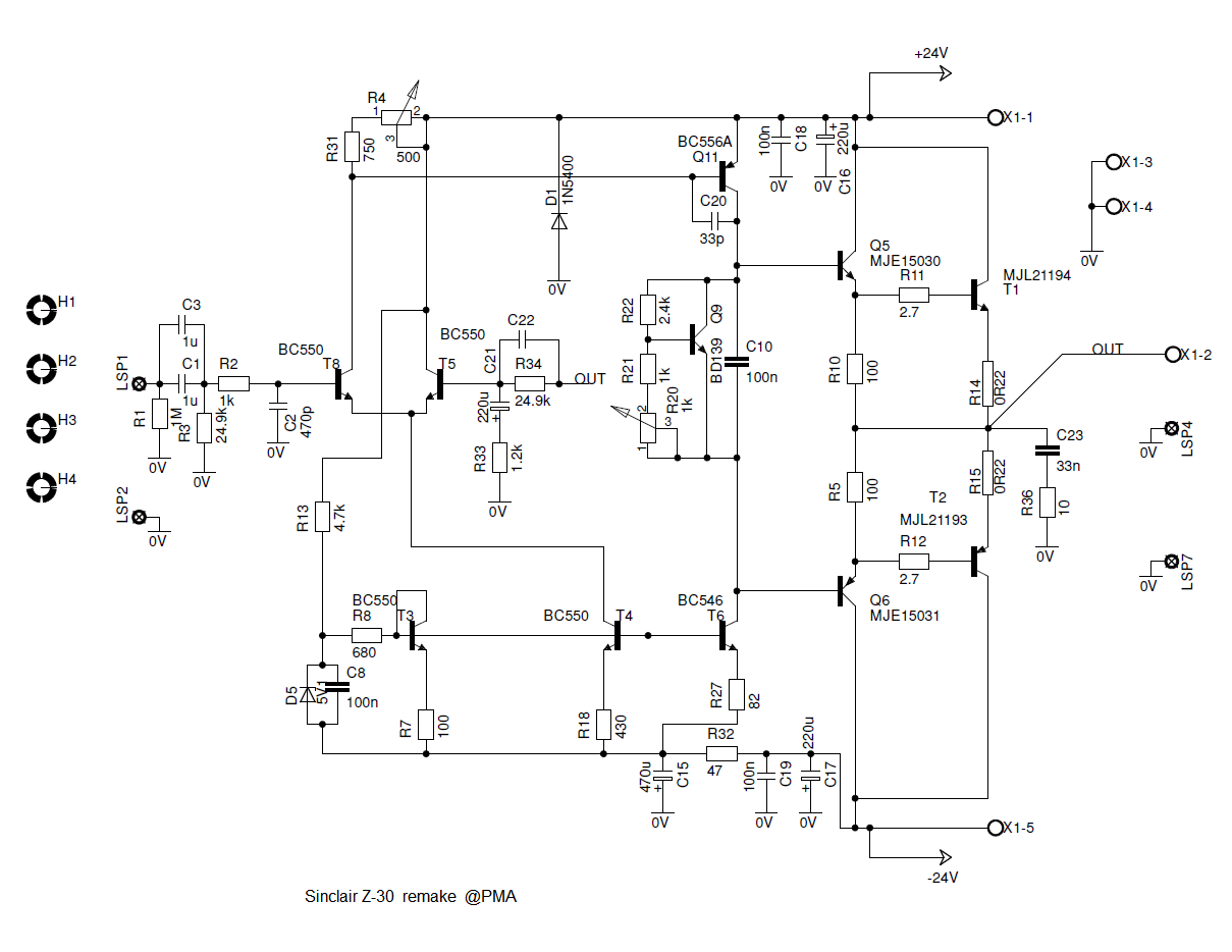

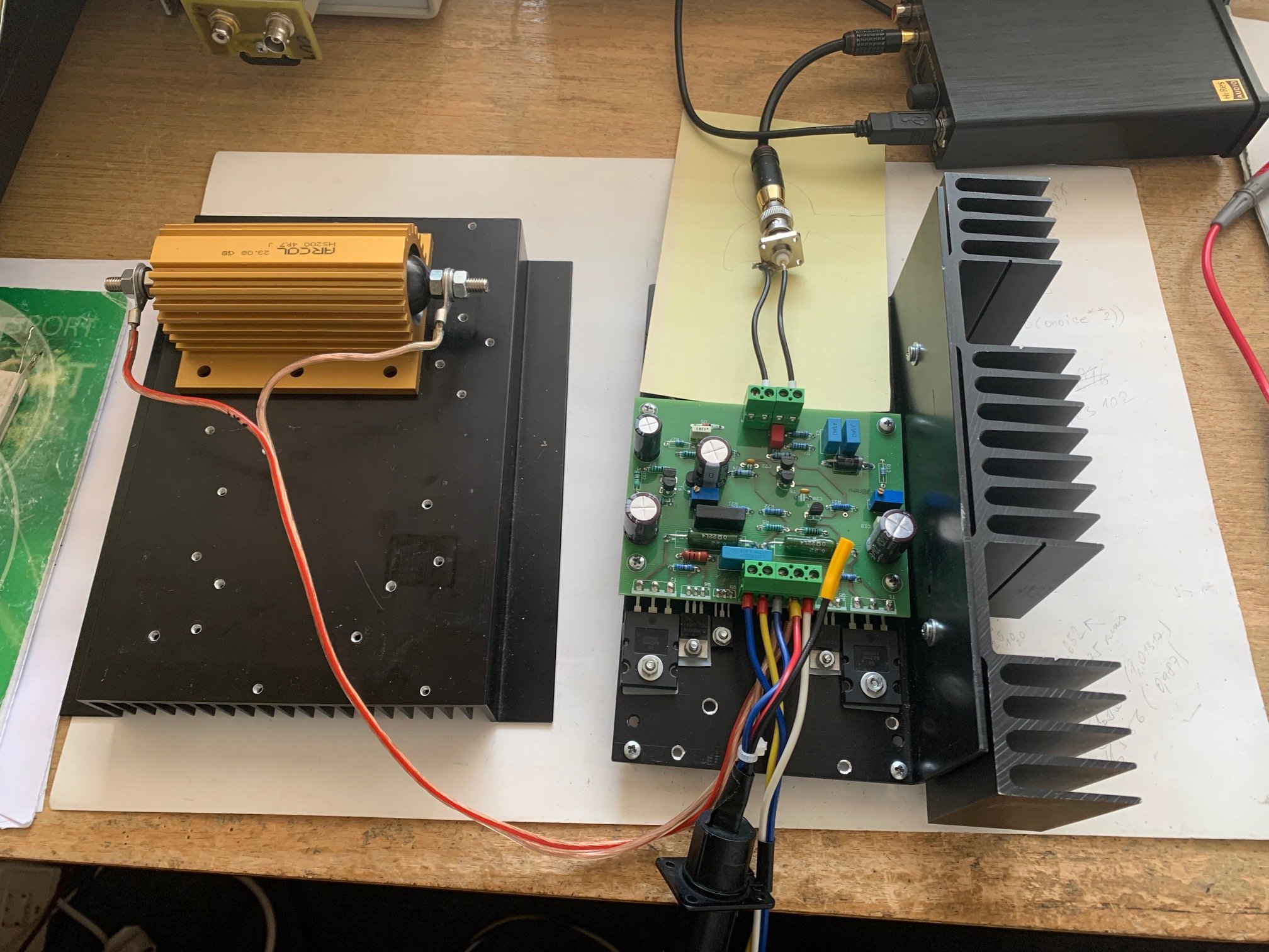

I am posting an example of the amplifier where this general rule does not work. It is the remake of 1969 Sinclair Z-30 amplifier:

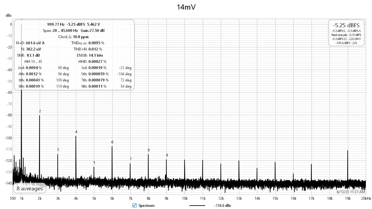

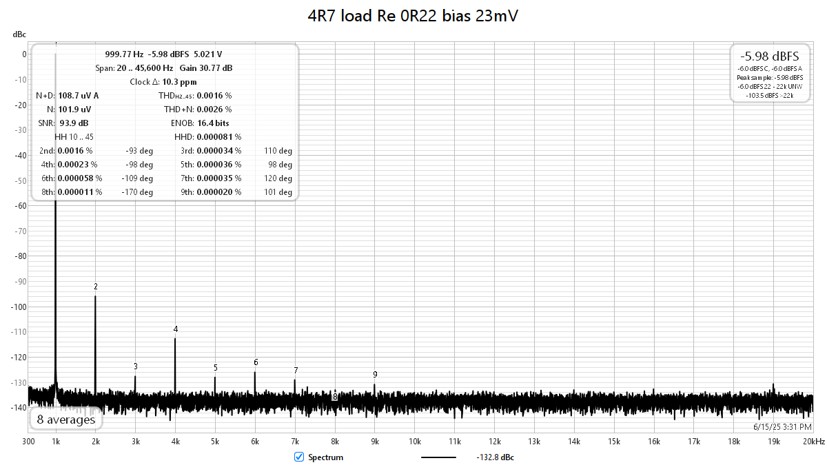

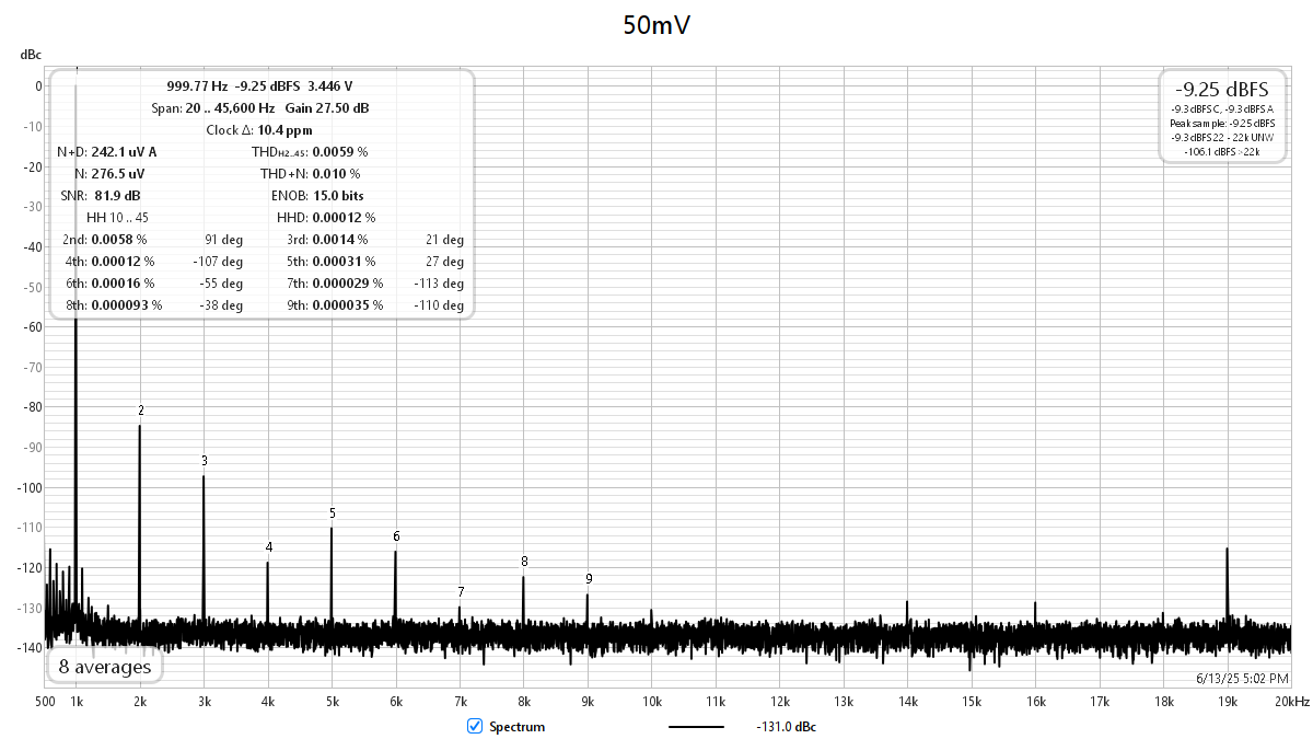

Re resistor (R14, R15) is 0R22. Optimal bias should be (according to Self) 23.1mV per Re. I have measured spectra at moderate power (4R7 load) for 8mV, 14mV and 21mV per Re, i.e. idle current 36mA, 64mA and 95mA. Below are the results.
The distortion is almost same in all 3 cases, slight differences are in high order distortion components. Something does not fit. Let's measure distortion as a function of output voltage and idle current:
And now we have it. It is something that we would intuitively expect. At low power, the higher the idle current, the lower distortion, because the output stage stays longer in the class A. The lowest distortion is for 50mV across Re, resulting in 227mA idle current. Now we are up to 0.48W in class A for 4R7 load (green trace). About 2.5x Self's optimal bias point. So? Isn't it better to design for lowest measured distortion, rather than follow textbook suggestions? And, BTW, this amplifier has flat THD vs. frequency up to 10kHz, measured with 90kHz BW.

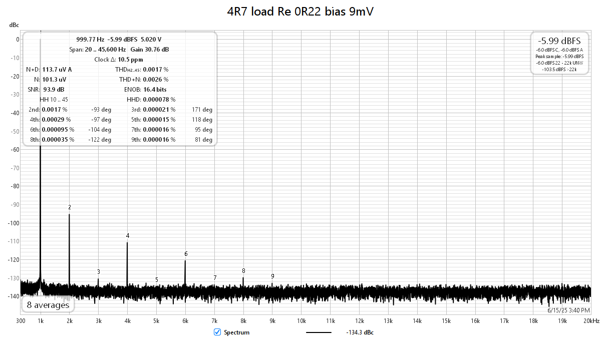

What frequency did you bench at? How about 10KHz.
I did some math behind it sometime ago. The result confirmed what Douglas Self suggested. One assumption is that the output transistors are driven by voltage source. Any impedance shown up at the base of transistor could be transferred to the emitter. That may mess up the setup.
As your VAS is just a single transistor and the Miller cap is relatively small, the output impedance of the VAS is high.
I also did extensively simulation with the Blameless EF2 topology. The simulation also agrees the optimal bias point is about 100mA for 0.22 Ohm Re. I will share this later.

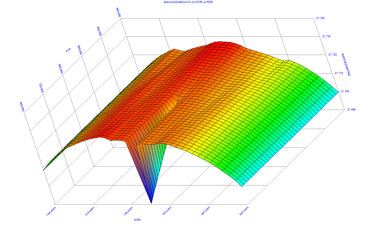

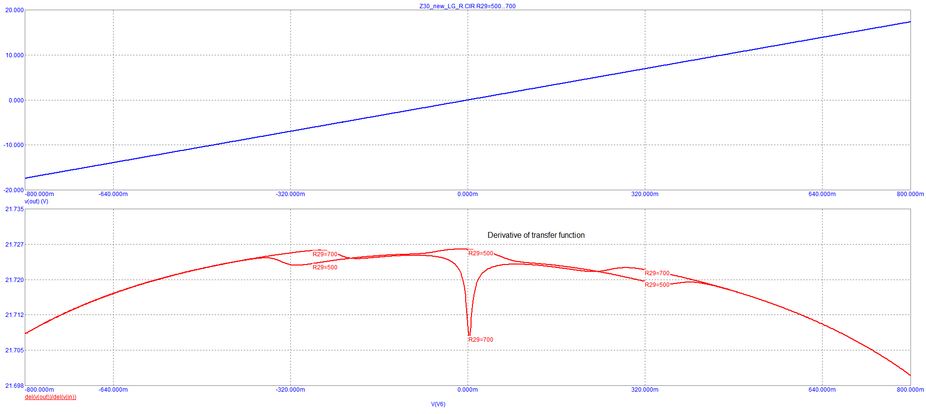

It is the derivative of transfer function (v(out)/v(in)) that has the decisive role. It must be as smooth as possible, without peaks and dips. (R29 is bias trimpot resistance, v6 is input voltage)

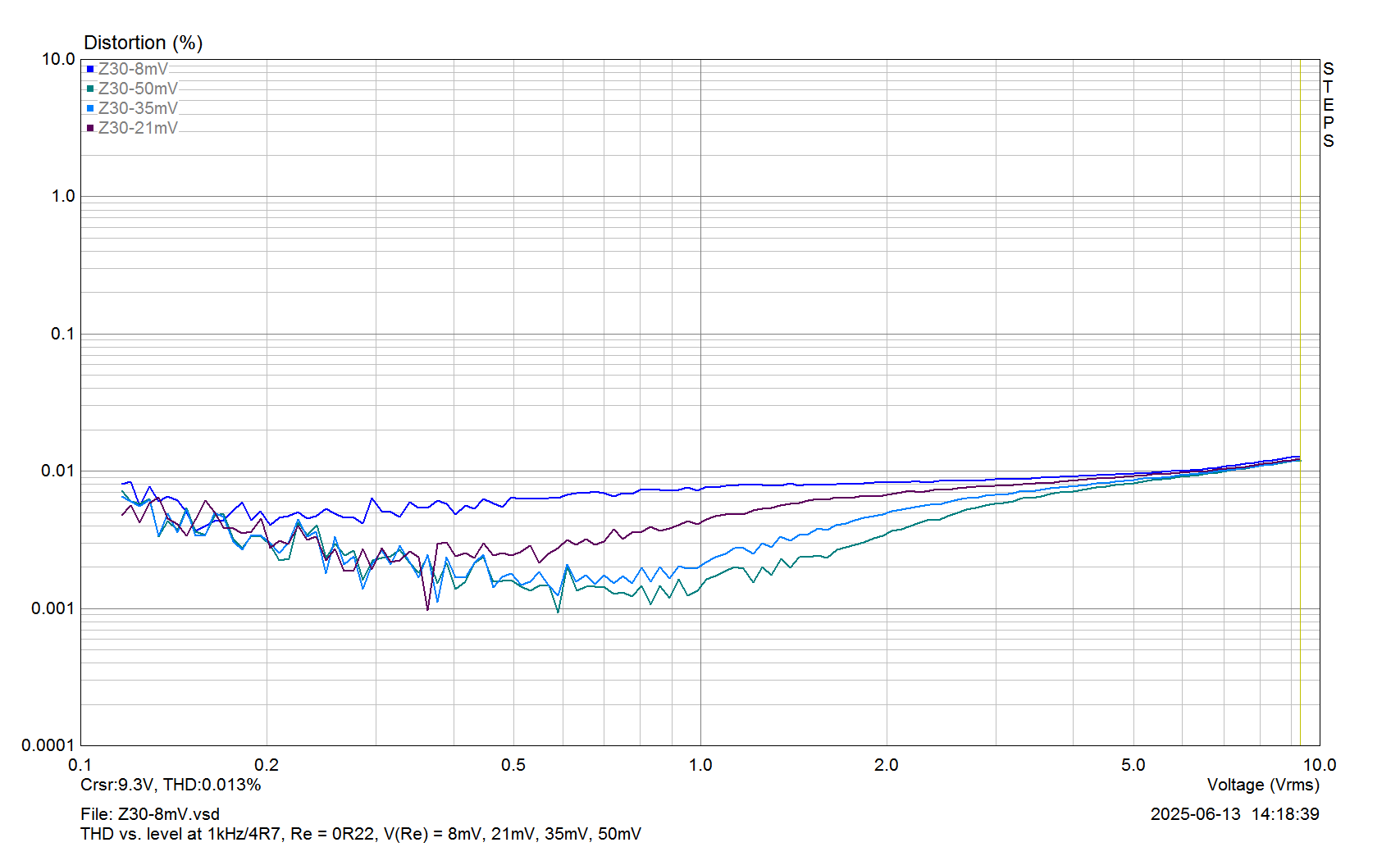

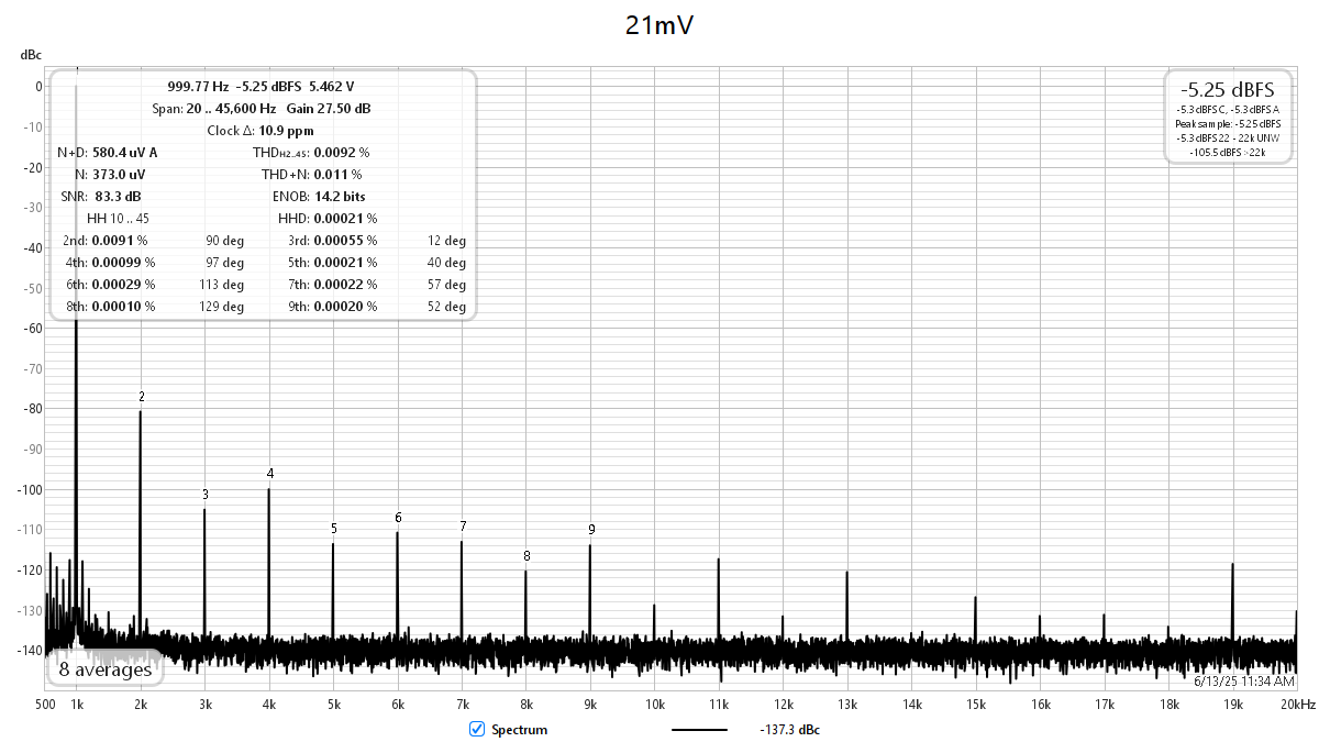

"Optimum bias" 21mV/0R22 (by Self) vs. "overbiased" (50mV/0R22) at 3.5V/4R7 - please note that higher bias has both lower THD and faster decay of high order distortion components. Of course going down to 1V with output voltage the differences become bigger.
"Optimum" bias
"Overbiased"
19kHz is air induced FM pilot frequency due to non-shielded sample setup.
"Optimum" bias
"Overbiased"
Very interesting.
Two observations:
Self's data is for an 8 Ohm load. You are testing with 4R7. How does that make a difference?
Also, you are testing for Iq's up to Self's recommendations. What about going higher?

You need to compare the measurements against simulation. I expect that the device parameters can be adjusted to get a good match.
The 22mV rule applies only to a complementary emitter follower class AB output stage driven by a voltage source. This is the dominant source of distortion in my amplifier (and I suspect all good amplifiers). The amplifier you are measuring did not try to minimize other sources of distortion.

This is IMO the best way how to display transfer function with respect to input voltages and idle current /represented by trim pot value/. This is the way how to find an optimum and then check it in a real circuit. Make it smooth as possible and get rid of the ditch. The "ditch" is the reason of the infamous transistor sound.
