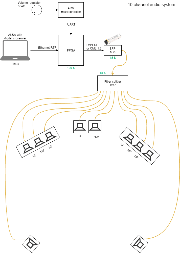

I have long planned to develop and assemble a multi-channel audio system based on fiber optic connections.
Now optical SFP modules are inexpensive.

I see master clock at the XMOS. Would the remote units use PLL for clock recovery from the incoming stream? In that case why not use regular TOSLINK for the transfer?
No PLL on remote devices will be used. The master clock is transmitted in the common TDM stream, the jitter of the SFP modules is very very small...
TOSLINK cannot transmit 8 channels 24 x 192 kbis/s x 8 ch = 36,864 Mbit/s
via SFP 1Gb, 200 such channels can be transmitted or over 60 channels 32x384 kbit/s
TOSLINK it's already yesterday.
SFP optics are much faster and cheaper, I wrote the prices in the figures

Interesting. I know almost nothing about the SFP technology. How does it technically route audio clock through a switch without introducing any jitter/phase delays?
OK, no switch, but splitter. Still I do not understand - can you run the SPF line at any frequency you want, or does it support just a set of fixed frequencies you can switch between?
it is possible at any frequency in a certain band, for example 100 MHz - 1 GHz
The module does not know anything about this.
What came from the differential input LVPECL went to the laser and vice versa...

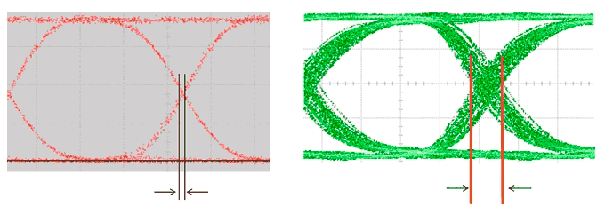

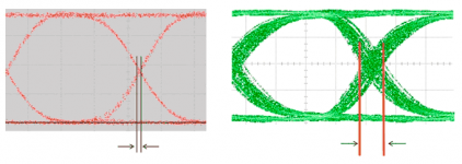

I indicated the above values jitter tolerance. For SFP is equal 0.2 UI
For TOSLINK 0.2 UI
real jitter SFP will be much smaller - about 10 ps
Jitter is inversely proportional to the maximum channel transfer rate !!!

I see you using this image to represent jitter in your system:
I assume this is supposed to be a digital signal, alternating between high and low? Only at the very bleeding edge of what sample rates can be supported would such "rounding" occur...
I really do not think that picture of jitter in a digital audio signal area really all that applicable to the "real" world, and if so they would only be a of concern where the digital audio is rendered via a DAC. This is under the assumption that the bandwidth of the signal transmission system is more than capable of carrying such a signal, and that the digital signal is not being bandlimited elsewhere. At what frequency do you expect to see such a pattern?
Would not a simple buffer and re-clocker at the DAC end of the chain make all of this a moot point ?
