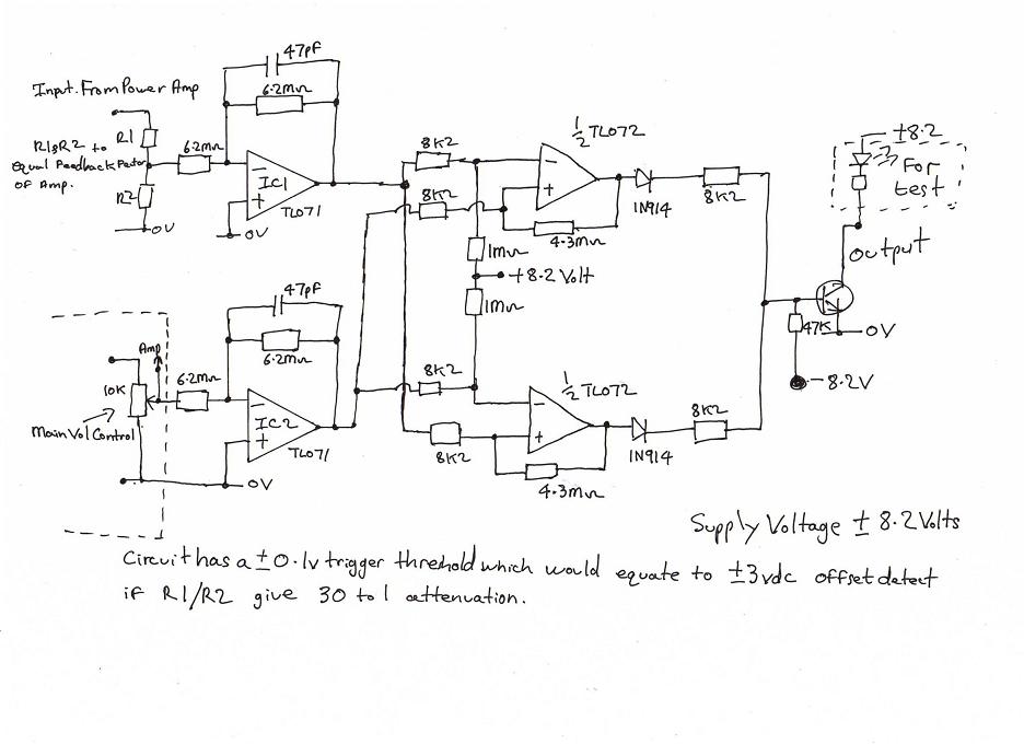

Not at all... that looks the perfect (never perfect is it 🙂) missing link for a project of mine... DC offset protection without the normal integrator delay.
Relays are the weak point (speed and contact arcing)... so using FET's and a photo voltaic driver could be ideal.
